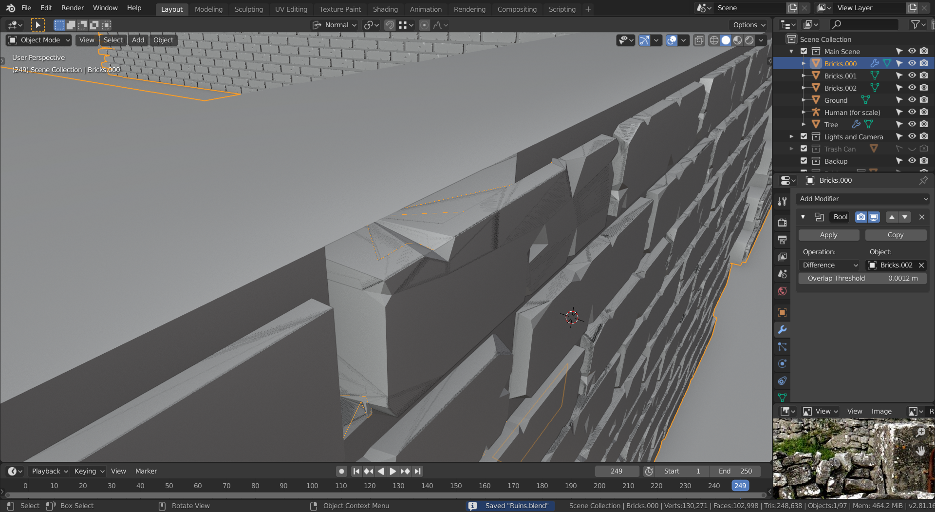

            I don’t want to get into the habit of not finishing projects, but this is hopeless.  Cell fracture deleted random chunks of the wall and created floating vertices and edges everywhere.  There is also lots of this:

              That is very strange William. Did a little test with Cell Fracture (default settings) and got this:

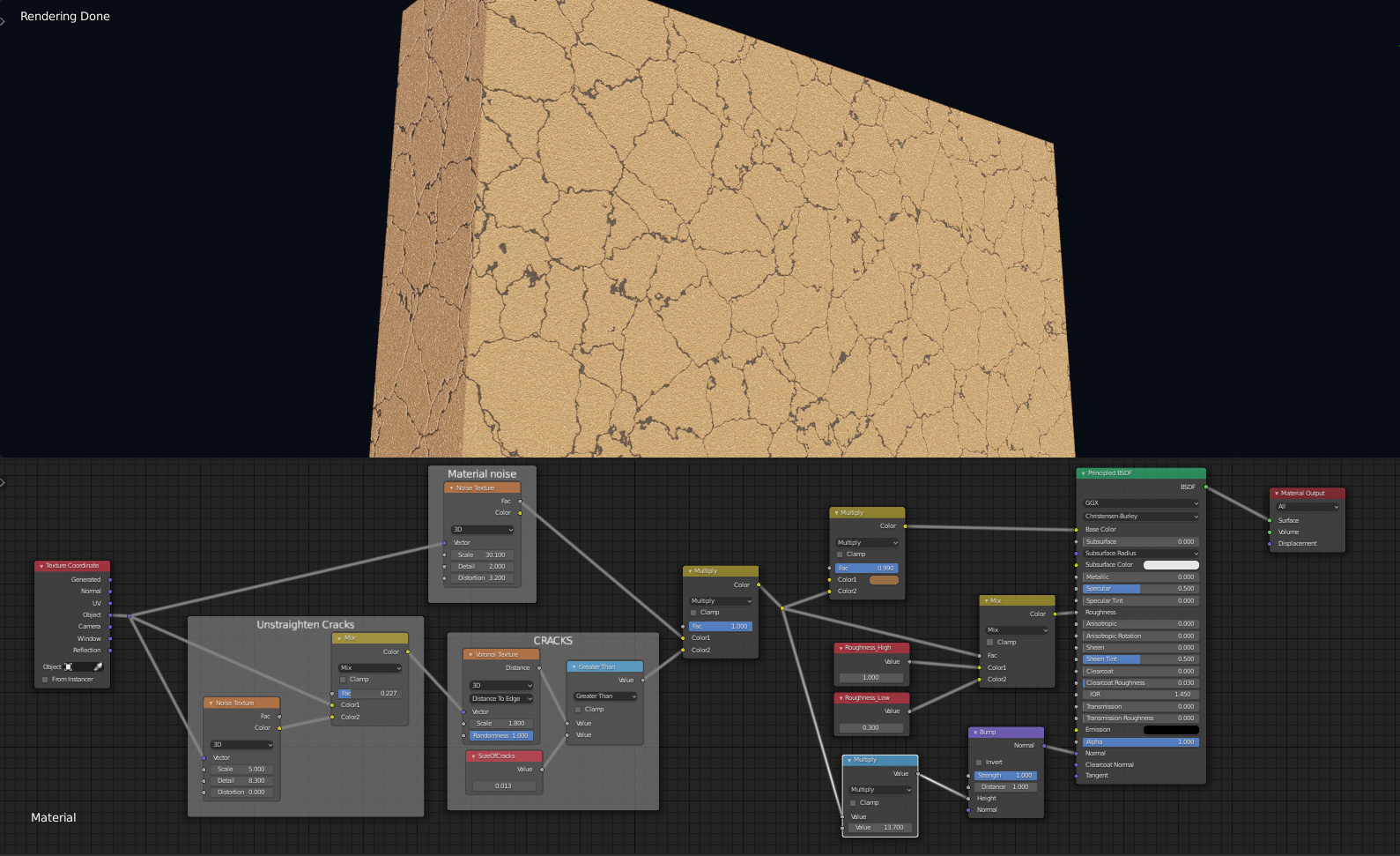

                            Maybe this can help you get started with the cracks. It’s just a basic set up, you can easily create a mask, so the cracks aren’t all over the place. Add some color variation. Some small dents and a larger scale, slight ‘waviness’ to the surface, etc…

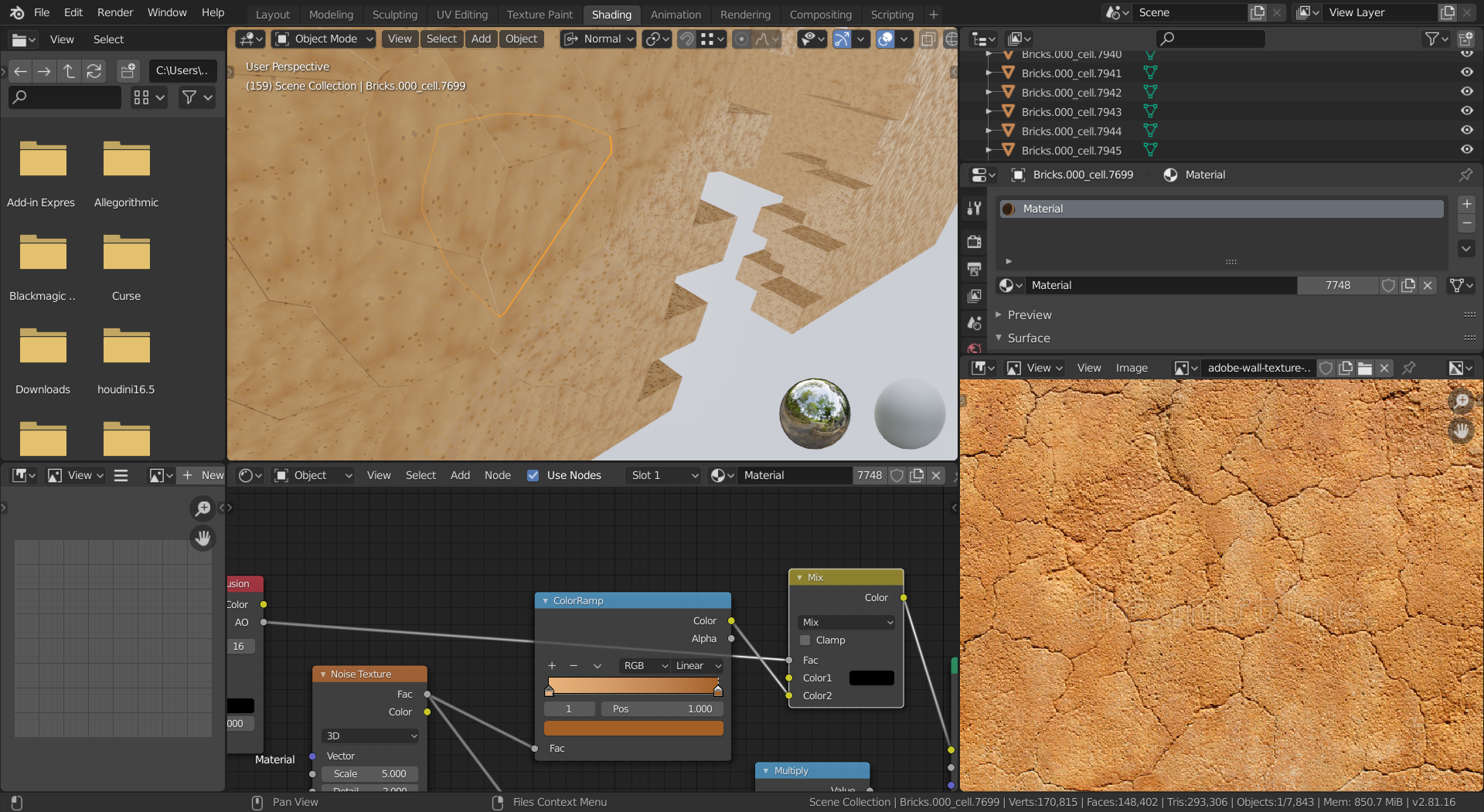

                              I’m trying to make it look good around the edges, but for some reason pointiness doesn’t do anything.  Do you know why?
                              #51755
                                Hi William, Pointiness doesn’t work with Eevee (yet). Material Preview Mode also uses Eevee.
