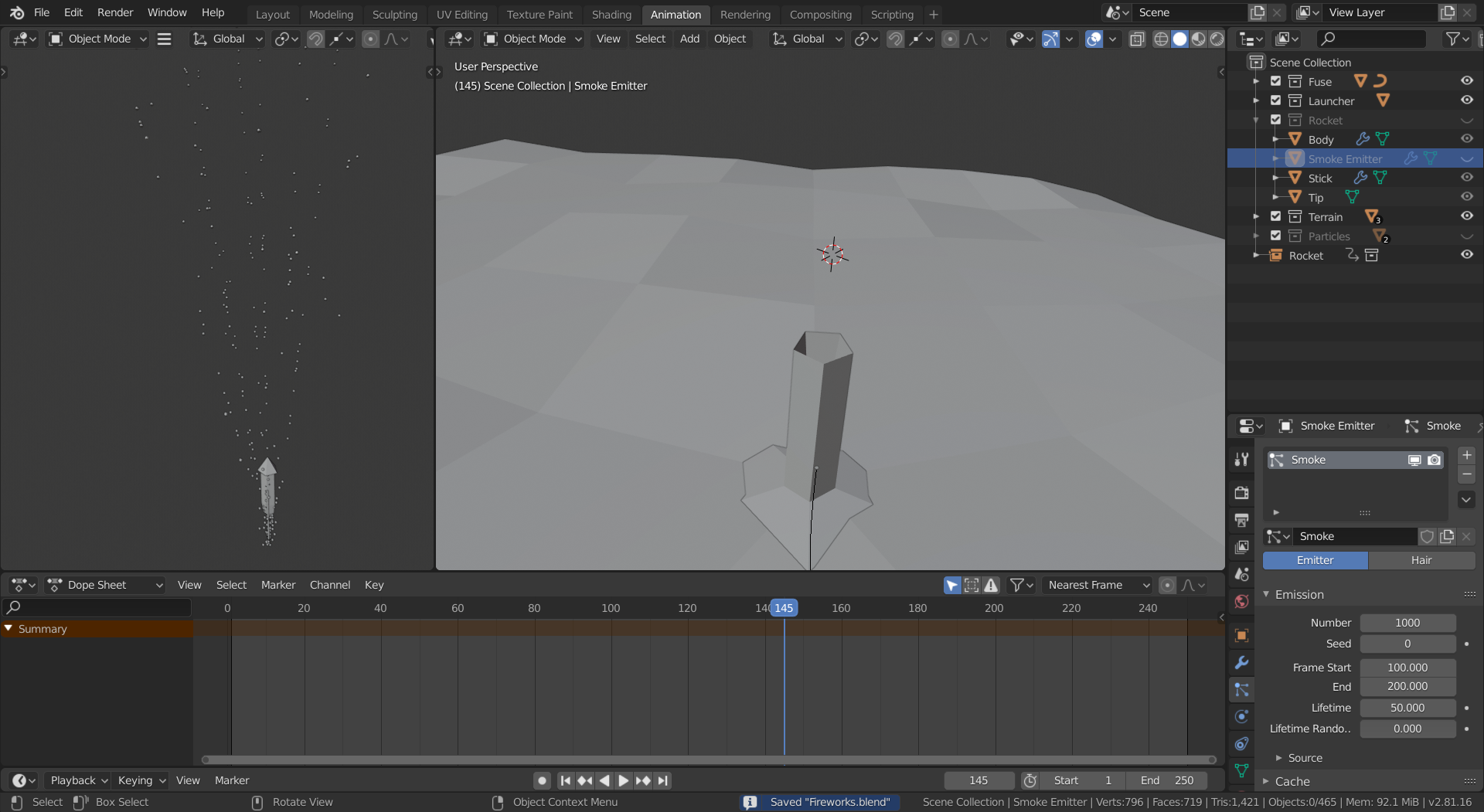

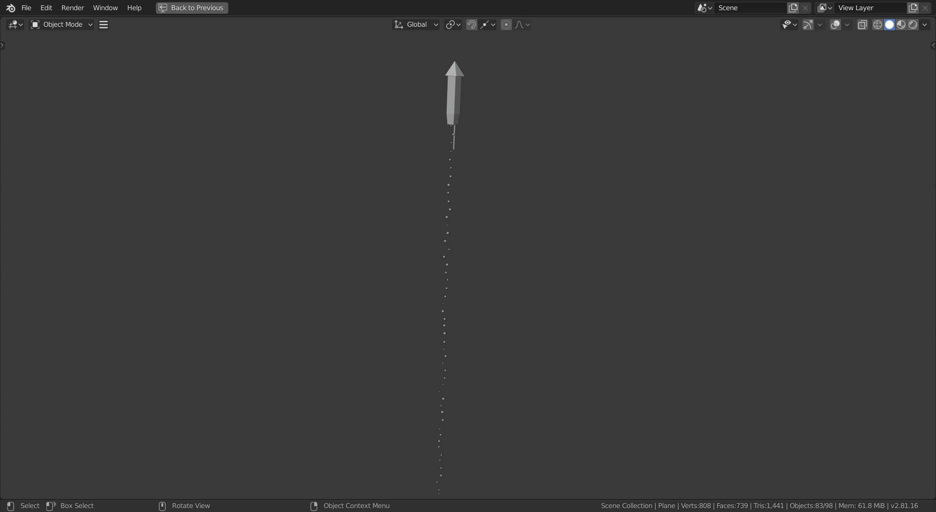

          William Miller
            My smoke is doing this for some reason, which is as awesome as it is annoying.
            #51701
            William Miller
              I still can’t figure out how to fix it.
              #51702
              John Sanderson
                It could be a number of things.  Check the normals on you emitter.  Check if any objects have collision enabled.  What are the friction and damping values? Do you have any physics applied to the particles?  If you can’t find anything maybe upload a link to the blend and see if someone can help you troubleshoot.
                #51703
                William Miller
                  I tried everything, but I still couldn’t fix it.  Does anyone else have any ideas?
                  #51704
                  William Miller
                    After some extensive troubleshooting, I discovered that some of the particles experienced more drag or something, causing them to get ejected downward at a slower rate.  I don’t know how to fix that, though.  Here’s the blend file in case you want to help:  http://pasteall.org/blend/index.php?id=52680
                    #51705
                      Hi William!
                      I don’t really understand your file; why are there two ‘rockets’ and why is the smoke emitter not parented to the flying one…
                      But your smoke particles are flying up, because your ground is a Collider with Damping set to zero. They bounce off the ground into the air;)
                      #51706
                      William Miller
                        You’re a genius!  Why didn’t I think of that?
                        #51707
                        William Miller
                          I finally got the particles to work!  Listening to Spear of Justice while working on it made the end result even more triumphant.

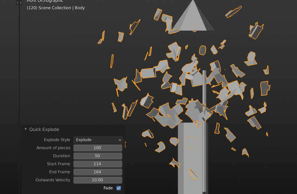

                          #51708
                          William Miller
                            I can’t figure out how to make the firework explode.  Cell fracture is too glitchy.
                            #51709
                              Hi William, maybe try this:
                              In Edit Mode subdivide your ‘rocket’/firework, in Object Mode with the firework selected go to Object > Quick Effects > Quick Explode. Adjust the settings, especially the Outward Velocity:
                              #51710
                              William Miller
                                I knew about quick smoke and quick fur, but not quick explode.  Is it new?
                                #51711
                                  Not really, I don’t know when it was first added, but here’s 2.63 from May 2012:
