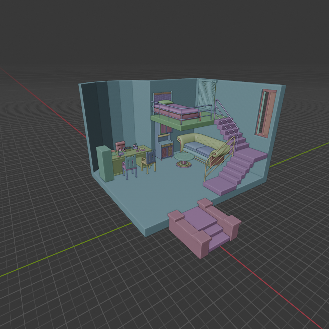

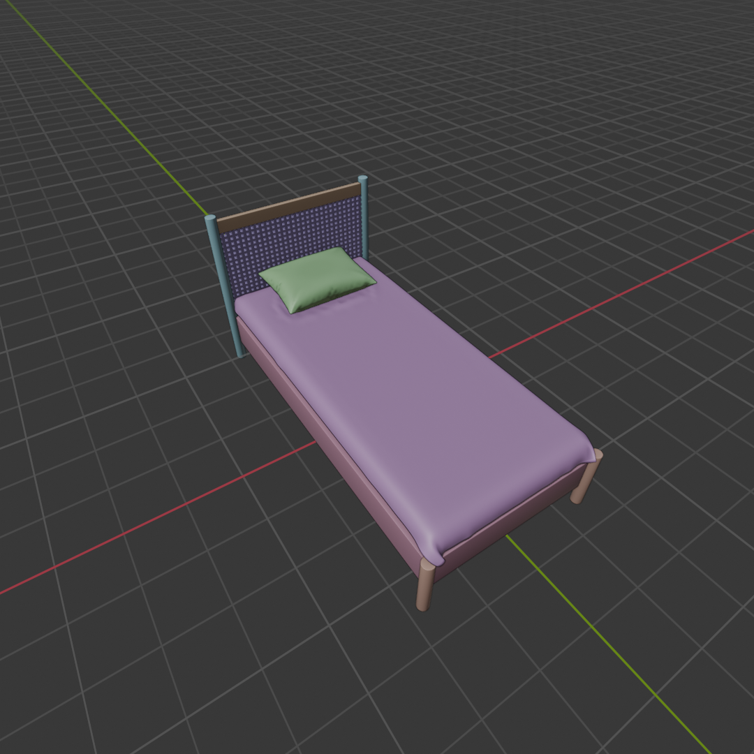

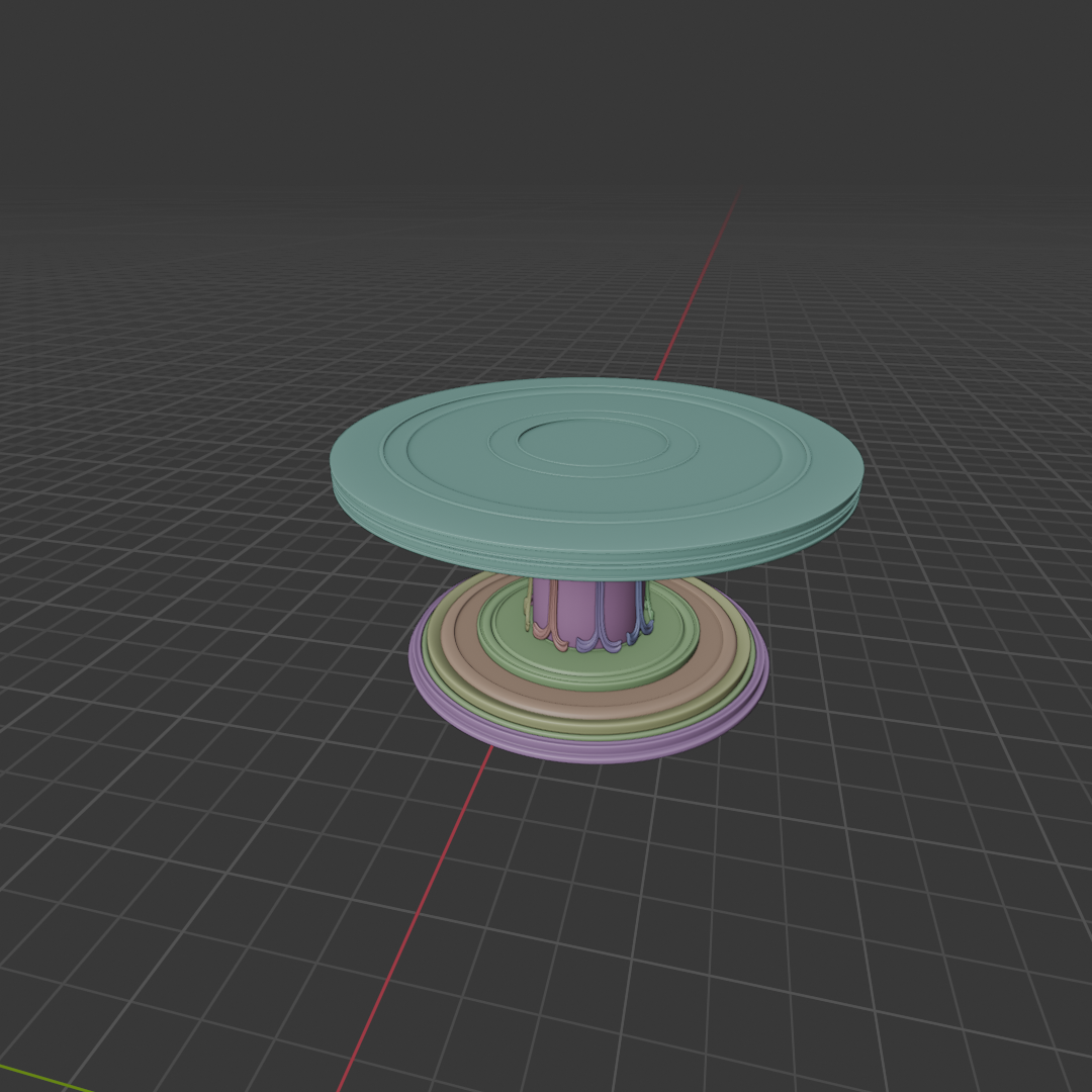

      Two more models finished! 🎉 For the bed cover and pillow i had to watch youtube videos cuz i never use physics before..
      I know I’m posting after a long gap again — it’s been a little over two weeks. My situation has been really tough lately, and my surgeon will confirm my surgery date this Wednesday. I’m honestly scared as hell, but trying to stay positive.
      I’m pushing to get as close as possible to finishing my first isometric room before the surgery, and these two models are now done.
      I hope you guys like them, and I’d really appreciate any critique or feedback — I’m waiting eagerly, as always. ❤️
      Thank you all so much for the constant support.

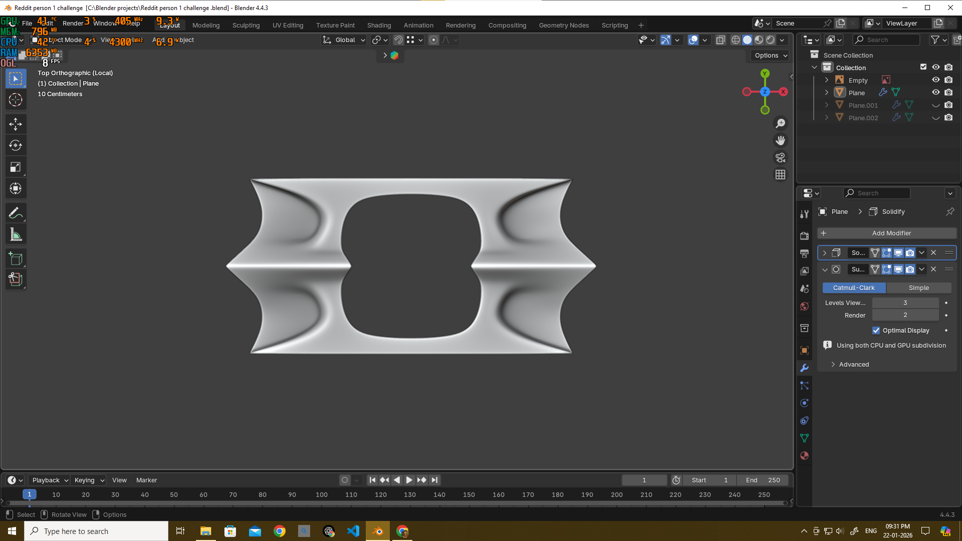

        A very professional person on Reddit gave me this challenge today to model this shape, and I finally completed it after some struggle and with his help (Indirectly). Now I understand the topology and the decision-making behind it, and I think I should add this piece to my artbook. What do you guys think…

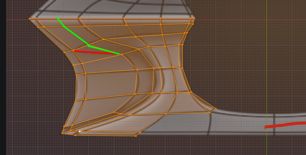

          That’s looking rather good, Deb.
          Now, I am not a professional, but I am not a fan of the two Poles next to each other in this case, giving this – not so pretty – criss-crossing Edge Flow (forgive my terrible Mouse-drawn Annotations). I’d try something like this:

              i notice that spider pole is happening after i use solidify..

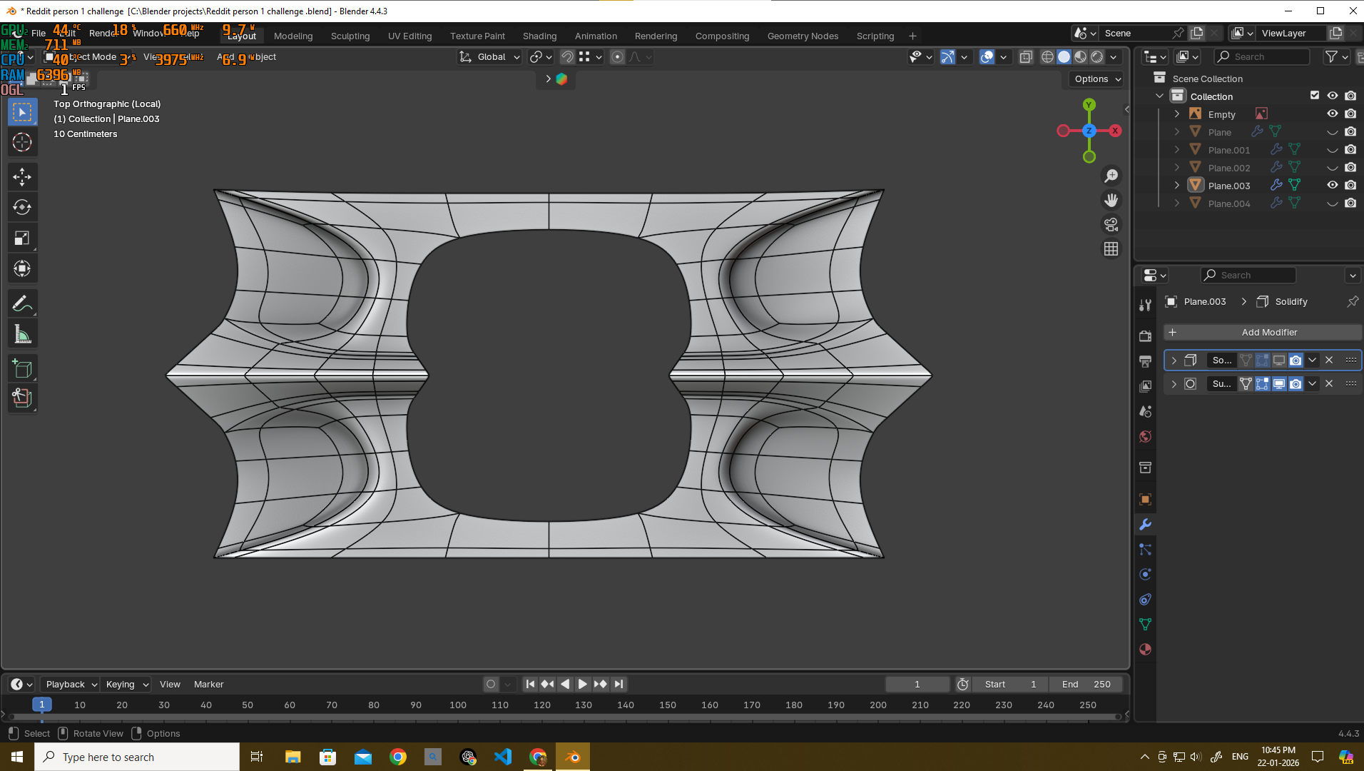

              #96190
              Deb kanta Guin
                here without solidify..now that 3 side pole…will try to fix those too

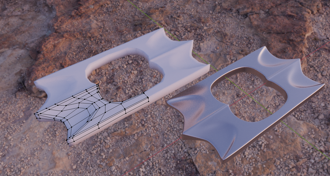

                      OH, I couldn’t resist; my (fast) version:
                      Needs some Vertex adjustments, but the Topology should work, I think.

                              Hey Deb,
                              It’s exactly what I drew on top of yours:
                              #96198
                                So actually just 3 new Vertices, or if you want 3 new Edges and 1 removed:
                                #96199
