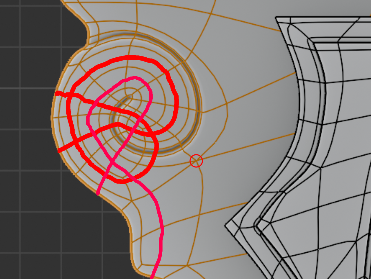

    Deb kanta Guin

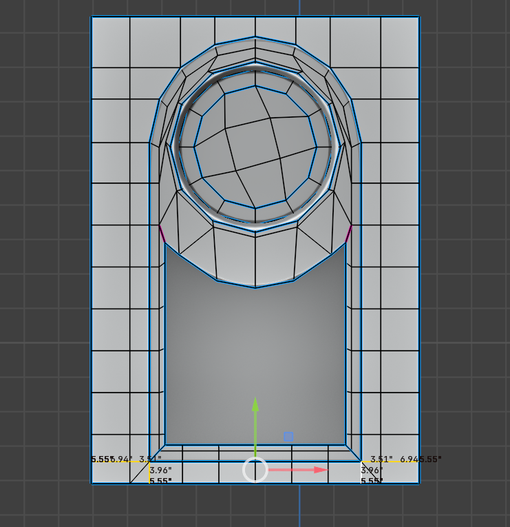

      omar thats actually a very good idea for me…definately i am taking my sweet time while making these models…a fix time would be a good challenge…Thank u very much

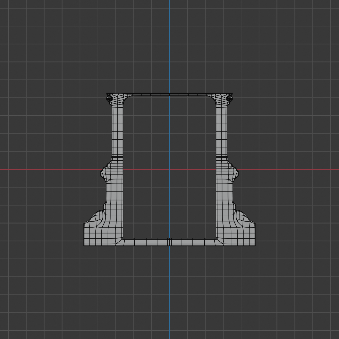

      and martin the i could turn the poles quad no problem
      The poles are there because of these two edges.and its just recducing some geo thats all..and as u said its juts a flat

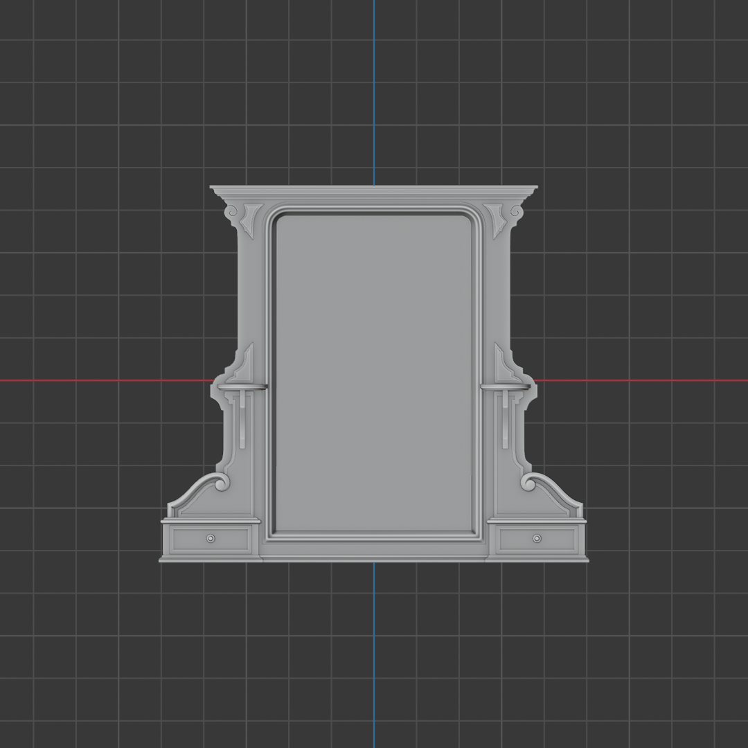

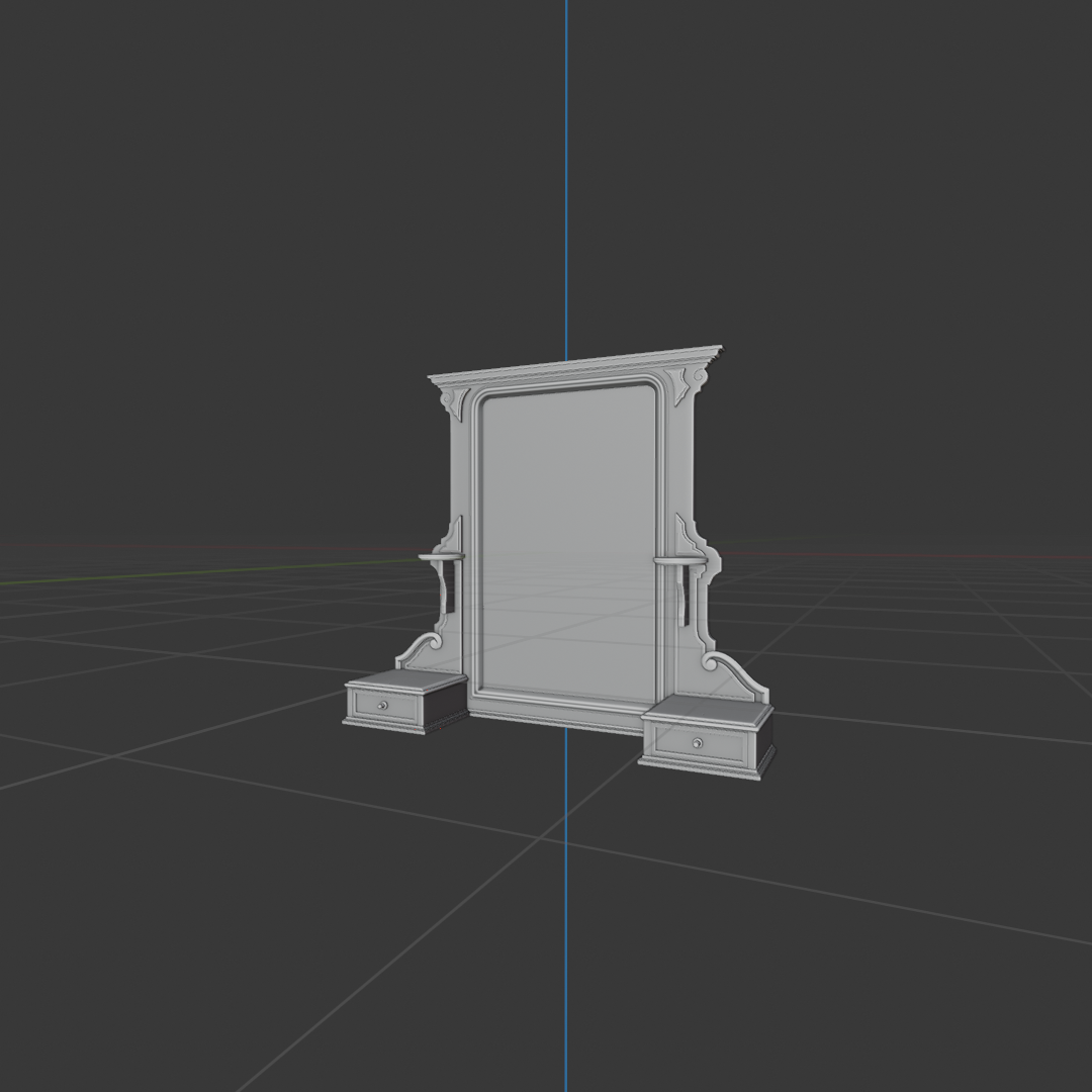

      Deb kanta Guin

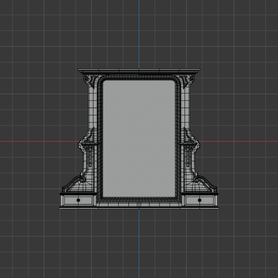

        Another prop completed…
        The actual mirror part is a big ngon
        I made a bad decision for this type of parts..
        if i just made them separate it would had been more easier to model and i would have gotten all quad…its not like i cant make it all quad now…but its not worth the time for what it is i think..
        As always would love to hear ur opinions….

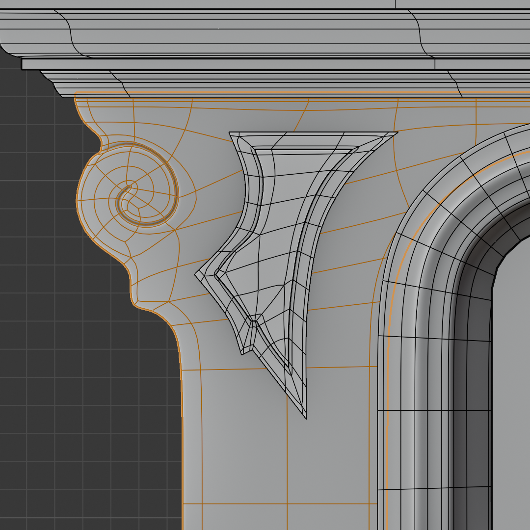

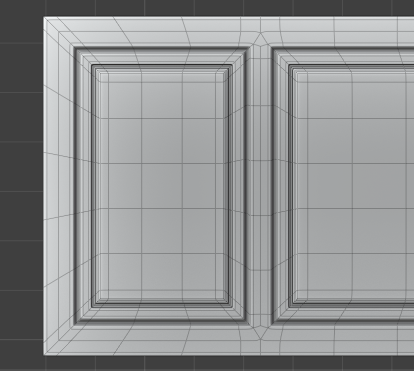

          HI Deb,
          The result looks great and that’s the main thing!
          But you seem to be too much focussed on Quads. There are things that are worse than Triangles and N-Gons. Like 6-sided Poles, bad Edgeflow….
          Now this doesn’t matter in this case with the flat surfaces, but it might be good to keep this in mind for future models. Here’s an example of what I mean:
          #96218
          Deb kanta Guin
            uhh…damn i really did not notice that pole..i mean really…i set a hard rule no pole that have more than 5 edges i allways do that..and i really did not even check that…i will surely remove that…thank u very much martin..

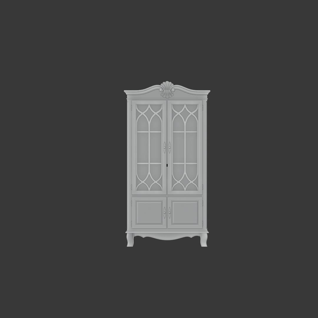

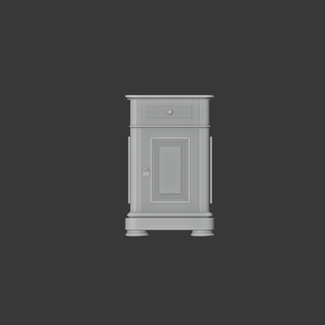

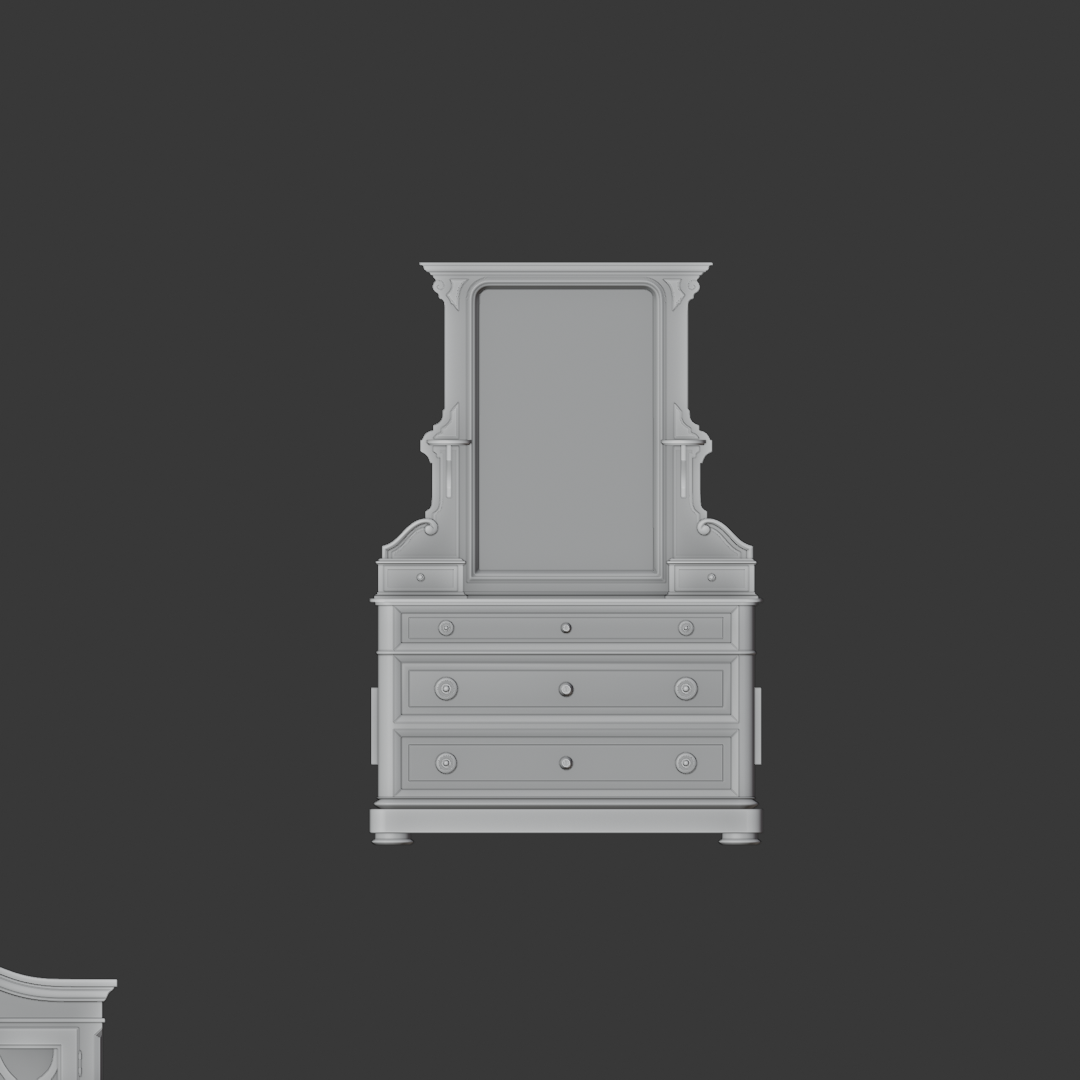

            Deb kanta Guin
              Finish 3 prop guys…
              feedback are allways welcome…
              Also plz tell me is all quad needed for this kind of obj? even in game?
              Though my top model that cabinet is all quad
              and the bottom comode and the table (attach with the mirror) is not quad modeling it have ngon…i mean its flat
              #96220

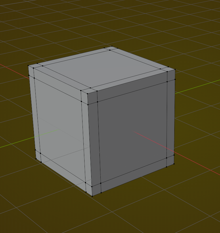

                Hi Deb,
                Those look great!
                As far as I know, all-Quad is mainly for Subsurf Modeling and similarly, if you use Multires for Sculpting. An occasional Triangle is okay in those cases. When used for (Multires) Sculpting, the Quads (Triangles) should be as even and regular as possible. So something like this:
                Is totally fine for Subsurf Modeling, but completely unacceptable for Multires Sculpting.
                The (free) Press Start Course: https://cgcookie.com/courses/press-start-your-simple-first-blender-project
                is a great demonstration of Modeling with NGons (amongst other things).

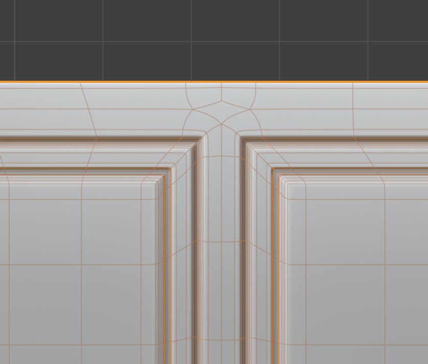

                      ohh i did notice the 6 edge pole martin..but i am not sure what else i shoud do there..i want that sharpness in the corner so i need geo..i did bavel that part and use the classic arc and shape 1
                      #96224
                      Deb kanta Guin
                        after i apply the bavel modifier and tweak the edges i remove the 6 edge pole but now look at this many poles at a same place this probably more bad
                        #96225
                          Hi Deb,
                          Those kind of corners (convex and concave together) can be tricky.
                          Maybe something like this could work:
                          Alternatively, you can allow for some Triangles. That way you can end up with less Geometry.
                          But anyway, a great looking model!

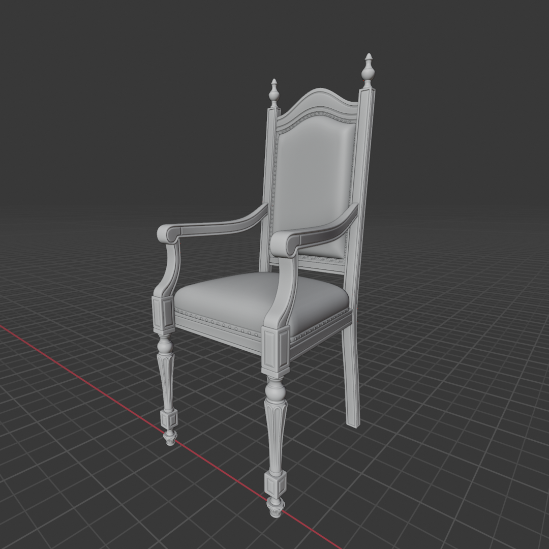

                            Deb kanta Guin
                              another one finish a vintage cahir….
                              any feedback welcome…
                              #96228
                                Excellent!
                                #96229
                                  Wow looking great. You hereby get elevated to Intermediate Blender Master Modeler.
