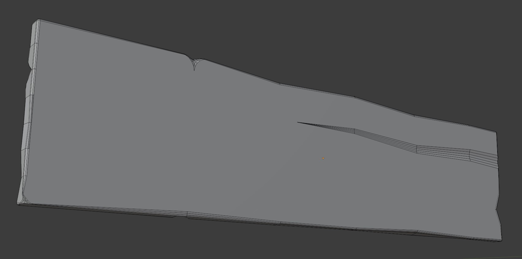

              when i add the cracks to my wood i get those shine spots on my planks.
              1) Is ist from the added details?

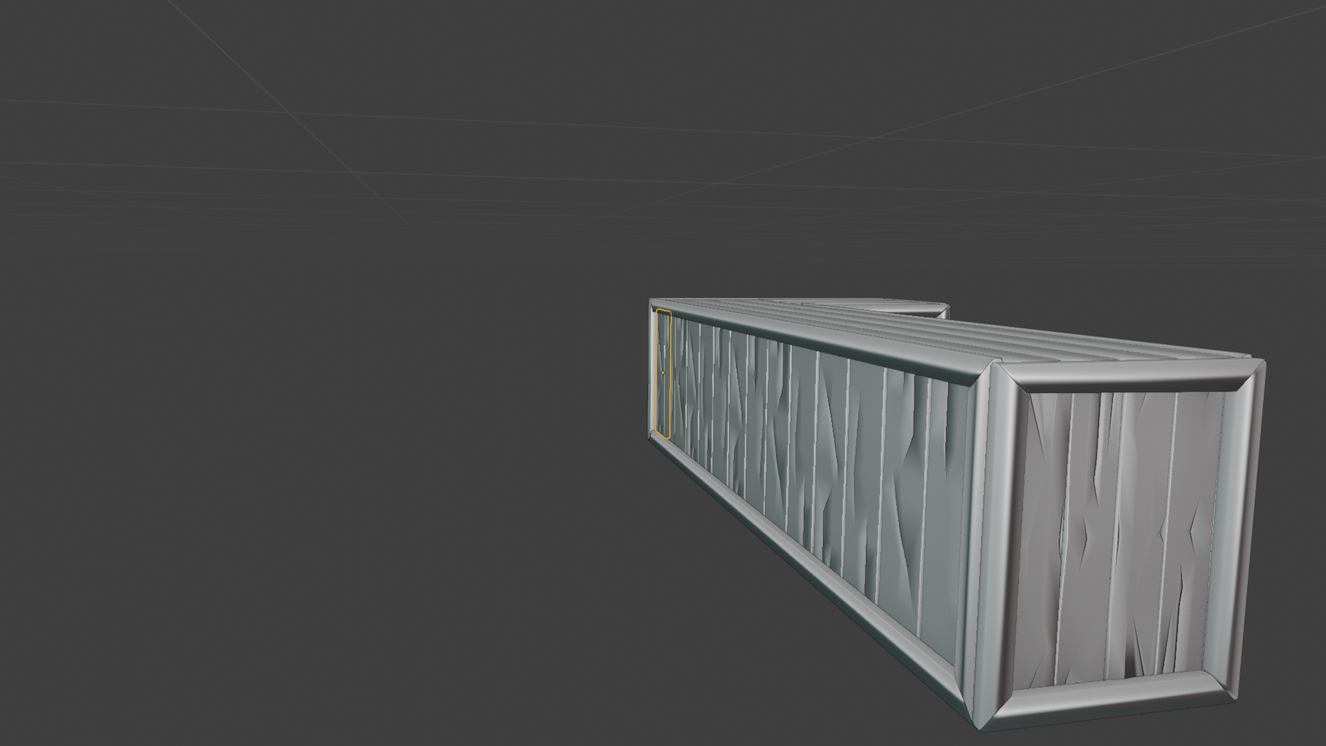

              #64907
              Angela
                It looks ok in the scene, but a bit odd up close
                #64908
                Ingmar Franz

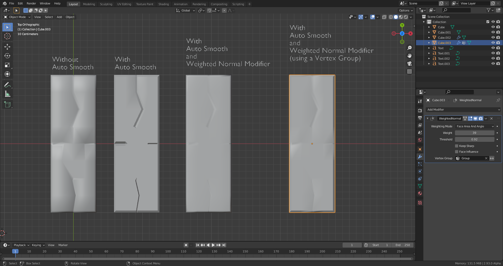

                  @amblender Did you try it with “Auto Smooth” and a different threshold angle?
                  #64909
                  Angela
                    @Blanchsb told me it could be my screen shading. When i use Lookdev Mode in the 3d viewport it looks much better
                    #64910
                    splat21
                      @amblender, try reducing extra vertices.  I was seeing the same thing that you are experiencing.  Here is how I resolved it.  From the board example below, I had six rows of loops and six columns of loops.  After putting in my cracks and dings, I Dissolved any extra vertices.  Especially for a low poly project, I view this step as housekeeping.  I probably have more of this type of clean up on all my objects.  Hopefully this helps.

                            I’ve done some tests:
                            File is here.
                            Lookdev Mode makes it look a little better but it also depends on the light strength. I’m wondering what @theluthier or @jlampel would do 🤔?

                                I’m not sure how Kent went about it in the course, so there could be a better solution here, but I would probably just add an extra edge loop in the flat area around each cut so that the smooth shading isn’t trying to blend with a face that’s far away. Since the rest of the area is flat and there are n-gons anyway, it could just be one big n-gon, but that’s up to you.
