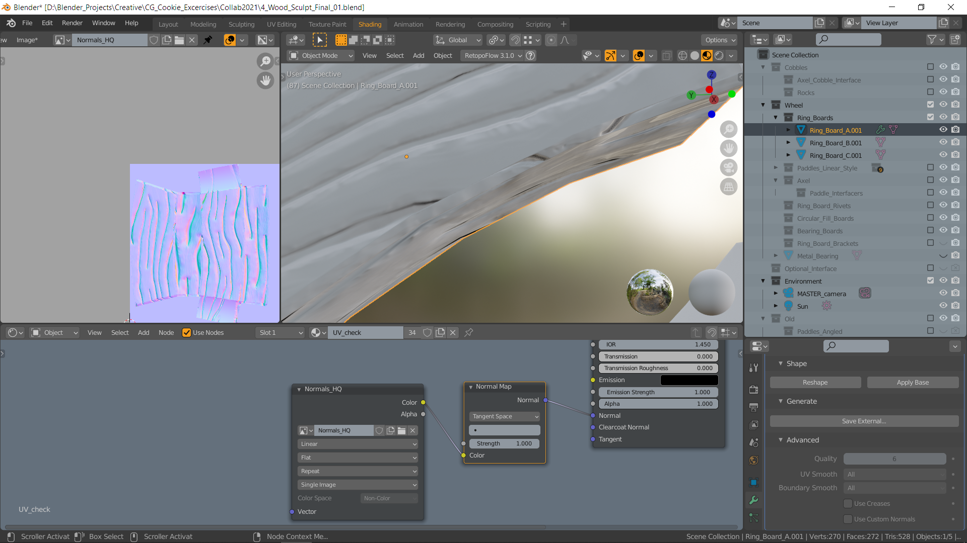

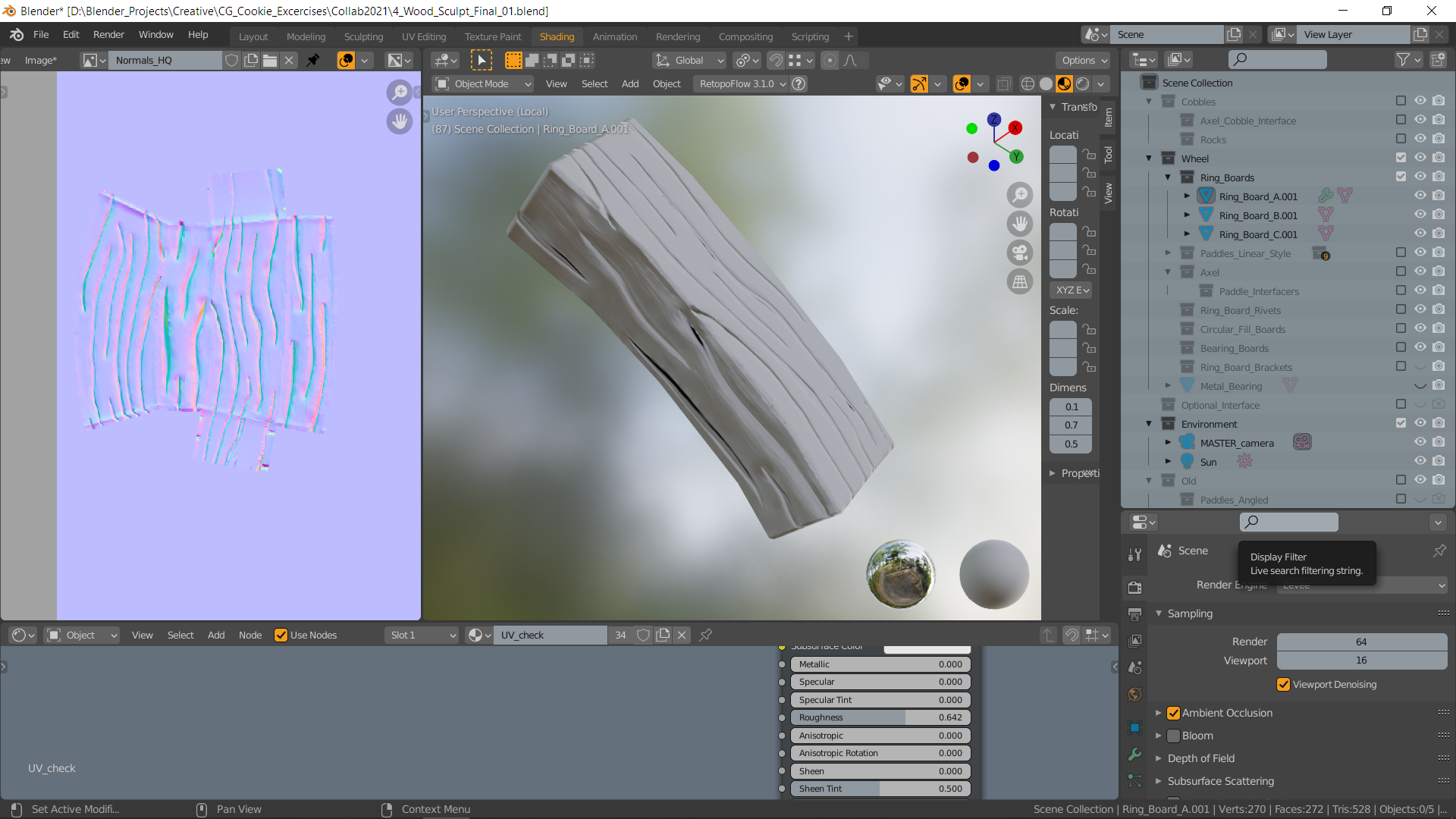

                  @theluthier @lucky Well now I can’t figure out how to get multires to smooth UVs. I did it somehow ONCE, and now it refuses to do it. Is there something special you have to do in order to get the UVs to smooth with the modifier?

                      @lucky The deformation stretched at 2 of the seams. Earlier I clicked through the smooth UV options on the Multires modifier, and it was responsive, and fixed the issue. So I was jazzed and decided to sculpt a bit more. Reloaded back to the file where I hadn’t changed anything, sculpted, and baked, and I can’t get it to work again.

                          @lucky im not exactly sure why its warping those two spots. It’s just frustrating because i definitely toggled those settings and it changed my bakes. But now its not changing the bakes. Which is mystifying. I probably just need sleep.

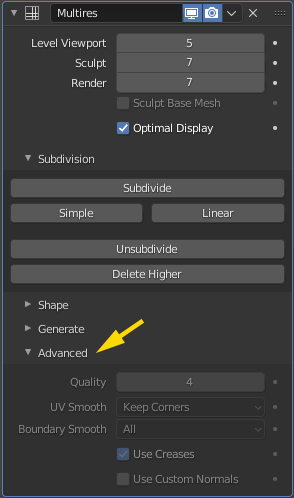

                            @lexicolopolis Look in the advanced tab of the multires modifier:
                            *I believe the settings are greyed out if no UVs are created.

                              @lucky Ok I figured it out.  In 2.92 i think theyre defaulted on anyway.  But you have to have view to 1 for them to do anything.  Was baking at 0 view.

                                  @theluthier They’re actually just always greyed out for me if I have a subdivision. Even if they’re working. And you can change them while they’re greyed out. It’s bizarre. They also apparently removed the option to toggle between simple and catmull-clark with 2.92. But from what I’ve read multires in Blender has been a pretty big mess until recently. So this chaos doesn’t surprise me.
                                  But the problem was just that view has to be 1 not 0, or the smoothing settings don’t get used.
