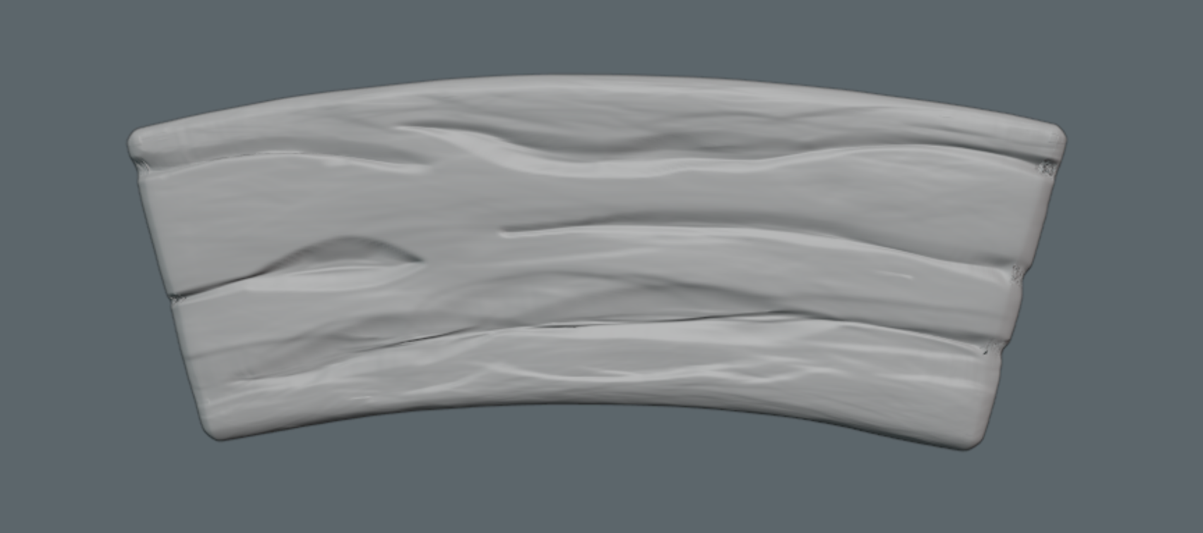

        @lucky It’s funny, I shifted directions again. But I feel really good about where I am. I’ve been doing this all wrong and I wish someone would’ve stated what I now think is  the obvious solution. I needed to take my low poly objects and just model in the cracks and larger details and give them bevels. And then sculpt. The style sheet makes it pretty clear that all of the wood details are done that way. I think I realized this a long time ago but then forgot about it.

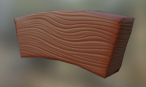

            WOW. @lexicolopolis Your thread only gets more epic each week! So interesting to see you get caught up on various styles of sculpted wood…all of which I kinda like 😅
            I’m with Spikey that this is probably my favorite:
            Though I really like this as well:
            A mix of both would be incredible. BUT you’ve done so much work here that I assume you’ve saved versions of each one and I say go with the grey one above 👍
            Keep up the amazing work. I gotta give you some extra points for the effort and dedication to style interpretation. A supervisor would LOVE to have options like this to choose from.

              Finally figured out how to do what I wanted to do, and made some good progress. Just a few things left to remodel. Then I can use a mask to add wood grain. And finally be done with sculpting. Oof.

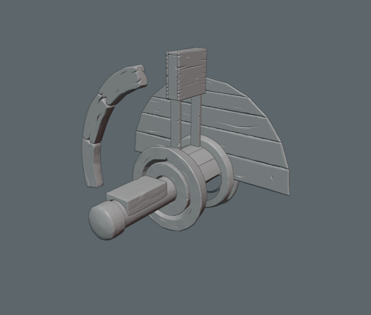

                      Everything is baked except the ring boards, which need to be completely redone cause they look like hot garbage.
                      Possibly restack stones, combine and lattice them.

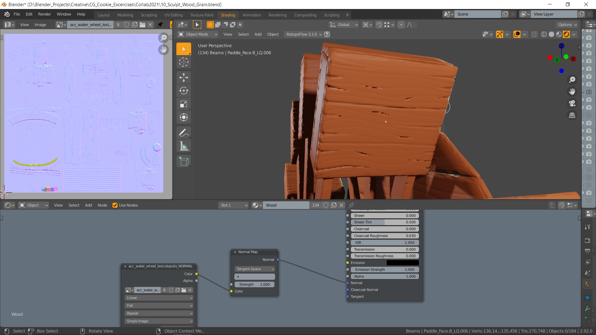

                      I hope this looks better with a coat of paint and proper materials. I’ve always struggled making things look decent in Eevee. Autosmoothing on? Autosmoothing off? I don’t know what to do with these normal maps to make them look decent. Hahah

                          I feel like I started to get the hang of sculpting this kind of stuff toward the end.
                          But as normal maps, none of it looks that great. Eevee’s render engine seem to accentuate pixelation that isn’t visible in viewport. My lack of experience using normal maps probably has me expecting to pull too much out of them with too little geometry, and too little texture space.

                            @lucky Specifically, all the cracks in the wood look fine as sculpts, but when rendered as normal maps they all seem to pucker.
                            But you can tell, there’s just too few pixels. And my UVs are pretty crammed in.

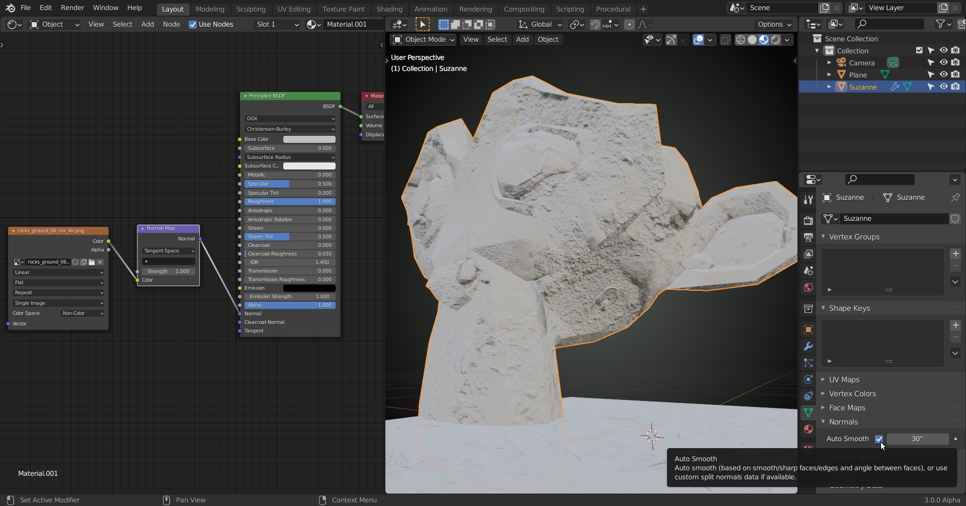

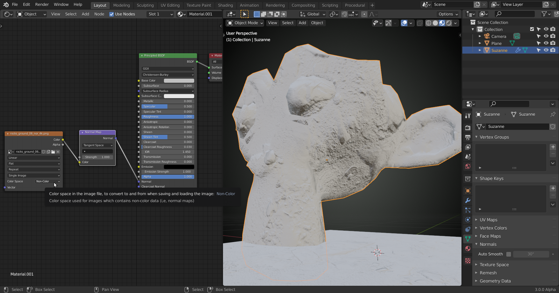

                                Autosmoothing has not really anything to do with the Normal Map…

                                  @spikeyxxx   Not literally, but certainly in effect.  If you’re taking an object that is inherantly more smooth because its been sculpted,  and applying its normals to a low poly mesh, attempting to hold those low poly edges sharp is going to fight those smoothed  details. So that’s all I was pondering.
