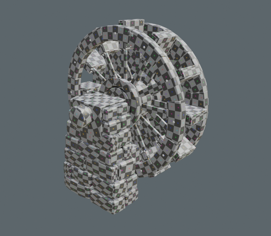

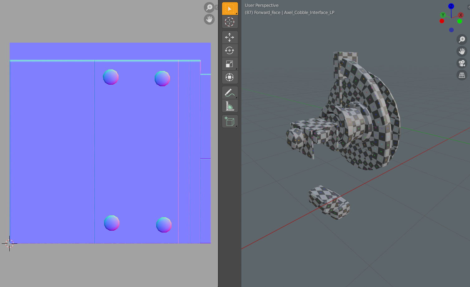

            Beau Kromberg
              Set up UVs and VERY slowly figured out how to bake normals again without skewing. Also made a bunch of nails, bolts, brackets, etc to bake into places. I wanted to set up all my cages and make sure that each one bakes the extra geometry properly before moving on to sculpting anything.

              Carlo
                Looking good, baking normal maps can be tricky. I would first do the sculpting and after that finalize the low poly model because you may have to change it after the sculpting. And then you would have to redo your UV’s.

                    Mona Loren
                      Very nice progress. I was also thinking about which workflow is right and the best.
                      Do you bake the normals with cages? Interesting, haven´t done this often so far. In the past (Blender Version 2.4.xxx) I´ve done some normal maps, but havent done much since version 2.8.
                      Normally I made the UV`s before the High-Poy Mesh. That works well with small objects, not so detailliert one and rather low poly. Sometimes I run into the problem to have to redone the UV`s, because of some changes I made.
                      It is possible to copy UV over, little bit tricky and I can´t explained the workflow anymore- sophisticated 😉

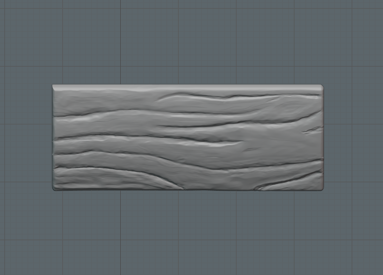

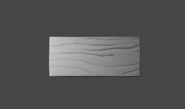

                              Beau Kromberg
                                First stylized wood sculpt attempt. I think I have a technique down now. I made kind of a mess of the plank during my hours of experimenting, so I’ll probably scrap this and start over with what I figured out. But I think from this point I’ll be able to make my wood parts a bit quicker and consistent across their topology.

                                Beau Kromberg
                                  @lucky Actually, I’m surprised. Multires worked without any extra help. I tried it earlier and it didn’t bake well at all. Need to work on my sculpting still. hahah
