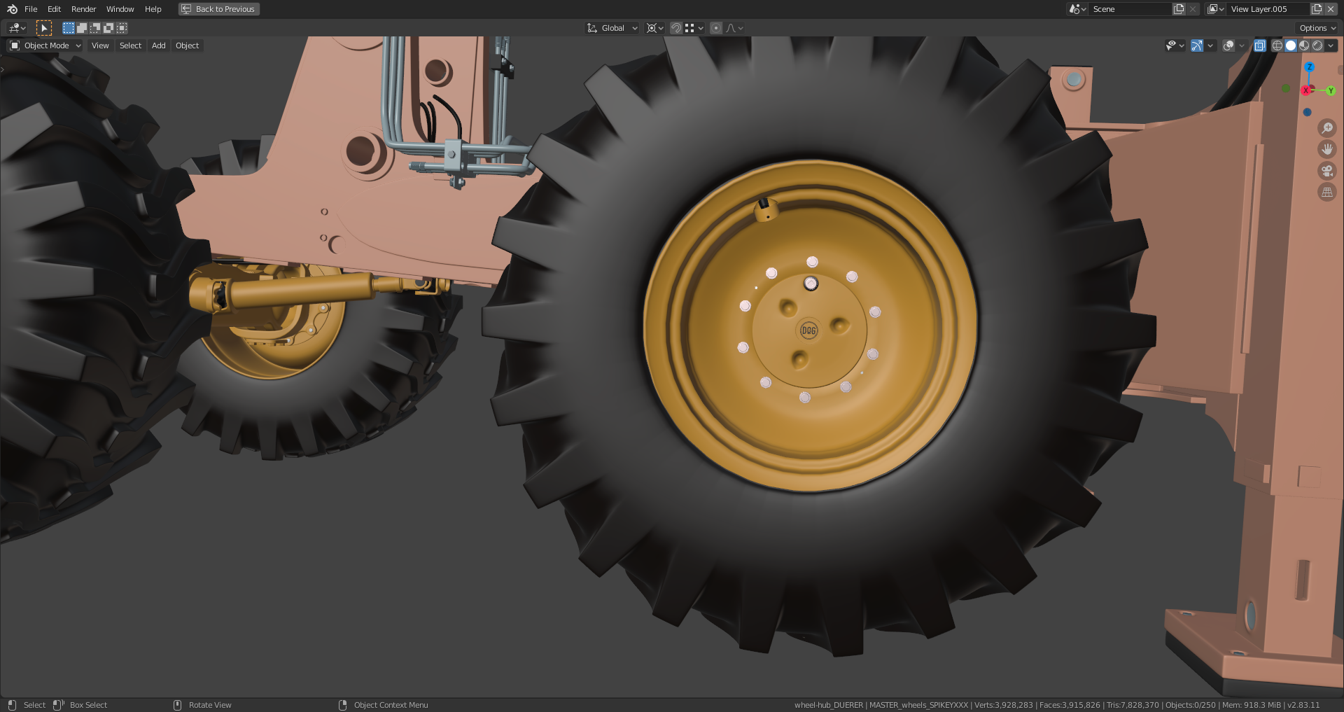

      Ok, I’ve updated my rear axle file on Google Drive. The connection to the front has to be readjusted since I had to recenter my axle properly between the tires:
      And the front rims and hubs at the rear axle have to be hidden:
      So that it looks like this:
      Some fineadjustment of the rims to the tires is still necessary as well as some smoothing in the areas of stretching:

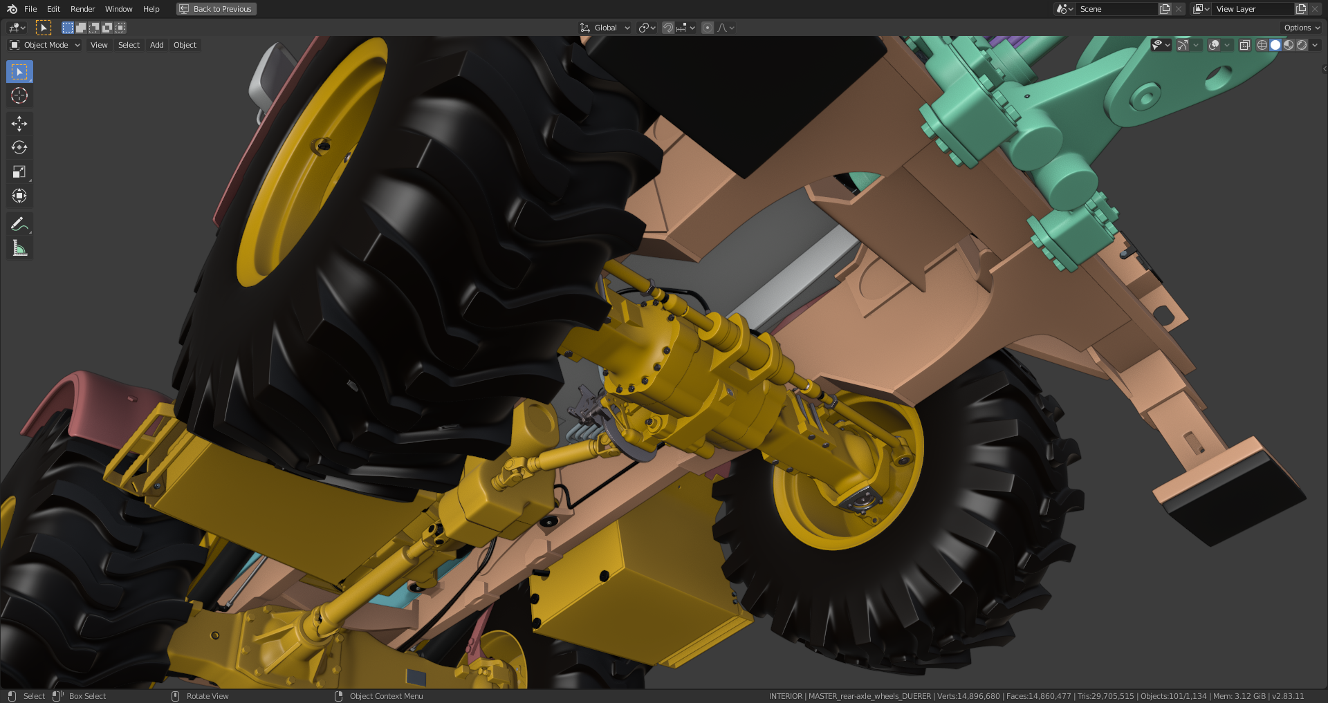

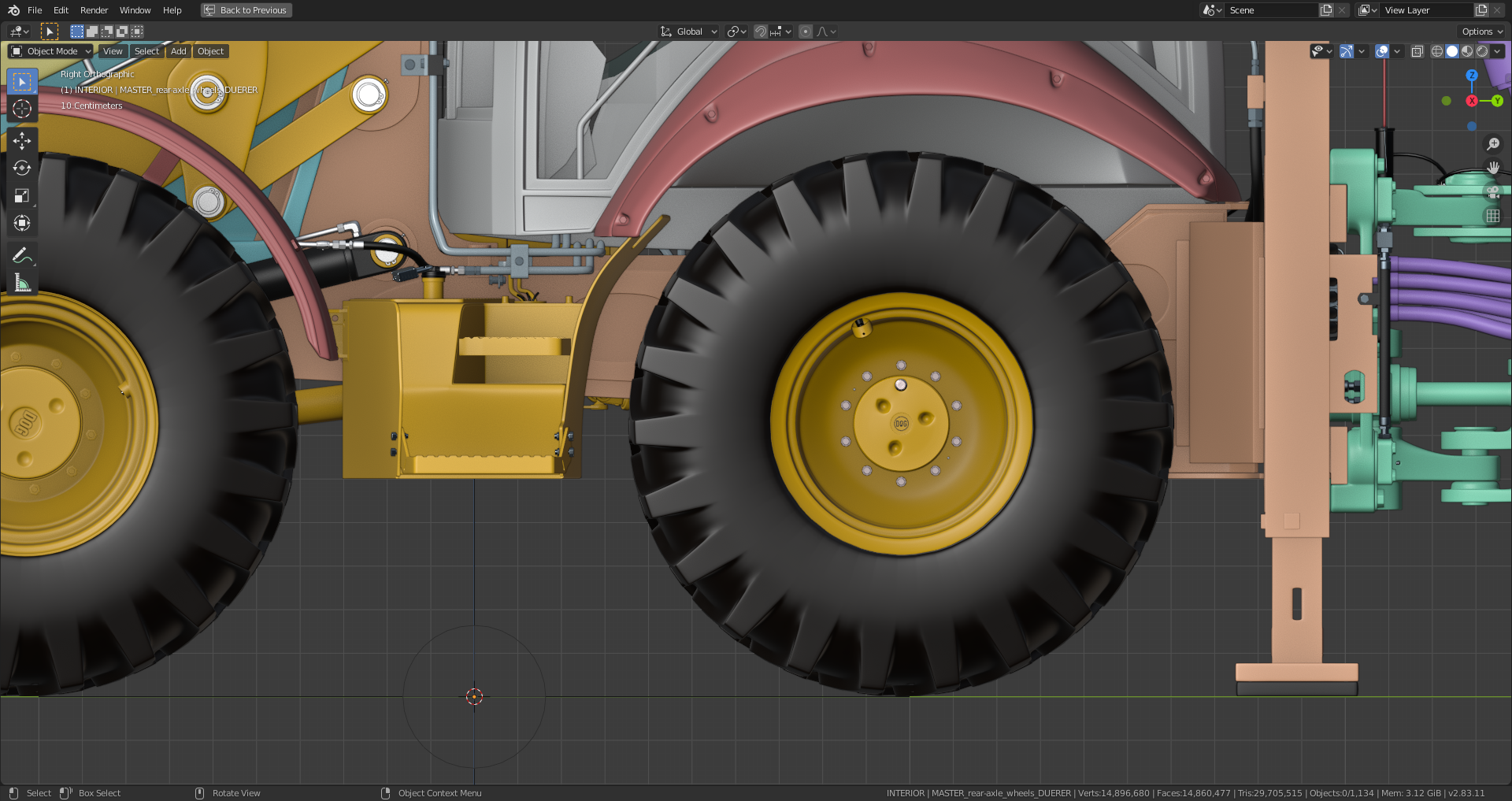

                Ok, the rear axle is now aligned to the tires:
                The new file is now on Google Drive.

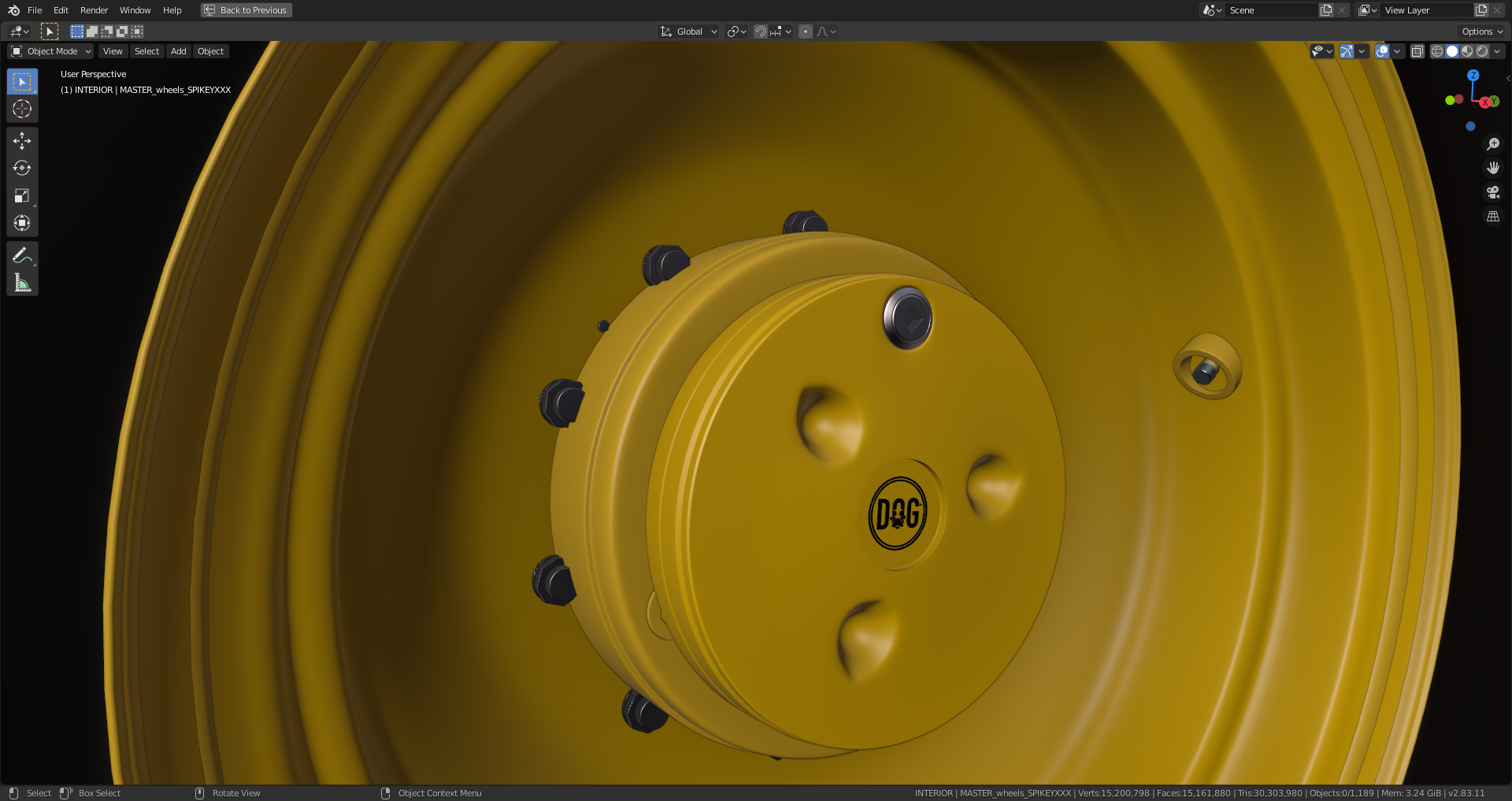

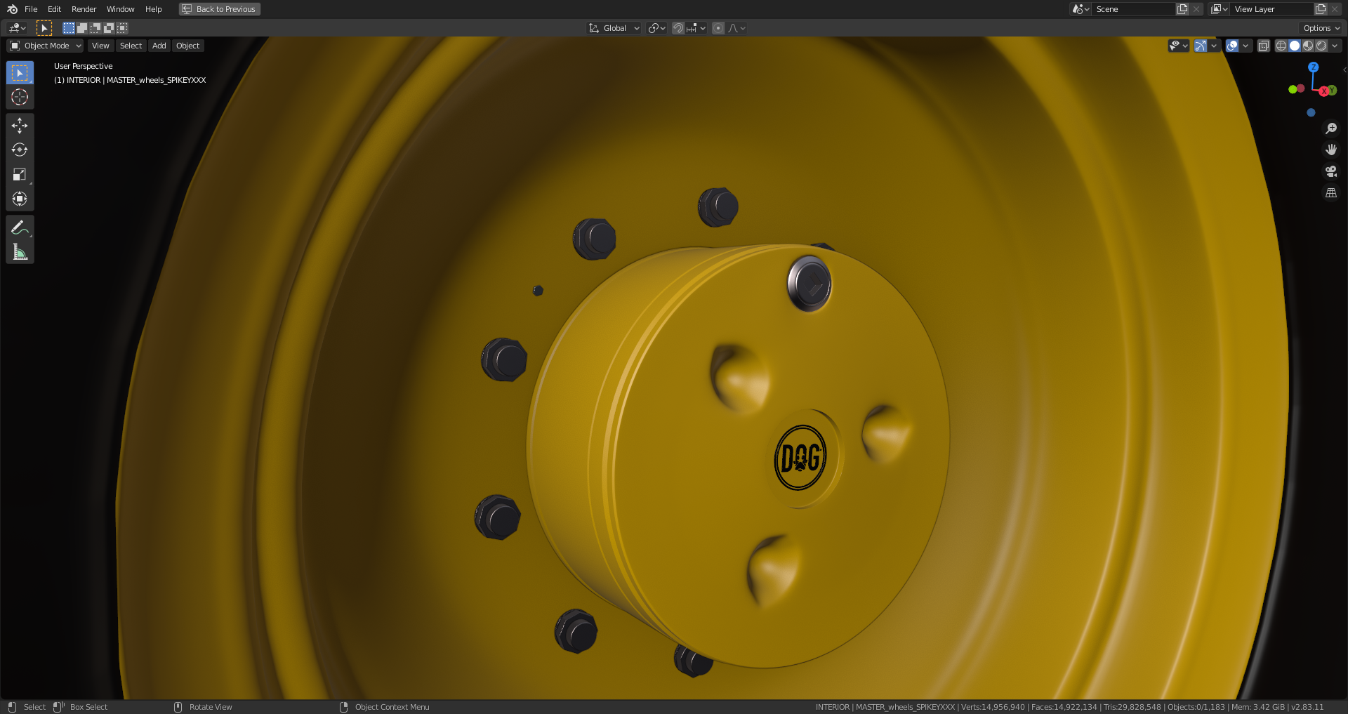

                                @theluthier The intersections you mentioned in your backhoe livestream (part 7) are simply caused by duplicates of the front axle’s hubs and rims:
                                These front axle parts (including the valves and the “Dog” logos) need to be hidden on my rear axle so that you get this view:
