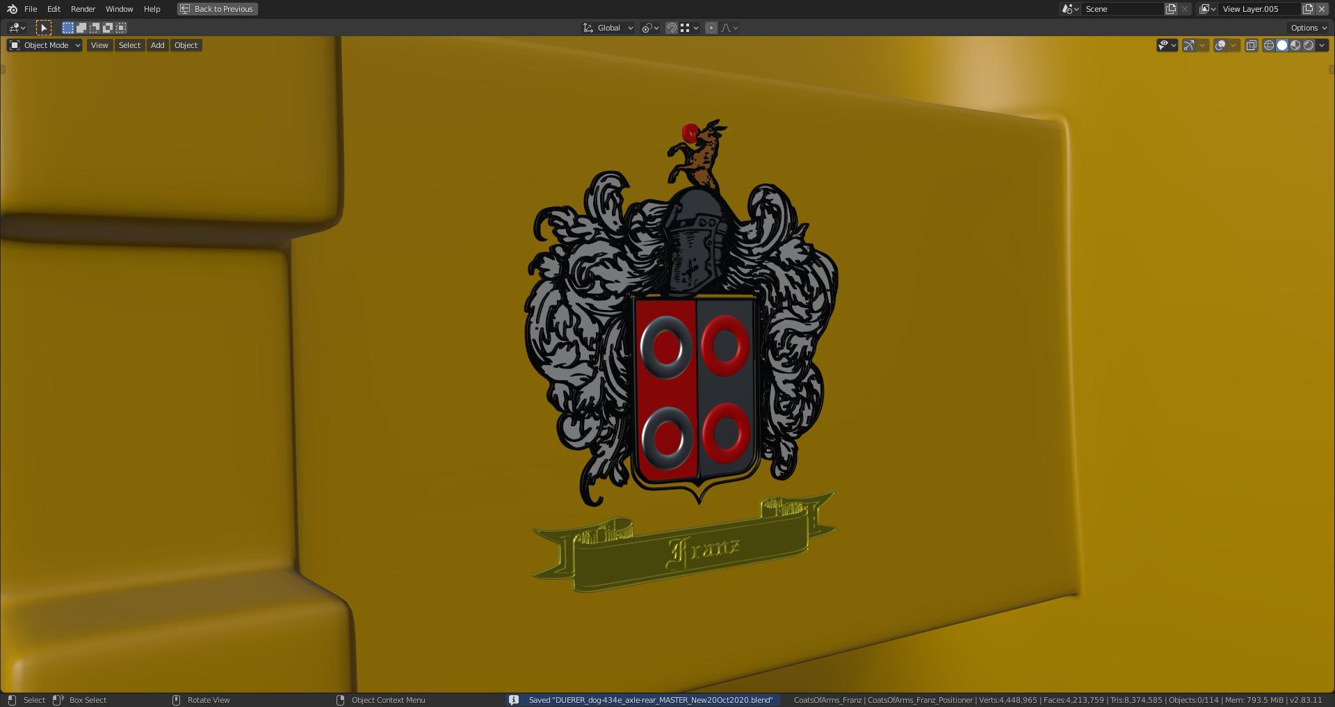

      @duerer Are those black outlines…modeled by hand? 😳
      #58231
        @theluthier I have traced a scan of that coat of arms in Inkscape:
        I’ve imported it as SVG file into Blender where I’ve extruded the curves for the feathers. The rings on the shield and the scroll with my family name are modeled as meshes, the scroll by conversion of the path into a mesh with some final editing (all quads for training purposes 😉).
        #58232
          @theluthier, @adrian2301 and @blanchsb I’ve uploaded a newer version of my part’s file with the complete coat of arms correctly colored:
          PS: Saved with Blender 2.83.11 😉!

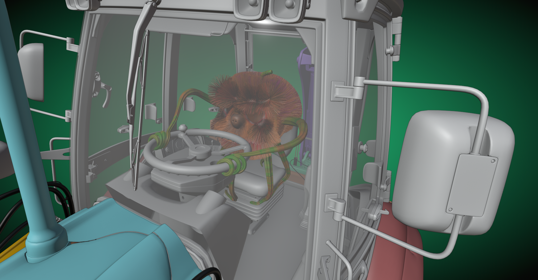

            #58234
              And a special “Halloween Edition” of my rear axle starring “Werewolf Pete”:

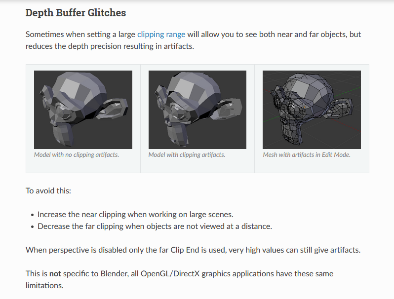

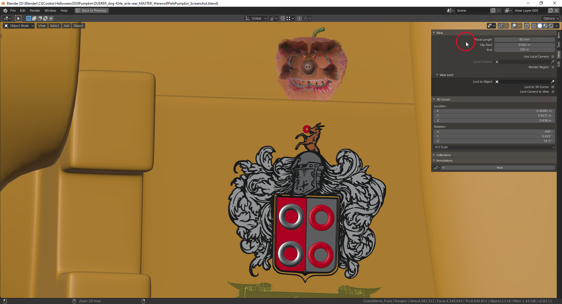

                  I’ve just found out that setting “View Clip Start” to 100 m  avoids any z-fighting between the coat of arms and the rear axle in the “3D Viewport’s” “Solid Viewport Shading Mode”:
                  That’s what the “Blender 2.90 Manual” also mentions here:
                  “A large clipping range will allow you to see both near and far objects, but reduces the depth precision resulting in artifacts.
                  In some cases, a very large range may cause operations that depend on the depth buffer to become unreliable although this depends on the graphics card and drivers.”
                  And the solution here:
                  I hope that this won’t be a problem with the final rendering.
                  PS: Interesting footnote: With “Orthographic View” the “View Clipping Start” is ignored as you can read here:
                  “Orthographic view:
                  The planes with distance of negative end and positive end from the focus point, in this case the Start is ignored. “
                  #58237
                    This has to do with the precision of floating point calculations in a computer; you can (simplified ) think of it like this: when you have a precision of 5 digits,  then in a range of 100 meters, you’d be able to see the difference between 5 and 6 mm, for instance. But in a range of 100 km, you only be able to differentiate between meters…
