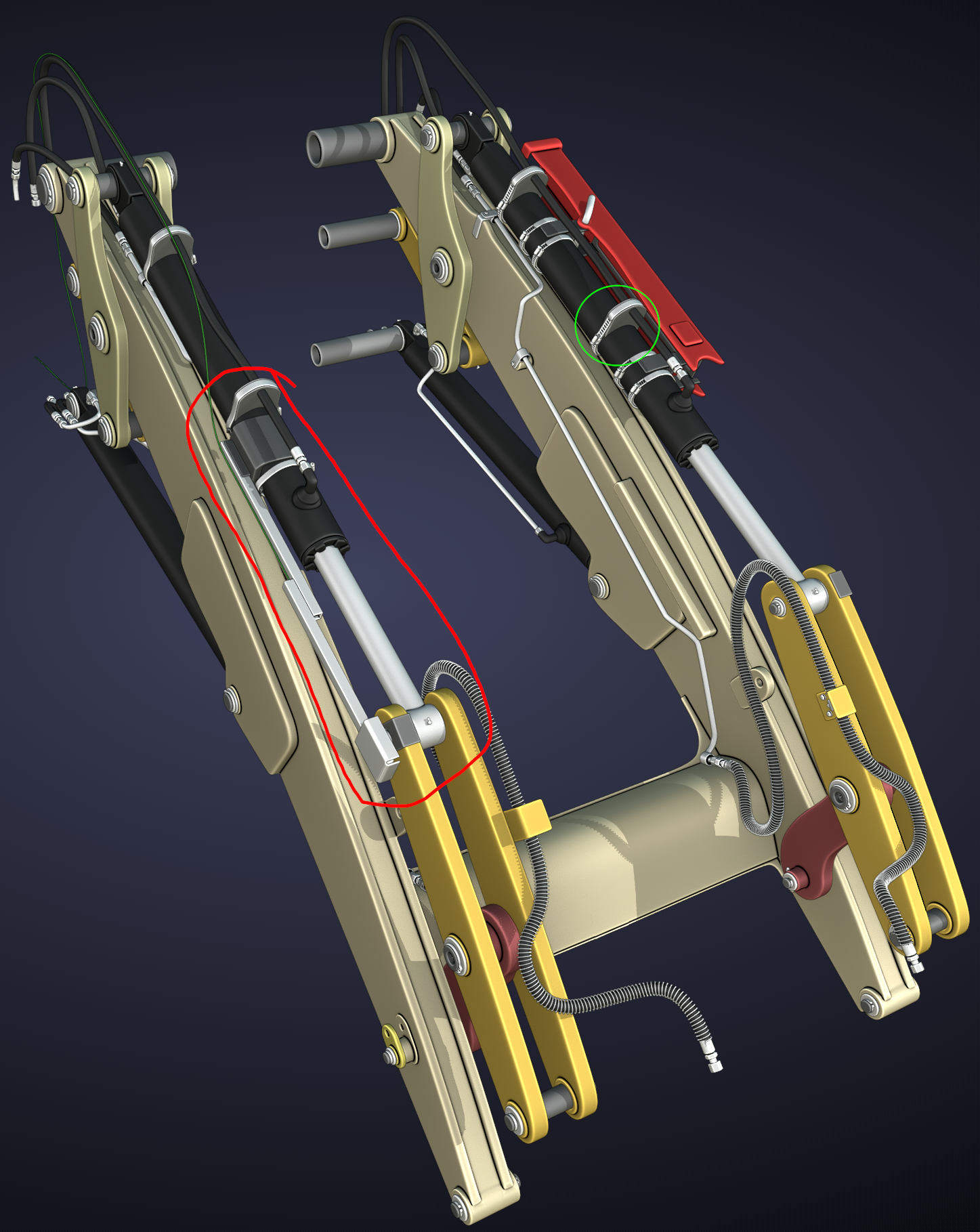

                  I didn’t get as much done as I wanted today but I did finish all of my hyd_piston connections finally. The feed versus return fittings were quite different. One is an actual fitting and the other is welded to the piston. Made for a unique look though.
                  you can see them on the bottom lift piston cylinder housing. All of my tubing has connections now. Yay! I just need to model in some supports and then the level sensor on the right upper piston housing. It’s a shame that piece ins’t more eye appealing. I feel like it will make my assembly look bad but the reference dictates it to be ugly haha. Coming soon.

                    Got some more of the hydraulic hose supports completed, which I am quite happy about. Still not done with the ugly stick, gotta work on sensor pieces tomorrow, but I should finish the modeling side this weekend, huzzah! It is finally starting to look a little more A-symmetrical, which helps keep the eyes moving around.

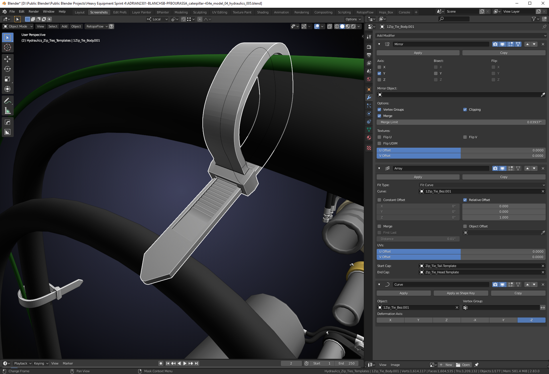

                        I made some zip ties tonight for the electrical connector. Using mainly an array modifier with a Start and End Cap and then attached it to a bezier curve. I actually got the dimensions from a zip ties bundle being sold from amazon. They had a couple of pictures of calipers on them and dimensions called out. Is it sad I am geeking out on zip ties??? Lol.
                        They don’t do a whole heck of a lot and they need a few holding edges but the proof of concept is there. Makes it super easy to tighten them too which is a nice touch. They actually act kinda like zip ties!

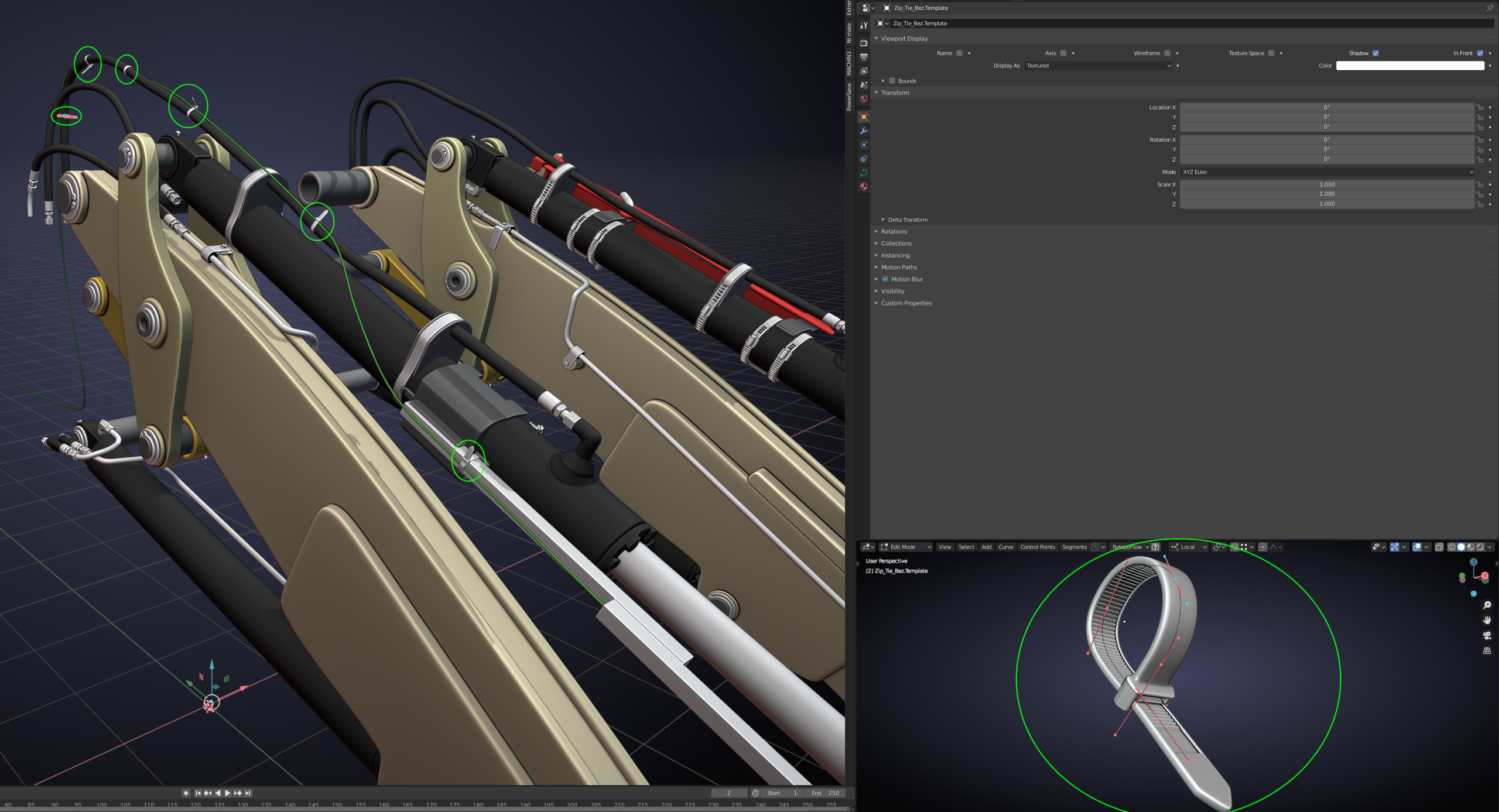

                        Shawn Blanch
                          Weekend work completed.

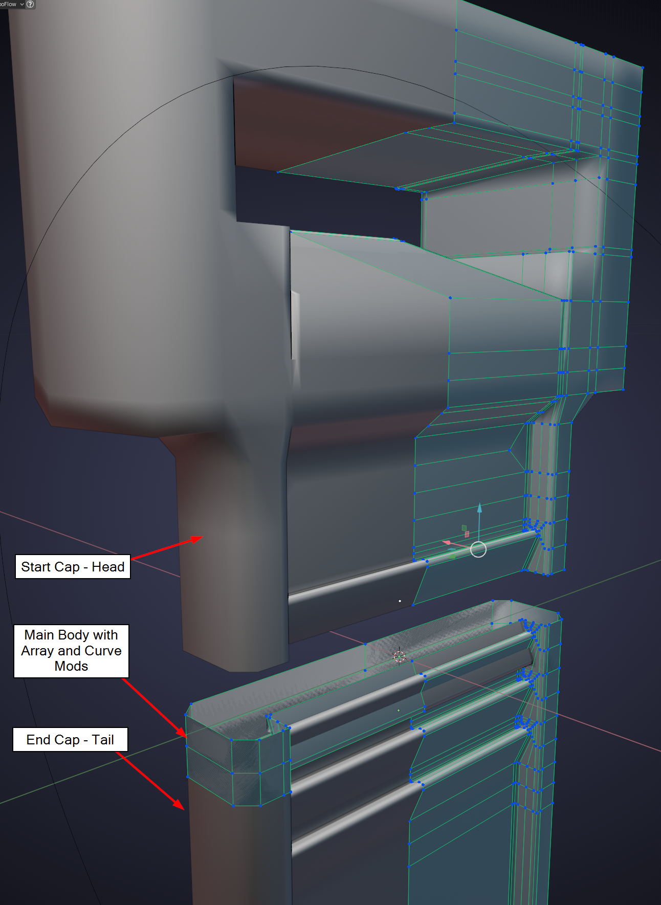

                          Now granted the zip ties don’t really appear completely in the references but I am not overly comfortable doing cloth style wire covers yet, and that is zip tied to the hydraulic hoses. So I am zip-tying the wire to the hose for now and taking my artistic liberty to do so. I cleaned up the topology on the zip tie and made it so that the head and tail for the array modifier all mesh together well and take a sub-d modifier like a champ. I have more edge loops than I wanted but I got enough done to get it looking good because of all of the teeth and clip detail.

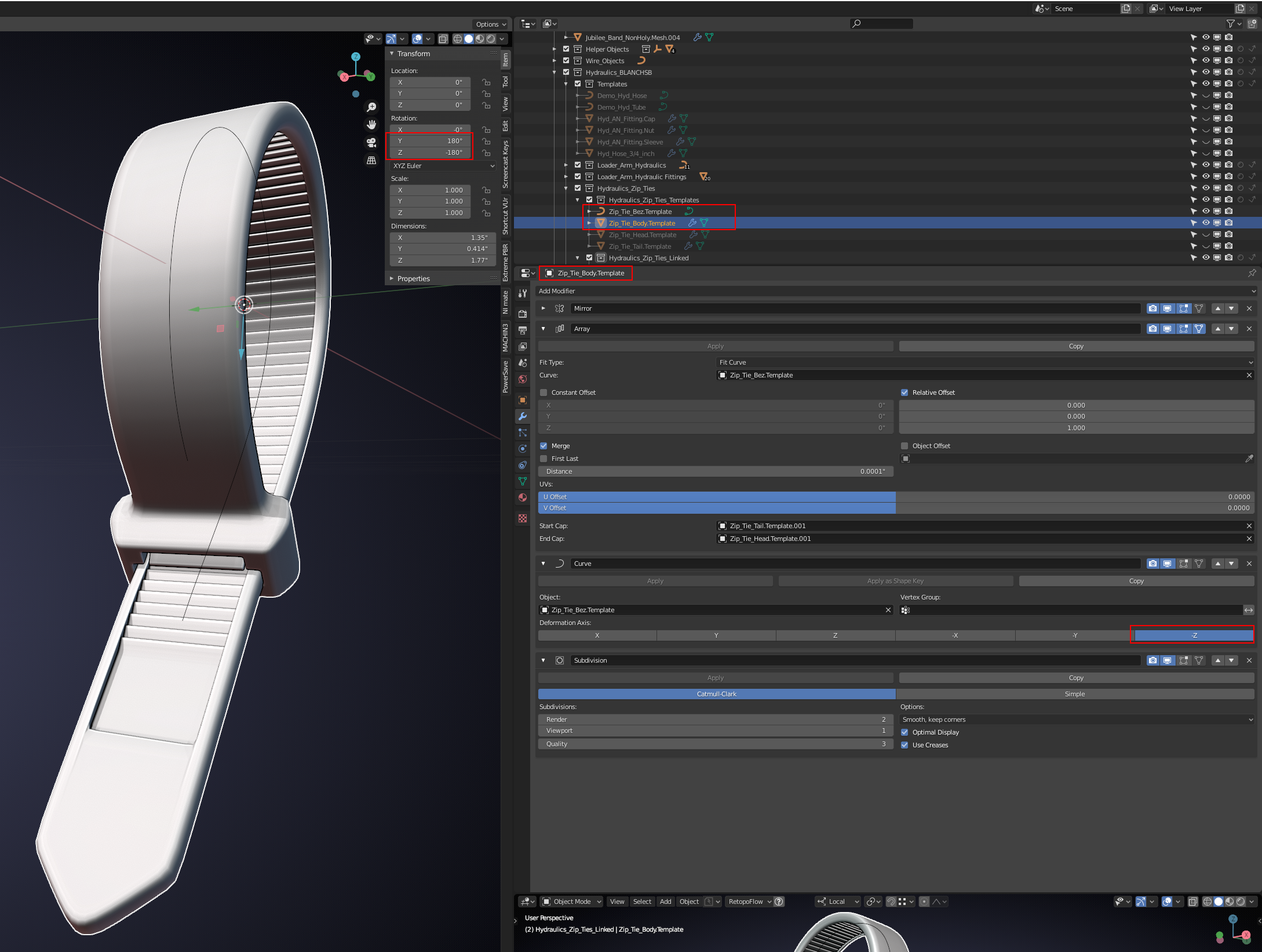

                          Then I plastered them all over the wire. I had a couple of interesting issues with the curve modifier. I could not get the zip tie to immediately follow the curve like it should have on the Z axis until I rotated the zip tie in object mode by -180 on the Y and Z axis. The it followed the curve exactly how I envisioned it? I guess I want to know what I am doing wrong for next time. It works but the transform must that that way for the zip tie mesh in order for it to follow.
                          Another thing. As long as I move the curve and mesh together while in object mode I don’t have to worry about it coming unglued from the curve. Is this the way I should be doing it?
                          Final picture of zip tie work: Each one is following a unique curve.

                            Hi Shawn, about the Curve Modifier, which can indeed give unexpected results:
                            To set this up correctly, you should make sure that the object’s Origin is at the Center of it’s Geometry and that it is at the same position as the Curve’s Origin. Let’s start with no rotations for both Object and Curve.
                            Now with a Curve Modifier, the Object should be at the start of the Curve and when you move the Object in the direction of the Deform Axis, then it follows the Curve like a train following the train tracks. That’s easy enough, right?
                            But the Deform Axis also positions the Object so, that the Objects (Local) Axis that is the same as the Deform Axis points in the direction of the Curve’s (Local) X-axis. As an example, when the Deform Axis is set to -Z, then when moving the Object in (Global) -Z direction, it will follow the Curve and the Object’s (Local) -Z-axis is pointing in the direction of the Curve’s (Local) X-axis…
                            A bit confusing, but still sort of understandable I hope.
                            Now, when you start rotating the Curve (in Object Mode) around it’s X-axis, then the Object also rotates along it’s (the Object’s!)  own (Local) X-axis. Similarly for the other axes…
                            Because the Curve was probably already rotated, the behavior would have been a complete mystery, especially if you are not aware of the above ‘rules’;)

                                 I can definitely do that @theluthier! I just need to re-read @spikeyxxx explanation above another 10 times so I can wrap my head around it before I pass on my bad habits using the curve modifier lol. Once I get it set up properly then I can do a nice little recording. I probably won’t re-make the entire zip tie but I can go over using the 3 pieces to get a decent looking final result that moves and behaves quite nicely.
