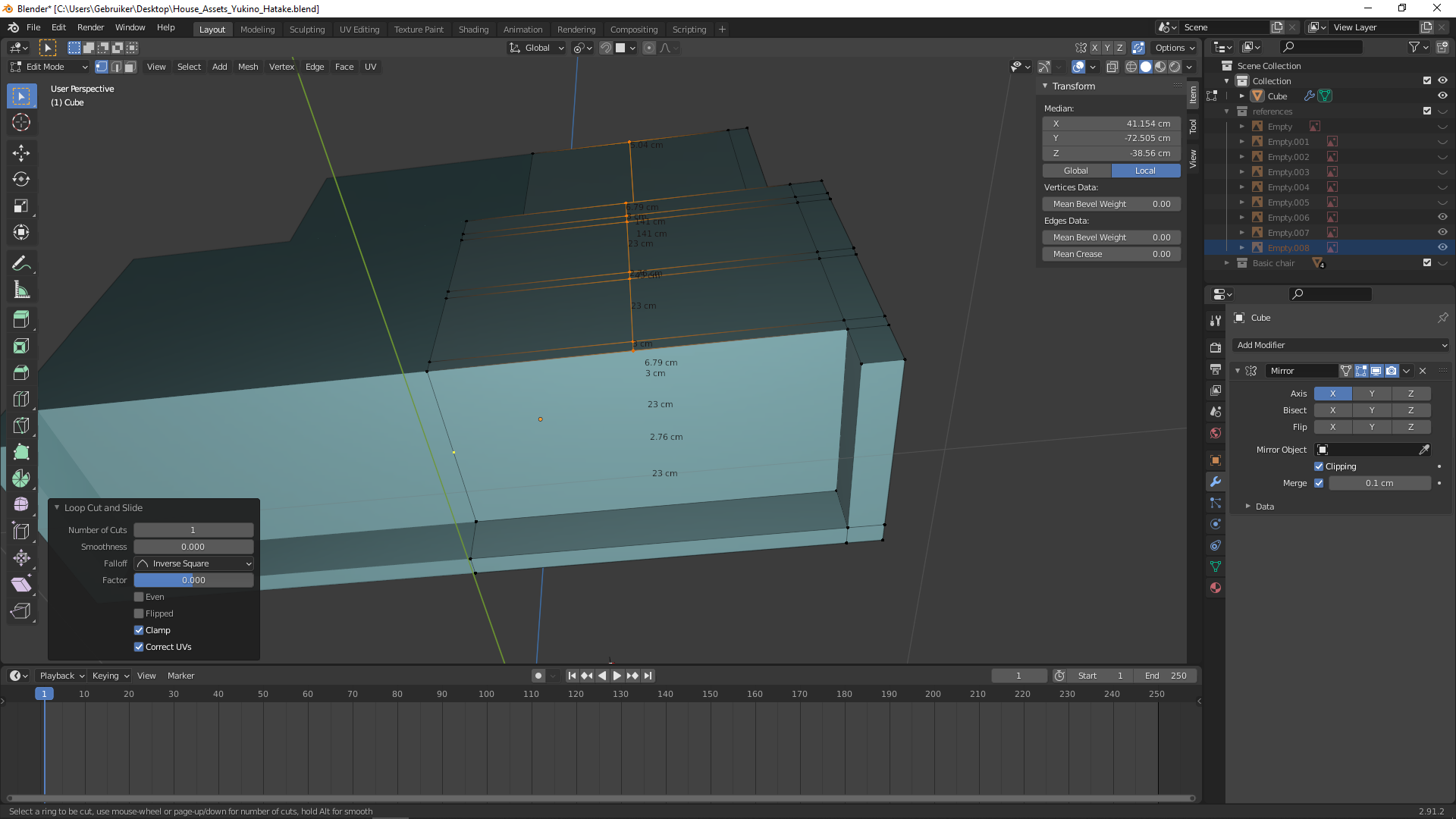

            question i am trying a kast (closhet but where you can put on tv or other stuff)
            when i make a loop cut it dont go trough all the way.
            anyone knows why that is ?
            you see the loop cut in goes troug the bottom same for the bottom in the middle when i do a loop cut he only place one vertici.
            its not a problem but i cant figure out what the cause is

                  Probably you have an interior face somewhere or two vertices one on top of the other that aren’t merged, look for Ngons as well.
                  I like to select a vertex and G to move it around and distort the mesh, it always reveals the problem.

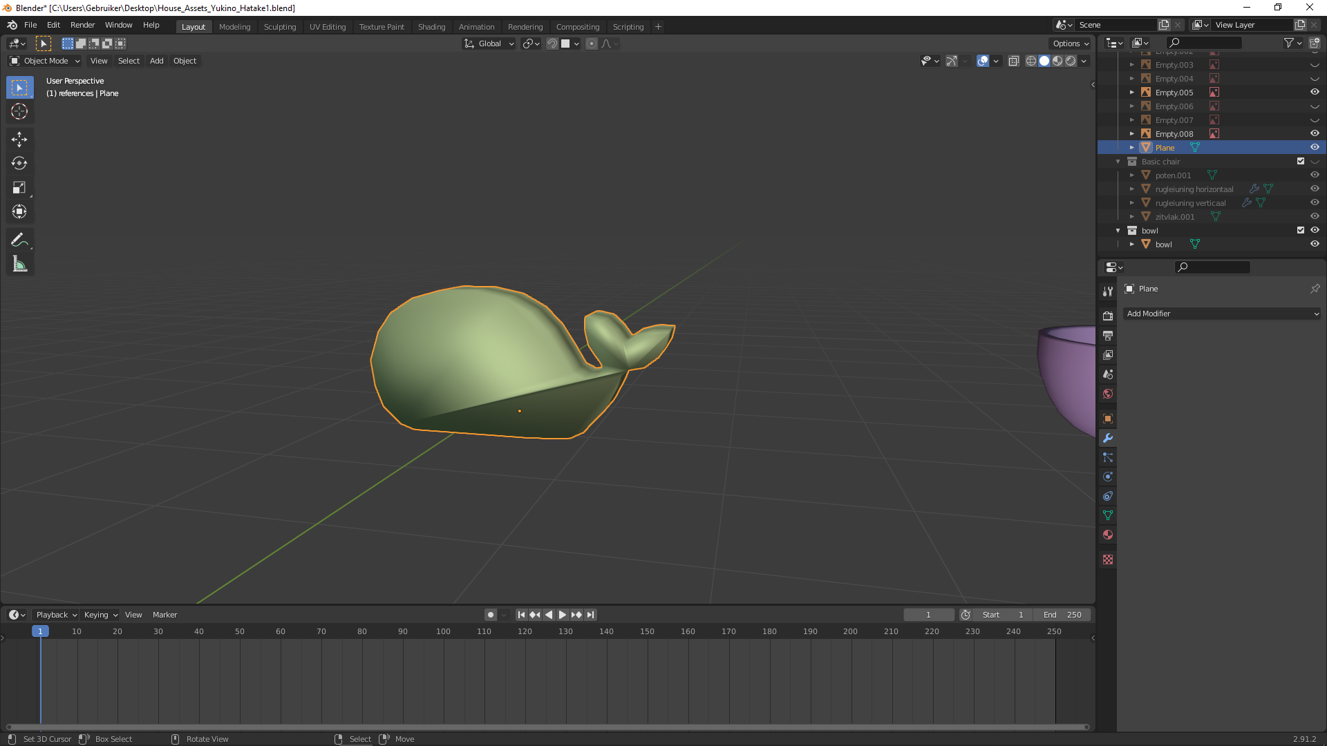

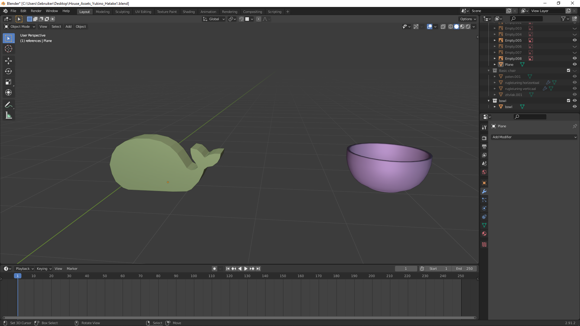

                    Modeled a bowl (could be a wooden bowl)
                    and a decoration whale 🙂 . i do have some troubles with the whale
                    this is how he looks when i turn on smooth shading

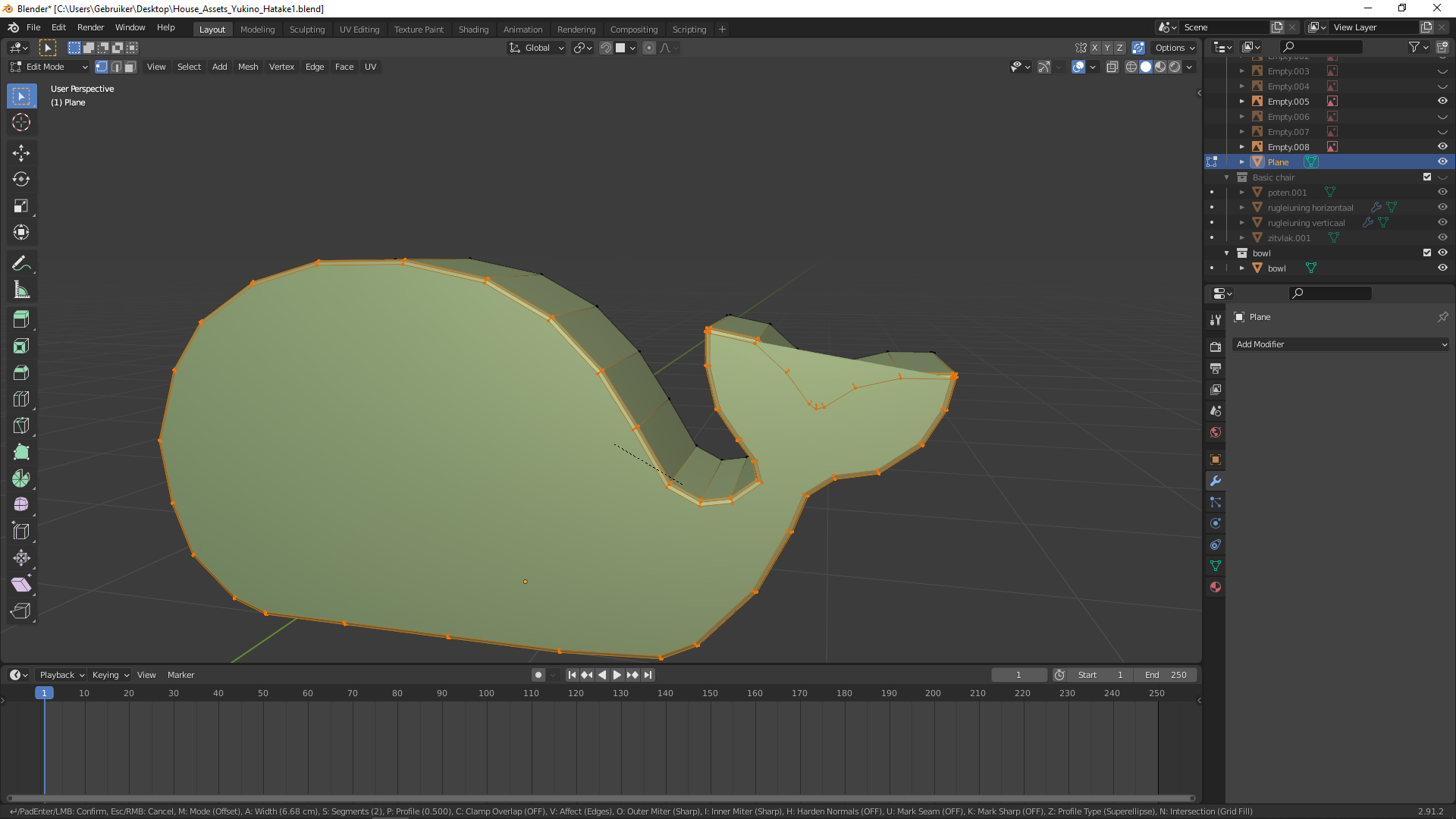

                    another problem when i try to bevel the edges
                    is this because the flat surface is made of one face ? i did this to keep it as low as i could

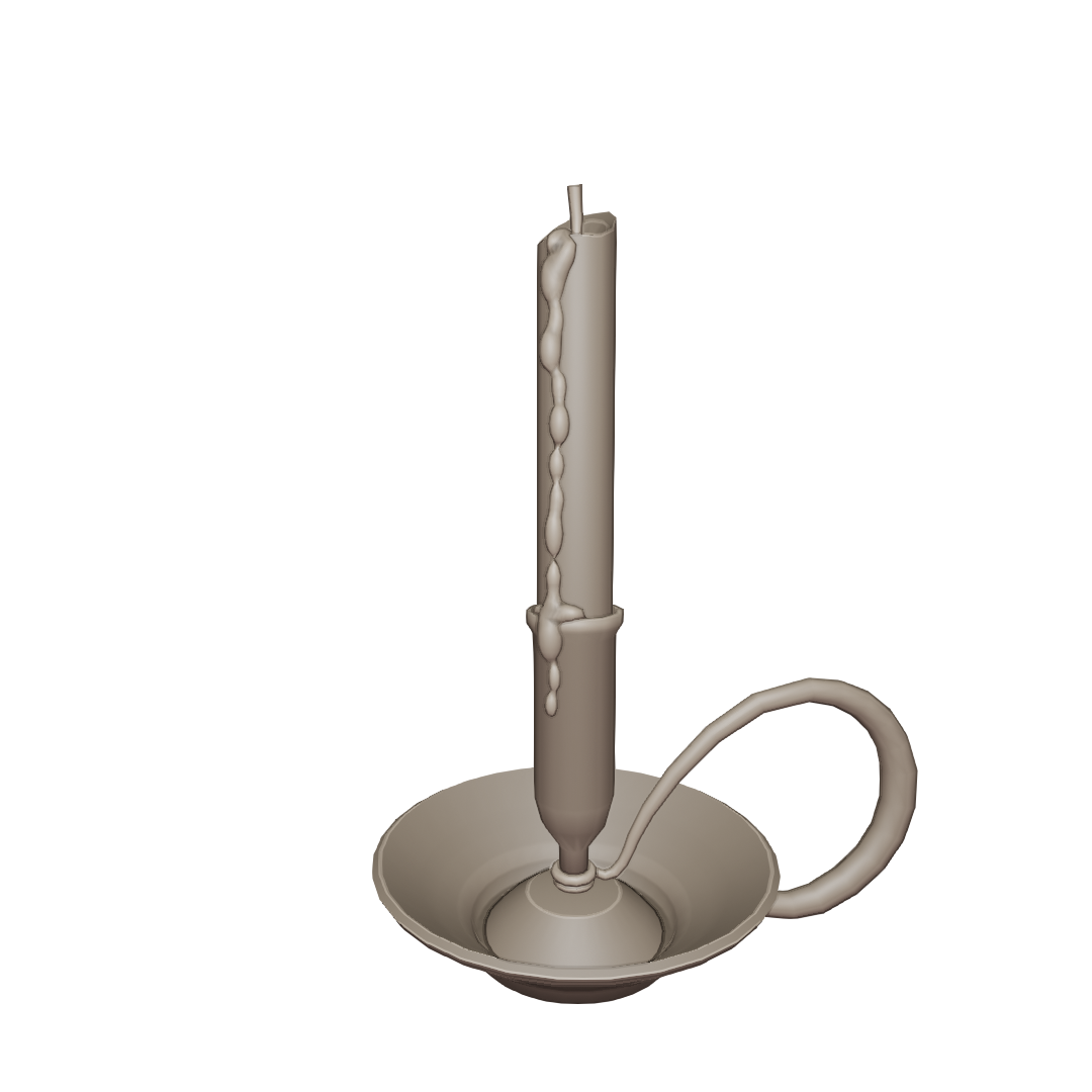

                            @ladymito I think  making the candles and the wax dripping is a really good idea! I had a quick go a modelling a candle holder and using Metaballs seemed to work pretty good for the dripping wax.

                              I guess you could try cutting that big face with the knife tool, make it into quads and tri’s – that might work better
                              #63874
                              yukino hatake
                                ok thanks , ill see how the it will work with the knife tool 🙂
