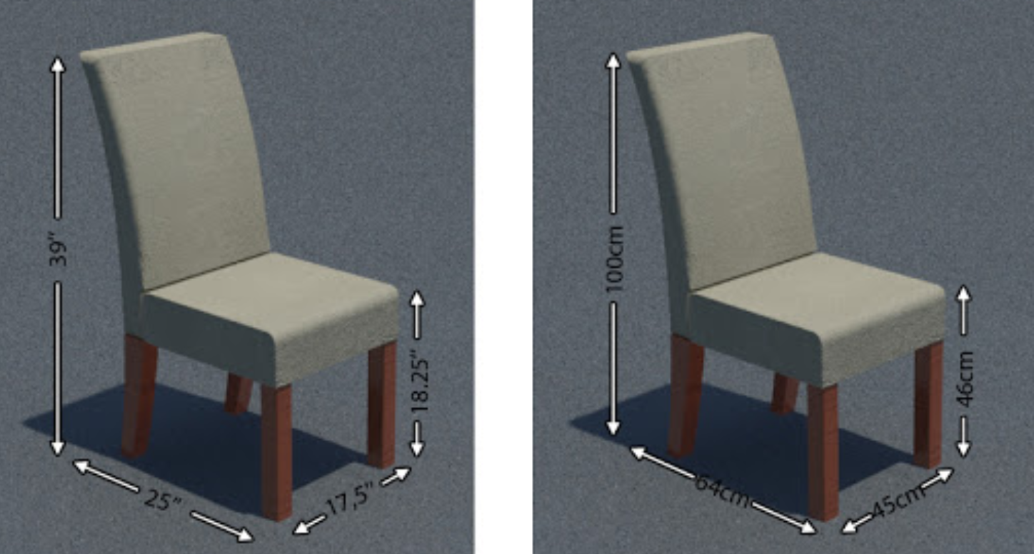

              You uploaded your .blend1 backup file, try having your normal .blend in the folder. Also in Edit -> Preferences, under Save & Load, I put “Save Version” to zero (0), so we don’t have the .blend1 and .blend2 cluttering up everything.
              Also you forgot to pack in the texture, at least it was like that in the .blend1. But I don’t know if that was what you were going for.
              In the IMAGES folder there’s an OBJECTS MEASUREMENTS folder. There you’ll find some images with real objects dimension that should guide us for working with good scale. I imagine with time that folder will grow.

                    yukino hatake
                      gonna make the changes, as for the dimensions of cm i guess it still can varry slightly but not extremely then ?
                      ill check out again how to see those sizes so i dont end up with a chair of 10 meters xD (otherwise the scene could be called Melvin in wonderland )

                              one more question , been looking a while now but i cant find the measurments option to enable and disable. i tought it would be at viewport overlay but guess not, been looking at several places but i no longer finds it . i use blender 2.91
                              #63814
                                @yukinoh1989 you are right, it is in the Overlays, but you need to be in Edit Mode to see it:
                                Alternatively, there is a Measurement Tool, that also works in Object Mode:
                                But I’ve never used that one myself.
                                #63815
                                yukino hatake
                                  Thank you once more, indeed the measure mode is not bad but its easyer with the measurement option enabled
