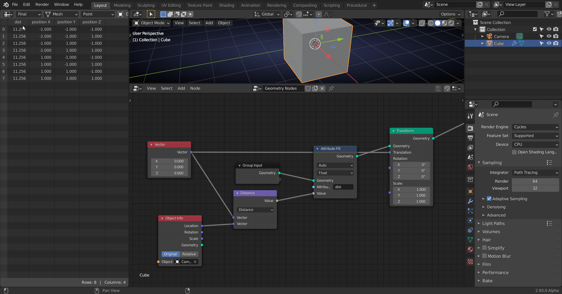

                  I did look at the Spreadsheet view.  I don’t believe that it’s functionality is what I was looking for.  I am looking for a way to view the output value of a Math node.  For example, as you camera zoom into the object, how do you know the value of the Math-Ceiling node going into the Ico Sphere’s subdivisions input?  Is it 0, 1, 2, etc. ?  The only way you would dial in the right values is by experimentation via changing the numerator in the Divide node.  I suspect that that is how you landed on the magical 10.3 value.  If the Spreadsheet View does indeed allow the monitoring of node outputs, I am not seeing it.

                            You need to use a trick for that:
                            Usually you are interested in Attribute values and Booleans, so here I just made one and that shows immediately in the Spreadsheet 😉
