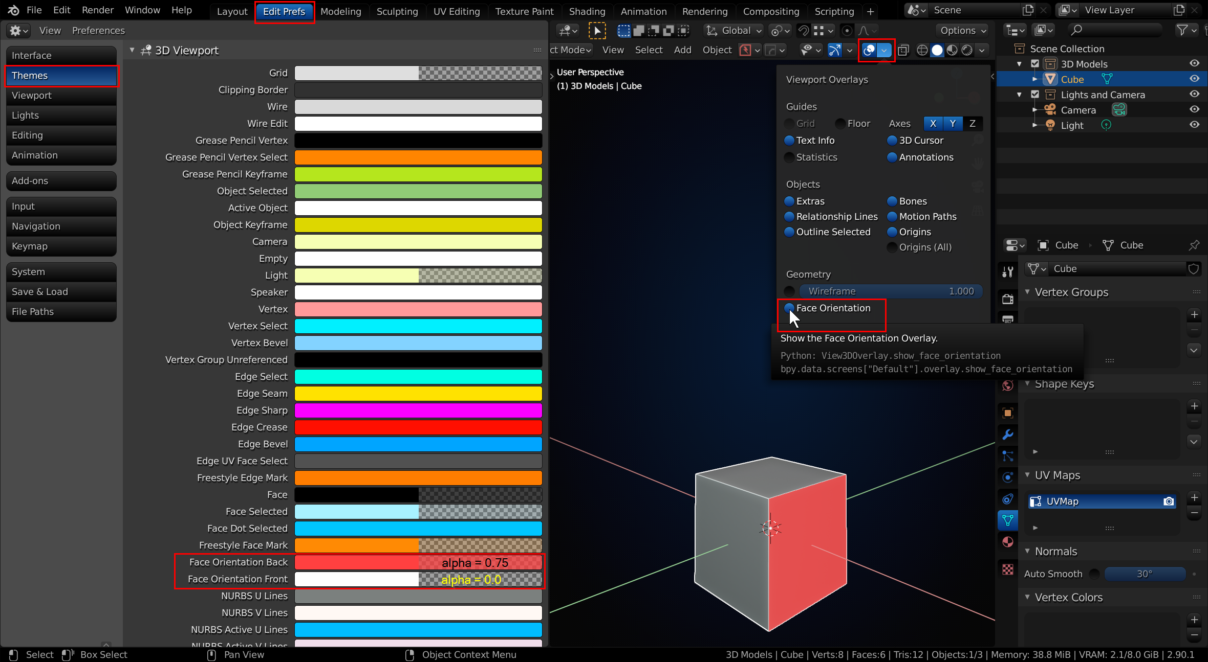

          Gold Nugget #2: Easy Flipped Normals View Setting (always on and only there when you need to know!)
          We’ve all been there. Working and plugging away on our beloved project. Then it comes time to add a Subdivision Surface modifier, or a bevel modifier and the cookie starts to crumble in our hands. After lots of troubleshooting and maybe a forum post or two we find that we have fallen victim to the ever elusive flipped normals! No longer will we be tricked thanks to this new treat! This one is actually credited to Josh Grambell from his video on his custom Blender Settings. Gold nugget #1 comes in handy for implementing Gold Nugget #2.
          Step 1. Open a new instance of Blender and start on a new file.
          Step 2. Go to your Edit Preferences and click on the Themes tab and open up the 3D Viewport section.
          Step 3. Find the Face Orientation Back and Face Orientation Front settings.
          Step 4. Set the alpha on the Face Orientation Front to 0.
          Step 5. Set the alpha and color on the Face Orientation Back to whatever you please. (I personally like a dark pink/red with 0.75 alpha).
          Step 6. Save the Preferences
          Step 7. In your 3D Viewport click on the Viewport Overlays and turn on the Face Orientation.
          Step 8. Click on the Layout workspace again and save the startup file by clicking File, then Defaults and then click Save Startup and confirm.
          Now anytime a normal flips without your permission you’ll know instantly and can flip it back with Shift + N.

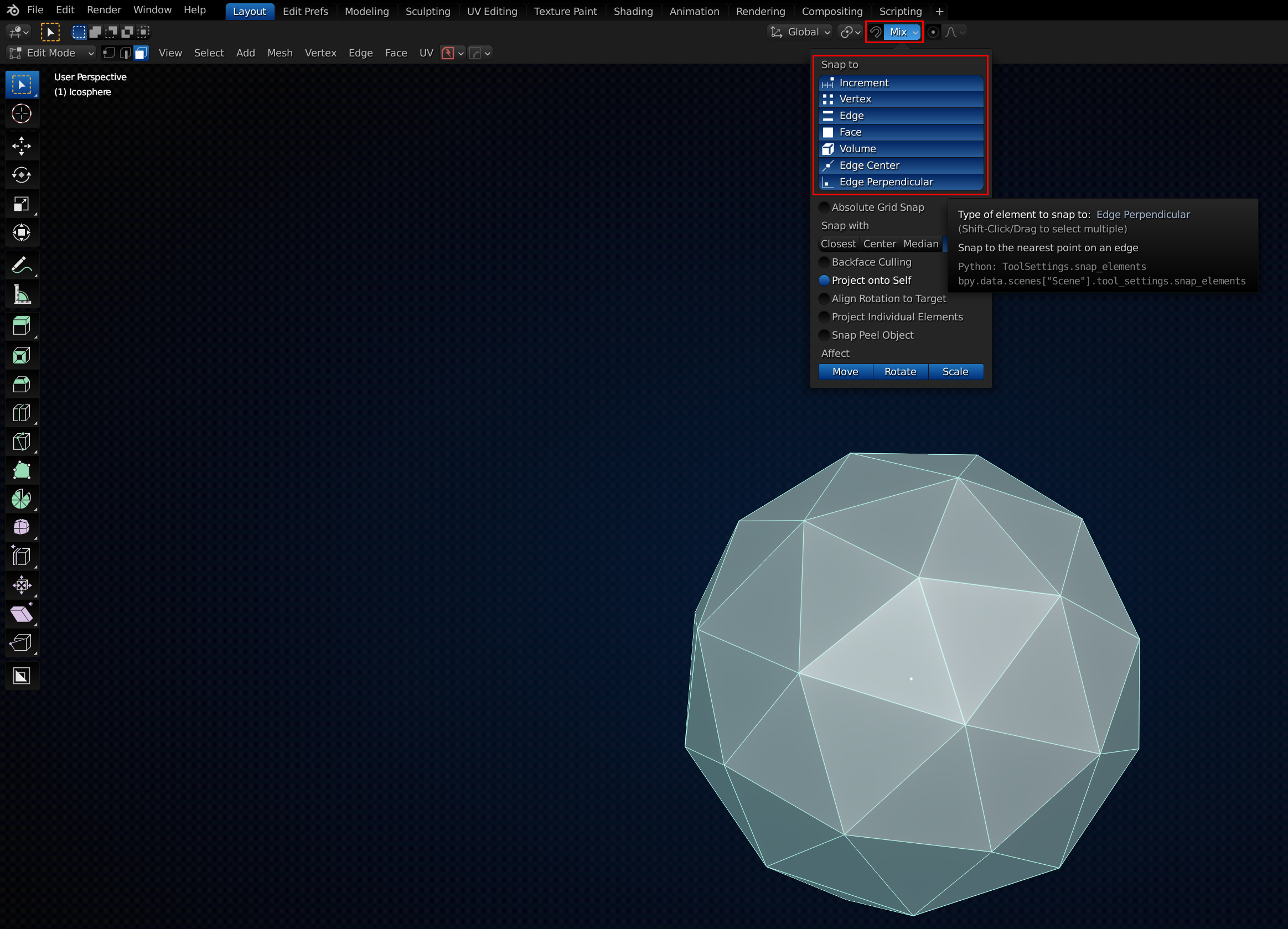

            Did you know you can shift select the selection method icons in the top right of the screen and have all methods available all the time instead of switching from one to another.
            All selected 👇
            #61237
            Shawn Blanch
              Yes that is super helpful!
              #61238
              Shawn Blanch
                Gold Nugget #4 Multiple Snapping Methods Active.
                This is a follow-up on gold nugget #3 from @adrian2301. You can have multiple snapping options enabled by shift selecting them in the Snapping Menu.

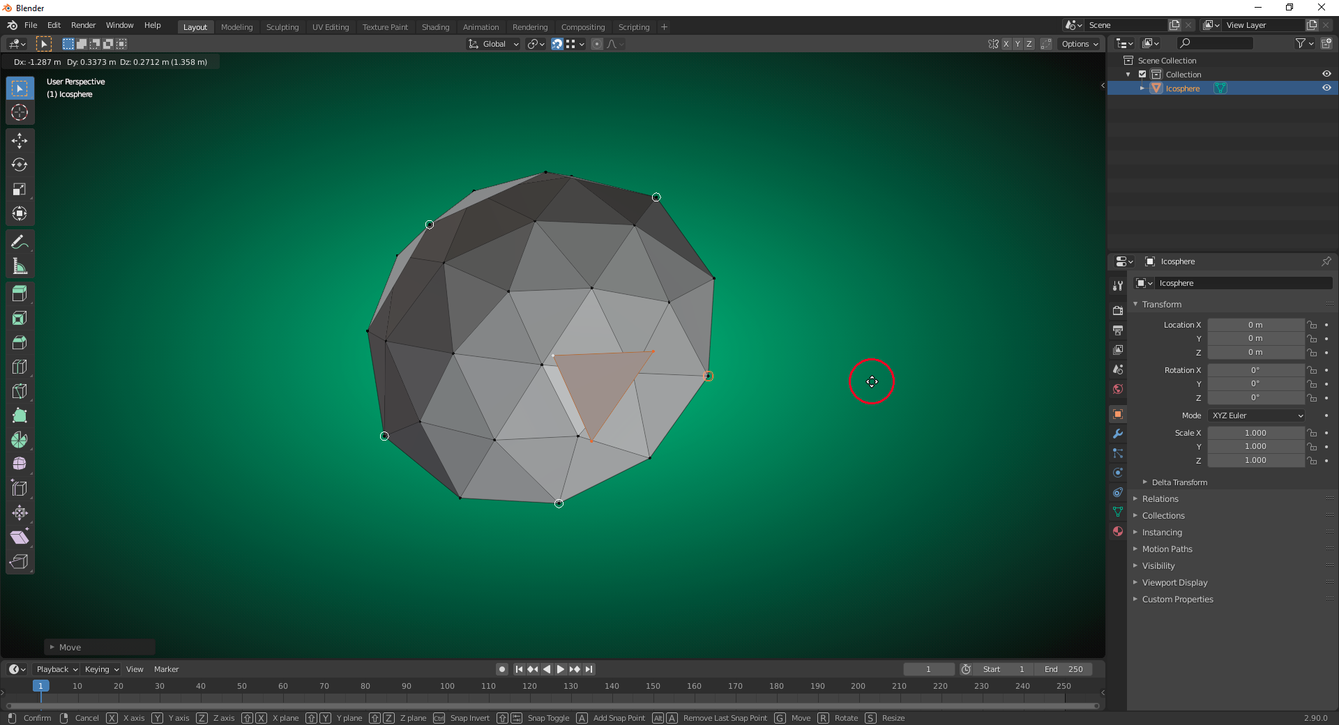

                      You can also define a selection of “Snapping Targets Elements” by hovering over one of these elements with your mouse pointer and pressing “a” each time. It’s even possible to repeat this with one element in order to assign it a higher “Influence/Weight” in that “Snapping Target Elements Selection”. After your selection is complete, move your mouse pointer away from any “Snapping Target Element” and confirm with “RETURN”. This method only works with the “Magnet Button” activated (indicated by the blue color), NOT with the “CTRL” key!
                      The image below shows this with “Vertices” as “Snapping Target Element”. The white circles and and the red-orange double circle for the last selected element show the yet unconfirmed selection:
                      #61242
                      Shawn Blanch
                        Woah hitting ‘a’ multiple times on one of the elements when multiple are highlighted is quite interesting and does indeed add more “weight of influence” to the selection. Hitting alt + a seems to lessen the “weight of influence on the one area.

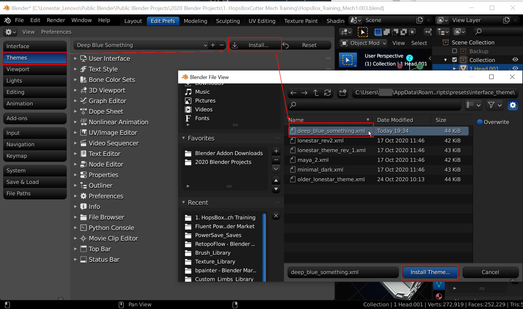

                            Gold Nugget #6 Shiny New Blender Theme – Made by yours truly.
                            I finally got my favorite theme posted to the devtalk.blender.org website under their “Call for Content: Themes” posting.
                            My theme is called Deep Blue Something (you can Ctrl + F) to find it in the web address below…
                            https://devtalk.blender.org/t/call-for-content-themes/3174/523
                            I have found this theme has really helped my workflow. Just install it in Blender Preferences under the Themes tab and click “Install” and then navigate to your theme file.
                            Pro Tip #1: If you continue customizing a theme that you loaded and want to save it: you can hit the ‘+’ icon and save it with the exact same theme name to Overwrite the previous theme (or save a new name).

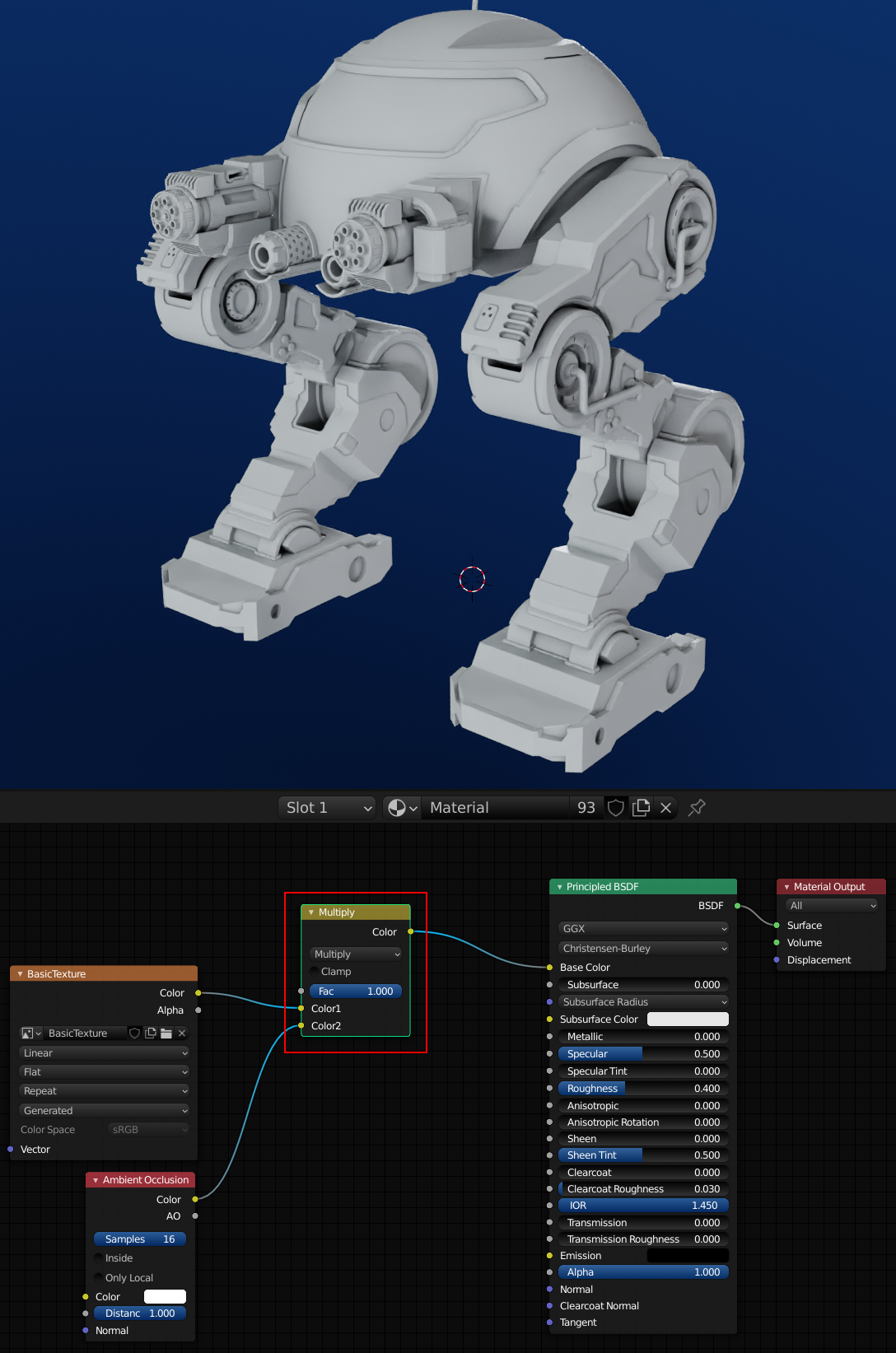

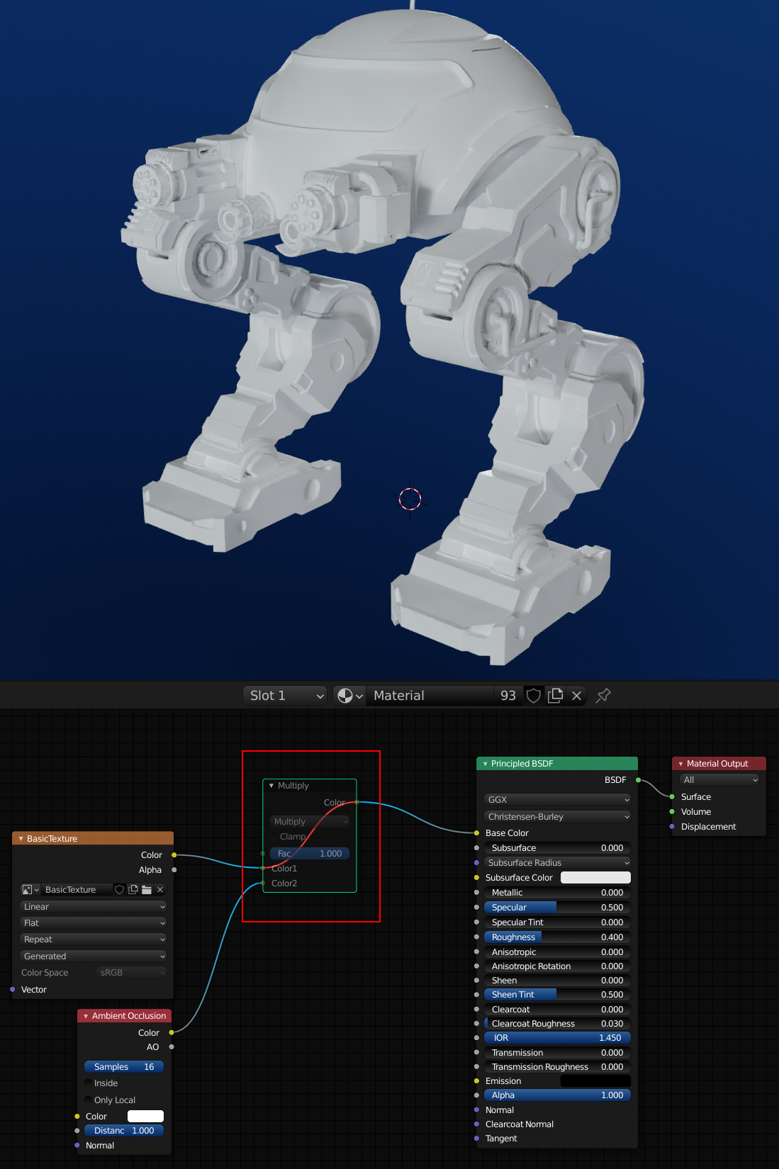

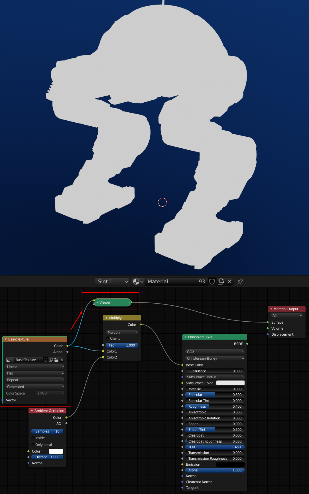

                              Gold Nugget #7: Node Wrangler Trick: Mute Function versus Focus
                              I give all of the credit to Grant Abbit on this one during his Cavity and AO tutorial: https://youtu.be/9z2kOJiheZs?t=203
                              This mech I am working on has some AO that I am mixing in to make the rendered view pop a little more.
                              If I wanted to see the comparison of having AO included versus excluded I could select the Multiply node and click the ‘M‘ key on the keyboard to MUTE the node.
                              This can be very helpful to see the difference the node made versus not having it. Toggle the mute off with the same ‘M‘ key.
                              You could also just focus the node to a viewer by using Ctrl + Shift + Mouse Click (mine is Left Mouse Button) while on the selected node you want to focus on. This enables a Viewer Node that only looks at 1 of the selected node’s outputs. You can scroll through multiple outputs on the same node with this key combination. When you are done using the Viewer node just use the key combo on the last node before the Material Output node.
