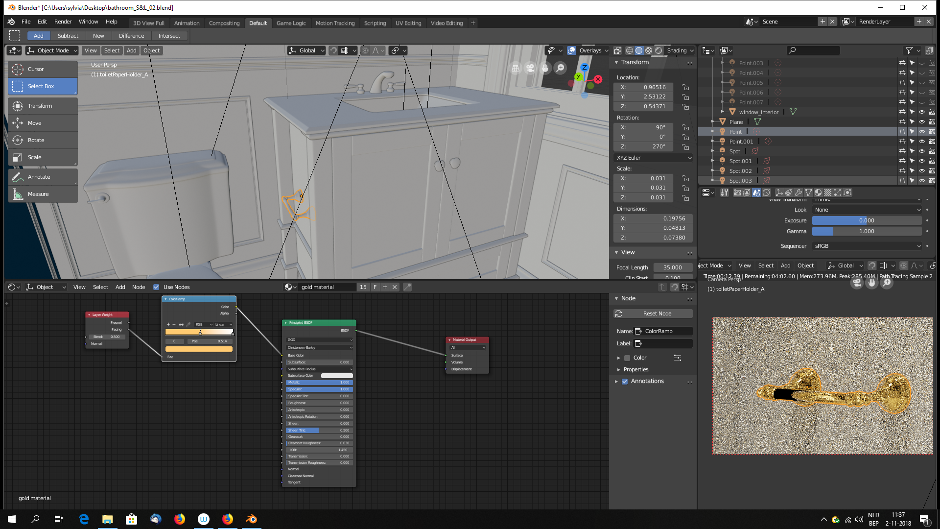

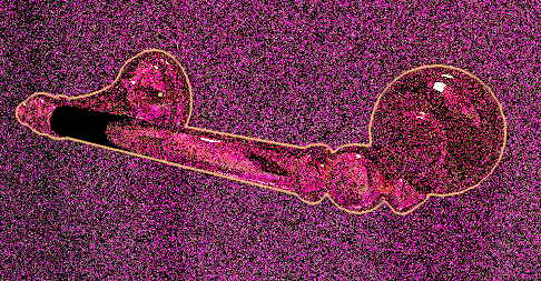

                    yukino hatake
                      does anyone know why i keep having this black spot in my gold material ?
                      I cannot get rid of it . if i turn up roughness its lesser dormant but ya gold should shine so thats not what i am looking for .
                      and as it is now i think its not really realistic with that black in it

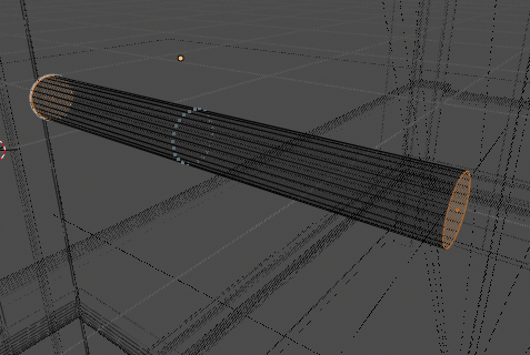

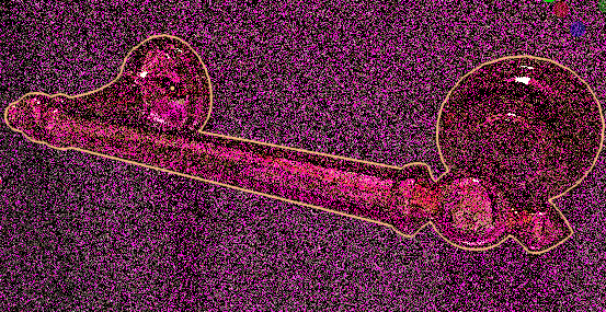

                            #42842
                            Pavel Mazanik
                              @yukinoh1989 the problem was about normals smoothing.
                              Current state
                              Delete this two n-gon faces
                              Now everything is correct
                              I can’t look at your bump map issue because texture itself isn’t packed into blend file.
