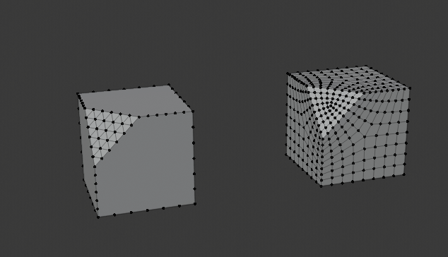

                                  Struggled way too much to get decent Dirty Vertex Colors!
                                  Subdivide just didn’t work, because it doesn’t subdivide N-gons. The Subsurf Modifier (set to Flat) did the job.
                                  Started shading and lighting…

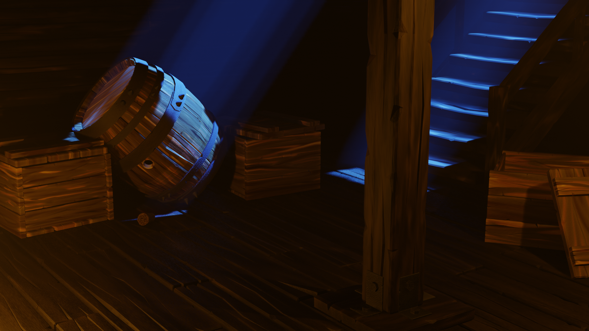

                                  Lighting in Eevee is quite the challenge for me!
                                  Here’s a first render:
                                  I don’t know what to think of it…
                                  Certainly not final;)
