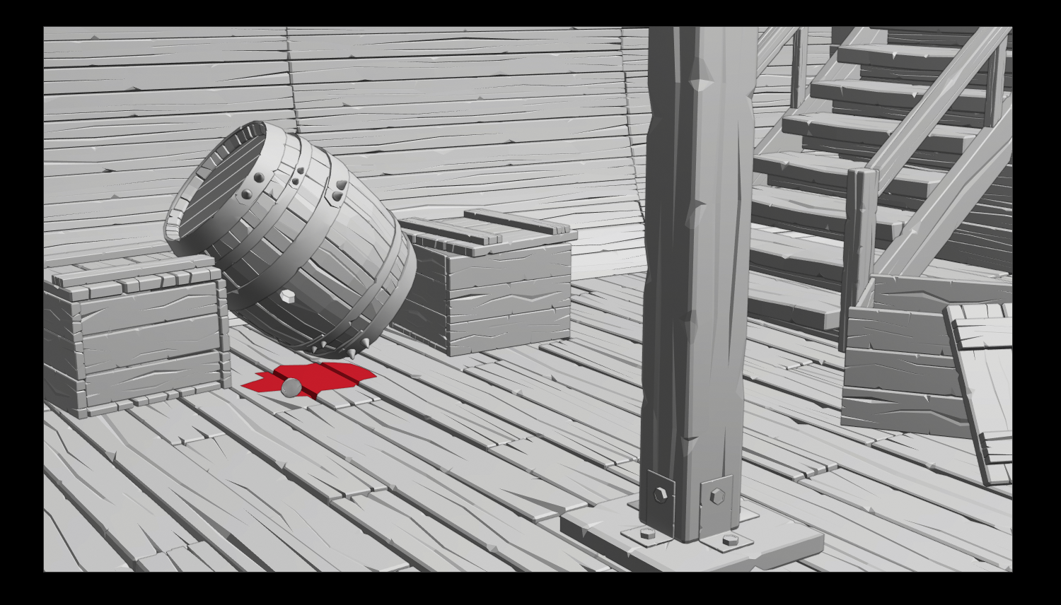

          @spikeyxxx That is a great solution!  Hot dog!  And yeah, I can see a little bit of repetition in the boxes, but I think once you light it, it’ll be less noticeable.  Missing some detail on the top of the barrel, but I’m sure that’s a quick fix.  Great effort!

            Looking like a good scene.  I like that you thought about the barrel wood type.  I can’t wait to see how you shade and light the scene.

              @silentheart00 Yeah, I know about the repetition in the crates, but that’s an easy fix, as I am using only three out of four wood planks for that. In case of emergency, I could even use the wooden beam for some of them and that has four sides, in stead of two!
              I know of all of the repetition, but I am really grateful if you tell me where it is noticeable, so I can fix that!
              With the detail on the top of the barrel I guess you mean the top ring? Yes, maybe I was too subtle there;)
              I’ll get that fixed, thank you!

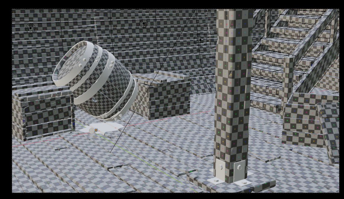

                      After having taken a few days of rest, I started UV- Unwrapping the wooden ‘Cubes’.
                      This was a lot more difficult than I anticipated, mainly due to the different scales of the wooden planks!
                      I ended up with this:
                      I’ll put the rest of the pieces on a separate Map.
                      It’s not a perfect Unwrap, but I think that I can work with this.
                      This is what I did (after several failing attempts):
                      I put all linked duplicates in a different Collection (how I love Collections!).
                      Then I put seams on each of the unique wood pieces.
                      So, all of the wood pieces had seams.
                      Then, in Object mode, I made everything a single user and applied the scale.
                      Selecting all the wooden pieces which had seams, I went into Edit Mode (another great feature of 2.80!) and Unwrapped them.
                      Averaged Island Scale and Packed the Islands.
                      Slightly adjusted the Margin and made a New Image of 8192 by 8192, with the Generated Type set to Grid.
                      In the Shader Editor, made a New Material with the newly created Image plugged into the Principled Shader (Selected the Principled Shader and pressed CTRL T, thanks to the ‘Node Wrangler Addon!).
                      Again, in 2.79, this would have been a lot more work!
                      Unfortunately, I can’t re-establish the Links now, due to the Scaling, but the alternative would be to either modell a lot more planks, or to put a Lattice on almost every plank and use the Lattices to give the planks their fitting shape…

                        @spikeyxxx Sorry I’m late to grade your week 1. But you probably noticed that your submission was among the notables. With the quality of modeling and scope, you’ve definitely earned an A+. I’ve only one note to offer and that’s the noticeable faceting on the barrel polygons. If you smoothed the normals and highlighted specific edges to be sharp, that’d be the cherry on top.

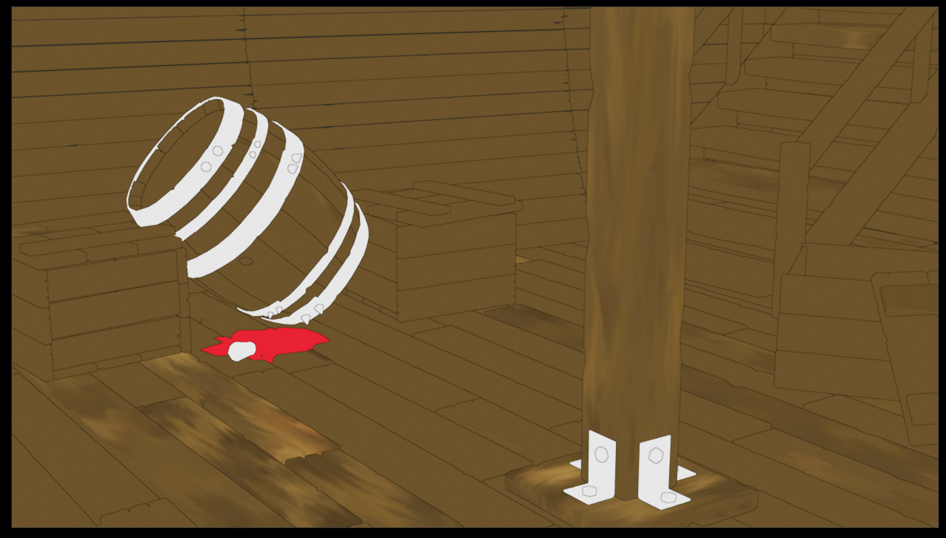

                                So today, I didn’t get very far, but learned a lot!
                                Started painting the floor.
                                Then I discovered that I had made a mistake with laying out my UV’s. The barrel was overlapping part of my floorboards…
                                All that painting had to be re-done!
                                But then again, I need the practice, so that wasn’t too bad.
                                Still no good at hand painting, but this is the result so far. (I know it looks awful..):
                                I thought I’d give it another try tomorrow;)

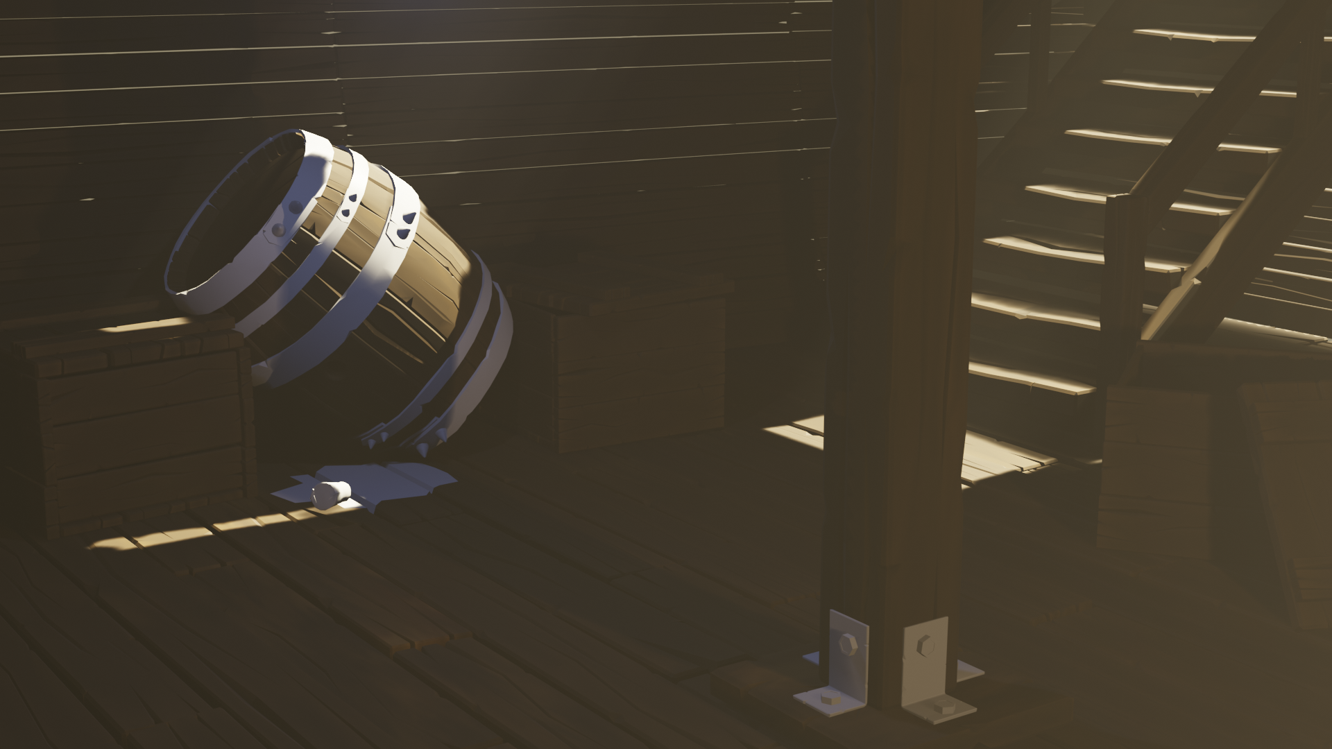

                                Tested out some lighting, to see how that would look and found that with this kind of lighting, almost all of the paint details get lost!
                                Maybe I’ll have to use more contrast?
                                Also, painting them singularly, they weren’t so bad, but from the Camera view….
                                Tomorrow’s another day with new hopes!
                                Here’s one of my renders (luckily this is eevee, so I could do 23 test renders in not time!):
                                  No way, it does not like horrible so far. It looks to me like you’re headed precisely where you should be for an appealing result.
                                  It sounds like you’re using one texture map for the whole scene. While you could do that, I personally would chose to separate textures according to object: Like a texture for the barrel, another for the crate, and then another for all the environment pieces (wood/wall boards, support beam, stairs). Just something to keep in mind for future projects.
                                  Are you painting each floor board separately or using the data sharing trick?
