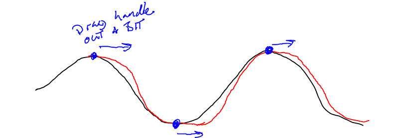

                                  And now about your limp issue you see. I think it might be in the hips and where you have them swing over to transfer weight.  Hold the hips a few more frames on the posted foot before swinging them over to the new passing/leading foot.  The hip swing is not a perfect parabola in you’re graph the arc usually weights a little heavy to the right side of the key. ( I don’t know if that makes sense ummmm……….look at my doodle below)
                                  I hope that makes sense. If you have any questions let me know. You can always hit me up on the Discord channel as well.
