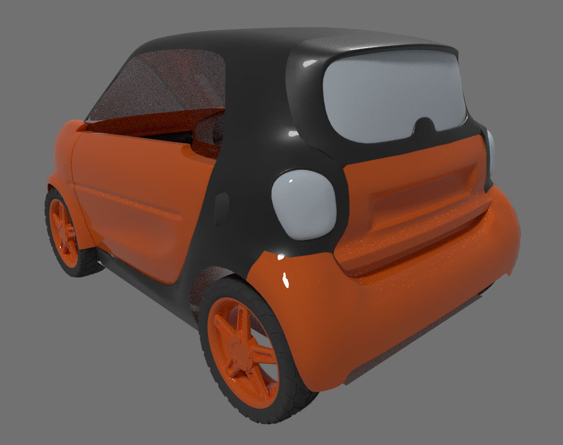

                Hi all, yesterday a can’t stay in streaming but stealing time to model my ¿car? Here it is my progress

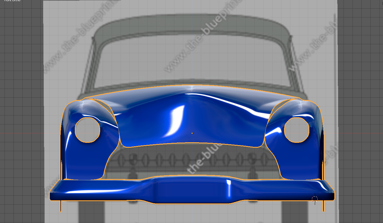

                    Morten Fjellheim
                      The hood completed, more or less! Only some minor cleanup.

                            @llusd You did this in one day ?

                                  @llusd Excellent progress! Nearly done it seems to me 👍
