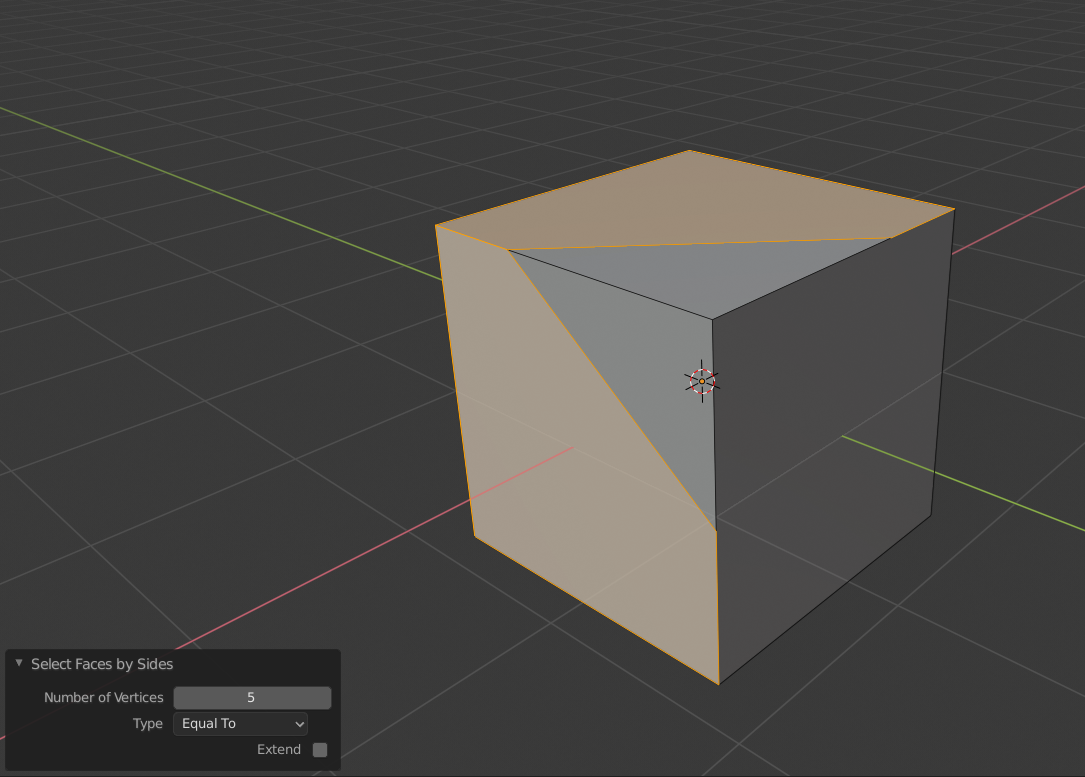

        Could you please someone advise is there maybe some visualization option in Blender 2.8 version to distinguish Triangles, Quads and Ngons on a certain mesh? Maybe with different colors?
        Not sure how technically that is difficult, but such tool could help in analyzing topology issues

            @csehz You could try: Select > Select All by Trait > Faces by Sides.

              @csehz At 3:30 minutes in this video Jonathan Lampel demonstrates a selecting technique to select n-gons. The settings can be adjusted to selecting quads and tris.

                  Zsolt Cseh
                    @smurfmier1985 @spikeyxxx that is great to know, thank you very much.
                    You answered so fast with pointing to the same solution.
                    @blanchsb Yes that is also a logical and good idea for fast area test on a mesh whether a loop stops

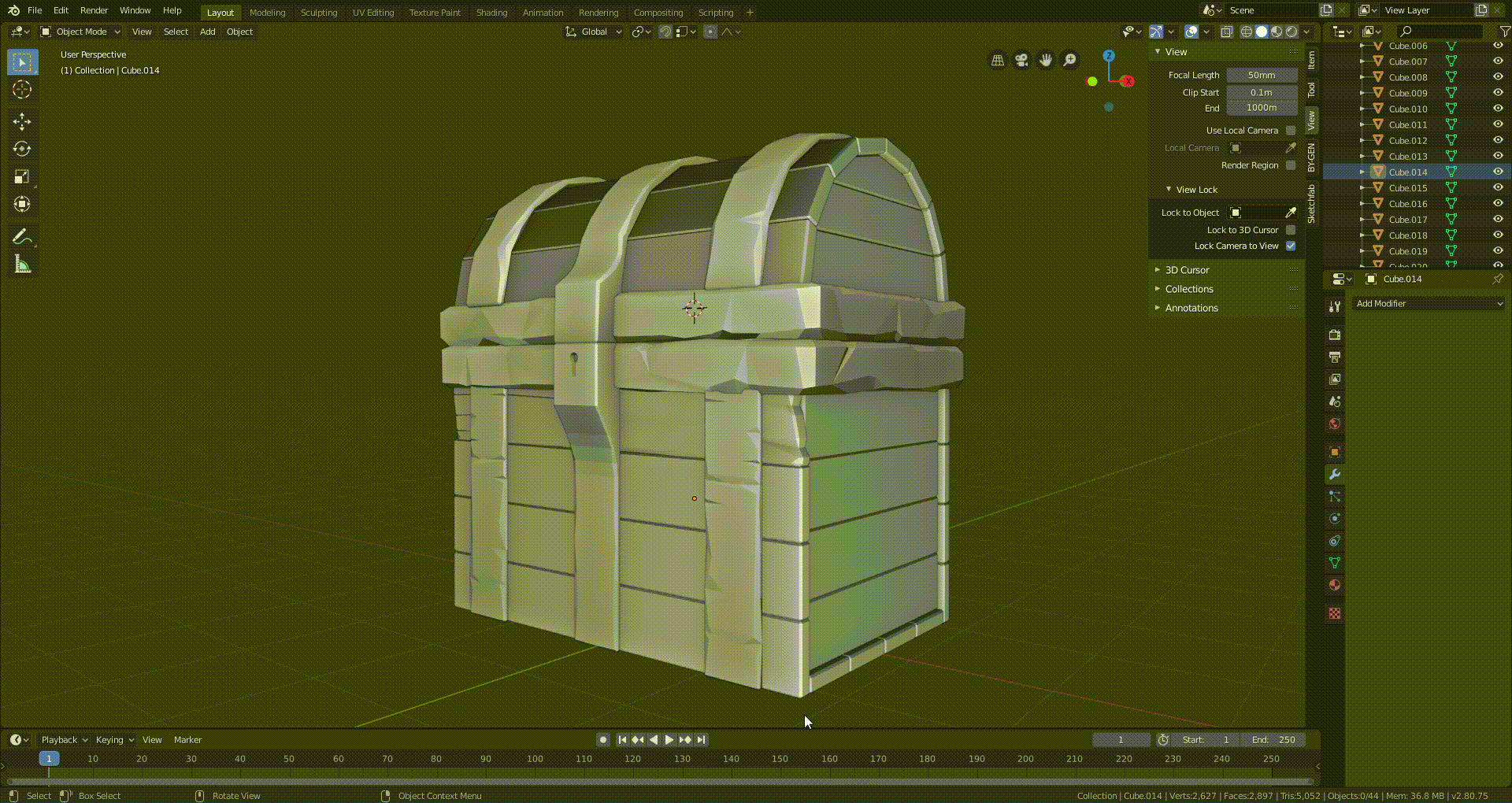

                            Hi All,
                            I decided to redo my half finished model of the treasure chest, but unfortunately I am stuck at the sharing object data.
                            Last week it worked perfectly for me but this time around I seem to do something wrong but I cant figure out what it is?

                                @justjenn Hi Jennifer, it’s hard to tell, but did you maybe forget to put the Origins to Geometry????
                                #46083
                                Paul Haynes
                                  @justjenn … I think it’s repositioning every single object in your selection to the exact location of the last selected object. So, they’re just stacked on top of each other.
