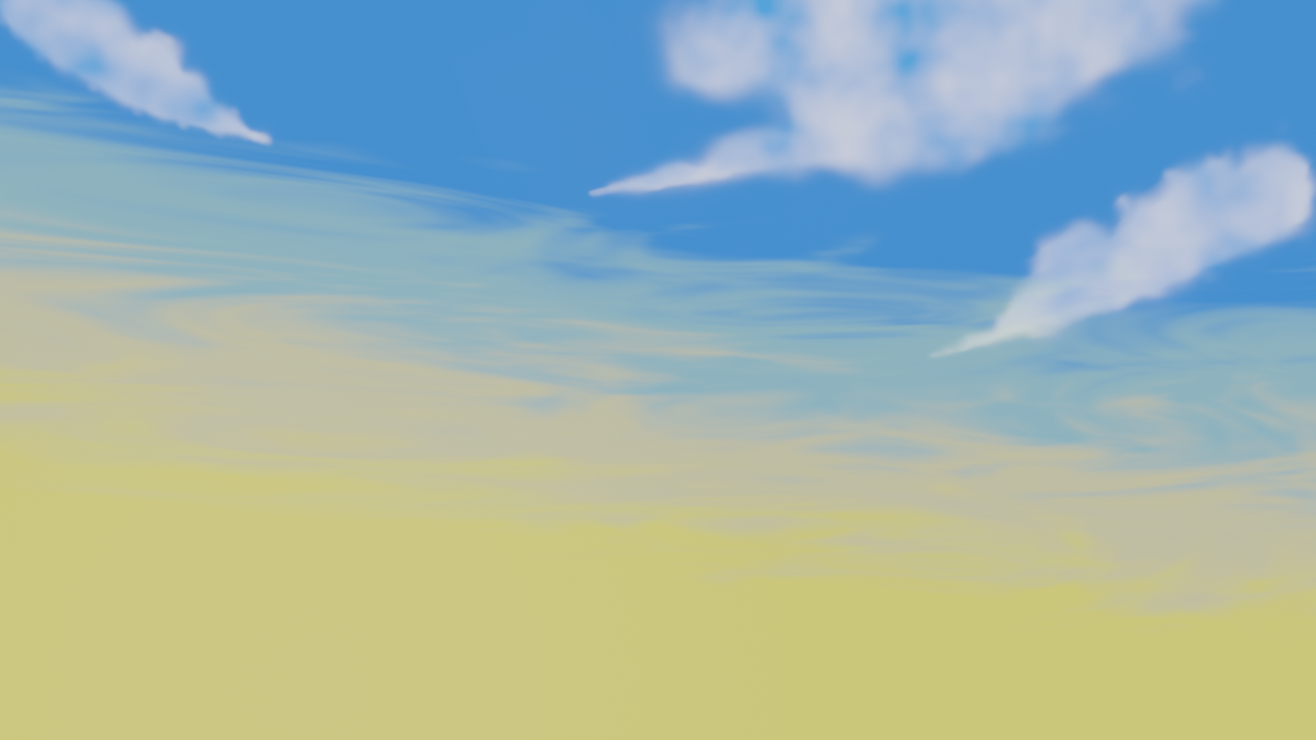

      I reinvented the cloud….
      I was playing hide and seek with my fluffy friends, and I had a thought about  my other friend, Sky….
      So I got all my friends together in one world….

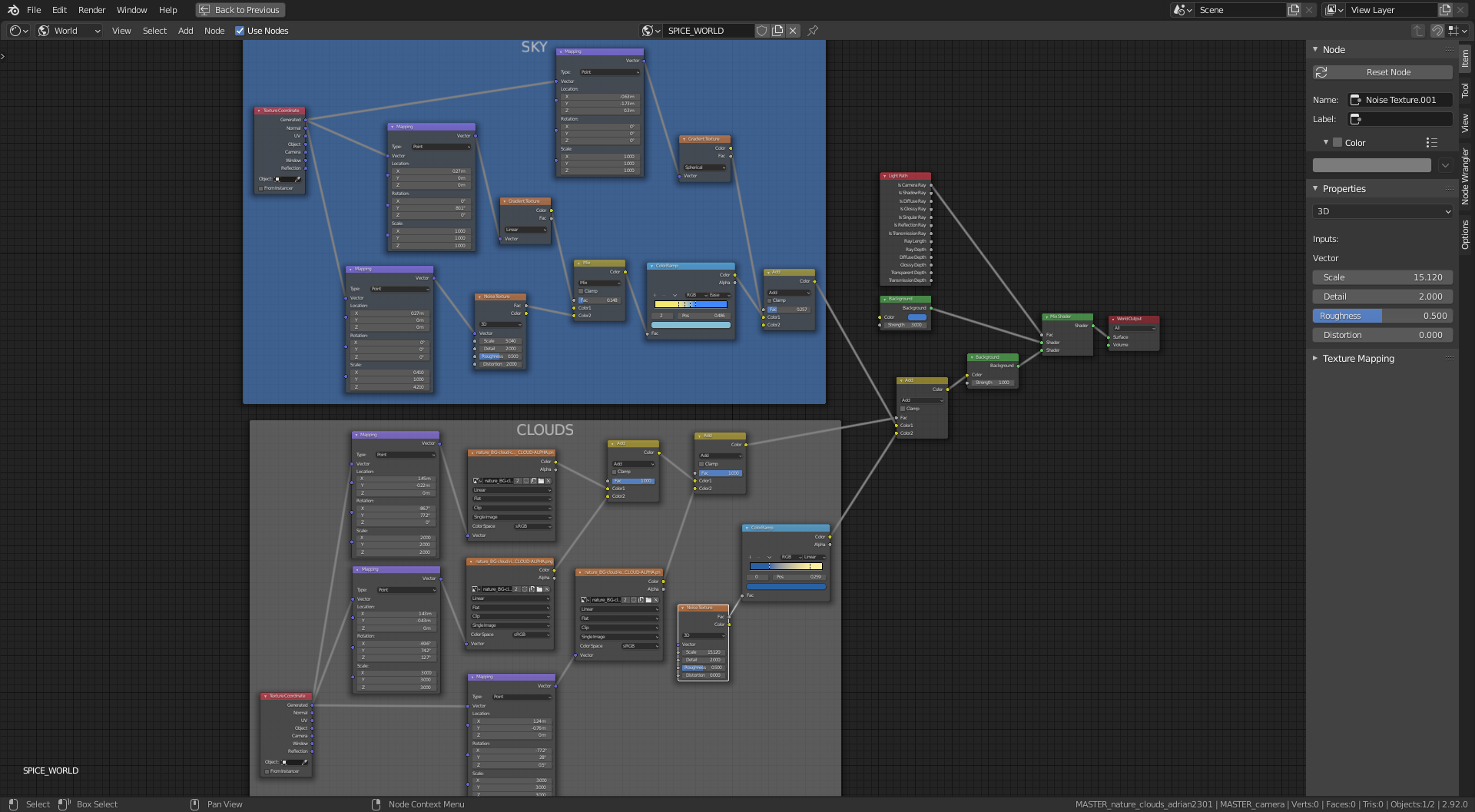

      I had the alpha maps from previous experiments and added them to the spice world sky, with some adjustment in the mapping nodes for placement.
      The result is interesting.
      Problem is no shadow, unless I can fake it.
      I’m not sure about a rabbit hole……
      Perhaps a black hole
      If you wish to follow me in, file is on google drive, WIP_nature_clouds_adrian2301_08

          Thanks @vincav81 , It’s not the shadow in the ground I’m thinking of , it’s the shadow on the cloud , darker underneath than the top
          #67406

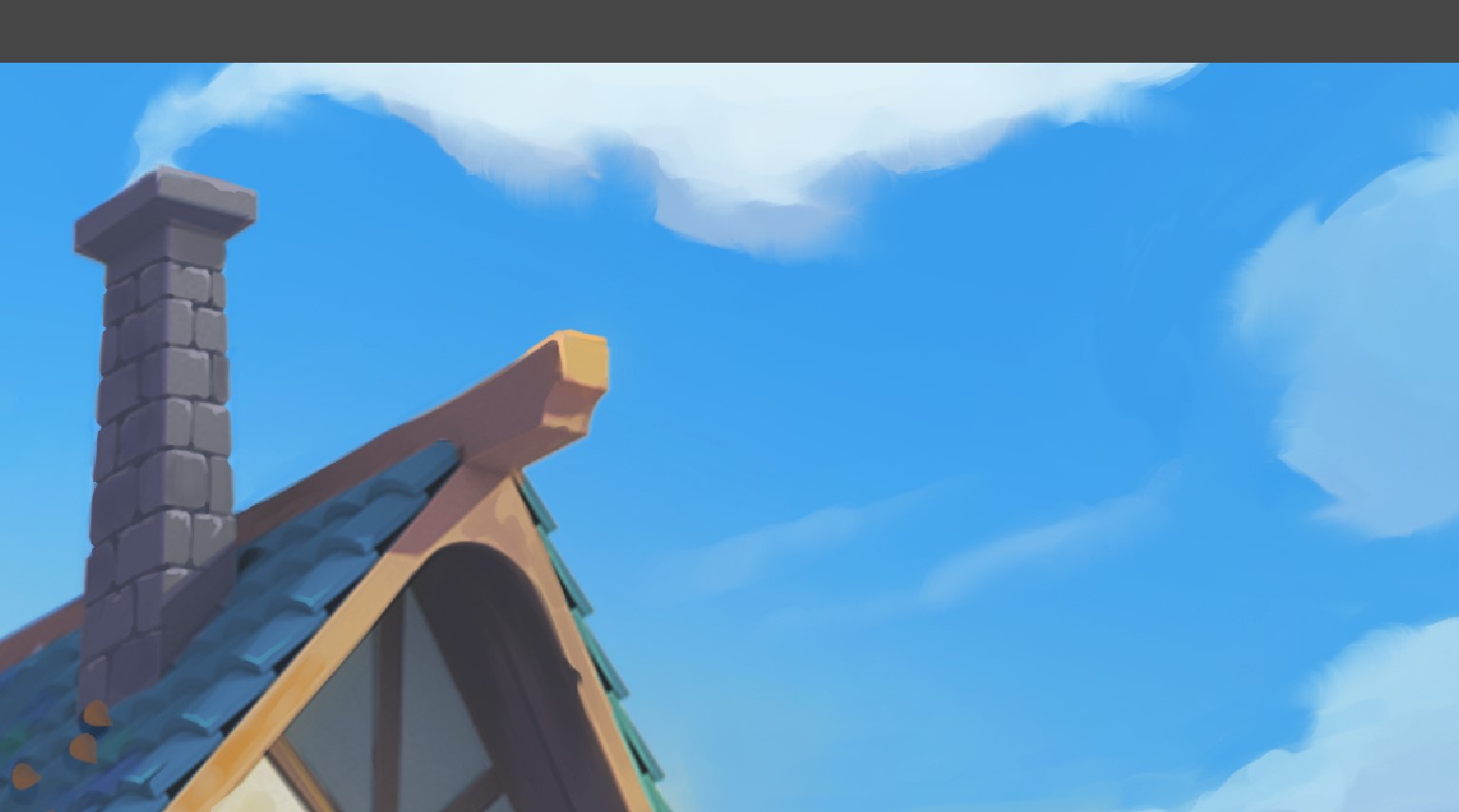

            @adrian2301 Your cirrus clouds are a perfect implementation of the idea! I tweaked the shader elements a bit and am VERY happy with the sky. Fantastic work sir.
            Do you want to add a card-based cloud for me to place in the sky? More variety is always nice. Otherwise you’re welcome to focus on the chimney smoke the rest of the time.
            Some sort of animation on the smoke seems necessary…it’d be really odd to see it static. It would also probably be best as a 3D asset, able to orbit around and cast a shadow on the roof. Since the art shows the smoke bent to the side considerably, accomplishing all these things could be very tricky. Thanks to the clouds we know the ghibli method is too slow if the camera gets close/inside and volumetrics aren’t a good option due to the flickering…
            Perhaps this method could work for us? https://www.artstation.com/artwork/mDW6Yd
            Where the puffs are card-based particles that follow a curve’s path to match the art?

                              As for the Sky, I have added another feature to Spice World, I will let you check it out in the file. From the house view turn around and look up, hope you like it.
