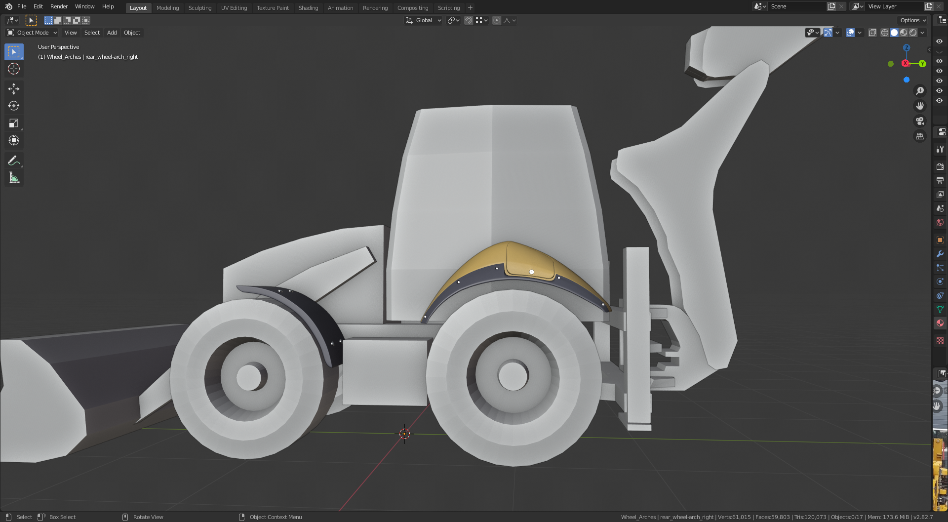

          I noticed  the wheel arches are not on the list. So I thought I would have a go. I added a comment and a link.
          #53840
            Woah, looks like you’re finished with those wheel arches! Who needs blockouts anyway 😁
            They look really nice, Adrian. Good work 👍

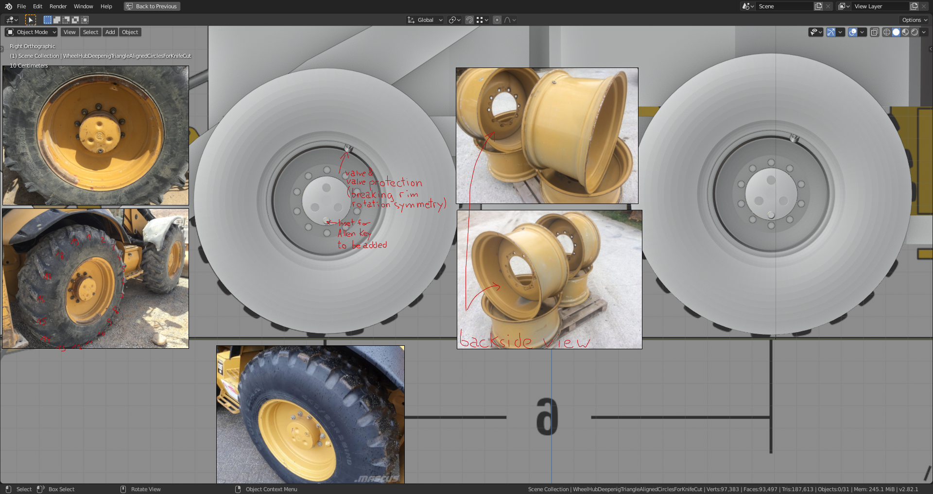

                  This is what I’ve modeled so far for blockout level 2 of the wheels:
                  And a closer look:

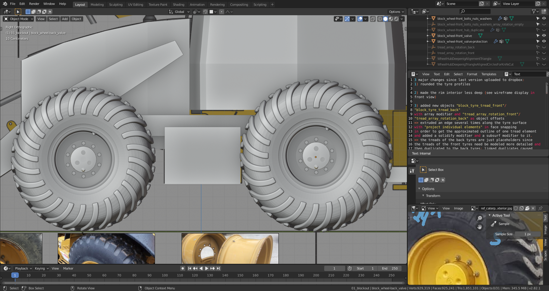

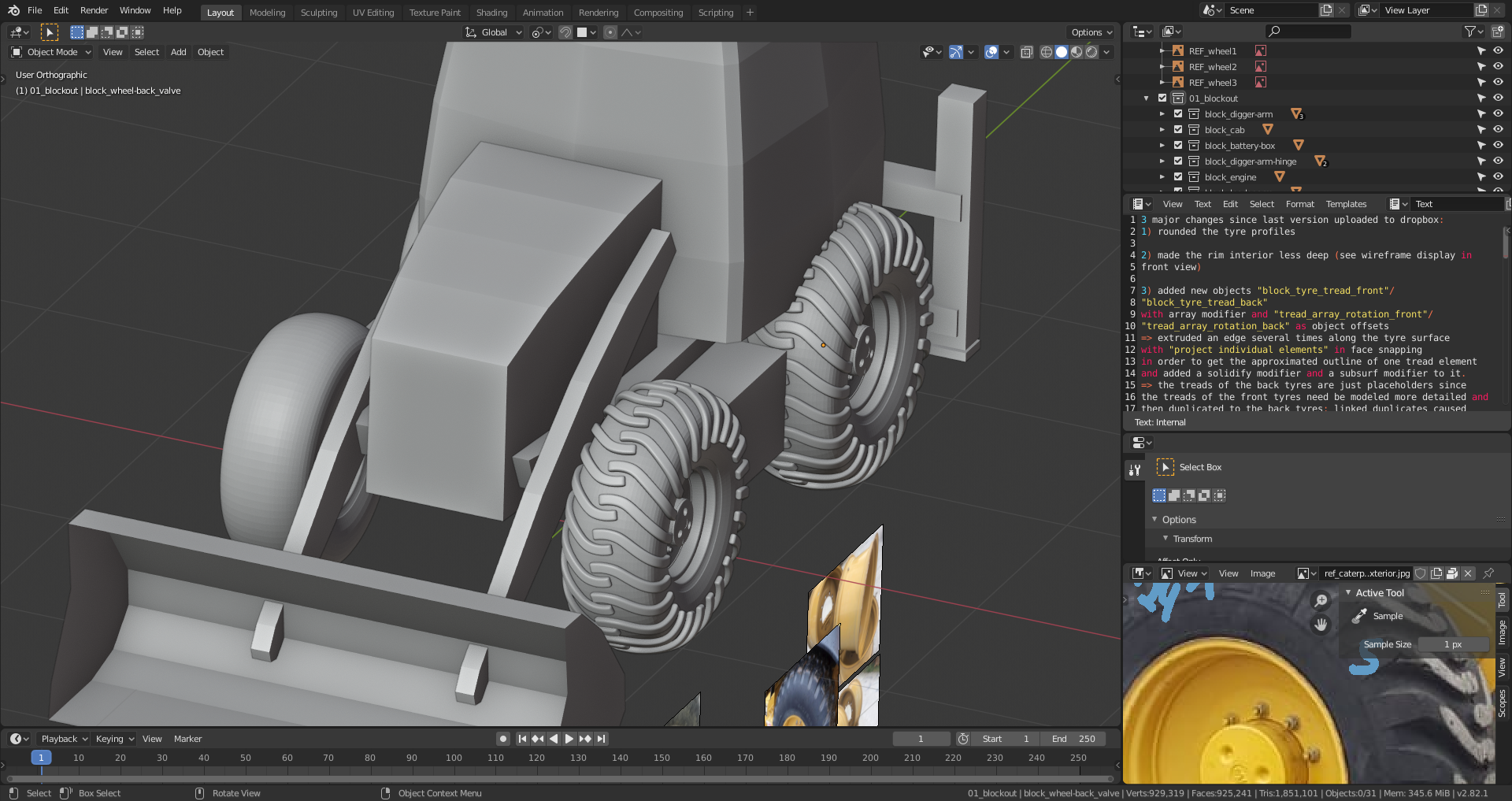

                          Here an augmented version of my wheels blockout level 2 with tyre treads:
                          PS: I accidentally closed all but one tab (active tool seetings and workspace) in my properties editor as you can see it in the screenshots above the reference images sheet in the bottom right corner. I’ve fixed it by leaving “Load UI” in the properties region of the blender file browser unchecked. But I stil don’t know how I’ve run into this situation.

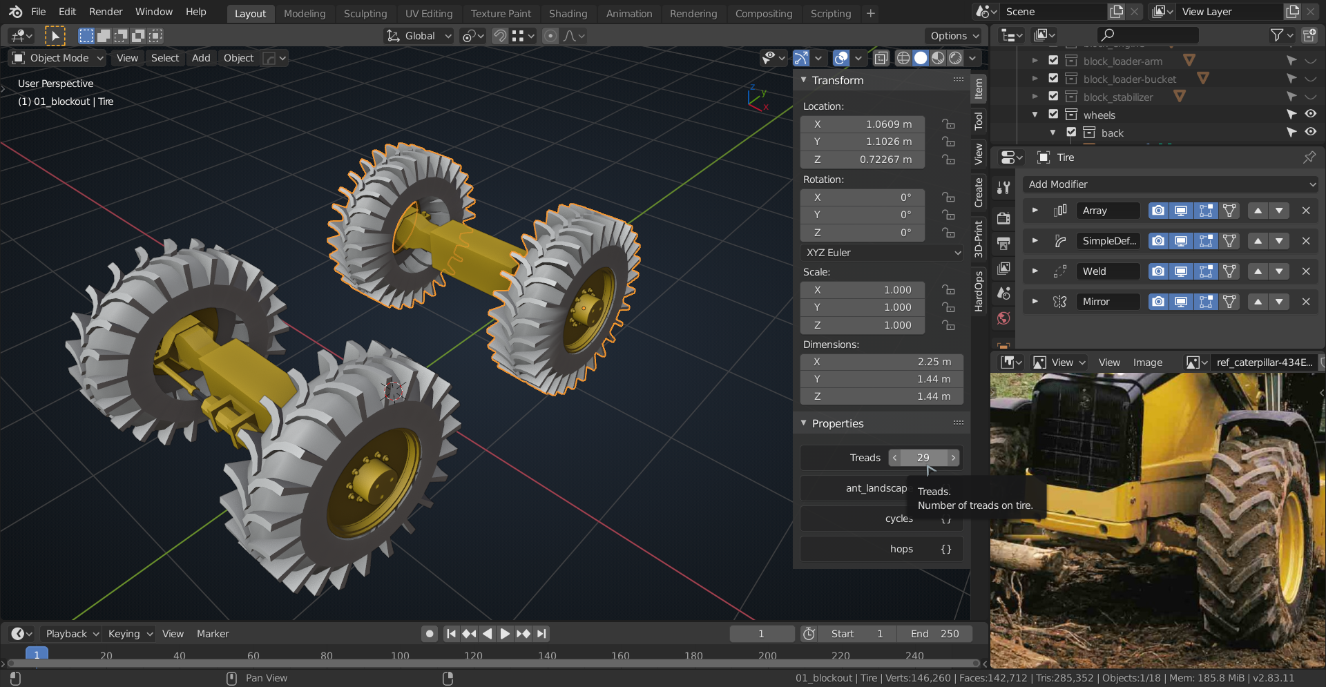

                            Also blocked out the treads and as the drawing has 23 treads and the pictures 22, I thought it might be fun to give the possibility to change the number of treads. You’ ll have to do the front and back wheels separately, but it’s working….

                              Clever technique! Didn’t know that there is now a “weld modifier” in Blender 2.83. I’m just using the good old 2.82 Alpha 😉 .
                              #53850
                                Actually, I don’t think I actually need the Weld Modifier. It’s just to make sure, because of rounding errors.

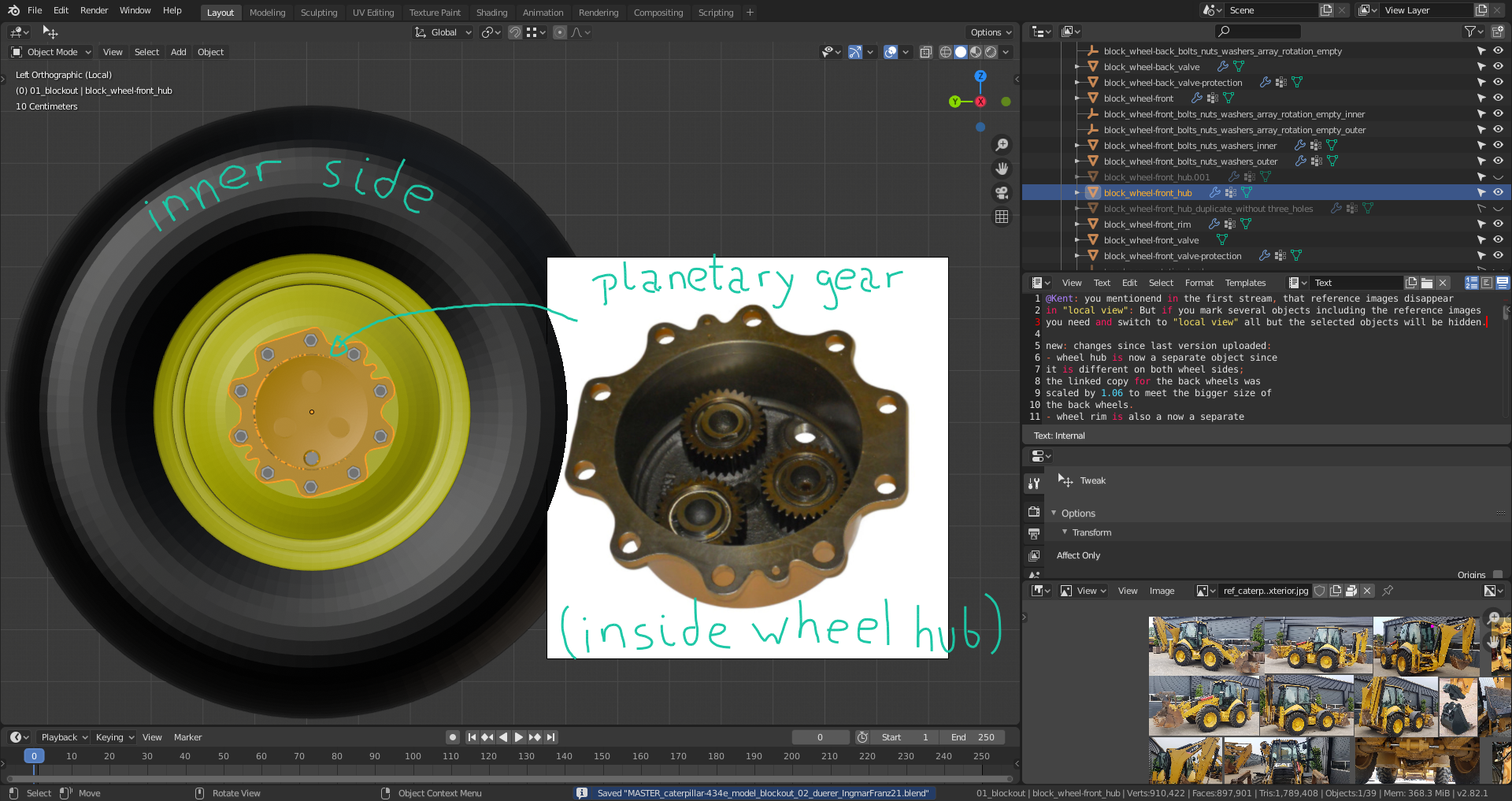

                                  Here’s my last version for the wheels blockout level 2:
                                  It took me a lot more time than originally thought. I’ve done the modeling of the inner part of the wheel hub manually by eyeballing. Maybe  it would be more precise using a plane orientated in the same way as the object in the reference image of the planetary gear  and then tracing the outline on the surface while in perspective view. I’m still looking for reference images showing the connection between the wheel hub and the axle. Are the front axle and the back axle identical?
