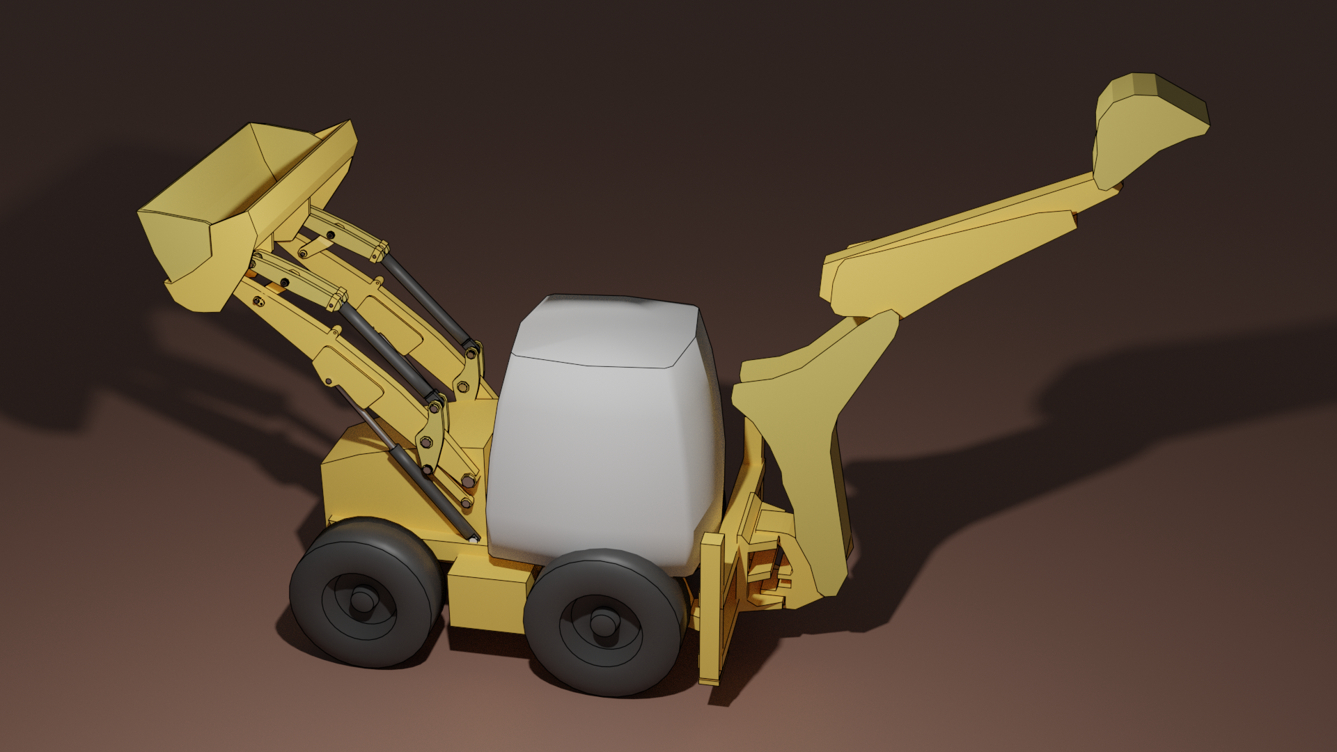

        @pfbourassa yeah I am saying that it’s not pointing to the part it needs to connect to AND I’m a little concerned if I go with my gut and ditch the reference that the hydraulics will interfer on the back side of the wheel/tire where it connects to the axle

          For what it’s worth, I think you are correct on where it should connect, and how thin the axle is.
          #53825
          Kaj Suominen
            Those things are forklifts attached to the bucket, you can see where they can pivot on the top. and they are hold down with bolt on down.

                @blanchsb kudos on your functional research and testing. I agree with your inclination to follow the red dashed line reroute. I’ve run into a few things with the blueprint that I know are inaccurate to the real thing. I trust your testing results 👍
                #53828
                  Also I think I made the wrong call to omit the forklift brackets. All 4 official CAT brochures feature them. This is another strike against the blueprint’s accuracy lol.

                    one thing i’ve learned when doing exact models of real things that blueprints are lacking, either because copyright stuff or that things have changed between different years of same manufacturer and then you also get reference pictures that might be on different model. So the more you have real reference pictures the better.

                        I agree with @louhikarme. Those forks rotate forward about the pivot bar on the top and turn the bucket into a fork-lift hybrid. Notice the forks get thinner at the bottom and thicker at the top. Ease of “stabbing” design.

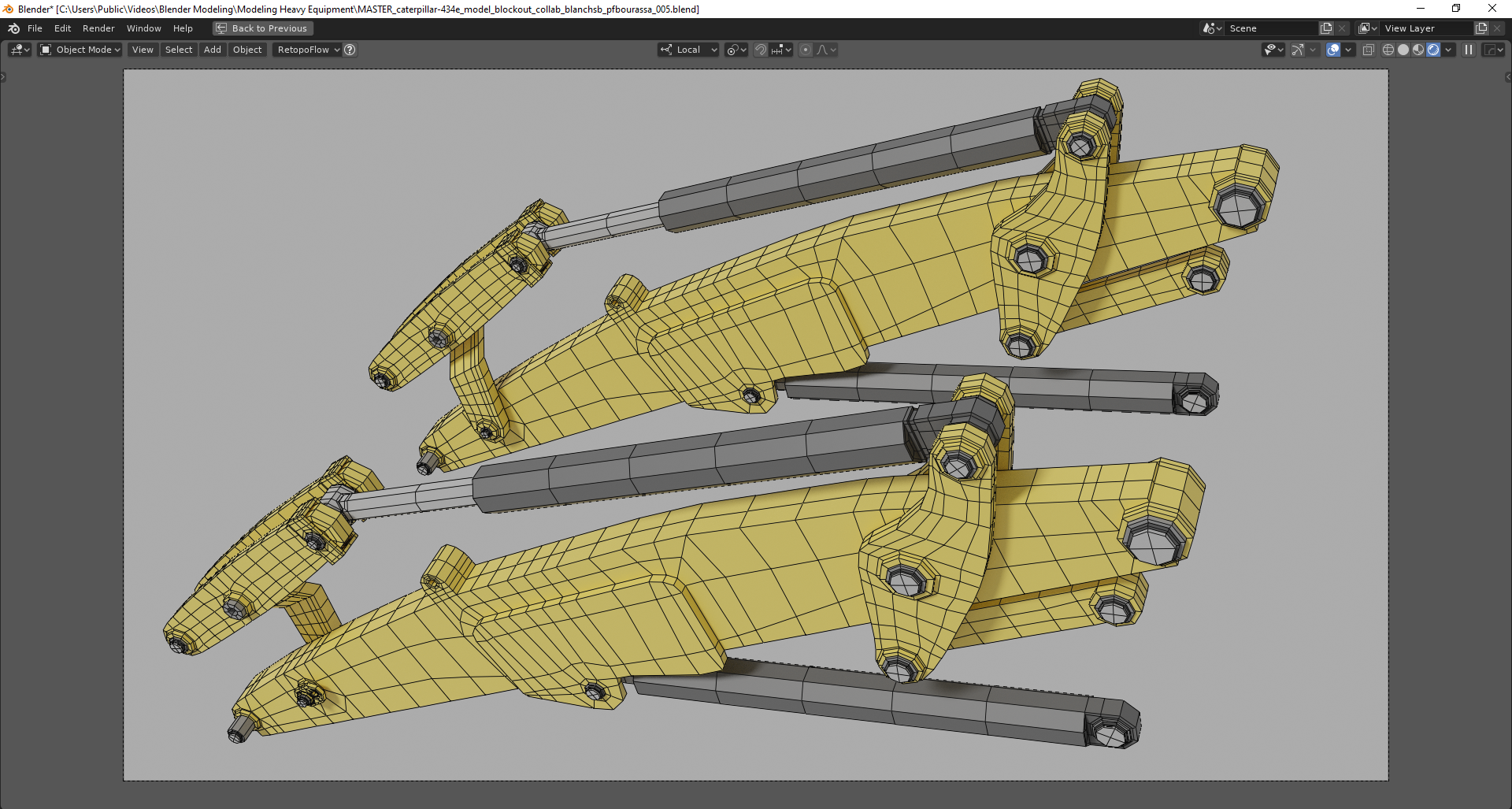

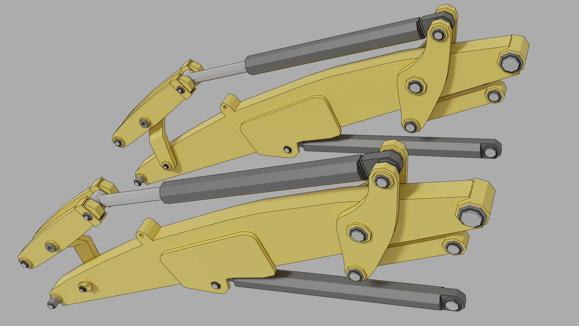

                              Okay. I feel like I am done with the basic block out. Maybe I have gone farther than expected or maybe this is just right. I’m hoping it is far enough Because I am ready to move on to train some more. I have most mirror modifiers still active but there are 40+ objects so I don’t remember if I applied a couple on the more basic shapes.
                              I’m including the wireframe and basic render here for feedback and critique. I tried my best to have clean topology to make it easy to add SubDiv Modifier(s) but there are probably areas that can be improved farther. There are a lot of circular cuts. I kept all circles at division of 8 and maintained same circle-rotation on pieces that shared a circle cutout.
                              If this looks good enough then I will upload it to the Google Sheet. Hope everyone else is having as much fun as I did! Go DOGs!
                              Wire Frame – Loader Arm Assembly
                              Block Out – Loader Arm Assembly
                              Reference and Playing Around
                              Notice how the lower frame is cutting into the lower hydraulic. That will have to be thinned out to make room.
                              I checked out the similar CAT machine at my work and there is plenty of Front Axle clearance behind the Front Wheels. There’s not a ton going on back there so I think the lower hydraulic shouldn’t interfere.
                              @pfbourassa I’ll send you the updated file here shortly the same way I sent it before.
