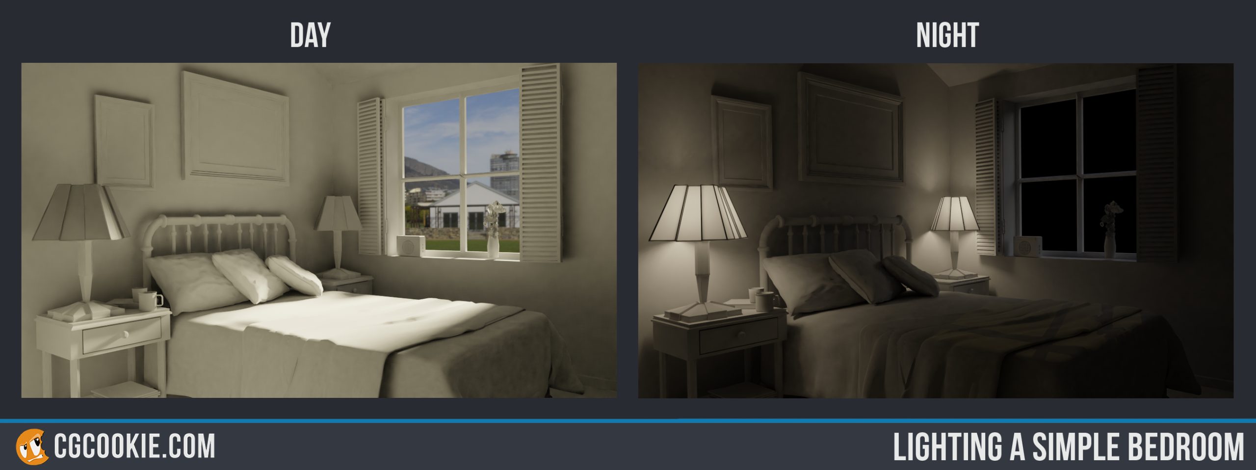

      Hey Guys,
      Had a go at the homework. The lighting was very interesting. In the end I wasn’t happy with some of the light colours. I added a second light in the room in the daylight scene. I thought it necessary so the sun didn’t crush some of the detail. A low strength Hemi in white. Using the HDRI images is super fun. There are some gorgeous images around. I went to HDRI Haven. Heaps of cool stuff there. The author has the right idea

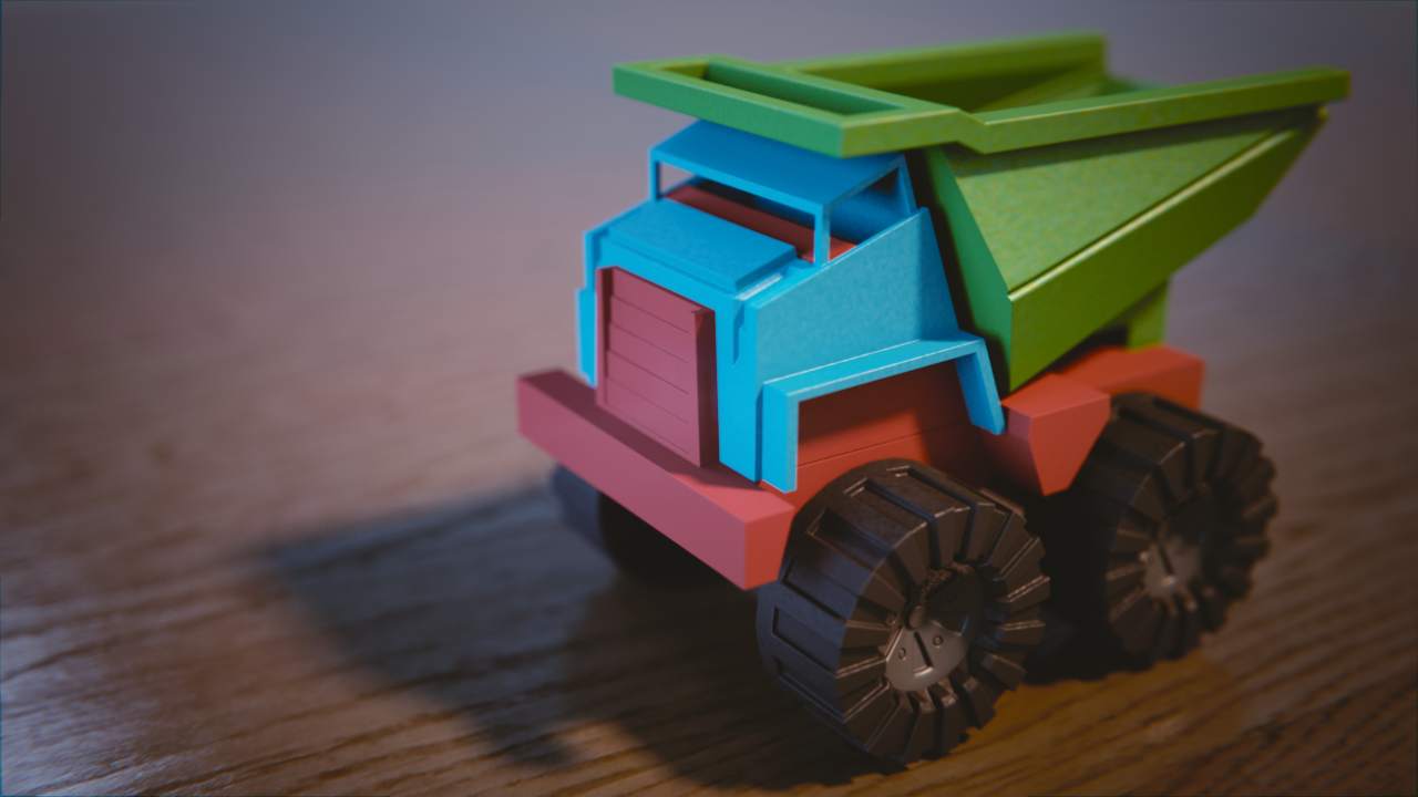

      Sean Parkes
        The toy truck was interesting. I used the complimentary colour wheel that Kent showed in the Live stream. It was fun. Palettron.com was the site. Thought it was amazing. I end up dulling the reflections with a subsurface scattering. This was way too noisy and I couldn’t get it to look good. In the end I put a noise texture into the roughness value on the Glossy BSDF and left it on default. This took the real sheen from the glossy BSDF and allowed a more “plastic” feel.
        PS. Colour was super fun

            Truck looks good if you’re going for more of a dull plastic feel.  Interesting color scheme.  It looks like a triadic color scheme to me.
            Your day scene looks nice.  Maybe the light is a little bit bright for my taste.  The night scene is nice, too.  White bulbs are kind of boring, though, and tends to make things feel clinical.  It’s getting a little dark on the right side, too.  Try changing the color of the lights and see what happens to the mood.  Good work so far.
            #42931
              Good stuff @sparkes983! Sounds like you’re making good strides with material nodes. Glad you had fun with colours and palettron.
              I agree with silent that the toy plastic is a little dull. But I don’t dislike it. Most of the time the issue is making the plastic too shiny.
              Solid lighting with the day and night scenes. Something about the landscape in the window feels odd though. Like the window is right beside a big hill or cliff. Not that that’s an impossible situation but it kinda makes for a clostrophic feel to me. I don’t know – that could be a difference of taste though.
              My only note on the night scene is the white lights. I prefer warmer lights BUT I also know that white bulbs are becoming quite popular. I hate em but they exist 😅
              Overall it’s an A from me this week.

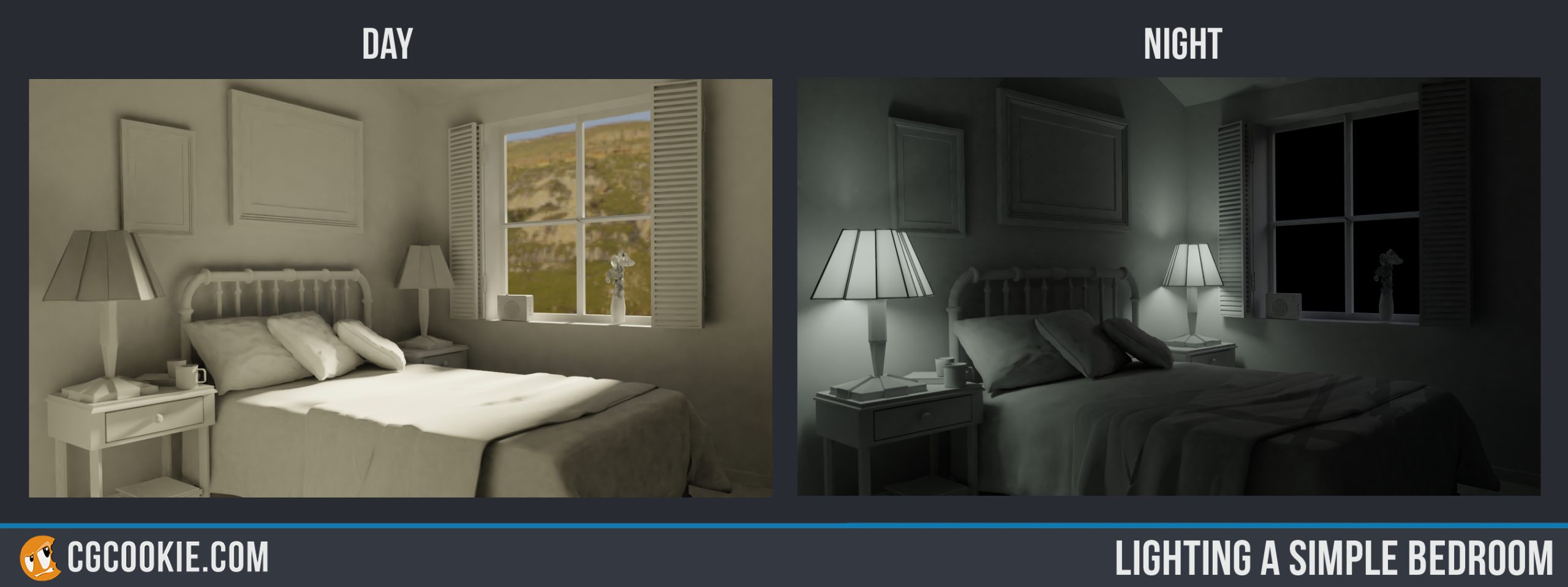

              Sean Parkes
                Take 2 based on the feedback. Changed the image in the day scene. I thought I could change the window view to just a blue tranparent plane, but it made everything blue. Can this only be done as an after effect? Night was a better result. I liked the colour mix better with the moonlightSecond Attempt

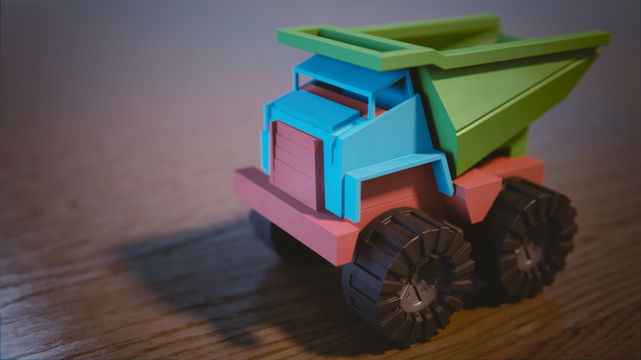

                Sean Parkes
                  had a play around with the noise texture settings. Plugging it in as a colour had a mottled effect, but got a bit of colour back into the red. I feel like this could be done a bit better with some more info on the settingsSecond Attempt

                  silentheart00
                    @sparkes983 Your second attempt looks nicer, with a better play between colors in my opinion.  For making the view out the window blue, how were you doing that?  Was it 2.7 or 2.8?  Cycles or Eevee?  I noticed when I switched to Eevee and then tried changing the environment color it affected the whole image, not what was seen through the window.
                    The updated truck is interesting, like a clear coat of plastic is peeled off in areas.

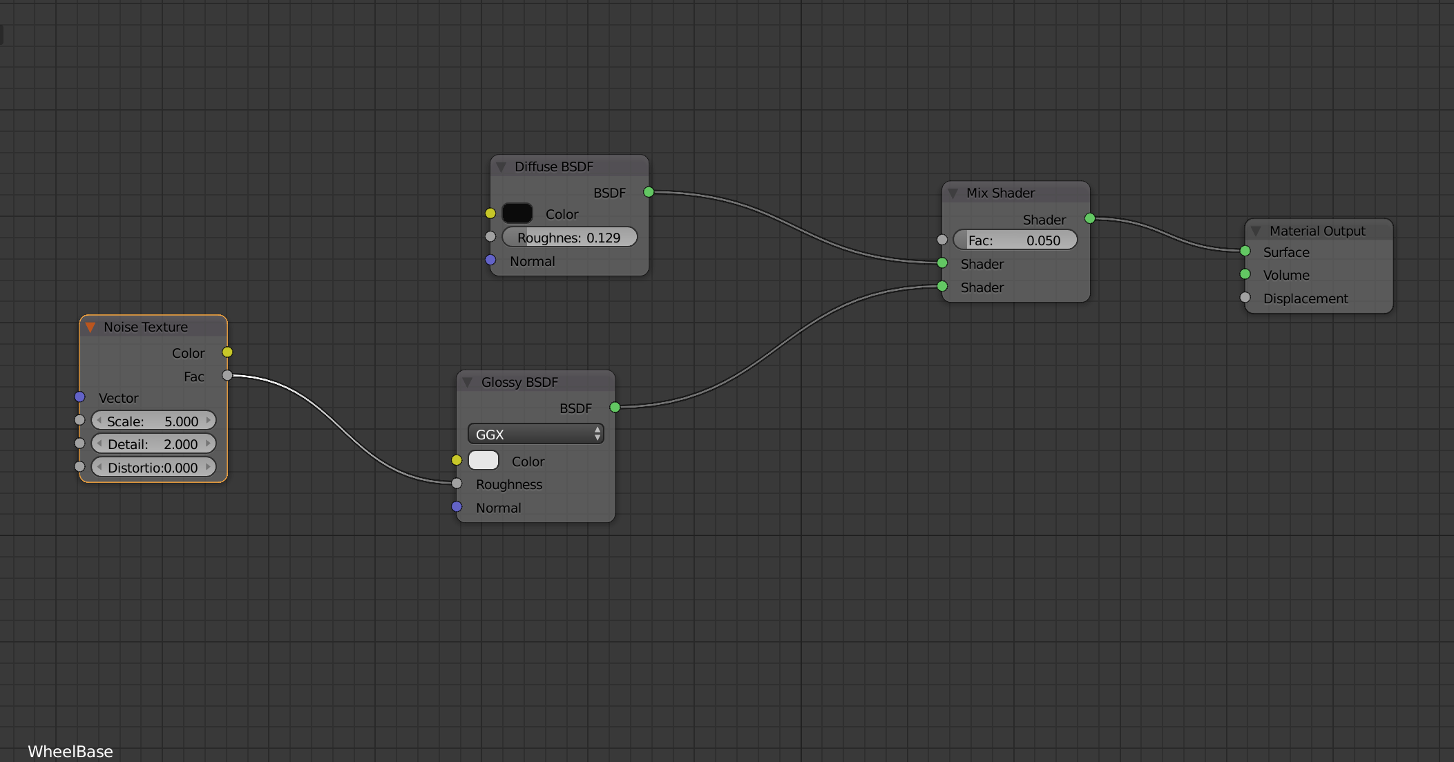

                        Sean Parkes
                          @silentheart00 I kept it quite simple. As attached. Really only tried to play with some settings in the noise texture node. Still quite green on the node editor, so didn’t try too much. Tried plugging the  noise texture into different nodes, found tinkering a little helped. Which nodes did you incorporate ?

                          silentheart00
                            @sparkes983 I have everything except the noise texture.  There is one more thing that is absolutely required if you want to make a realistic shader.  Do you know what that is?

                              Sean Parkes
                                @silentheart00  Thaks for the reminder. I forgot to watch the follow up video on the exercise. Fresnel is key here. Also adjusting the roughness on the wheels, which was what I was trying to avoid by adding the noise texture. Cheers.
