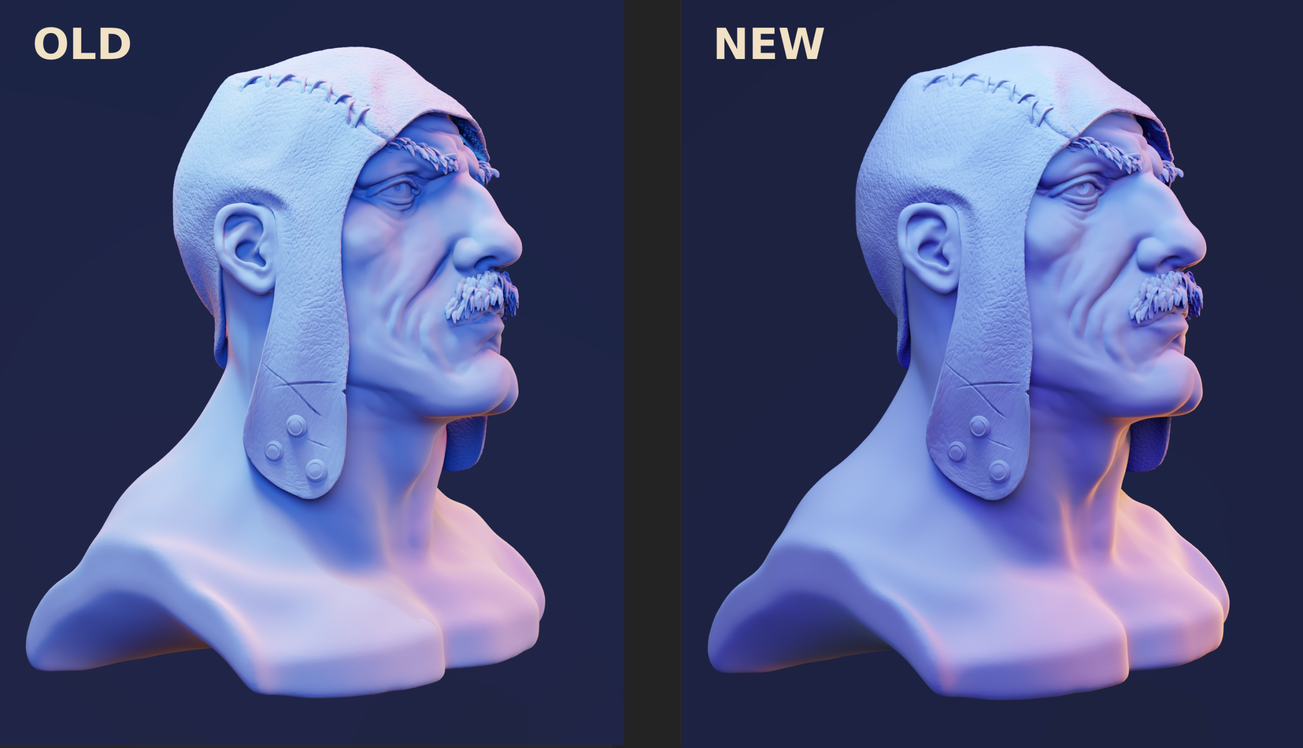

              Week 3 – Act 2
              I decided not to get defeated by Eevee’s harsh shadows – and lo and behold, I won this round. Sort of. Maybe.
              The character model I used is “Male character head” by flioink and the target image is “The Captain” by Matt McDaid. Rendered in Eevee, using an HDR, 4 area lamps, 1 point lamp. I originally had 2 probes, but they somehow made things worse, so I deleted them.
              There are couple of things that are different, most notably the dark shadow under captain’s chin, which is missing from my version. I *think* it’s there because of captain’s chiselled features. Another difference is the surface detail. The captain is  very smooth, which (again, I think) makes the reflections look sharper and brighter than those on the detailed cap of the other character.
              However, it can also be me not doing it right, so once again, if you have tips for me to improve it, please don’t hesitate to send them my way.
              EDIT: Added new version, see the post below.
              #42527
              smurfmier1985
                @shiennar Very close! I think the goal image has a bit more purplish hue on the back, looks like yours is a little bit bluer (just a very tiny touch), but still extremely close. I’ve done them too in eevee so I know it’s not easy with all those extra settings, kudos to you for trying again. The result is worth it, great job! 😄

                  #42529
                  yukino hatake
                    @shiennar looking really good. amazing work agian . one thing i noticed is that at the back of youre model you have a pinkish rim light at the nape i think its called (or more a bit above it actually) but its someting really small . else its really perfectly done
                    #42530
                    Katerina Novakova
                      @yukinoh1989 Hmm, good call, I didn’t notice that. Must be the right lamp reaching too far. I’ll try to give it another go tomorrow. Thanks. 🙂

                        #42532
                        yukino hatake
                          @shiennar np at all . guess indeed that should be the issue . but even with that the lightning match looks really wow .
                          You sure are tallented 😀
                          #42533
                          Katerina Novakova
                            “I’ll just have a quick look if I can improve this…”
                            [Many iterations later]
                            I think this is an improvement. Maybe? I can’t tell anymore. I was trying to get rid of the pink area at the back of the neck, get the front of the neck closer to the original, and remove the harsh shadows from the top of his face. This is especially tricky because of the cap, but it will have to do. Also, the pink lines at the very left and bottom of his neck come from the HDR and I just didn’t find a way of removing them. So, here is the comparison of what’s been changed.
                            #42534
                            yukino hatake
                              @shiennar the new one looks better. Really nice work.
                              #42535
                              Grady Pruitt
                                @shiennar Hmmm.. the Goal is more chiseled and stylized than yours, so which is better might be a little harder to judge, but I guess the new one is closer to the original. that said.. I’m debating on whether I like the extra light highlighting the cheeks on the old one or the shadows deepening in the creases in the new one.. both are appealing to me 😀
