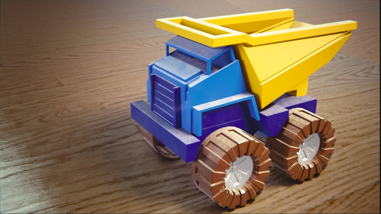

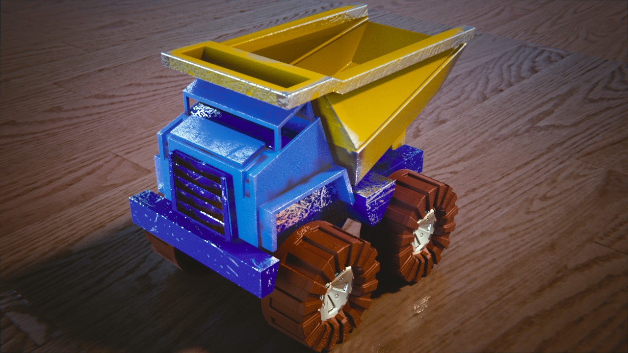

        Hi there. I decided to recreat Toy Truck as old metal toy. I am trying to make dust, grime and scraches without creating special textures like in tutorials for begginer cause I don’t know how to make them. I used wertex paint option “Dirty vertex colors” for dirt and noice texture. Its not the greatest so if anyone would have some other ideas I will be happy to listen (or read) them.
        For scraches I download a free texture. I want to use “pointiness” value (pink group) to get more scraches on the edges. I don’t know how to connect that to the rest and make it work.
        Could someone help me pls 🙂
        #42428
        smurfmier1985
          @dragonice69 Hi dragonice! I’m not a shading expert (more beginner 😛), so I’m using this tutorial on YouTube to create procedural grime and scratches on my truck, by far the best explanation I found on YouTube on how to do this! And it uses the pointiness. Funny enough it’s made by cgcookie instructor @jlampel so when I recognized his voice I knew it would be good 😬 Hope this helps you too! It might at least give you an idea on how to use the pointiness and how to connect things, if you want to continue on with what you already got instead of changing it all to what he does in the tutorial.

              #42431
                @dragonice69 Just some tips: The pointiness value can often replace the dirty vertex option – less steps to go the pointiness route. And you can simply think of it as a black-and-white mask (or factor) for a mix color node or a mix shader node. The same way you’re using the dirty vertex colors in your current node.
                Does that help?
                #42432
                Dragonice
                  @theluthier I already made that change cause I noticed that I can manipulate settings easier with pointiness.  My tree is getting bigger one minute after another 😀

                    Dragonice
                      OK so. I have couple problems I dont know how to solve.
                      1) Pointiness is not working exacly as I would like it to work. As you can see sometimes only edges have scraches but sometimes whole side. Also I wish to know if there is an option to deselect part of a mesh. Like here there is this part above wheels that if child won’t scrach it in purpouse should be rather smooth.
                      2) I don’t know why texture on wheels is streched around. I wanted to apply mirror modifier like I did to other parts but I’m getting an error saing “Modifiers can not be appllied to multi-user data”. I remeber that this was to do with linked objects and data but don’t know even if  that will help.
                      I would love to link in here my blend file but don’t know how 😀

                      #42435
                      silentheart00
                        @dragonice69 Hey, looks like a good start!  You can assign different materials to the same mesh by having multiple material slots, selecting the material you want, select part of the mesh, and click Assign under the material.
                        What are you trying to do when applying the mirror modifier?  What’s the thought process there?

                            #42438
                              First off – I highly commend the effort to add wear and tear to the toy truck. You’re on the right track for sure. Unfortunately you may be approaching the limits of procedural grime/scratches, especially in terms of masking. The issue you describe of needing to exclude a certain area is tough to do procedurally (without painting custom UV texture maps)
                              Silent’s suggestion is valid about assigning a different material to the faces in the wheel well that you described. You could duplicate your shader, remove the scratches component from the duplicate, and assign to those specific faces.
