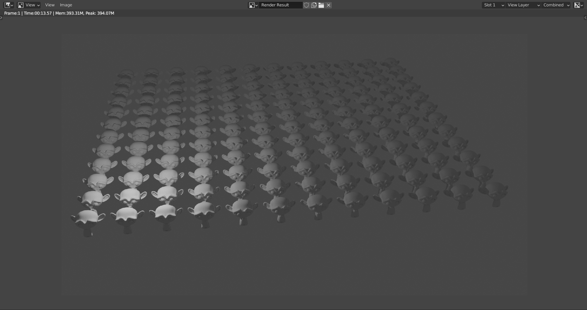

          @theluthier that is crazy, I get these results:
          – Subsurf followed by two Array Modifiers:
          and Subsurf with linked duplicates:
          So, linked duplicates are worse on my machine!
          Maybe that is because I am using only my CPU????
          (What was to be expected: when first Arraying the monkeys and then Subsurfing them is a lot worse!)
          #57692
            And yes, the twelve times twelve monkeys was deliberate;)
