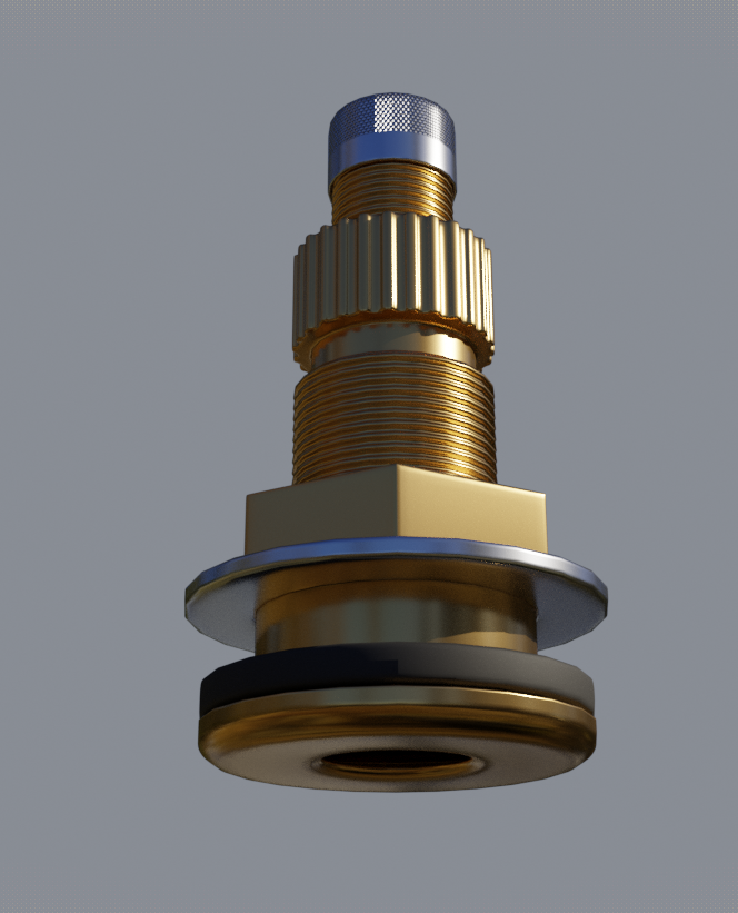

      Just a fun little modelling exercise:
      but of course complete overkill! Made some adjustments on the tires; looks better now, I think:
      #57675
        Is that screw thing a single contiguous mesh??
        #57676
          Most of the Valve is one mesh, yes, just the metal ring and the cap are separate:
          Not even an actual screw thing, the windings are fake, they do not spiral, which is a lot easier to make and when it’s on a small enough object with very ‘shallow’ windings, nobody will notice.
          #57677
            I’m impressed. The non-spiraling threads fooled me. Vertical and lateral threads in the same mesh is not easy. You’re a topology wizard, sir 💪

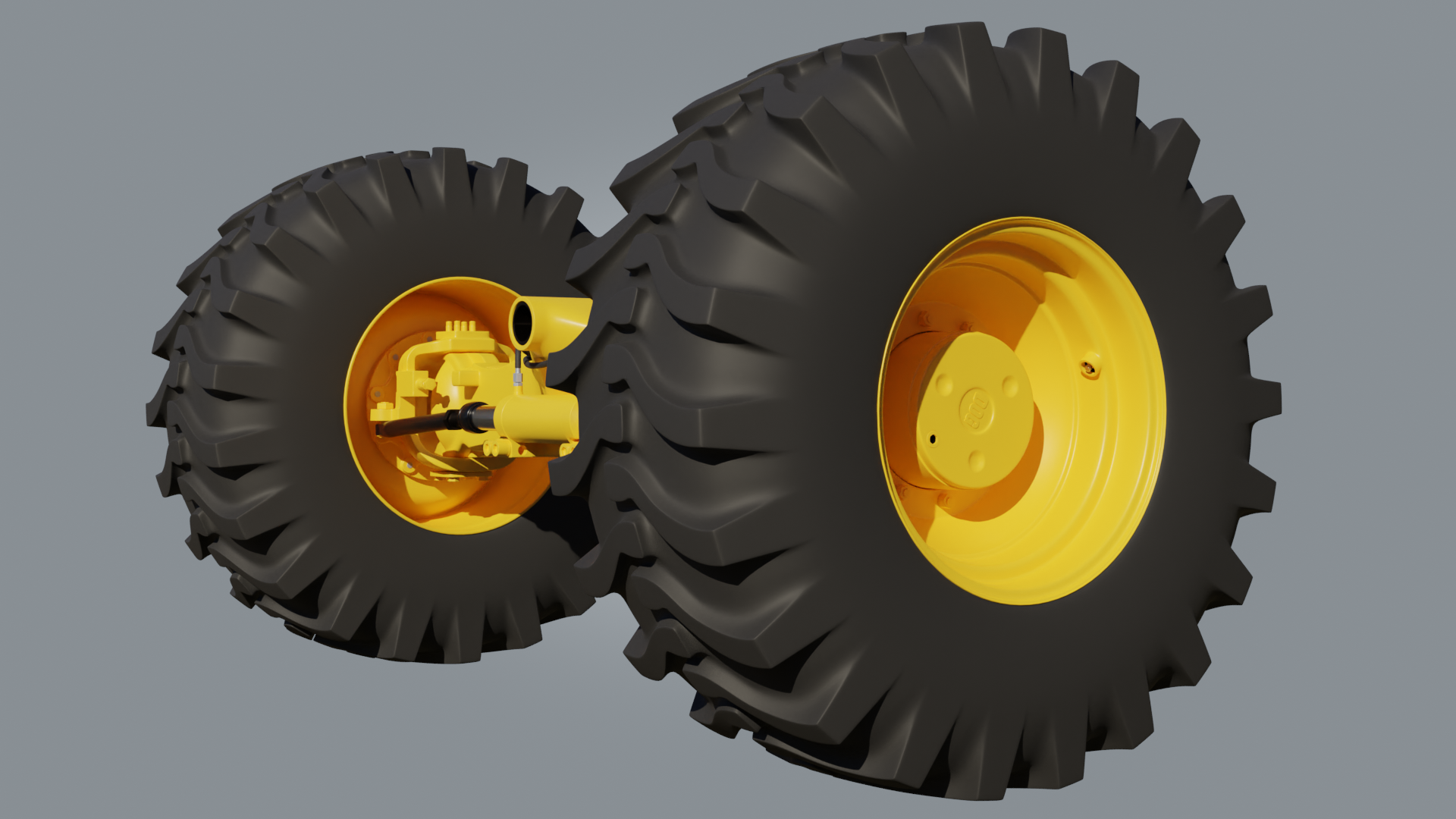

              One more piece:
              that is hiding out here:
              Some statistics included; the wheels have about the same amount of Vertices as the axle.
              The second image is with the ‘new’ Viewport Denoising, which is horribly slow on my machine (can’t use GPU, it’s too old), but still very impressive for 4 Samples!
