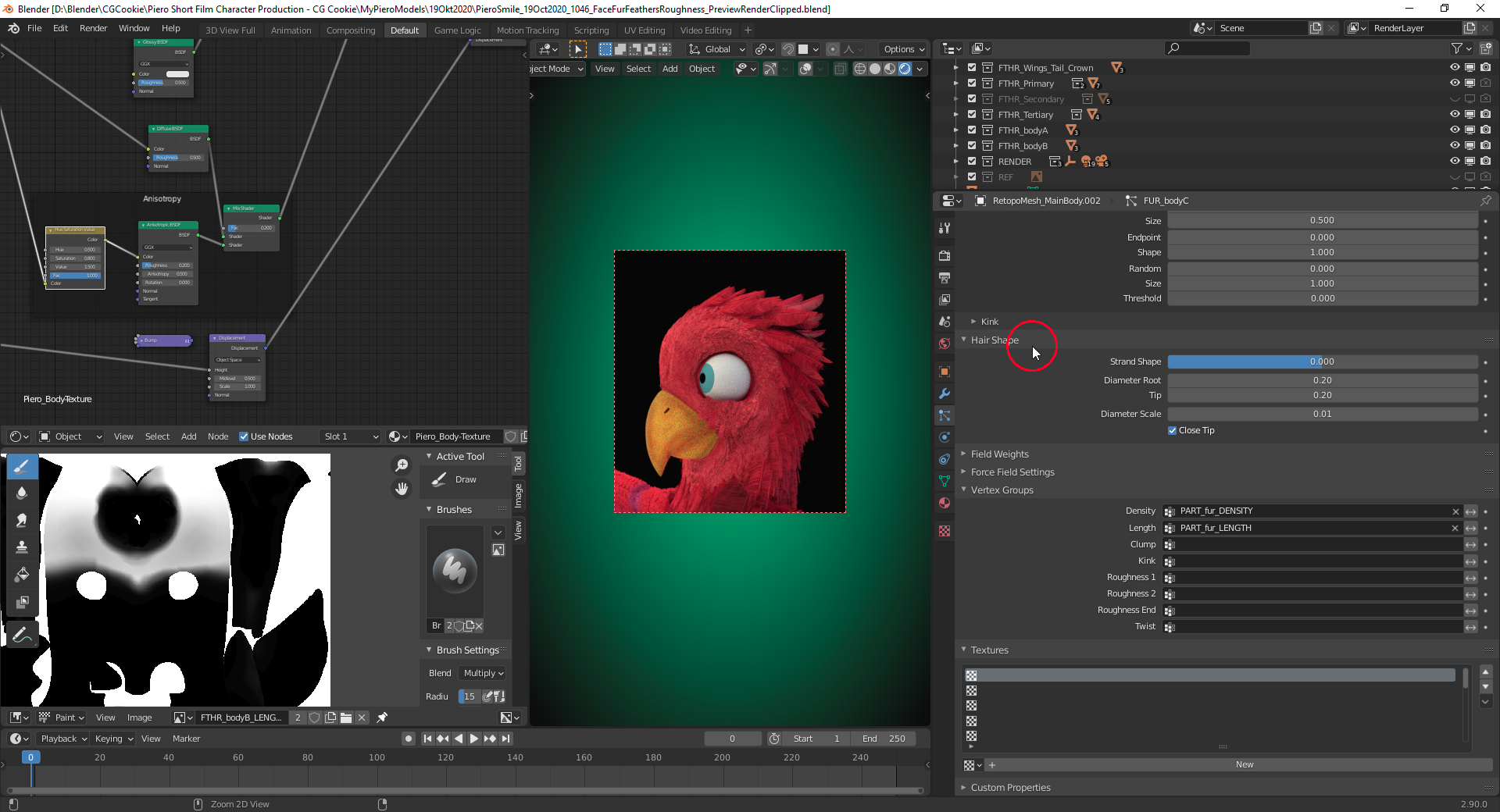

      In Blender 2.90, you can find the “Cycles Hair Shape Settings”  in the “Hair Shape Panel” of the “Particle Properties Tab” of the “Properties Editor” …

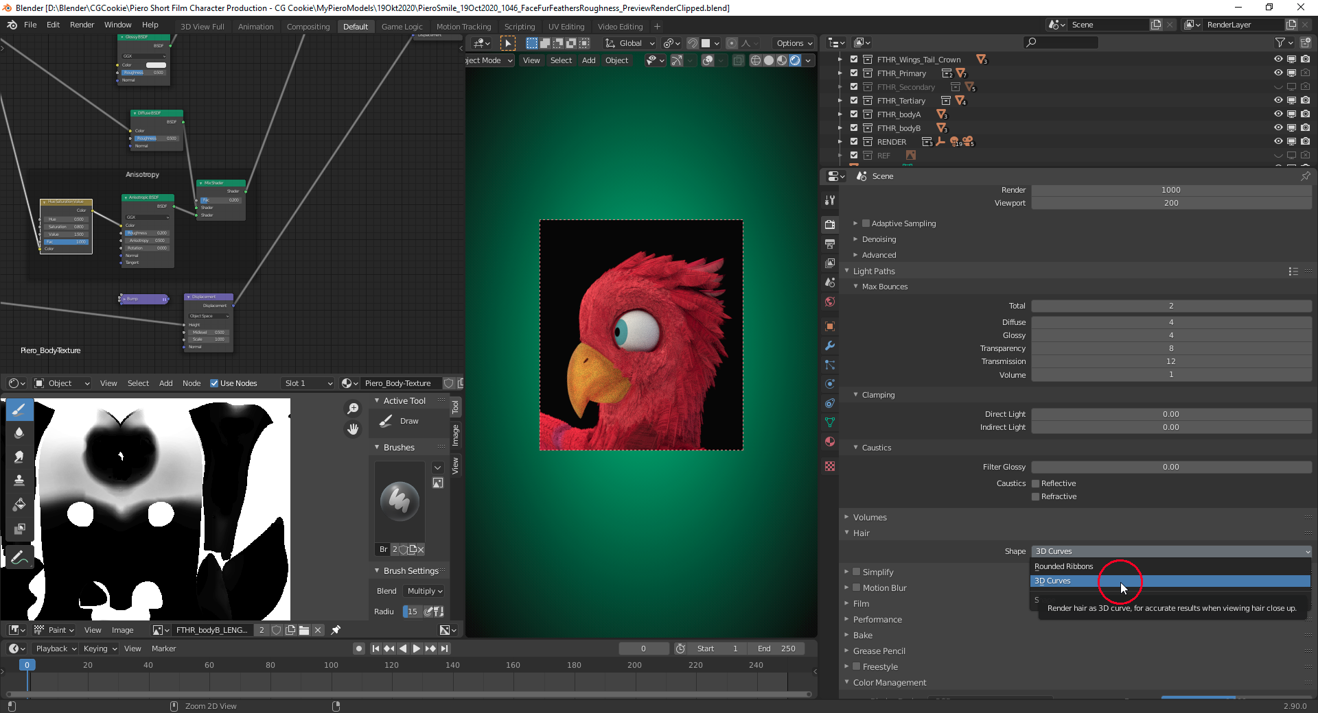

      … as well as in the “Hair Panel of the “Render Properties Tab” of the “Properties Editor” where you can now choose between “Rounded Ribbons” and “3D Curve”:
      “Rounded Ribbons” offers you a setting for “Steps” whereas “3D Curves” automatically tries to smoothe it as much as possible.

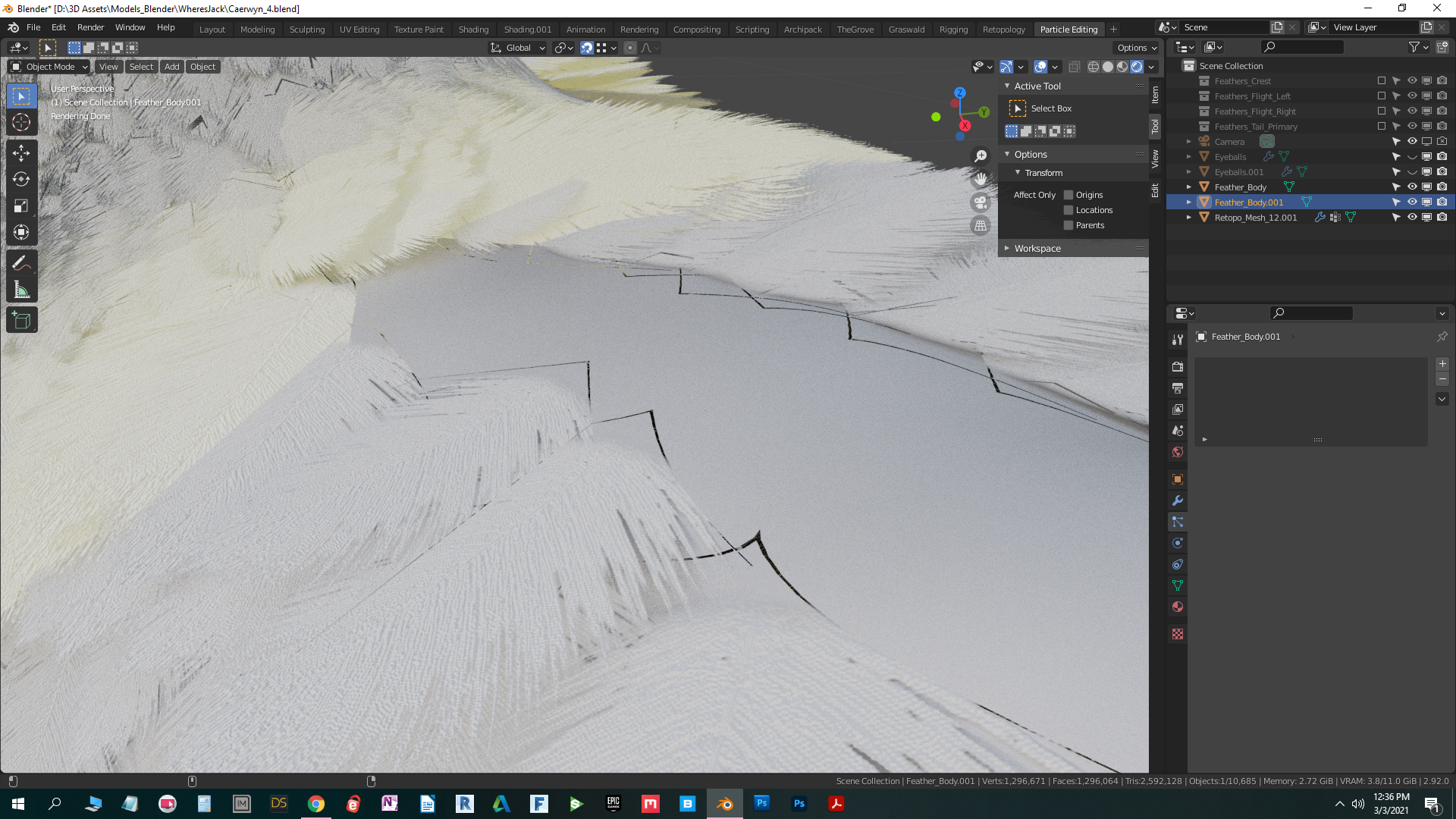

                Ah, yes, I’d seen that thread before, and then forgotten. I removed subsurface scattering from the hair texture, but I also had to uncheck “From instancer” in the texture coordinate node. So that’s only required for particle hair systems that are using objects rather than just the hair strands? Anyway, it’s solved for the hair strands, thank you! I’m still having problems with the feather objects, but I’m now pretty sure it has nothing to do with the instancer, but with the feather textures or mesh. The dark lines appear where the mesh intersects with other objects, as you can see in the image I’m attaching. It’s only visible in cycles.
                #61033
                bkol
                  So, apparently, this has been a problem in cycles for years, where a transparent object has a black line where it intersects with another object. Doesn’t look like they’ll be fixing it very soon. Someone on the first thread suggested trying to mask part of the mesh with vertex groups, but I tried, and if you mask even one vertex of the feather mesh, the whole thing disappears. So, I’m not sure what do do. If anyone has any suggestions, I’d love to hear them!

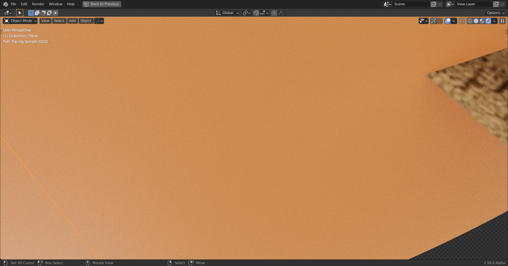

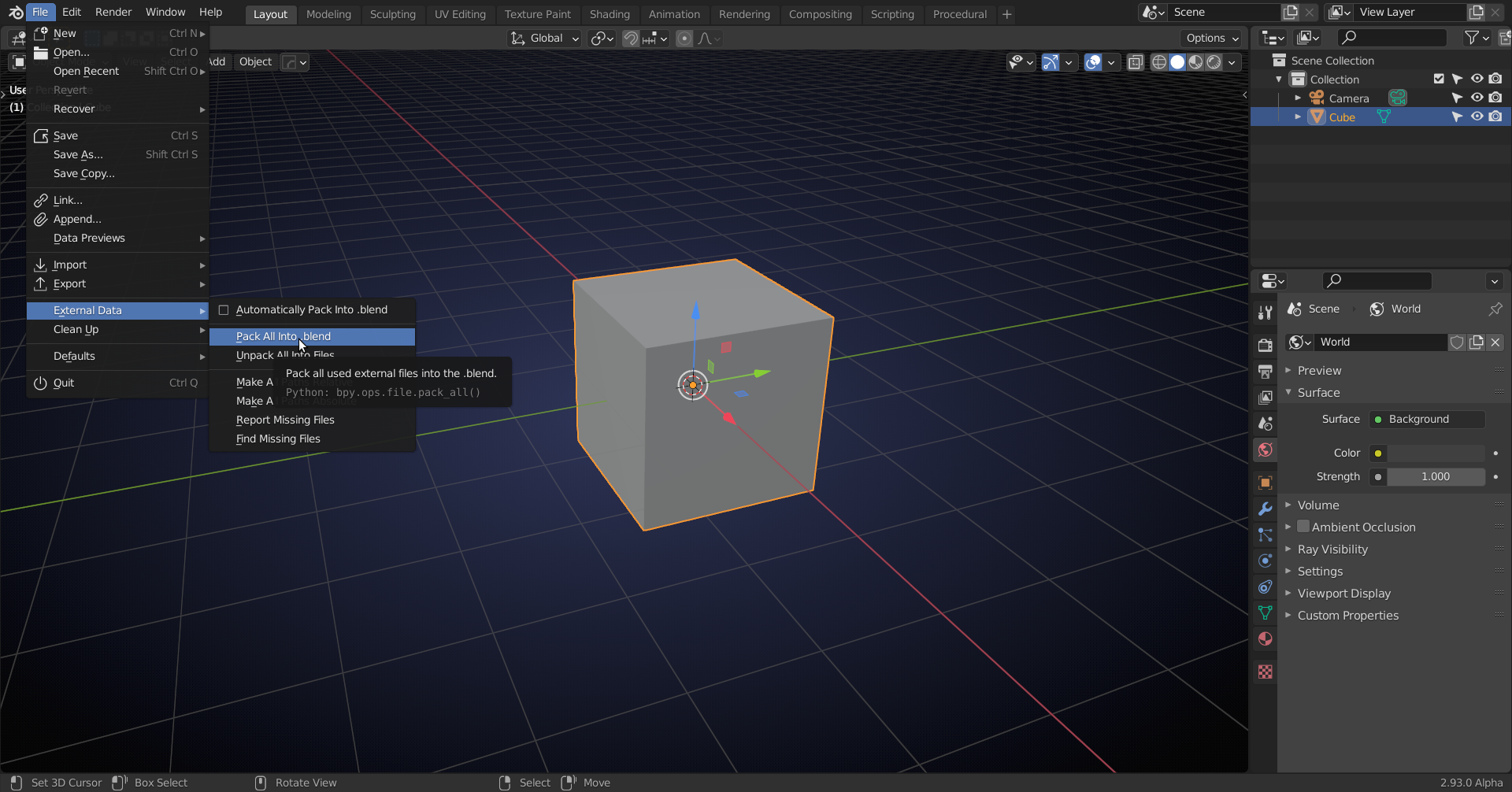

                    @bkol could you provide us with a link to your .blend file? (Use Dropbox, Google Drive, or any filesharing service). Please include all images:
                    I can hardly see any lines at the intersection, just vey faint and only when zoomed in really far; nothing like what we see in your case:
                    You can probably not even see it here (try downloading the screenshot and zoom in…)
                    From further away:

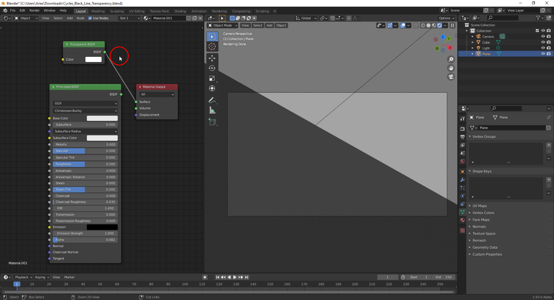

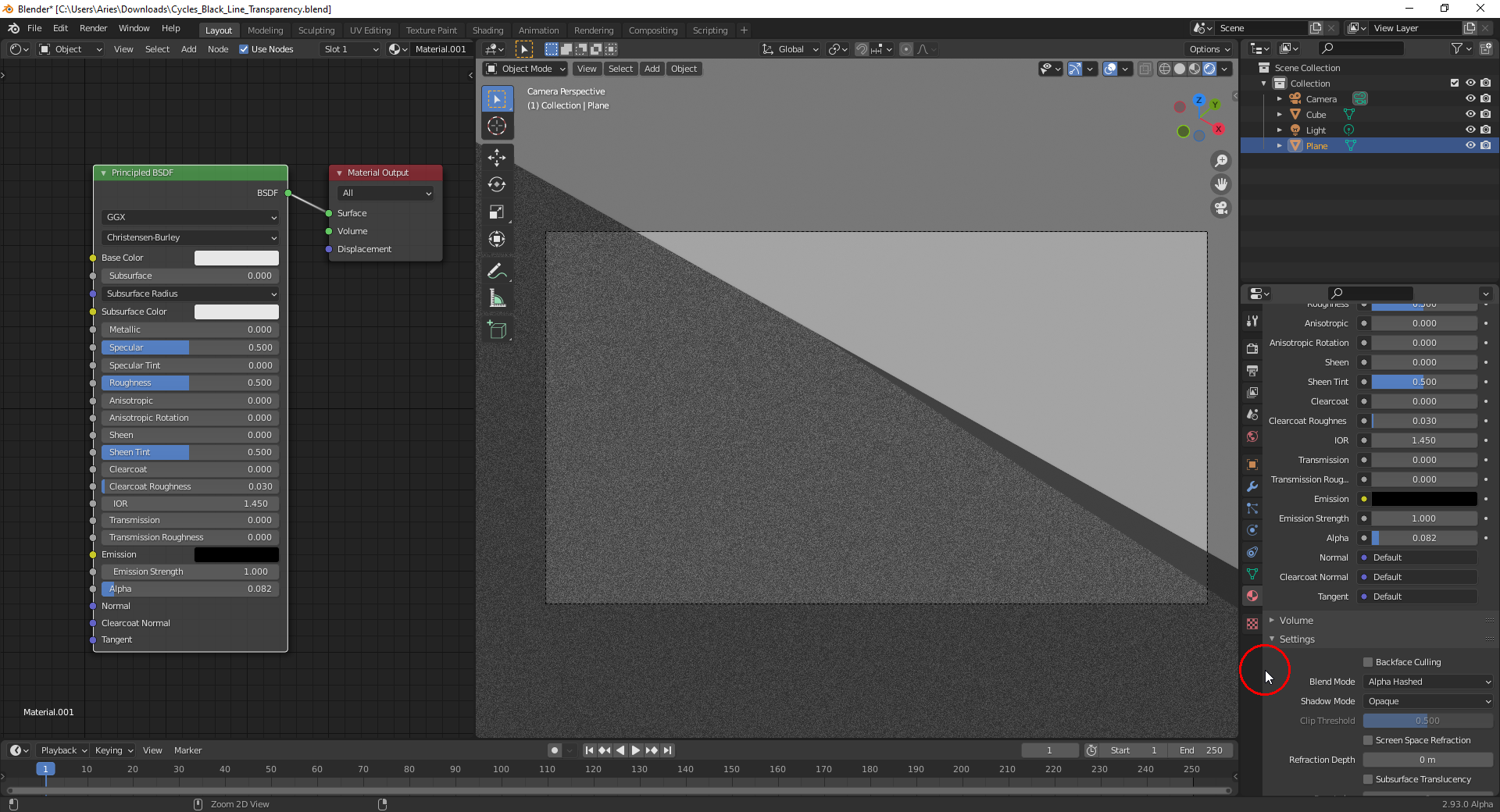

                      @bkol The “From Instancer” box must be checked only if you use the hairs for duplicating objects and it works only with Cycles. Hair strands alone automatically pick the color from the lacation where they are growing. The black lines in the example file here also appear when using a “Transparent BSDF Node” instead of the “Principled Node”  if the angle between the transparent plane and the intransparent cube of that file is very small:
                      #61036
                      Ingmar Franz
                        I’v just seen that the camera in the example file here has an extreme focal length of 400 mm and is very close to the object:
                        Lowering the “Clipping End” value of that camera makes the intersection line appear grey instead of black:

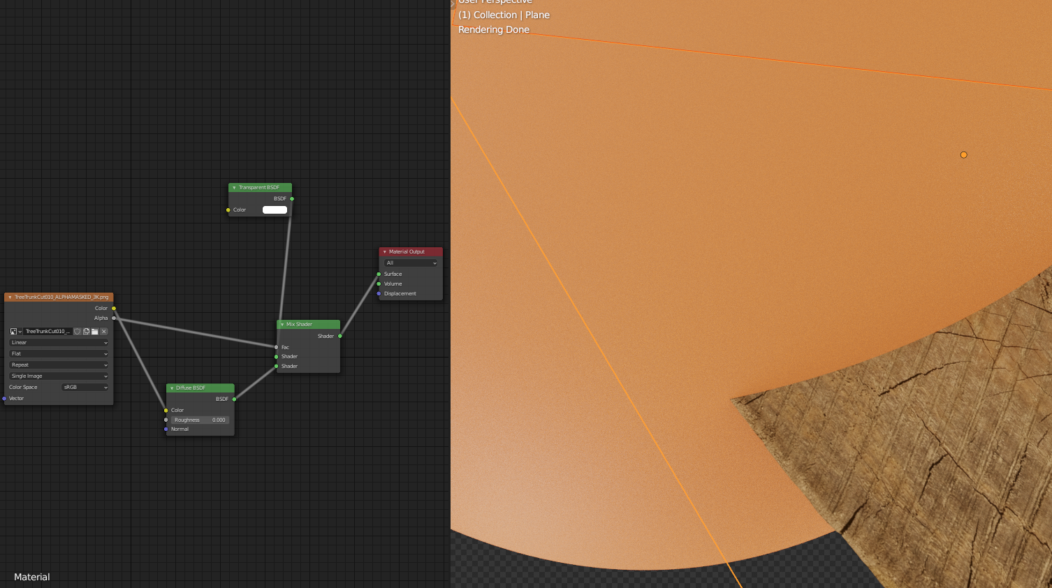

                            These black lines at the intersections of transparent objects with other objects seem to be a problem of Cycles since when I switch to EEVEE and set the “Blend Mode” for the transparent object to “Alpha Hashed”, these lines disappear:
                            But EEVEE can’t be used for inheriting colors from the instancing object. So it’s not an option for the bird’s feathers.

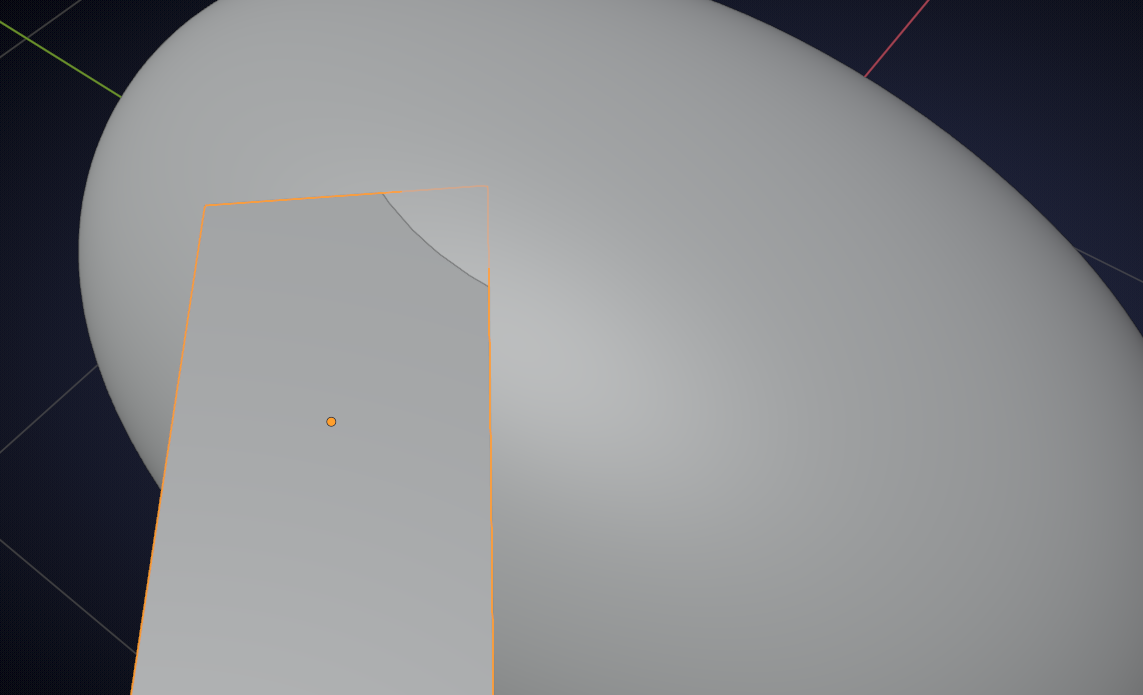

                                @bkol I really don’t think the intersections are what’s causing those lines in your case!
                                A plane would intersect differently:
                                and your lines are way  too thick.
