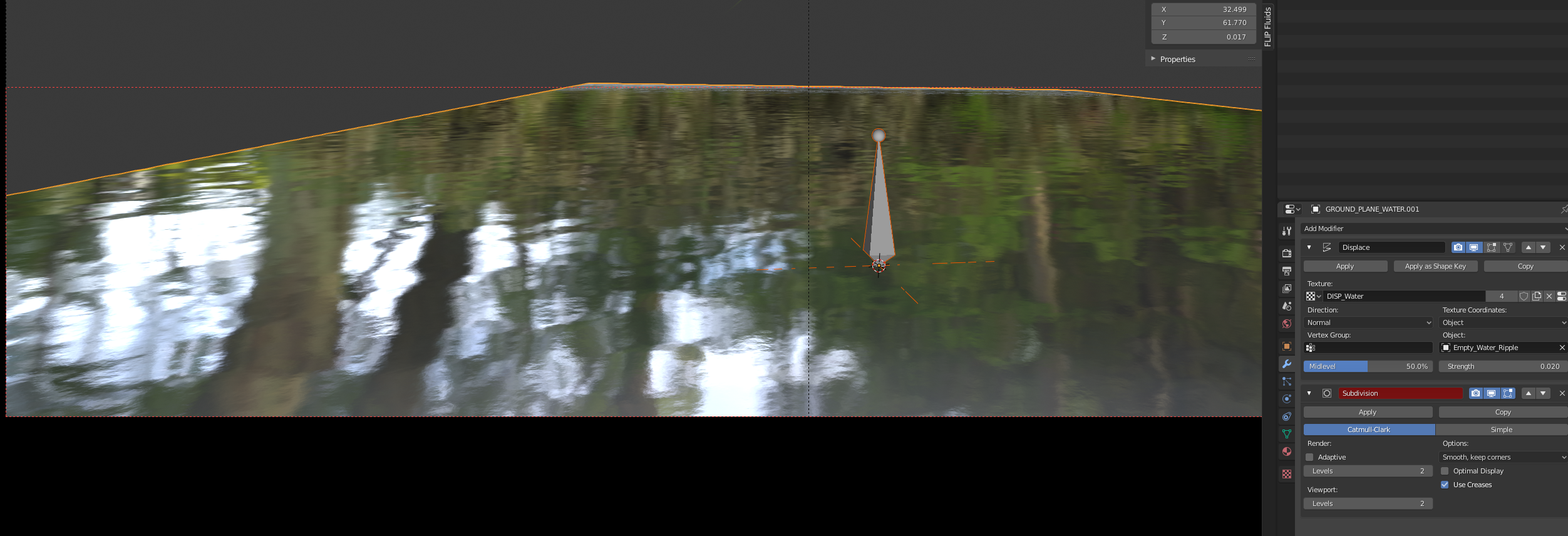

      As you can see from the scene below , I have a plane setup to simulate a lake :
      The plane is using a displacement mod to simulate water ripples. The displacement texture is animated by means of an empty that is parented to a bone in an armature. I have set the bone to rotate on its Y axis 360 degrees so that as it rotates full circle , it creates a looping seamless animation of the water rippling gently.
      This is all good , however, I have to make the whole rotation 3500 frames long to get the water ripples to go slow enough to look the way I want. However , as this animation is to be used in game , I really need it to be 48 – 96 frames max. The issue I have though is that I can’t find a single section of the 3500 frame animation where I can cut such a segment from that gives a believable loop that does not jump.

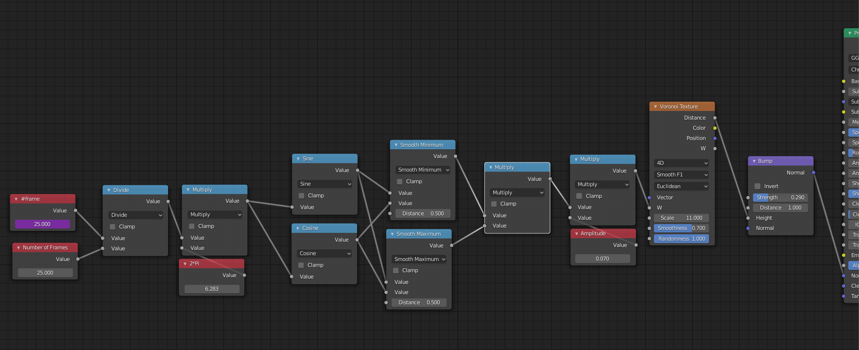

              Well, if you want to use a Shader for the displacement, you might be able to use this Node setup (the second, improved one):
              https://blog.cgcookie.com/forums/topic/collab2021-wip-phoenix4690/
              This works because we now have 4D Textures
              #53560
                Ahhh I forgot about your thread. Great suggestion spikey 🎯
                #53561
                  The above mentioned node setup for looping  a noise texture was made with the procedural fire by @theluthier in mind and gives a choppy effect. So here is a smoother variant that is more suited for a water surface:
                  By the way if you take a Value Node and type #frame in the number field, Blender automatically sets up a Driver for you….
