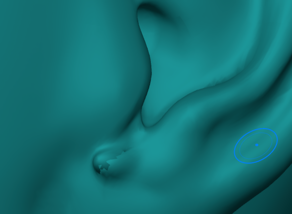

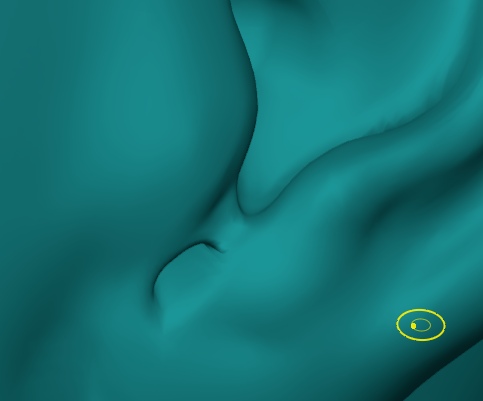

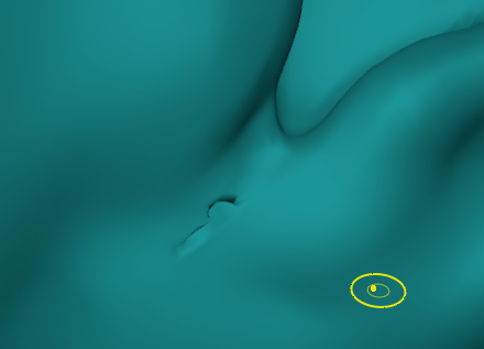

      When I gave my model the multires modifier and let it rebuild the subdivisions, a small hole appeared in the ear. The hole was not there, as I projected the details via shrinkwrap onto my low poly model and there is no hole in the topology.
      When I try to smooth it out, the hole gets bigger:
      Inflate doesn´t work either D:
      How can I get rid of this?

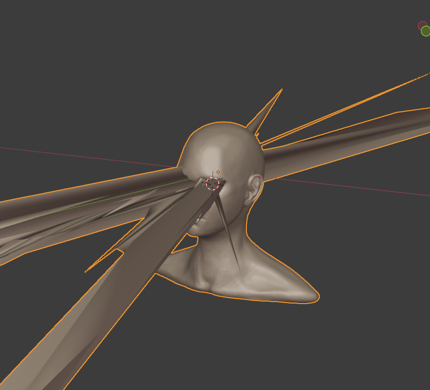

          And now I also have the “silly bug”, which won´t go away either. Just as I finished the first detailing pass :((
          #71935
          Adrian Bellworthy
            Oh no!
            Have a look at this Silly Bug response from @theluthier ,
            Hope this helps.

                The multires “reset” method might fix your issue if you find the behavior kind of buggy, but it looks like this artifact appeared as a result of rebuilding subdivisions.
                It looks like this hole is the base of a multires “spike” artifact. Can you confirm by looking on the inside of the head for the point of the spike? Such spikes are an annoying multires bug but they can often be smoothed out as I did in chapter 3, lesson 10.
                #71938
                Ingrid Frank
                  @theluthier thanks for your reply! Yeah it´s one of those spikes. I am able to smooth it out in sculpt mode, but as soon as I go back to object mode, the spikes – the hole in the ear and the ones around the eye – reappear…

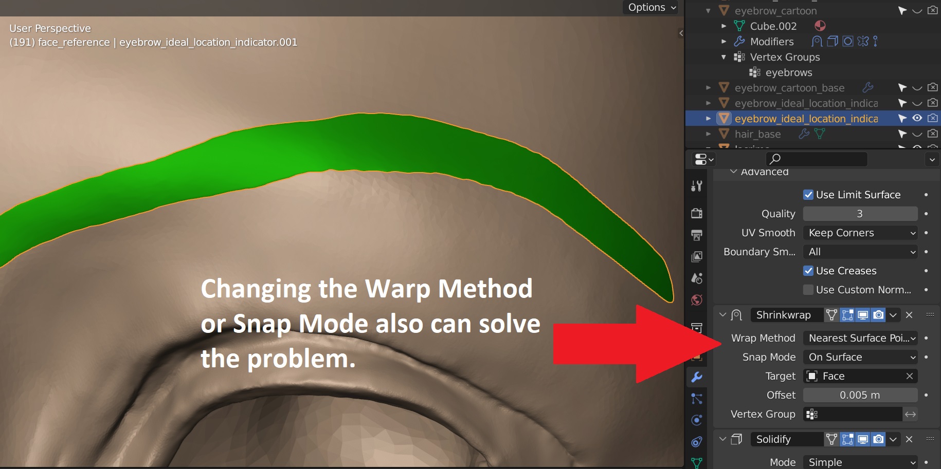

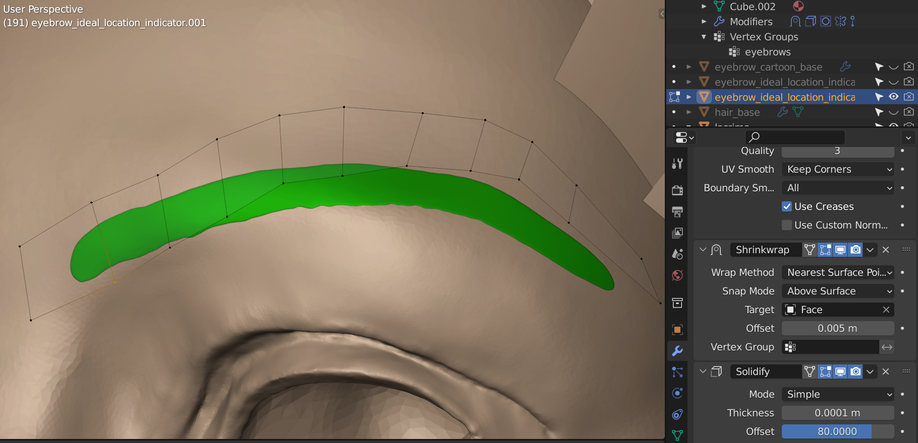

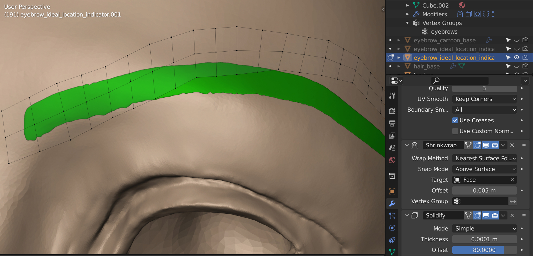

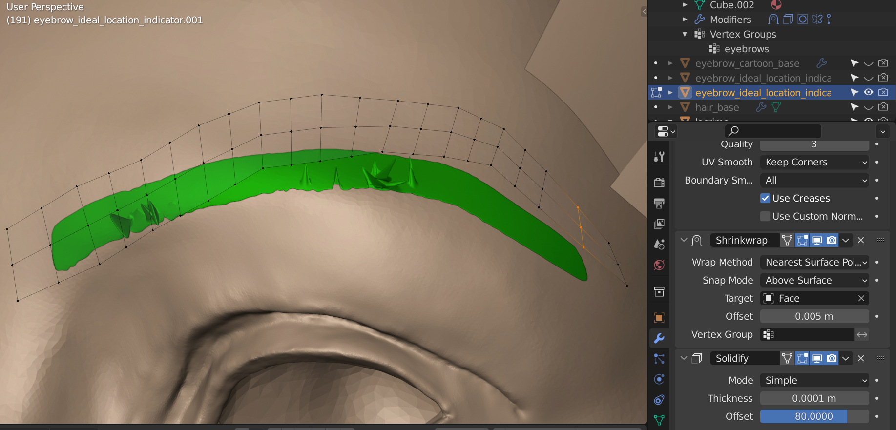

                            naiad
                              I recently discovered that the spikes can be generated even without using multires modifier.
                              Let’s take a look at the following example:
                              The eyebrow made by a separate mesh is shrinkwrapped on the un-retopologized head.
                              The small spikes are generated after adding loop cuts on the eyebrow mesh as the following screenshot shows:
                              Now, let’s select the head and go to the Sculpt mode and turn on the Dyntopo. Use Draw or Simplify brushes to remesh only the area where the spikes occur. After that, go back to the Layout or Edit mode, and the spikes are gone. (If they are not gone, then repeat the process several times.)
                              My Conclusion:
                              In my cases, the spikes are caused by:
                              1, the algorithm of the Shrinkwrap;
                              2, the haphazard locations and shapes of the polygons from the head;
                              3, the relatively denser loop cuts of the eyebrow mesh.
                              The spikes can not be generated if any one of the three causes is eliminated in my case.

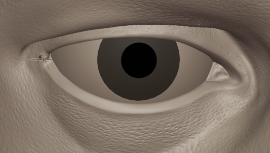

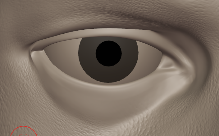

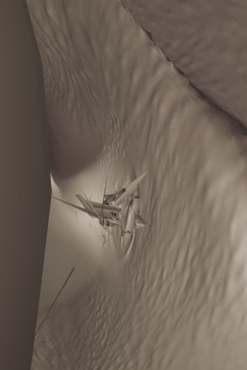

                                I also suffer from the silly bug (working with Blender 3.0) everything was ok until I’ve noticed a pinch in the corner of my eye, after I used smooth brush and my silly bug appeared..… honestly I’ve  tried everything you guys suggested and nothing works:(
                                Is there any way to salvage it or should I just leave the pinch and re detail the eye?,,,
                                annoying pinch  -_-
                                 Silly bug
                                #71946
                                Adrian Bellworthy
                                  You could try using with the clay strips brush lightly just in the area where you have the issue., then smooth it back and reshape the corner of the eye.
