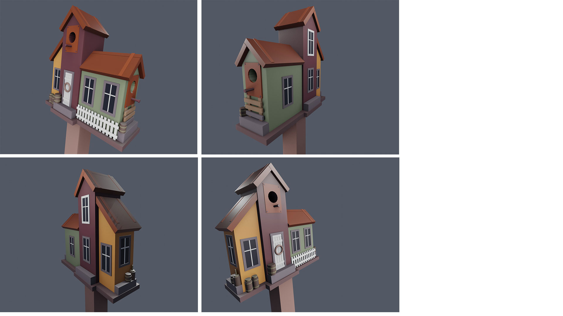

                    Here’s my homework/exercise submission for the first week. It’s a birdhouse. I did it in Blender 2.8. I edited a version for Sketchfab, because the file would glitch out in Sketchfab. I could not upload the blender 2.8 file directly to to Sketchfab. I exported the file to Alembic (*.abc). Also I had to edit the blend file several times, and replace a few cubes, because it wouldn’t export correctly to Sketchfab.
                    Here’s a few pictures:
                    Here’s my Sketchfab file:
                    Here’s the blendfile. It’s for Blender 2.8. Let me now if the link works. It’s the first time I shared a link from my NAS. I’m not sure this link will work.

                      @carrotnl I’m curious what kind of specific details prevented the model from loading correctly in sketchfab.  Could you talk about the problems and how you solved them?

                        @silentheart00 When I tried to import the Blender 2.8 file in Sketchfab it gave an error when interpreting the file. I then tried the only two exporters available in blender 2.8;  Collada (*.dae) and Alembic (*.abc).
                        The first one did import, but only a part of the model was visible. When I activated wireframe I saw only the edges where there but more than half of the faces where gone.
                        When I imported the Alembic file, it worked, but some of the faces where glitching out a lot. I later found out that some of the objects (the tops of the middle and the right part of the house) in my scene had errors in them (not visible). When I replaced them with new objects it worked a lot better. Then I still had to edit the parts I used the bools on so they only contained quads.  Then the model displayed correctly.
                        I canceled the bool modifiers in the walls behind the plates with the holes to keep the mesh simpler, else I had to remodel a lot of stuff in edit mode to let the model be watchable in Sketchfab.
                        Earlier on I had some crashes when turning on the Eevee rendered view ( because earlier I used OpenGL mode). I suspect the errors in the data where generated arround that time, or maybe where the cause of the crashes.
