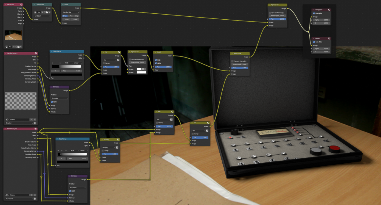

      I motion tracked footage with table, where I wanted to composit modeled case with shadow catcher etc. In compositor preview (Viewer node), all look very good – just like intended. Node tree attached:023-08-14 190340.png
      PROBLEM!
      When I hit “render animation”, out of 100 frames only first frame is rendered correctly and EXR size is around 17MB, but I don`t understand, why rest 99 frames come out black and file size is only 51KB?

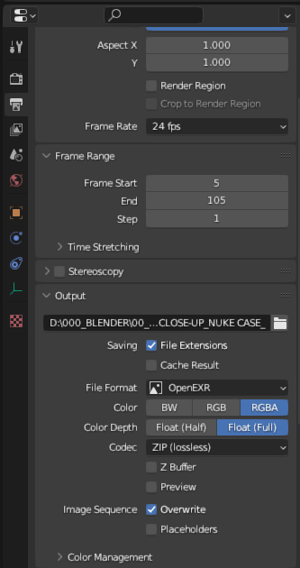

                  1) my frame range is START frame 5, END frame 105, and step is set to 1,
                  2) nop, video sequencer is empty,
                  3) honestly – I`ve never uploaded Blender files here before – can you give a hint on best way to do it?

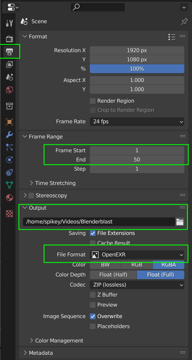

                    Hi Gatis,
                    Call me stupid, but maybe like this:

                        All I want is to learn this case and understand the issue…. Here are my settings – I see, that they are the same as in your screen shot!
