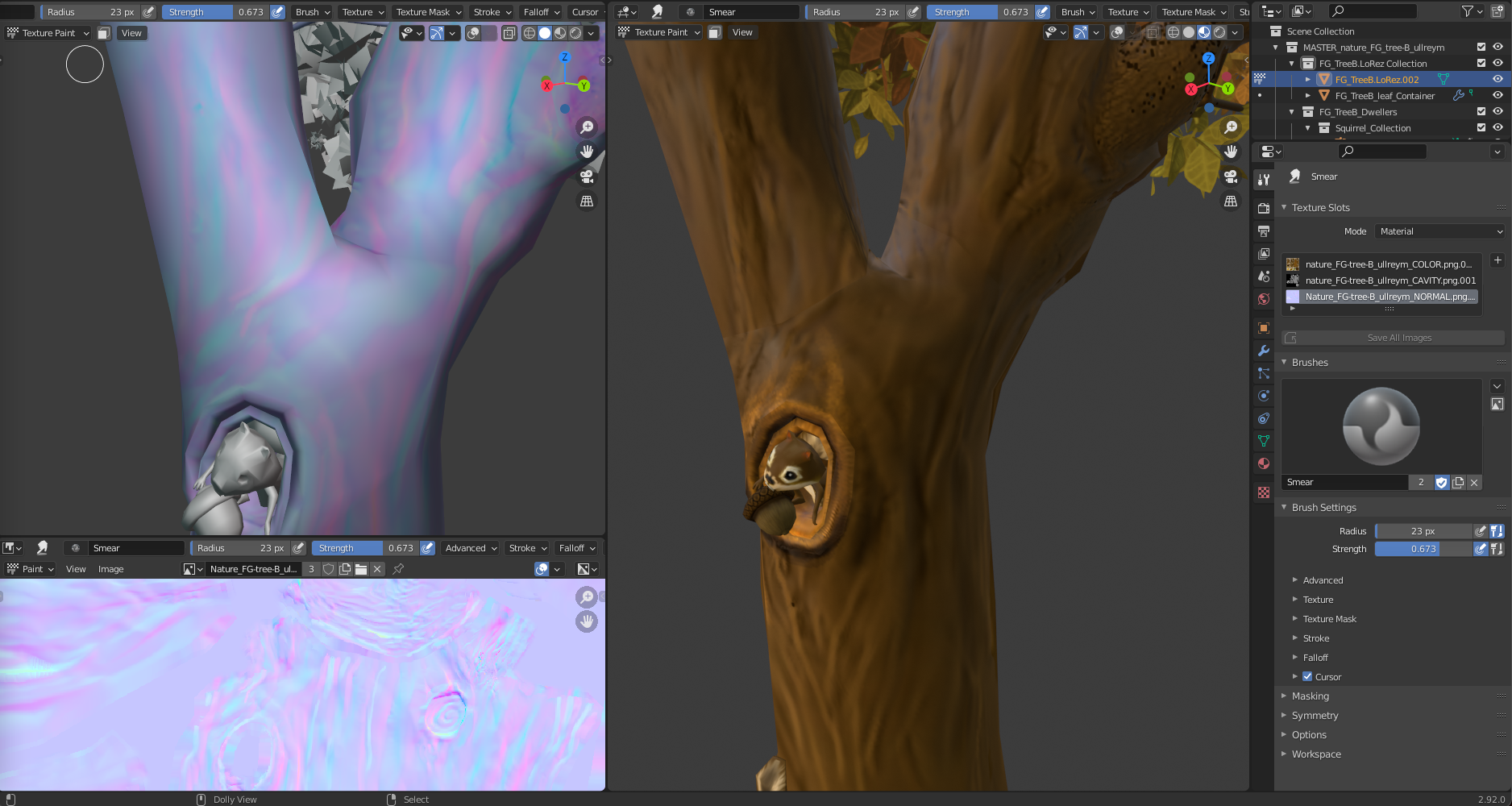

        @ullreym , this tree is incredible! Top notch work sir, and that would be the case even if the squirrels weren’t a fun surprise on the other side. Full points for week 4 and then some!
        One minor issue I see is a pretty clear seam where the trunk forks right above Peapod. My guess is that it was caused by some of the manual fixing in Krita, and it should be fairly easy to fix in Blender. You can just grab the smudge tool and smear each texture across the seam:
        Once that’s sorted I think you are golden. Nicely done!
        #65454
        Matthew Ullrey
          @jlampel What a cool technique! Smoothin’ the UVs is so fun! I went through and found other seams that I could even out as well. Thanks!
          I have sync’d the new updated files to Google Drive and connected the textures to the geo.
          #65455
          Jonathan Lampel
            Awesome, looks like that did the trick! It may be necessary for the cavity map as well but I think the color one was fine.
