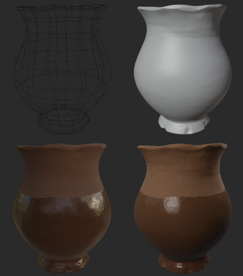

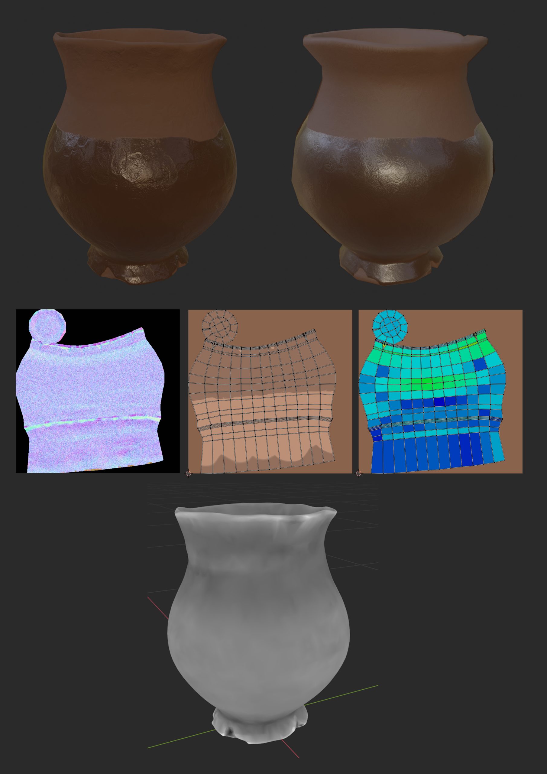

      I’ve managed to get the high res model done to the point where I was happy with it. see image above this message. then, I started on the baking process. 5 hours later I am still working on it. To be honest, I think I have bitten more than I could chew based on my blender capabilities. I thought I understood the process from your live videos, I have even checked out other videos on YouTube, including the CG cookie ones. my problem, I guess is that I don’t have a clue what I want to achieve here (Omar and Spikey have tried to give me some advice too). what I want, in very simplistic terms, is to make the low res model look like the high res one. the only map I have managed to get done is the normal map (not perfect, but just acceptable). when I get to the cavity one, I get stuck. to cut the long story short, I don’t think I will be able to submit my homework on time. I think I need to get away from the PC for a few hours and start from scratch again. I am hoping to have better luck on this tomorrow.

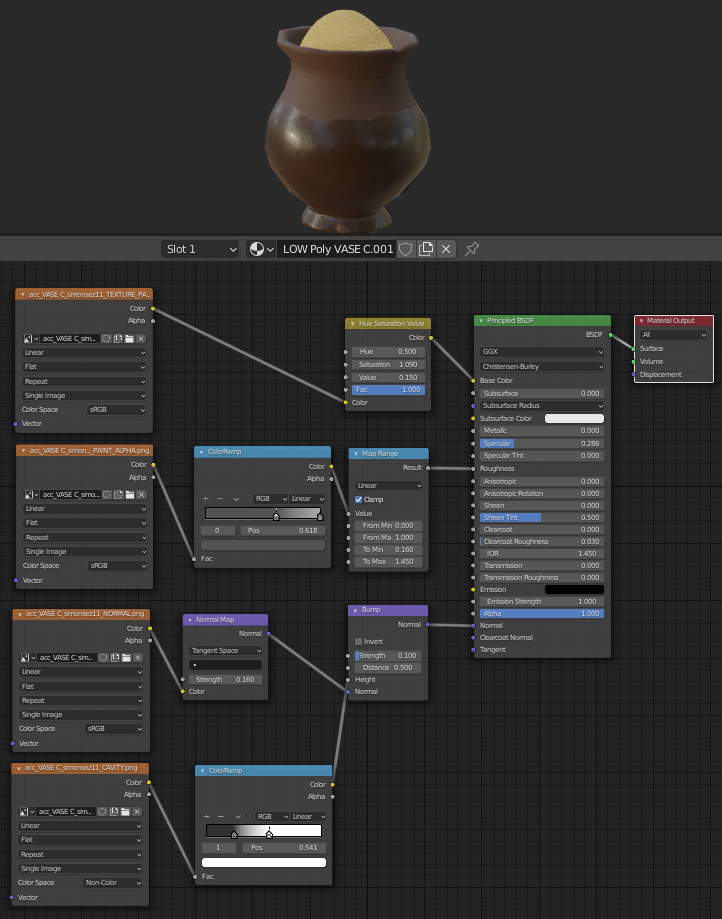

      I have attached here a screenshot of my material setup on the high res model. my problem here is that I don’t even know what questions I have to ask to be able to get any help on this. I will eventually get there, but I just feel right now that nothing I try works. this is just another one of those hurdles of learning a new skill and fortunately I have been in this position before in my life to know that when this is overcome, a lot of things will fall into place after it.

      Ingmar Franz
        Excellent 👍! I escpecially like the fingerprint pattern and the damage parts😀.

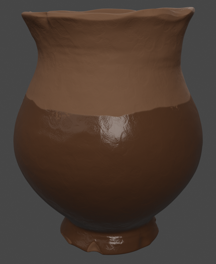

                  I have decided to re-do the vase C from scratch. I think some of the issues I got with the baking process was to do with the modelling.
                  Unfortunately the low res model doesn’t look so great 🙁

                      Ingmar Franz
                        @simonsez11 Wow 😀!  That’s what characterizes a true artist: Redoing a work from scratch in order to make it even better! The low-poly model just needs, as far as I can see it, two or three more edge loops in the mid-section in order to achieve a rounder silhouette. The combined textures themselves are looking fine 👍!

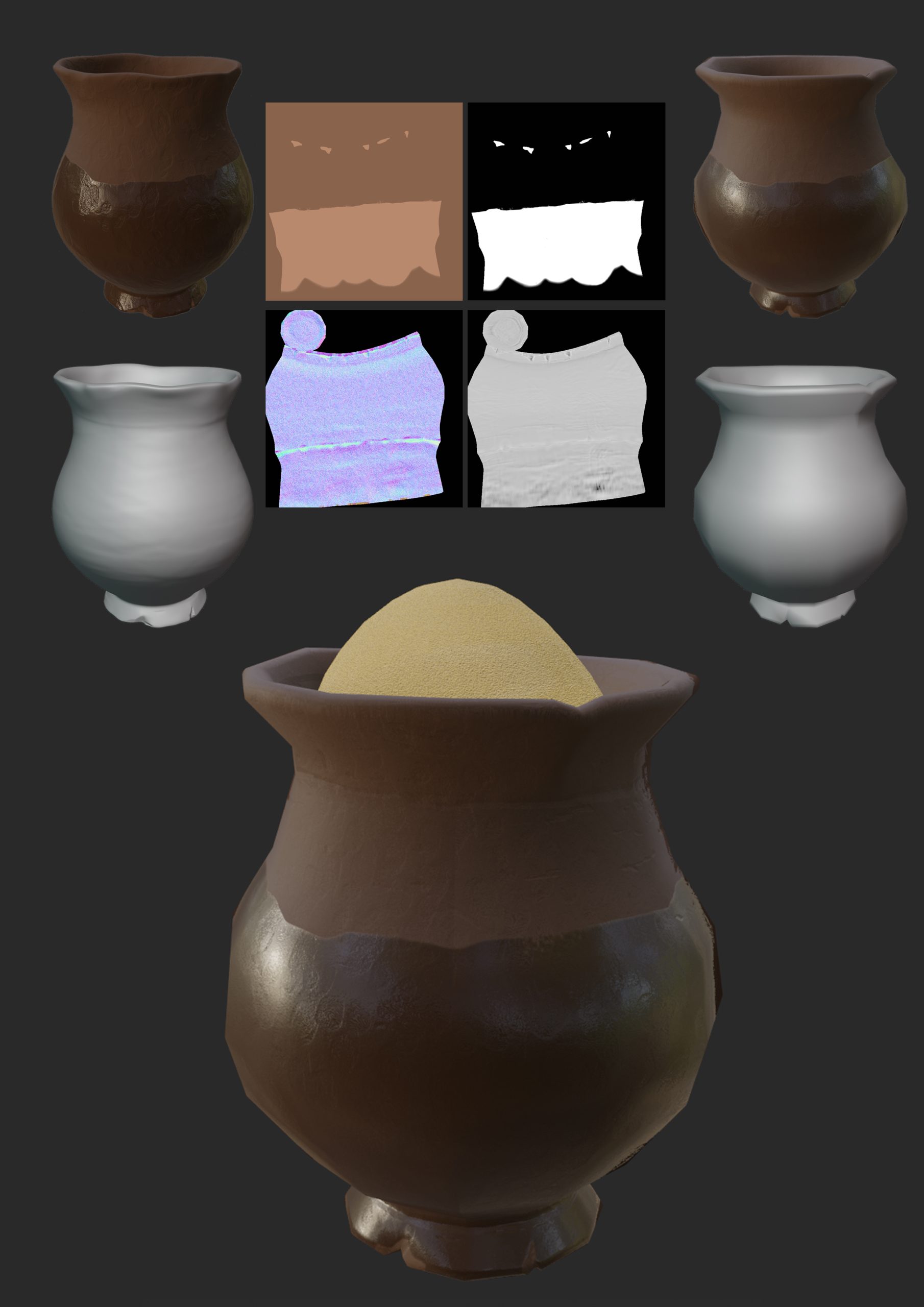

                              HOMEWORK SUBMITION – WEEK 3 – VASE C
                              Hi @theluthier & @duerer  , I have finally managed to work out the baking process properly. I had to re-do the work form scratch twice and had probably 3-4 goes at the baking process of the materials. I got confused because I was using multiple textures to create the final finish of the vase. I think right now I got the balance right. I hope this model will be good enough to make it on the final project. Can you please have a look at the 3D model to see how I can improve it? or is the detail reasonable for the job?
                              Also, is it OK that I have used nodes instead of textures and sculpting to create the spice? or do I need to bake that too?
                              Thank you and I am looking forward to your reply.
