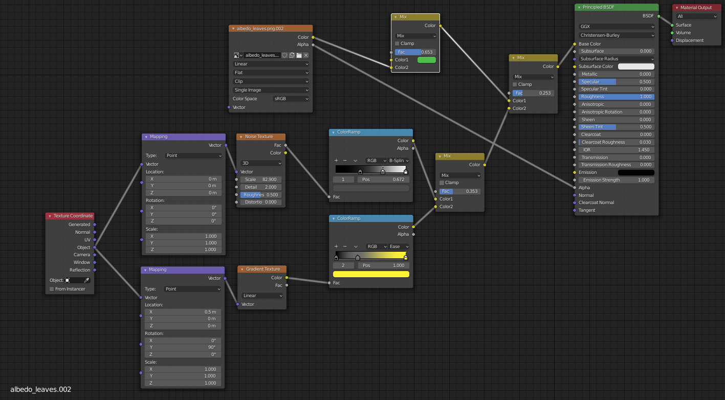

      I reworked the texture entirely going for crisp edges this time, adding small veins but leaving the spots for the moment. Since I’m going to play with scales for leaf variation, I want to have consistent spots as in film grain. I have uploaded the texture in 2k and will shrink it to the agreed 1k once they are finally adjusted.
      While painting, it turns out that I may have gone a little crazy with the gradients, which need to be toned down in the node setup.
      The node setup tones down the heavy gradients of the original texture and provides some spots on the leaves.
      I’ll fix the broken UVs over the course of the next days. I’ll also add the twigs that go every which way and add some loop cuts to bend some of the alpha planes. Your input has already been very valuable! Thanks a lot!

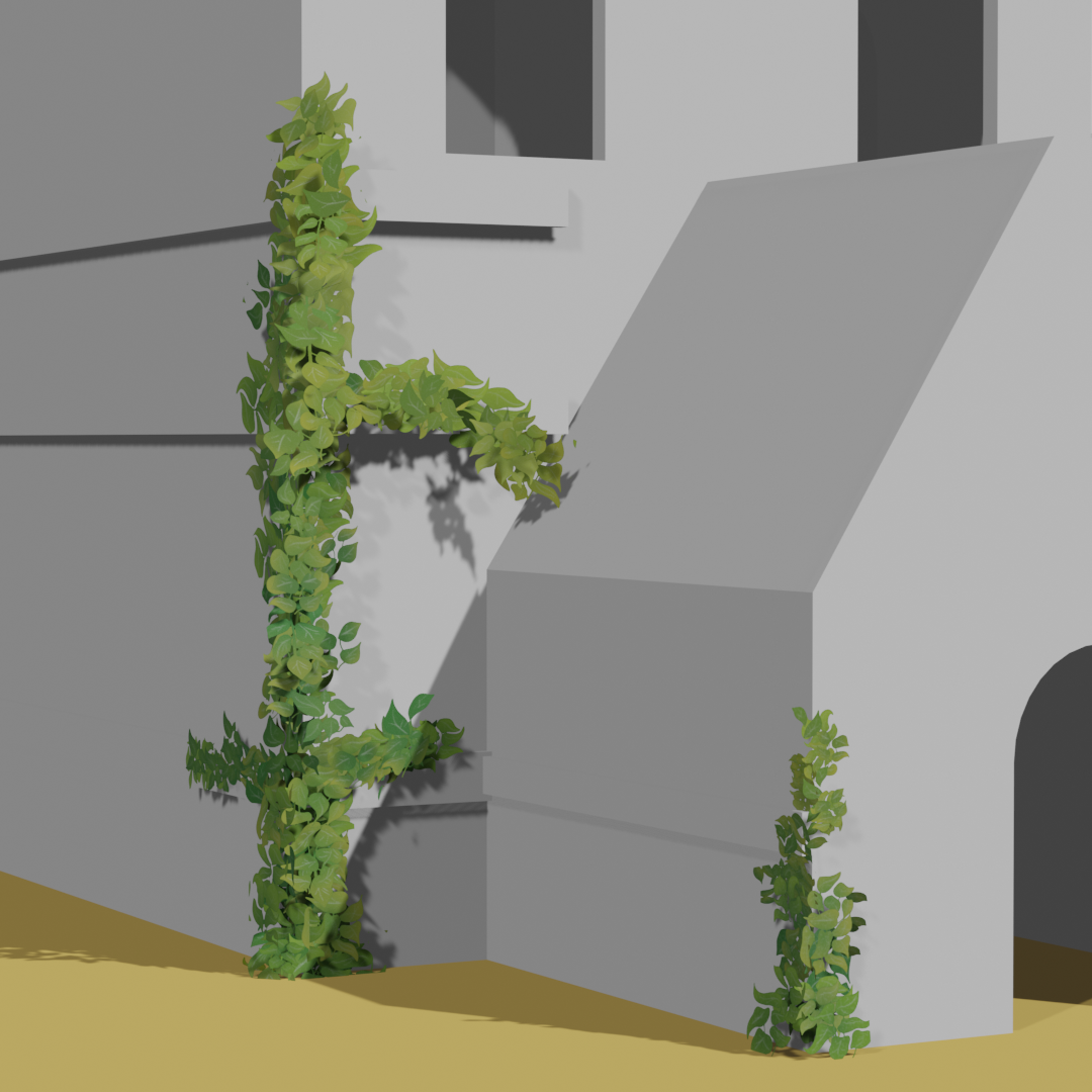

          Homework submission – Week 4 – Nature:FG Ivy
          @jlampel
           I’ve added quite a few more subdivided planes as branches that are sticking out.
          Some planes are gently curved in order to create a nicer overlap.
          On the corner of the entrance I made sure that the silhouette matches the line of balance, using my separate leaves on my alpha card generally pointing upwards on the corners and the very tip.
          Furthermore, I replaced the texture in the folder with a 1k texture as specified in the project outline.
          #67067
          Jonathan Lampel
            Awesome job, I’m loving how this has turned out! When viewed from the side this looks much less flat and much more interesting.
            I do still think the overall structure is a bit boxy:
            It’s a hard problem to solve, because I can see that you’re following the lines of the house which are inherently straight. The concept art is following those same lines, but I think the difference is that it’s less dense, which makes the boundary of the ivy appear less uniform.
            My theory is that actually removing some of the cards to reduce the density could help the distribution to look more natural, but I could be wrong.

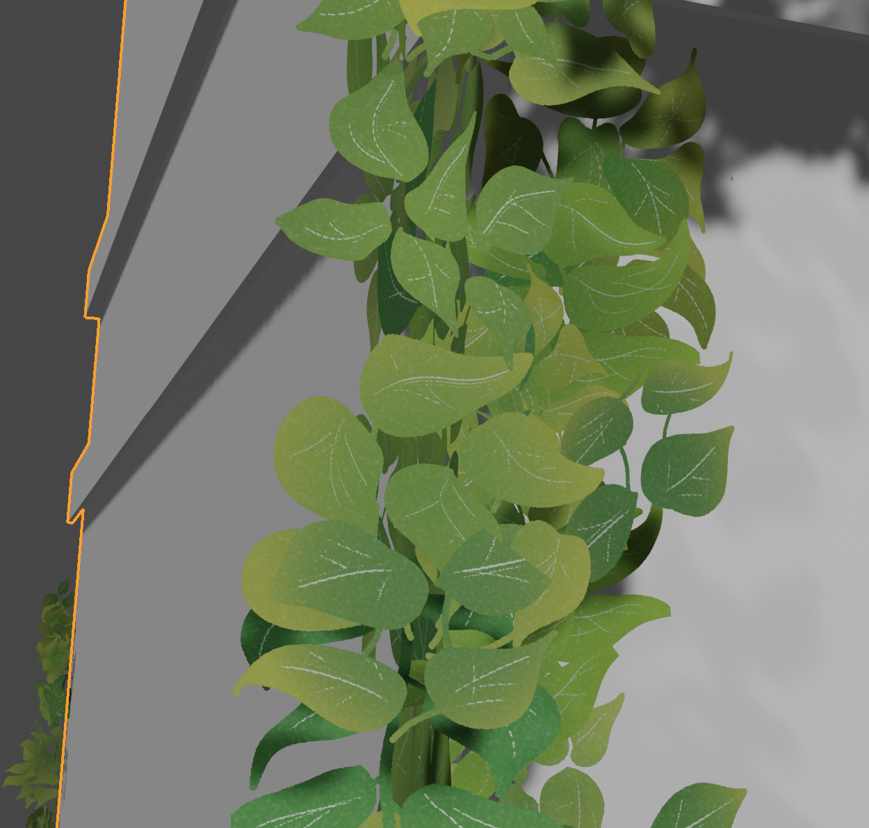

            #67068
            Fabian Grundmann
              Full foliage – prior version
              reduced foliage in edit mode with hidden planes
              I guess you’re right. Focusing on the asset isolated from the other assetsof the scene I may have given it too much geometry for fear it might look to whimsical. However, when I reduced the number of cards too strongly, the fact that they are made of alpha planes stood out quite a bit. But I liked the effect of randomly reducing the number of cards to have a more uneven distribution. In the lower version the ivy tapers in the middle section, which reduces the initial pillar-shape. For the lower version I hid some planes in edit mode. When overlays are deactivated it is possible to use tab for switching between the two versions in object and edit mode. I think it will much depend on how this works with all the assets in place.
