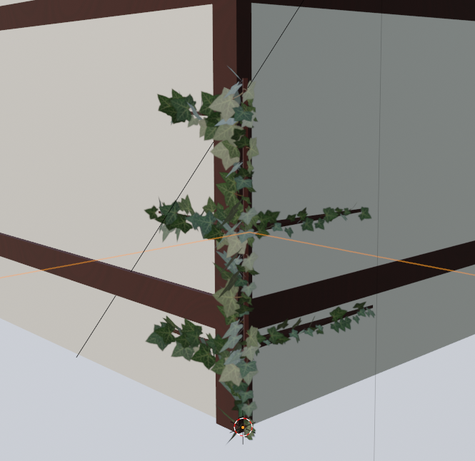

        Wow. This was my first attempt at the ivy. I started with a particle system. But after I while I realized this would never bring the silhoutte and desired leaf orientations. Both the ivy plugin and the particle system remain too random, more apt for photorealistic styles at high numbers.

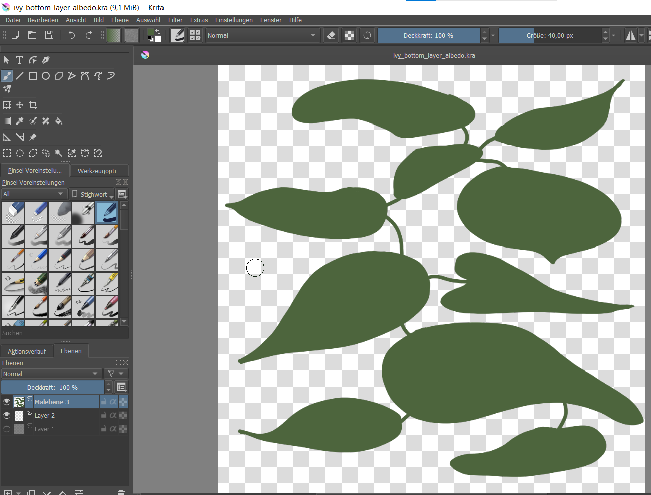

          So, I took another direction. I’m going for foliage cards, trying to emulate the leaf shape from Vadim’s work. This will be the bottom layer leaves. Further foliage cards will feature the full palette employed by Vadim. Subsequent shapes will be smaller, more random. I decided to forgo a central brown stem and rather evoke the impression of thinner green stems integrated in the foliage cards.

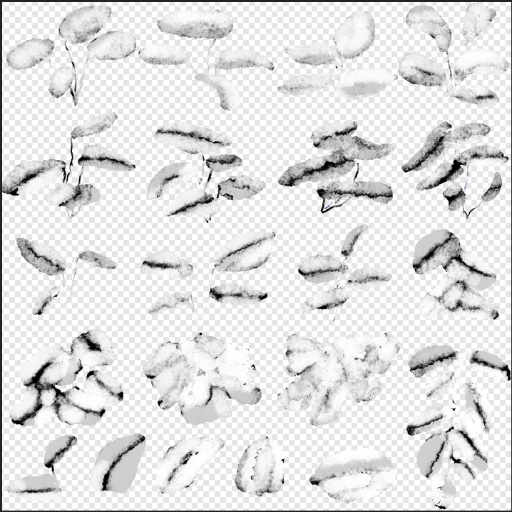

                  So I decided to go for hand-painted alpha cards. Alle leaves will be one material on which I push the UVs around.
                  I took a fuzzy brush in affinity and created clusters of leaves (just like Vadim did – you can see the repetition of his smart brush. There are clusters for the background. I picked most of the colors from the lit parts in the foreground.
                  I took advice from Marie Lazar’s excellent blog entry on creating stylized plants and used some spare space for individual leaves that help for emulating the same “line-of-balance-silhouette” of Vadim’s artwork.
                  3. Let’s paint
                  Not quite happy with the blandness of the texture, I inserted some highlights on a different layer. If these highlights turn out to be clashing with the rest of the artwork I can return to the bland versions.
                  The goal for our project is to have a painterly style and yet – the leaves should have physical properties. I went about this Ian Hubert style and did a slapdash roughness map. The idea is that the roughness is lowest in the middle of the leaf where many plants feature a shiny stem.
                  I keep the effect subtle on the dials.

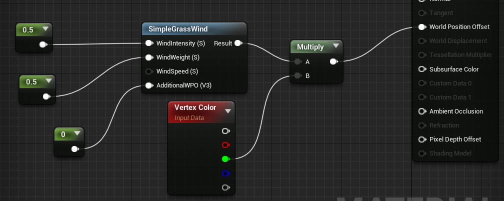

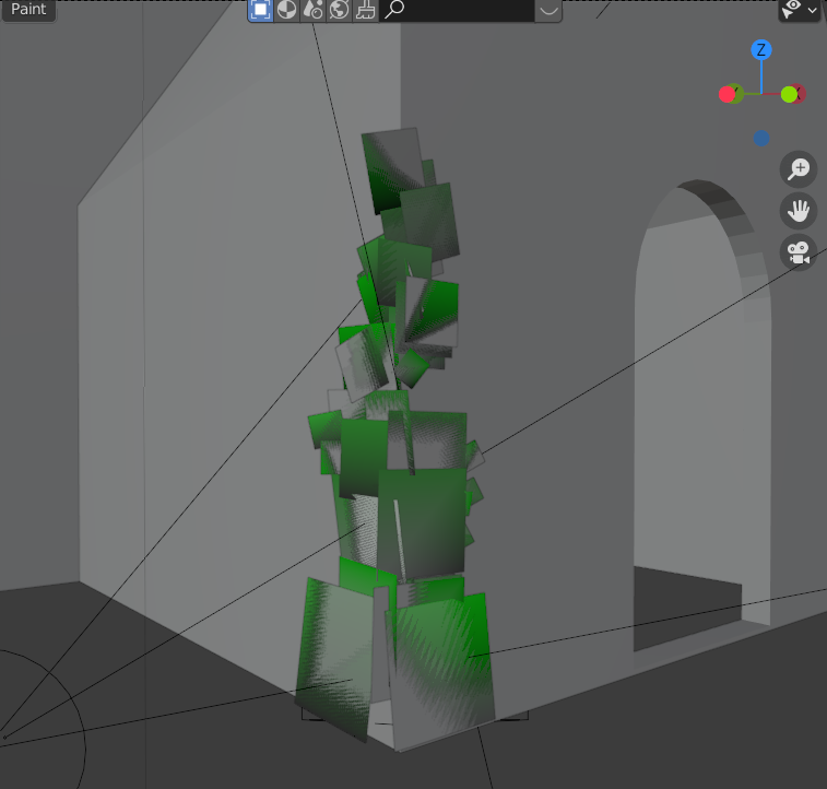

                  In order to have some random movement in Unreal I randomly painted some vertices on the green channel (chosen randomly) whilst favoring the upper parts of the vine cards.
                  Coming from blender node-fun is to be had in Unreal. The green vertex channel drives the displacement animation. So only green vertices are being “shoved around” more in the wind. And there it is shaking gently in the wind! Vines don’t move like that? So what?! – They don’t grow on wooden beams only either!

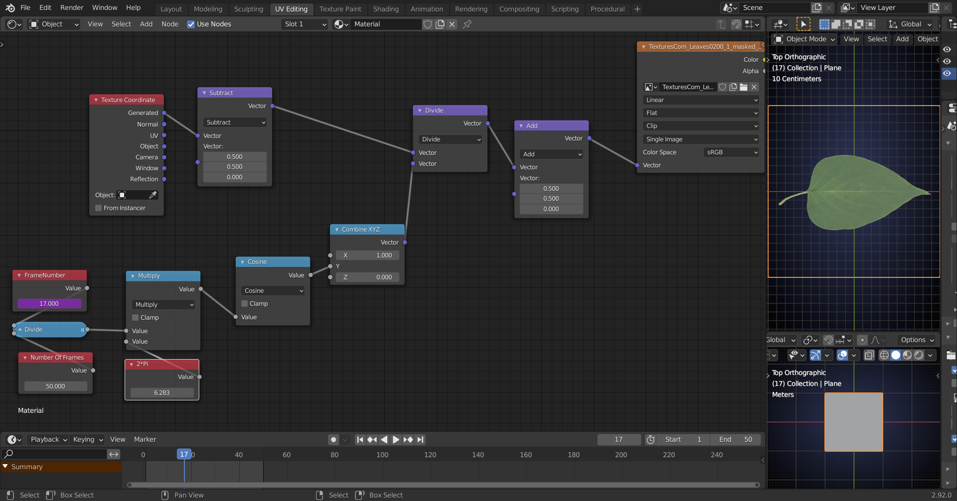

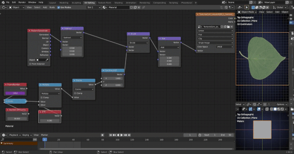

                          You have inspired me, Fabian:

                            On taking the animation to blender
                            @spikeyxxx – you sure do know your way around them nodes! Some of those I have never seen before! Is that a “random integer pacemaker” on the far left? Would you mind sending me a high-rez version on the discord so I can replicate it for creating some wafting in blender?
                            This might be a good question for tomorrow: If everyone in the scene is working on a looping animation (wafting leaves, water, the tarp) should we agree on a frame number to make it looping? Off the top of my head I’d say 100 frames to have at least one different iteration of movement and counter-movement? In that case all looping animations need to end on frame 101? (I’ve never tried a looping animation before.)
                            Apart from Spikey’s node setup I can thing of several ways to do the leaf animation in blender:
                            – a lattice deform, maybe two lattices because one part of the vines are facing the y and the other one the x axis.
                            – a gentle f-curve modifier with noise on the location and maybe the scale of the alpha-cards.
                            Could you think of other ways I could approach this?
                            #67061
                              No, that is an Input >  Value Node. In the value field I typed in:   #frame
                              that way, the value is the same as the frame number.
                              This was not intended as an animation demo, but to show the you can make rotated looking leaves from ‘alpha planes’, without rotating the planes themselves 😉

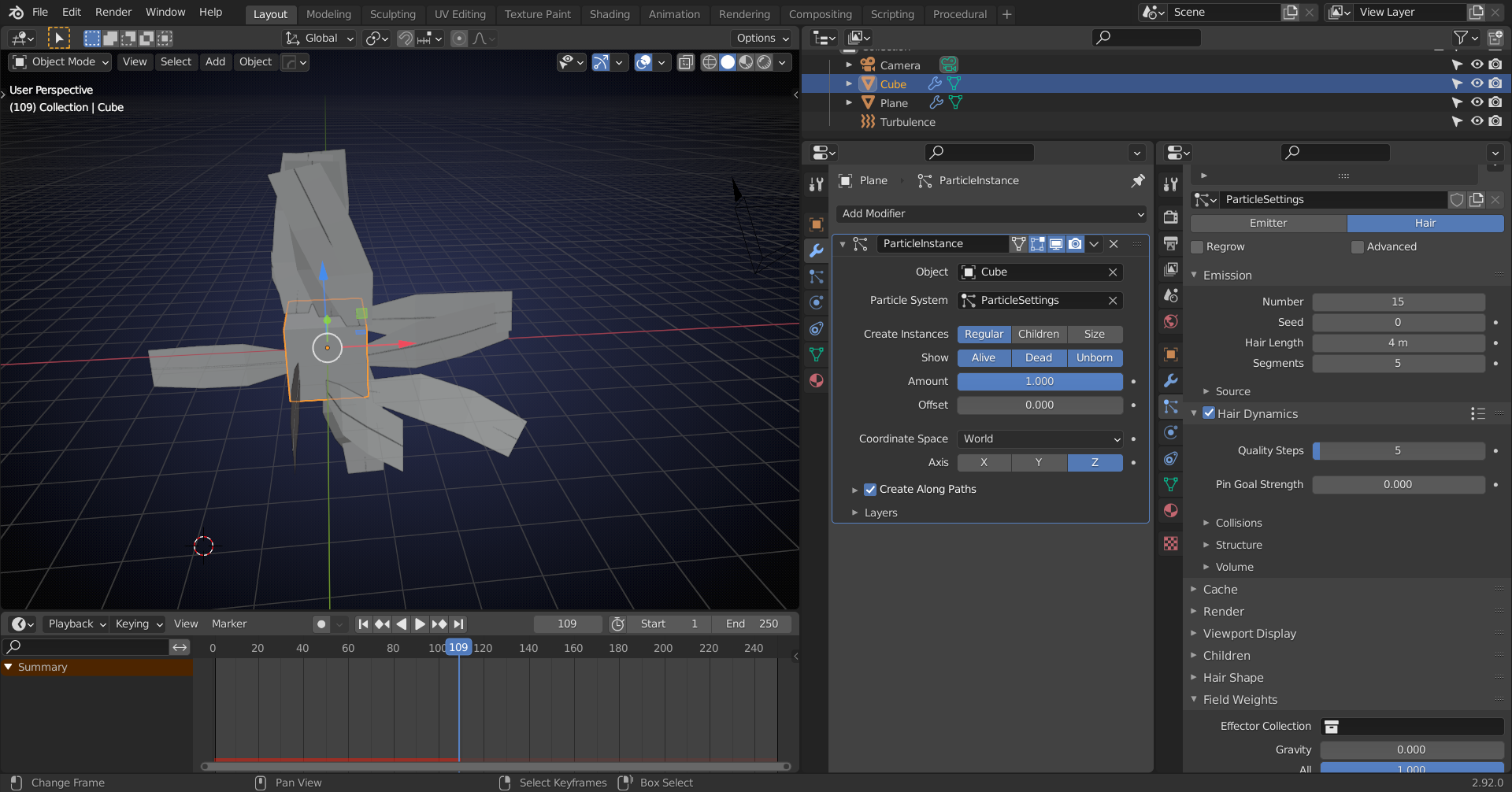

                              There are other ways to do leaf animations, for instance use a Particle Hair System with Hair Dynamics and no Gravity.
                              Then add a Particle Instance Modifier on the leaves and check Create Along Paths.
                              Here’s a better picture than the GIF:

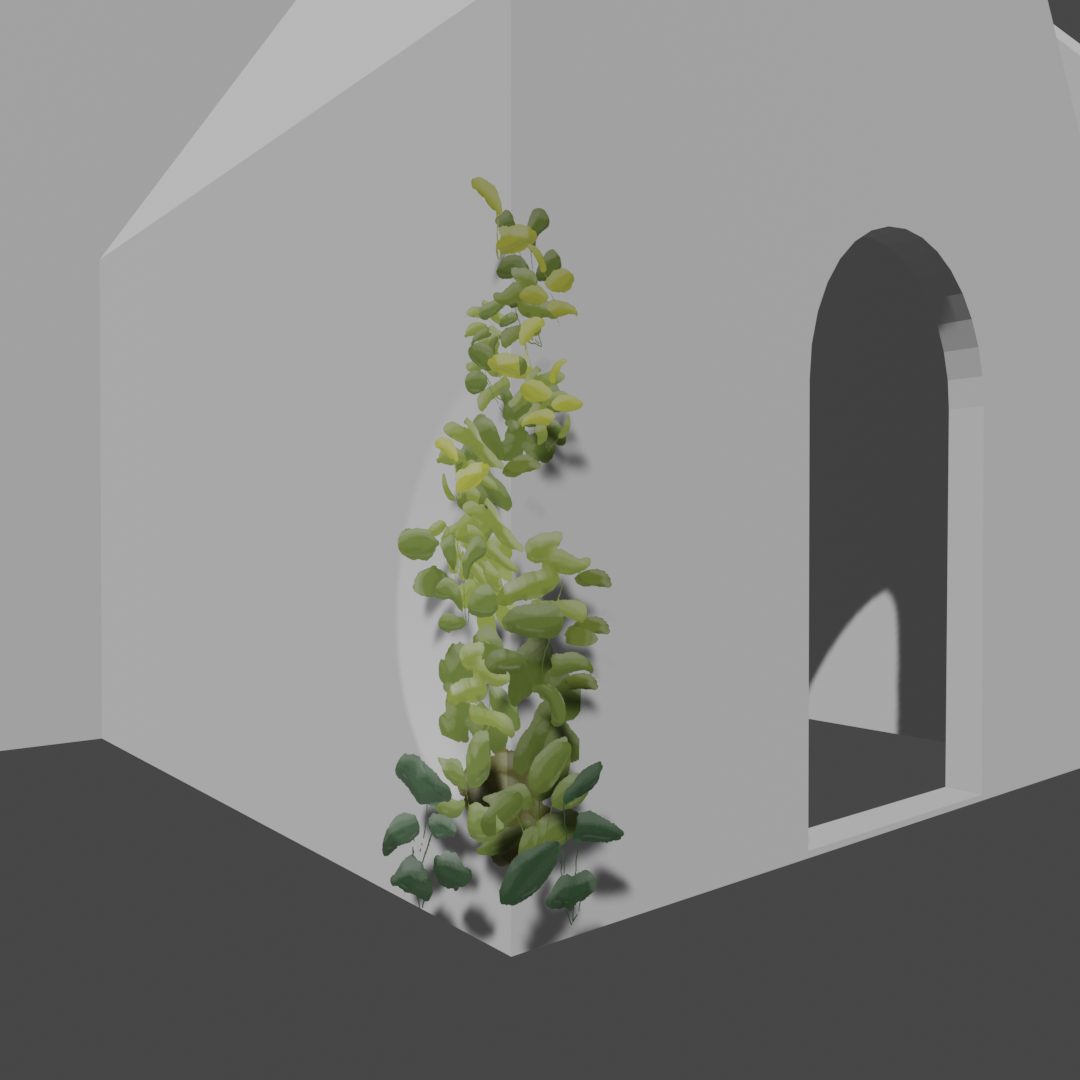

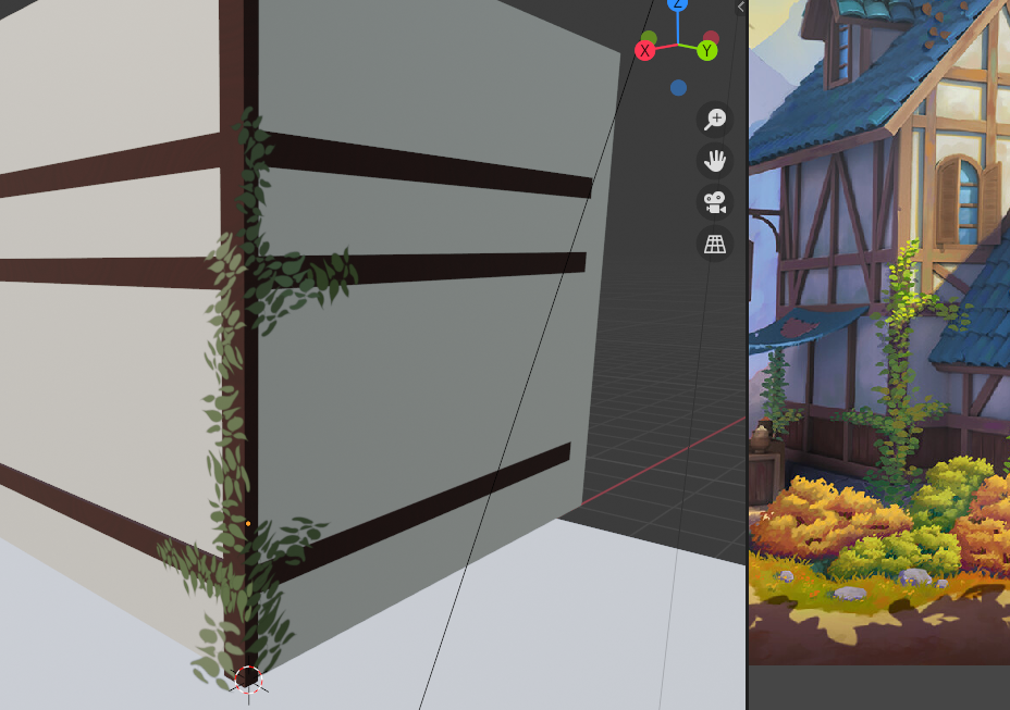

                                Homework submission – Week 3 – Nature:FG Ivy
                                @theluthier
                                I finished the tallest of the three vines using a numer of leaf variations. I wonder how it’ll look on the final model of the house. I’ll finish the other corner in the course of the week.
                                #67063
                                Jonathan Lampel
                                  Hey @raisonhomme , I love seeing where you started, what you’ve tried so far, and where you’re ending up! This is great progress!
                                  Here are my suggestions for improvement:
                                  Even though the ivy is fairly rounded in the artwork, it still has a pretty distinct shape and still has a point on the end. I would love to see the textures be a little more crisp and pointy than bean-shaped. I can tell you’re going for the paint brushed look, and it *almost* works, but it needs to be dialed back just a bit to hit the sweet spot.
                                  I wasn’t able to test out the file since the textures weren’t in the drive. Please add those in when you get the chance.
                                  I’d encourage you to experiment with adding a loop cut or a couple to play with some of the shapes so that they’re not all perfectly flat planes. Giving some a slight curve or bulge may help it to look less flat at many angles.
                                  Along those same lines, try adding more leaves sticking out at odd angles so that we can’t tell as easily that it’s just flat textures.
                                  Lastly, I would like to see some leaf vein lines in the texture as well as some  super subtle spots and a gradient from the center or from the end. The current painted  stepped gradient makes it look like a rounded 3D shape which I think is what’s contributing to the bean-like appearance.
                                  I know that’s a lot all at once but I can definitely see that you’re up to the task! Amazing job here, full points for week 2, and keep up the good work!
