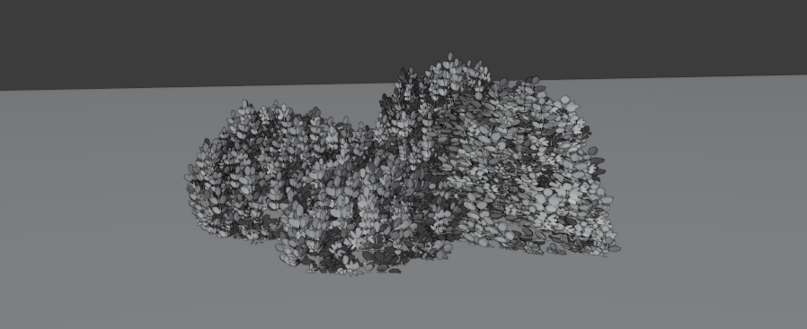

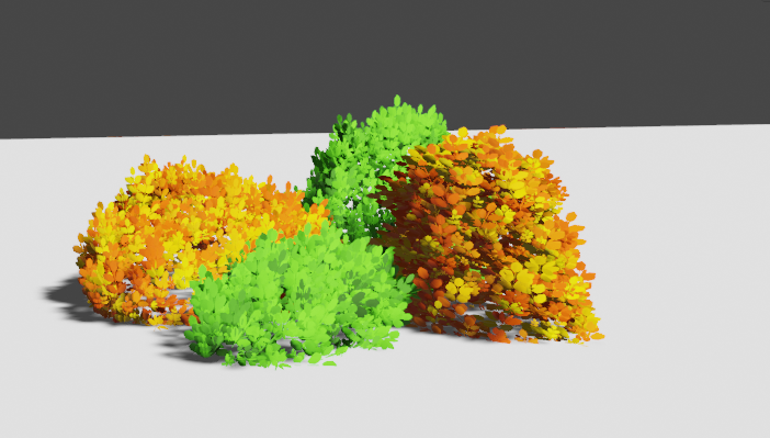

            #66589
            artifact
              This is what I’ve ended up with. Overall, I’m pretty happy with the look and feel of the bushes at this block out stage.
              And quick rendered with basic materials:

                #66591
                Dani Tufeld
                  I realy love the bushes!!
                   I think it will look great on trees as well, how optimzed is it?
                  would you mind sharing the proccess?
                  #66592
                  artifact
                    Thanks @danitufi
                    No, I don’t mind sharing the process at all. I tried to optimize the base geometry I used to distribute the leaves as much as possible, and I managed to get that down to 170 faces.
                    To get the rough shape of the bushes, I started with metaballs. Once I had the shape I liked, I used the Remesh modifier to get an all quad mesh with roughly even quads. Next I decimated it with the Decimate modifier to lower the polygon count while retaining the overall shape and form. Then to get that to an even lower vertex count, I made a quick retopology manually using a combination of vertex snapping and the shrinkwrap modifier.
