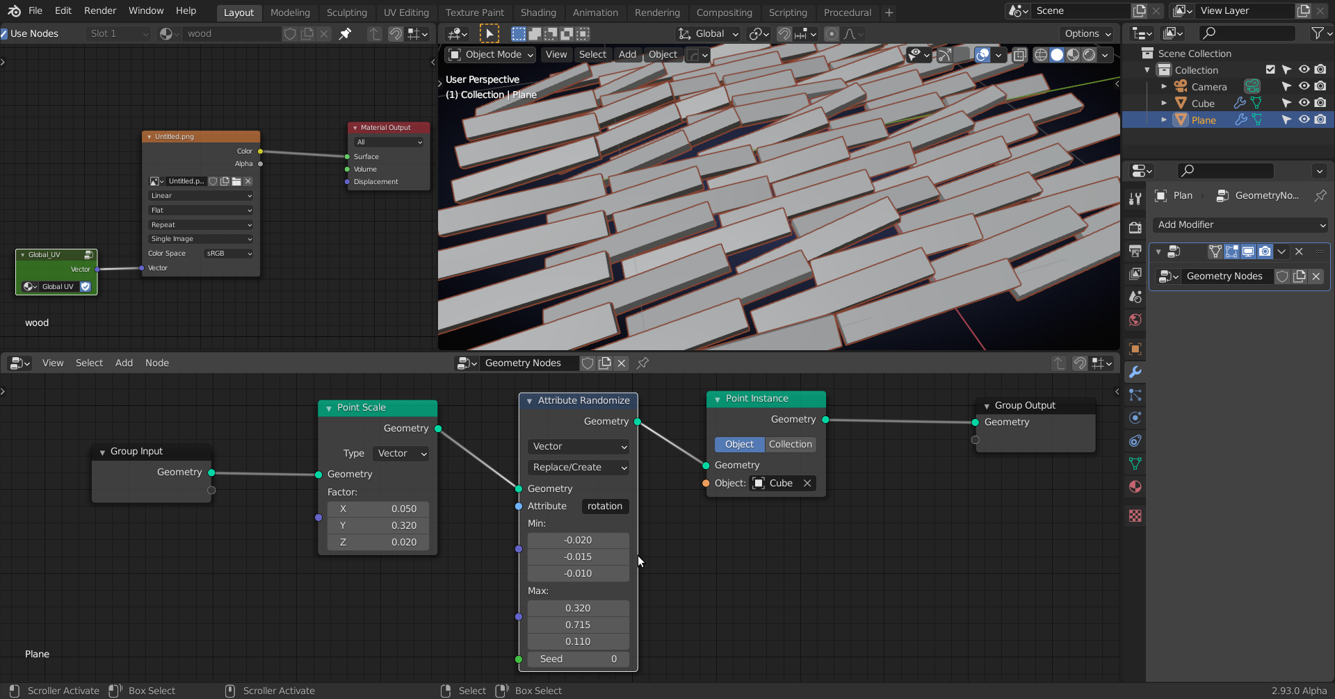

              Ok, so you must obviously be on one of the experimental branches (like the spikeyxxx I know and love) because Simon T. approved the use of the replace/create just recently and I don’t see it on the official release in 2.92 and was trying to place but I only end up with 1 instanced object.
              Did you instance that whole board array there with that new Replace/Create functionality? I don’t see an array modifier on that object, only the Geo-nodes.
              Okay and on to my next question: let’s say we modeled in some cuts and damage instead of texturing everything (just trying to wrap my head around this new work flow). For example there are 3 boards with enough variation that you get a total of 6 sides to use and rotate for tons of variation: I’m thinking about random-run instancing between the three objects in a collection and letting the instancer geometry nodes handle all of that and throw in a random value. It could pick one of the three boards and rotate about the local x axis 180 OR NOT and rotate around the Z 180 OR NOT and Possibly the Y 180 OR NOT and you would have all kinds of combinations of instances from geo-nodes, correct?
              Something similar to this posting only using Geo-Nodes:
              https://blender.stackexchange.com/questions/191492/how-can-i-randomly-instance-and-distribute-objects-from-a-collection-on-a-mesh-u
              You would get some increasingly complex floor board or tile or shingle structures that way in my mind.
              #63308

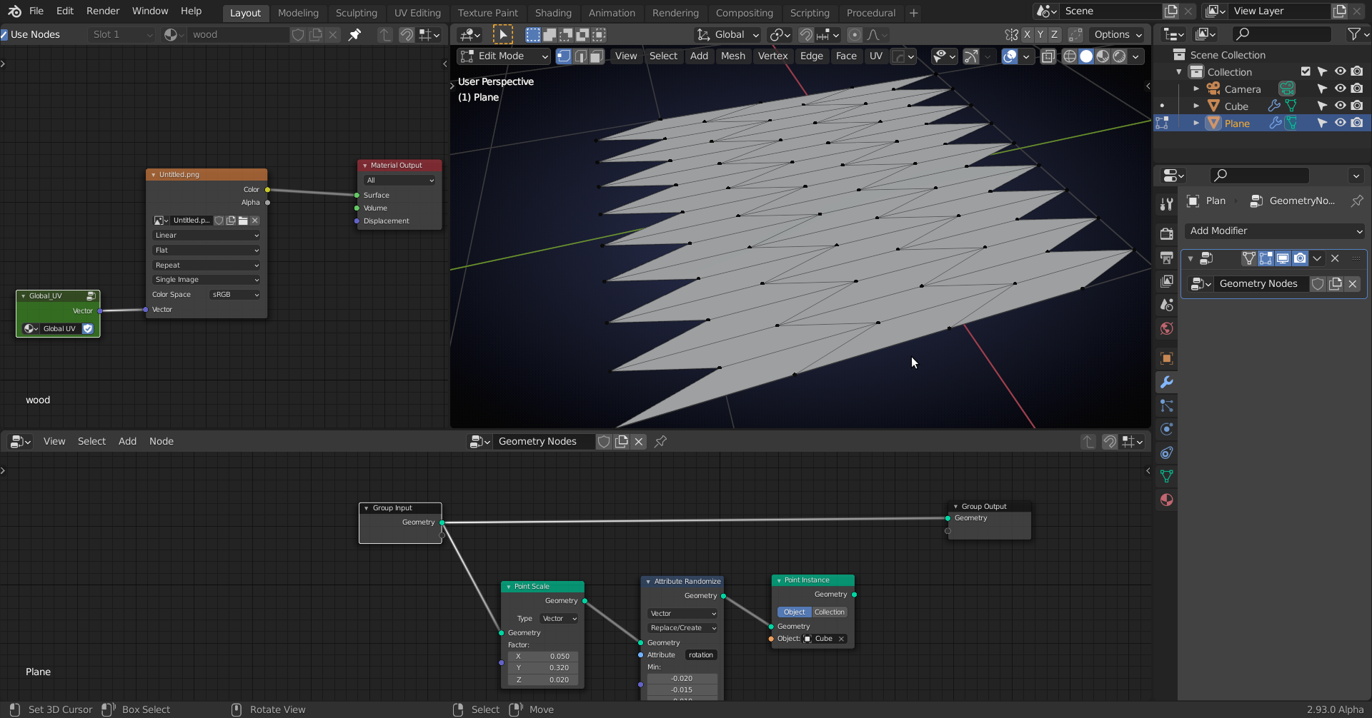

                No, to be clear, there is no Array, I just instanced the Cube on the Vertices of the Plane,,the Plane looks like this:
                The blue Node only randomizes the rotation (Attribute) of each of the points (Vertices)…All those points have a rotation, scale and position (Attributes), a bit like Origins of the Instances that are going to be put there. The Replace/Create was the default in 2.92…it’s just that now (in the future) we (will) have more possibilities
                Exaggerated:
                …and you would have all kinds of combinations of instances from geo-nodes, correct?
                That is correct!
