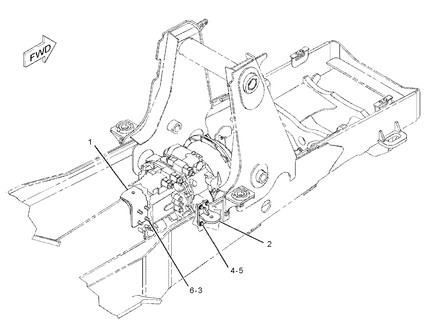

        The inner part of the rim is a little bit of eyeballing since I only have photos of them but no construction drawings. The rear axle itself is based on isometric and orthographic plans but I don’t have any precise measurements. And the connection with the front axle will be another tricky task.
        #54349

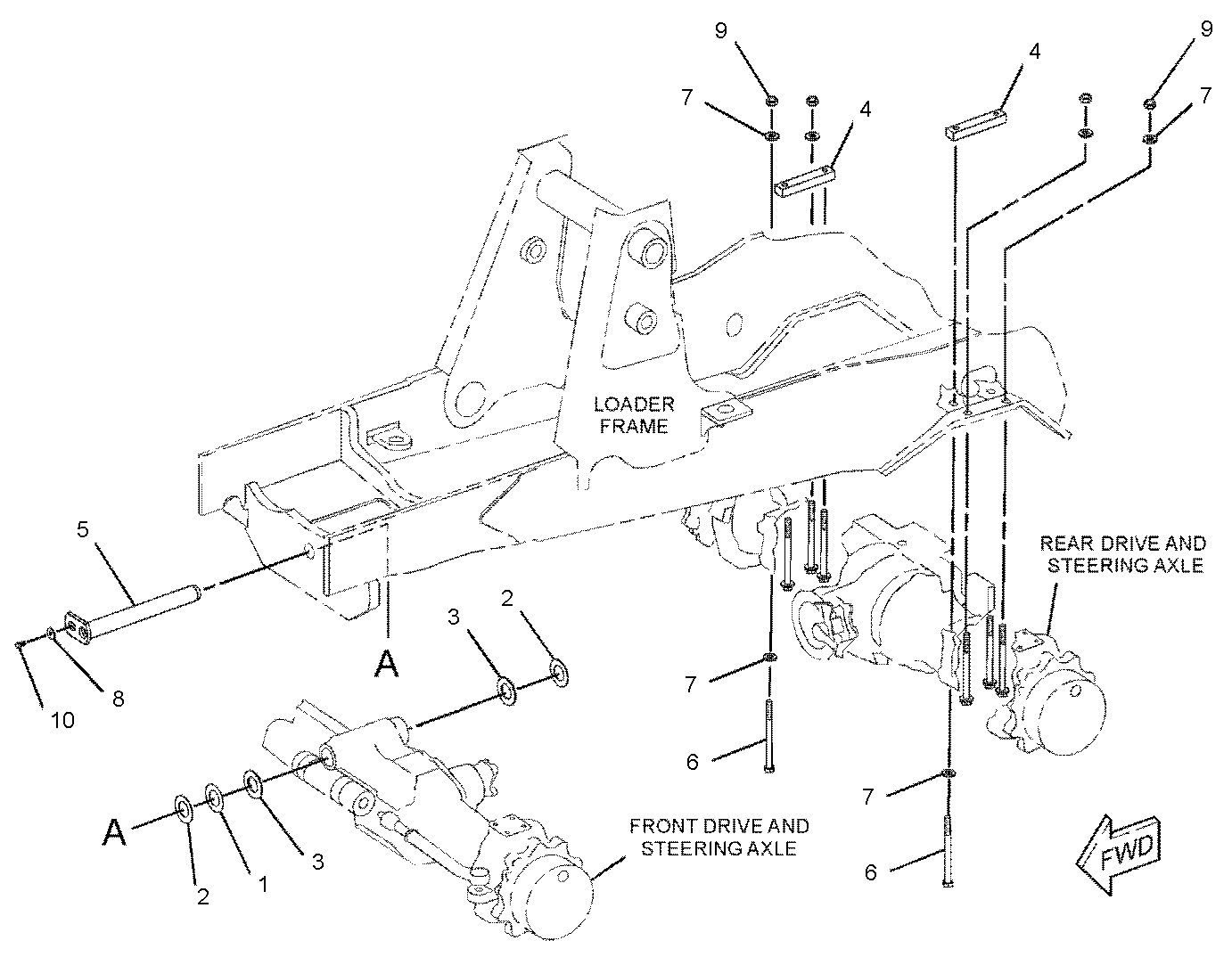

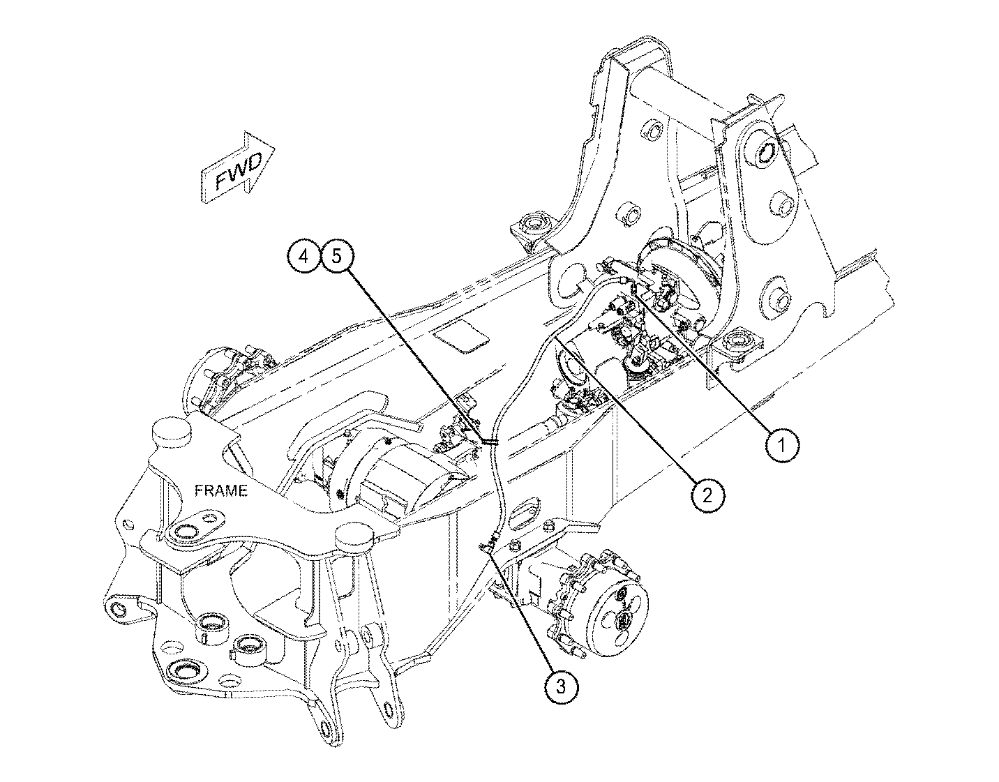

          This is the connection between front and rear axle on a Cat 434F:
          I don’t know whether there’are differences between the E-version and the F-version of the Cat 434 in that part of  the backhoe.

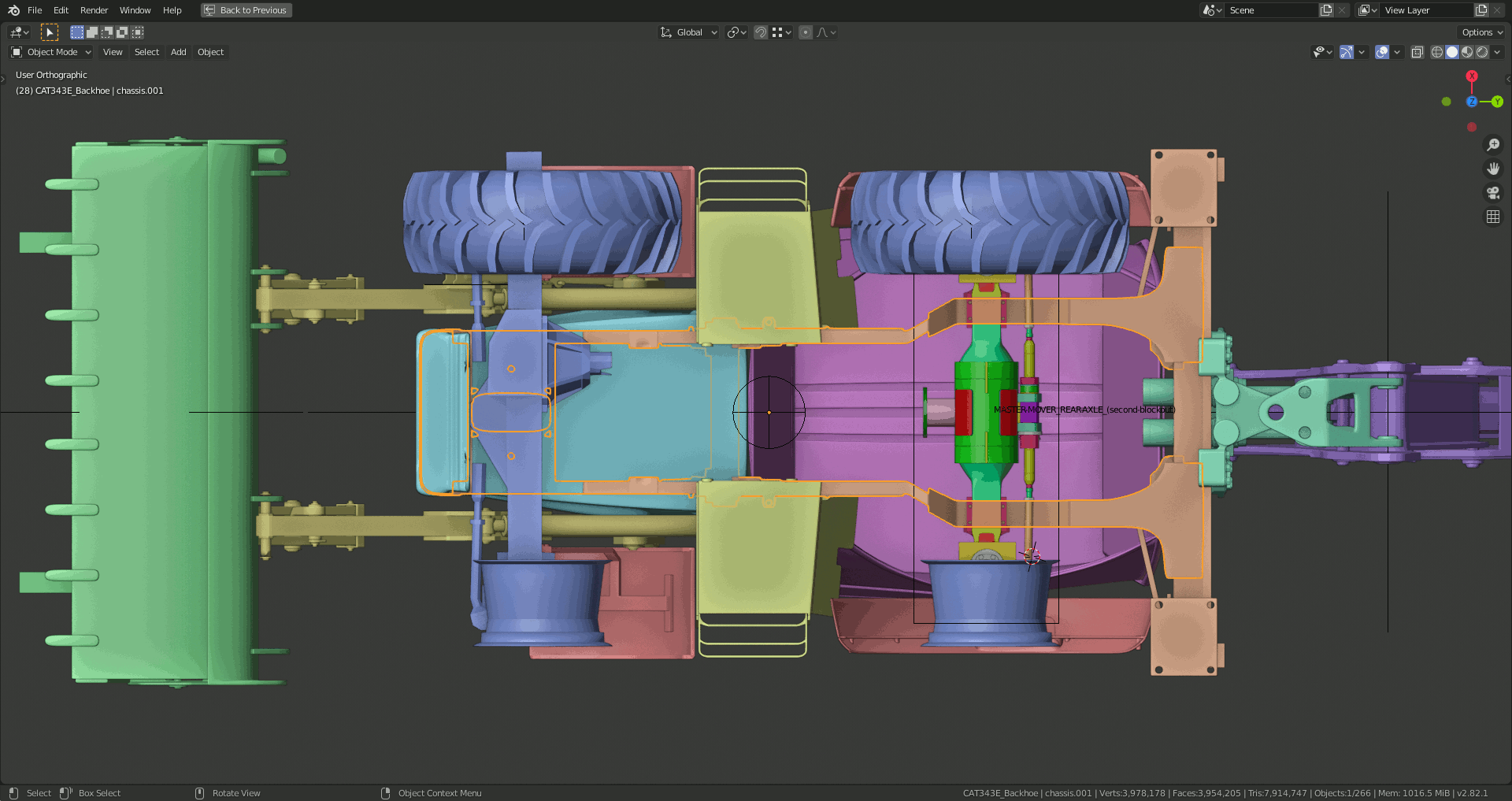

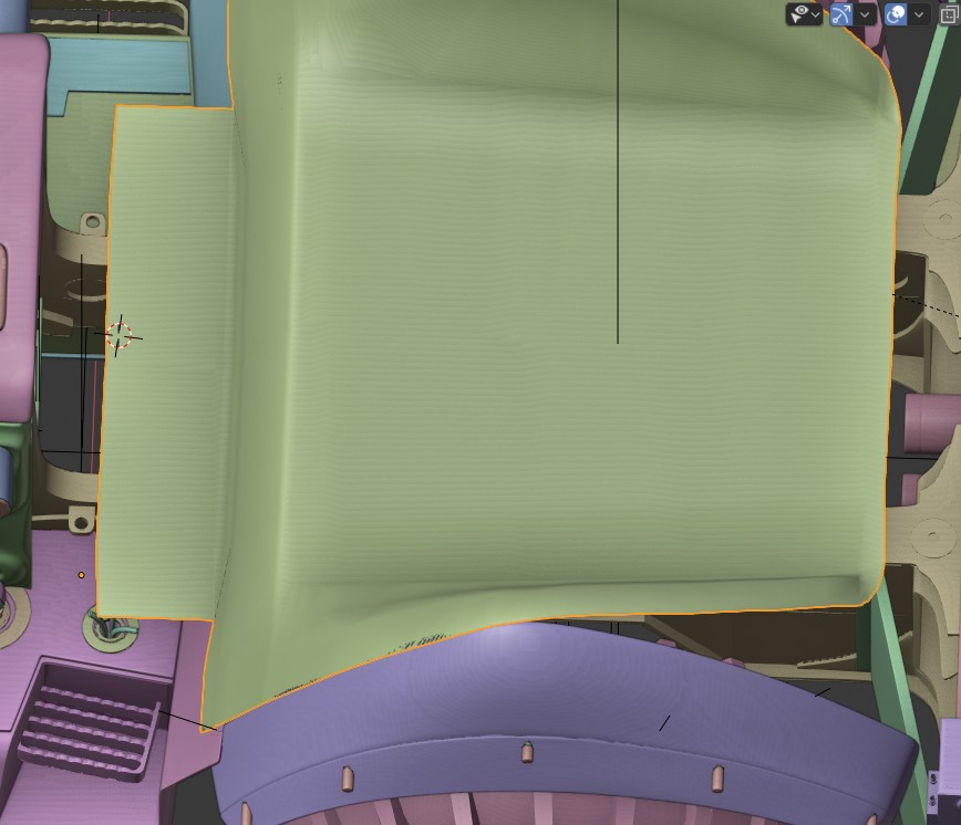

                          Thank you @adrian2301 for the adjustment. Now it intesects with the battery boxes:
                          It’s maybe best that you keep your chassis as it was since we first have to ensure that both axles are properly connected via the parts in between.

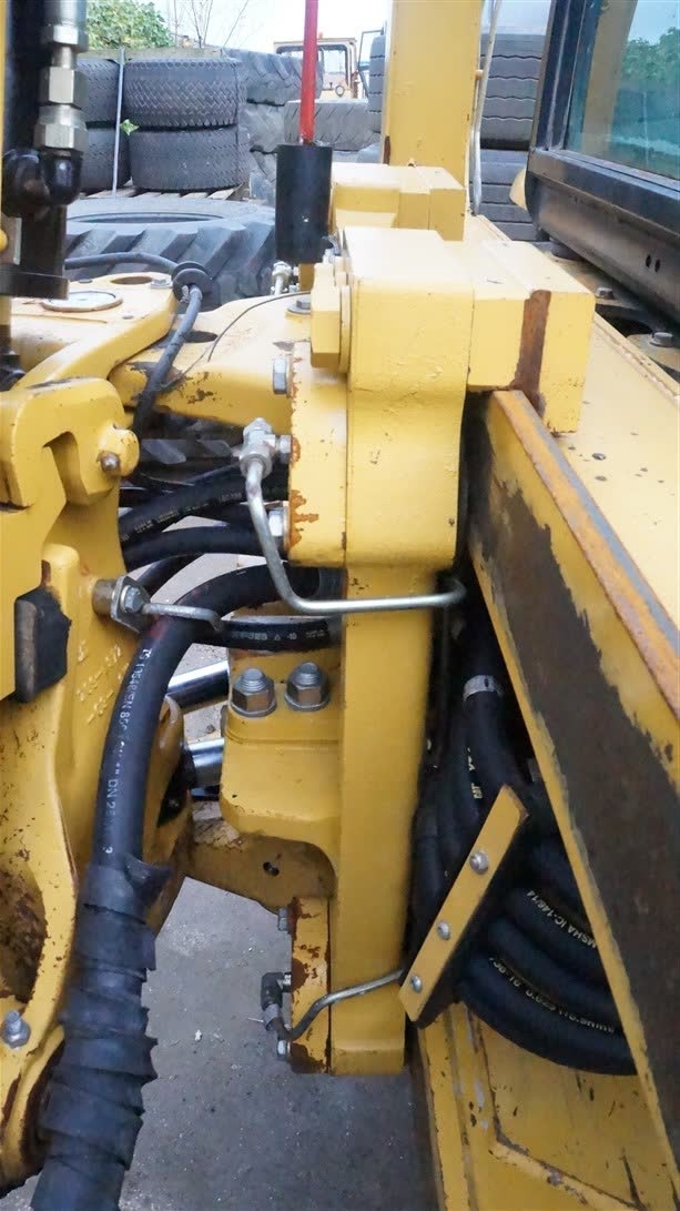

                          I have found some higher resolution drawings of the chassis:
                          I’ve also found some close-ups of the rear side:

                            The chassis is actually closer to the right size, I have taken from reference the chassis is the same width at the front as the engine compartment. and now with the alignment with the rear axle. The Battery Boxes are actually to close together (x-axis) or to deep individually.
                            These images will help me with the shape of the connecting part to the stabilizers, much clearer images than I had before.

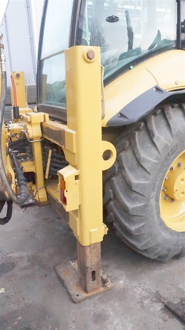

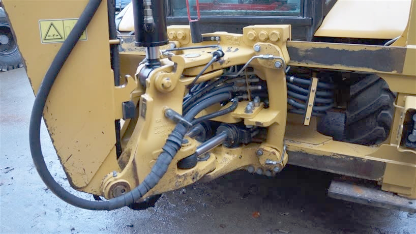

                              Actually second look tells me there not from 434e. first image is completely different at the rear where the swing frame is, as in your first image, our swing frame attaches to the stabilizer rails. not directly to the chassis. As in image 4.
                              Second image on the upright part where the loader arms attach has 3 holes on or dog.
                              #54360
                                @adrian2301 It’s a Cat 434, but from 2006. That could explain the differences

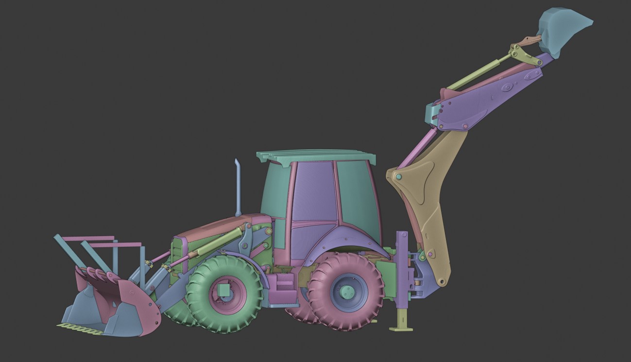

                                  Ok here is what I have so far, Trying this out was pretty frustrating at first but it looks better than I’ve done so far.
