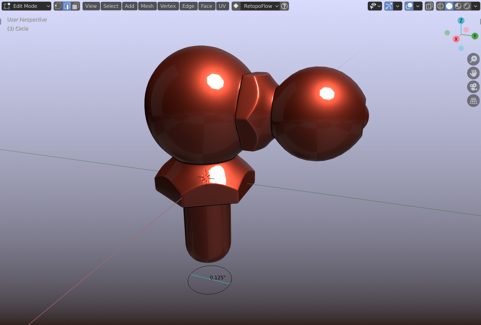

                  I tried my hand at the Zerk Fitting: and did it with Retopoflow to keep my skills up with that add-on.
                  It’s such a small part I’m not sure it will need such detail but there are a ton of them on this DOG so I will leave it as is for now and maybe ask Kent how he wants to handle small parts haha. I’ll post a reference shot just to show them on my own thread but I figured I would post saying I was able to recreate @theluthier ‘s teaching topic without too much trouble. The intersect boolean took me a while to figure out. I was cutting way too much material off because I wasn’t intersecting enough!
