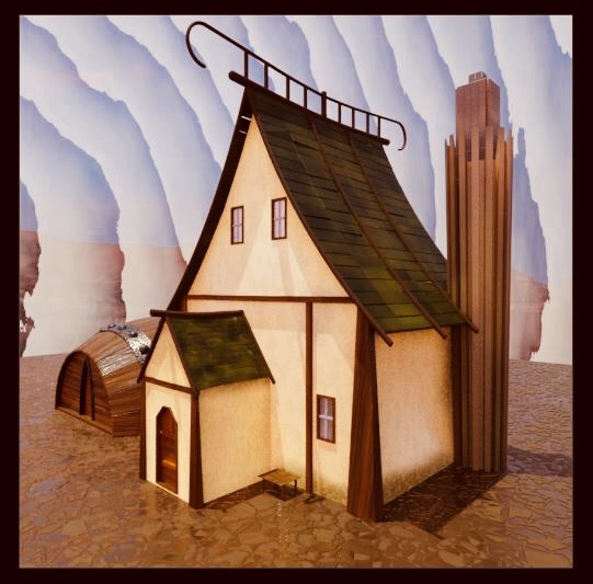

      @ghujelk Its a real size house , the Barrel-like structure is 3×5 meters which in my mind , is a proper size for a small barn or guests house.
      #49742
      Mona Loren
        looks very cozy. This little House-barrel remind me on Empy´s Island-Titiwu and the home of the cleanly Wutz.
        Or maybe a kind of hobbit home

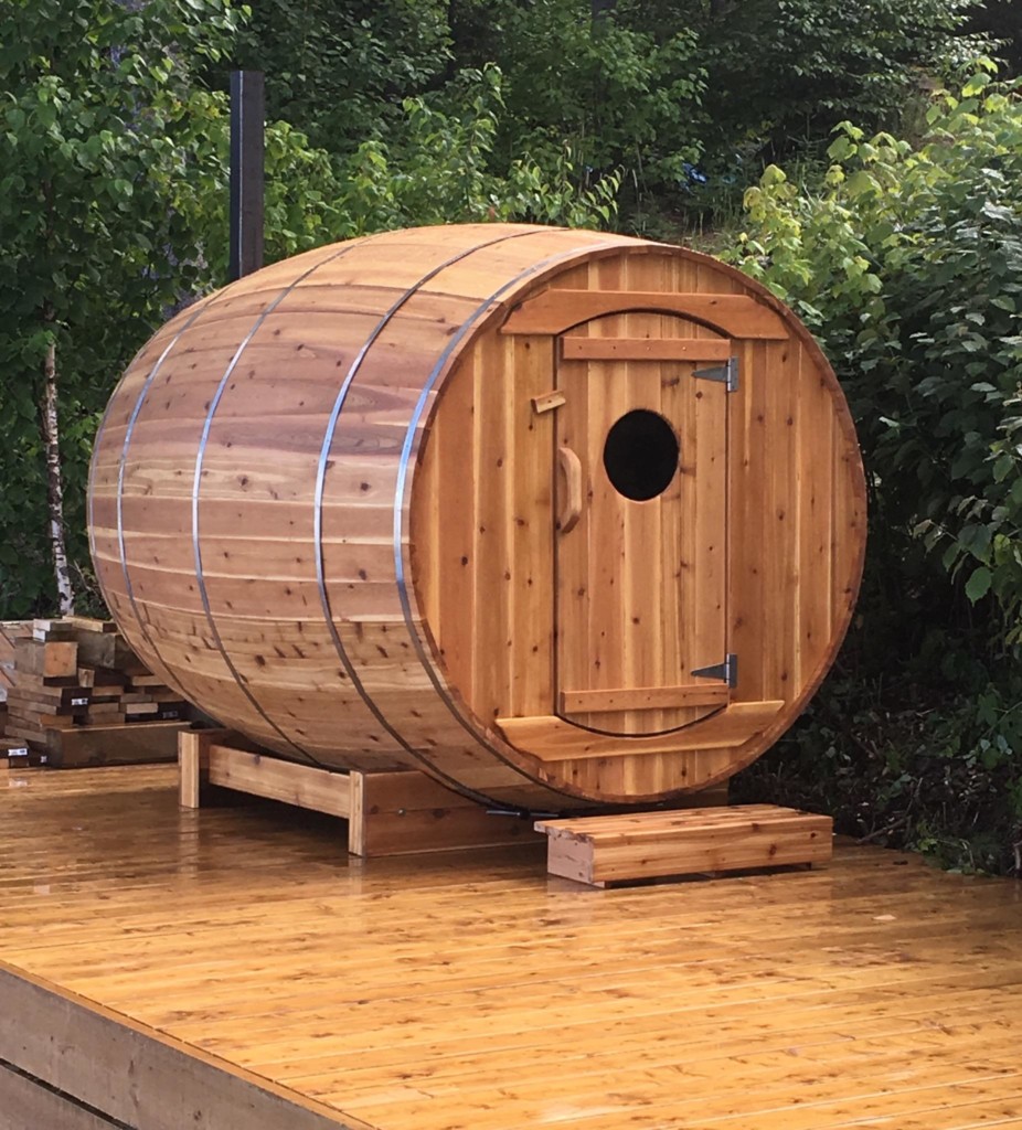

          @avirozenboim Nice, it reminded me of these barrel saunas I’ve seen. Here’s a pic:

          Avi Rozenboim
            @ghujelk Yes have seen these exact while researching. Thanks (BTW I just replaced the main image. On my work PC it looked too dark, its annoying that every monitor shows efferent results)

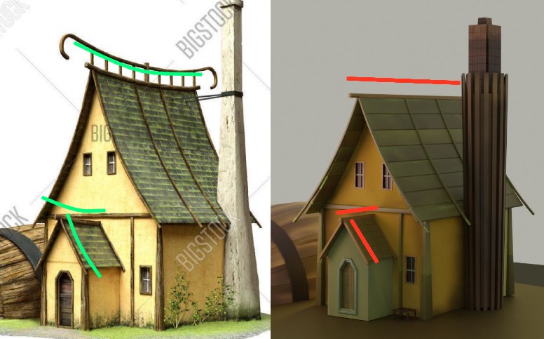

              @avirozenboim I 100% affirm your aim to evolve your project this way. Evolving creativity is the digital artists’ lifeblood!
              The model looks good and authentic for the most part. My only note there is to de-straighten some of the straight structural features as the art suggests:
              As for the texture, my primary criticism is a lack of detail. If these are meant to be dwellings that humans/hobbits/elves/etc then the model and textures need to have enough detail to support the scale. Currently with the textures being more broad and less detailed, they look like miniatures. The art has a lot more fine detail like wood splits, roof tiles, and moss/grime at the base near the ground.
              So it’s a B for the lack of detail but I’m bumping it to an A since you’re pushing yourself in a great way 👍

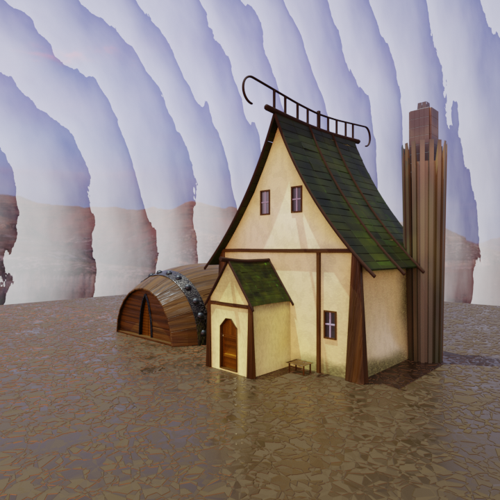

                Homework Submission- Week 3
                Got long way to go with texturing and shading , could not get the the objects to look good , I think I should have kept it simple and not do such a complex scene on my first course , but anyway this is what I got.
                I was really disappointed to see that whatever I do , the render is always pixalated when I zoom in 🙁
                Thanks for a wonderful course , learned a ton , especially with modelling .

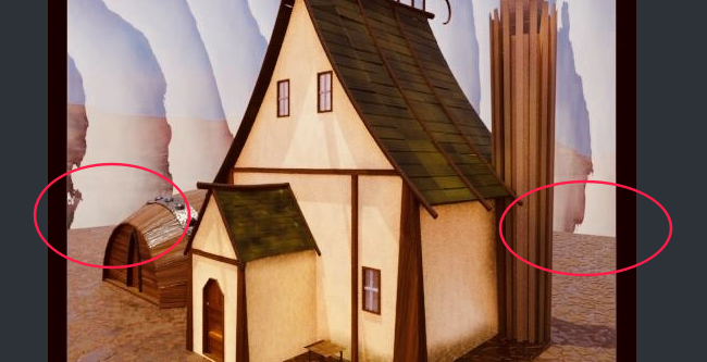

                  @avirozenboim I’m so impressed with this final result. It has a kind of impressionistic aesthetic to it that I never expected. From the way it’s lit to the unique sky texture…I can’t help but call it Art (with a capital A).
                  I also really like the procedurally textured ground pattern. It’s a great way to add some interest to a simple plane. On that note, the only critique I offer is that the edges of the plane are obvious:
                  This is a common issue that’s a dead-giveaway that this image is a 3D render. I recommend that you turn the plane into a circle and fade away the edge, it won’t be an issue any longer.
                  In the end it’s a very small note compared to how pleased I am with the final. It’s an A+ in my book! 👏
