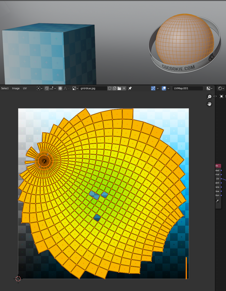

I hide the inner sphere.

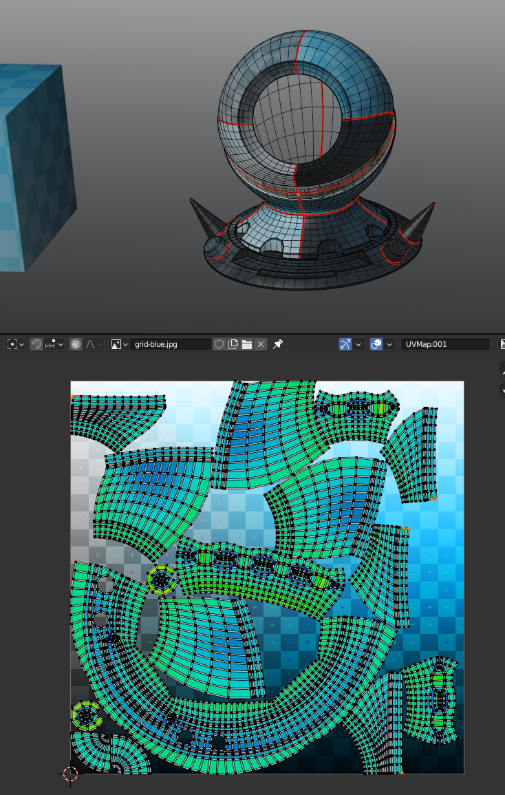

Clear original seams, mark new seams, unwrap and pack. Good results

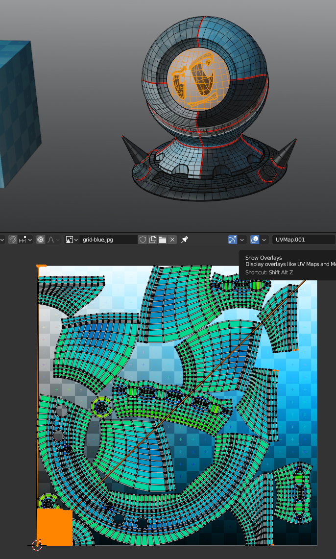

Now I unhide the sphere

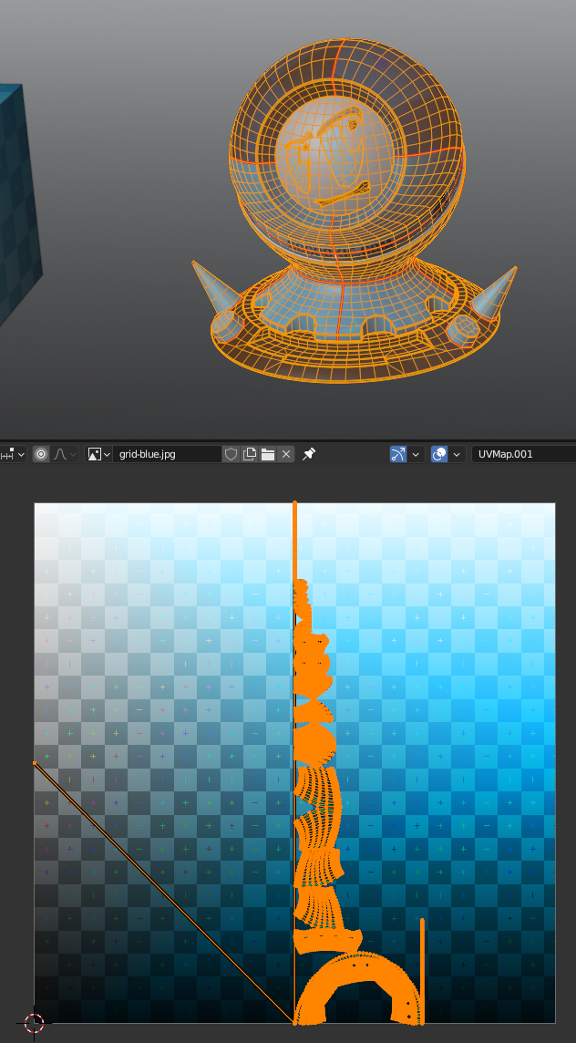

Select all and unwrap
and now pack

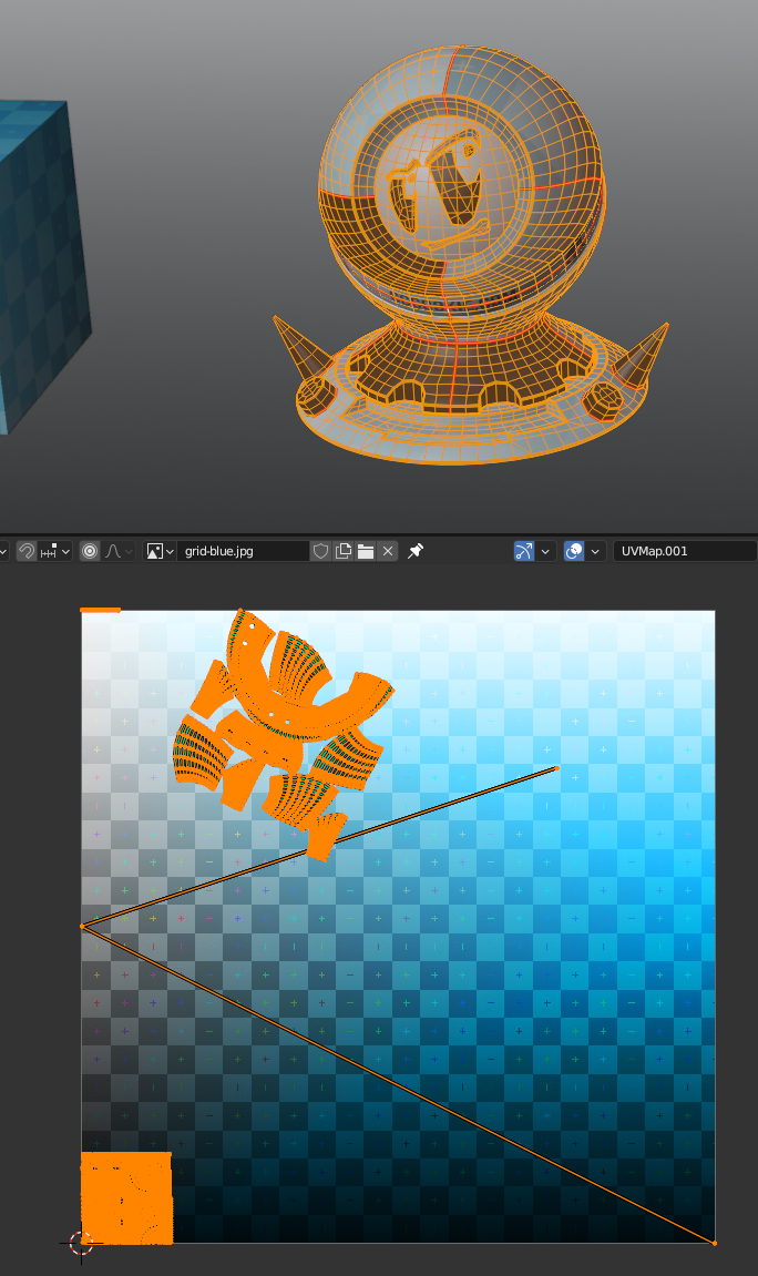

The crazy diagonal lines are from the eyebrow! So I hid everything except the sphere, unwrapped jus that – and get this (below) Why are there a few missing faces and why do I have a line of vertices in the bottom right hand corner of the UV edit?
