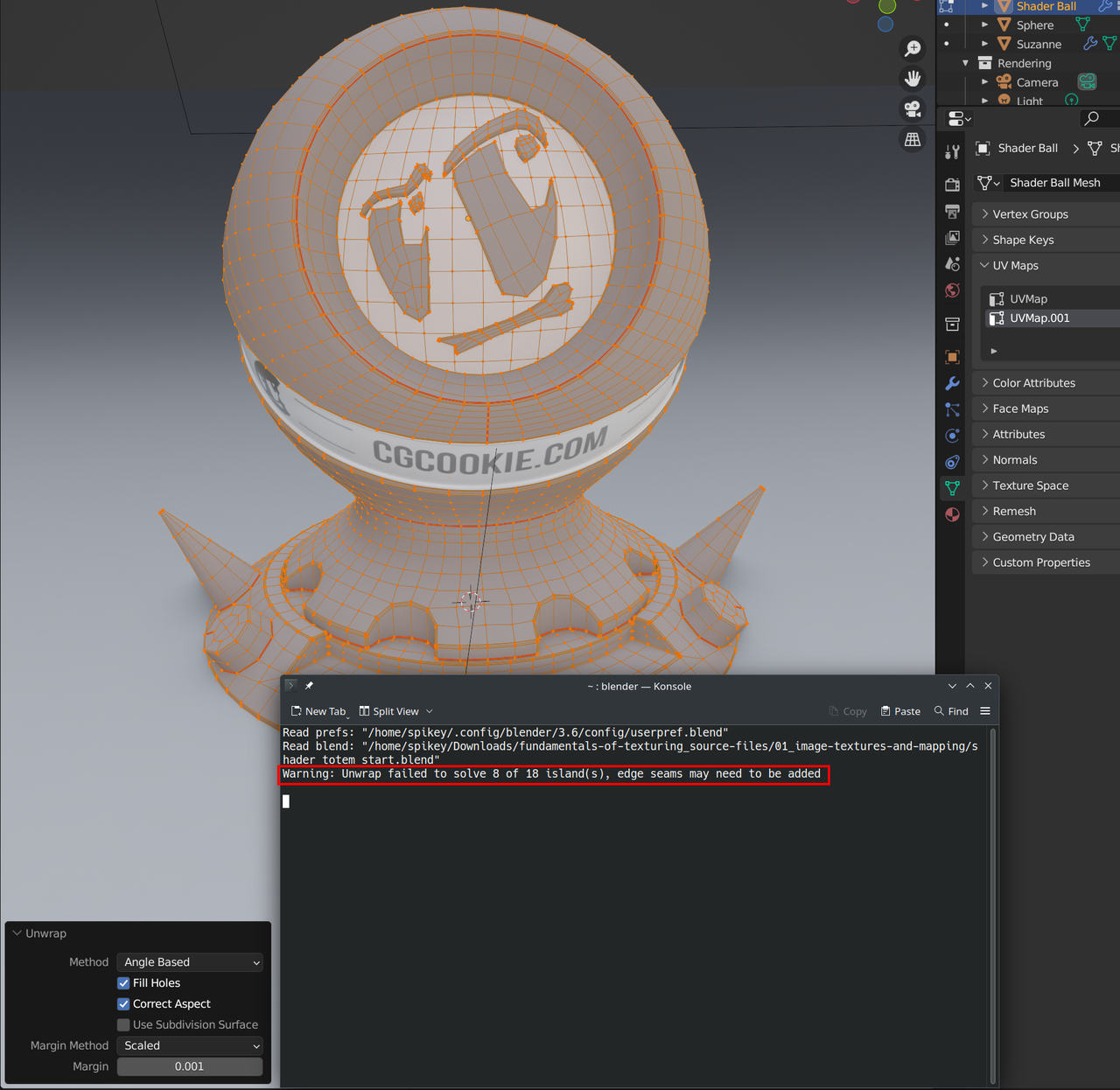

    If you try to Unwrap the Shader Ball as is, with the Seams that are present, you get an Error:
    (The Error Message shows on the bottom of the screen, but it disappears after a few seconds, that’s why I show it in the console here.)
    Packing after a failed Unwrap, doesn’t really make sense now, does it?
