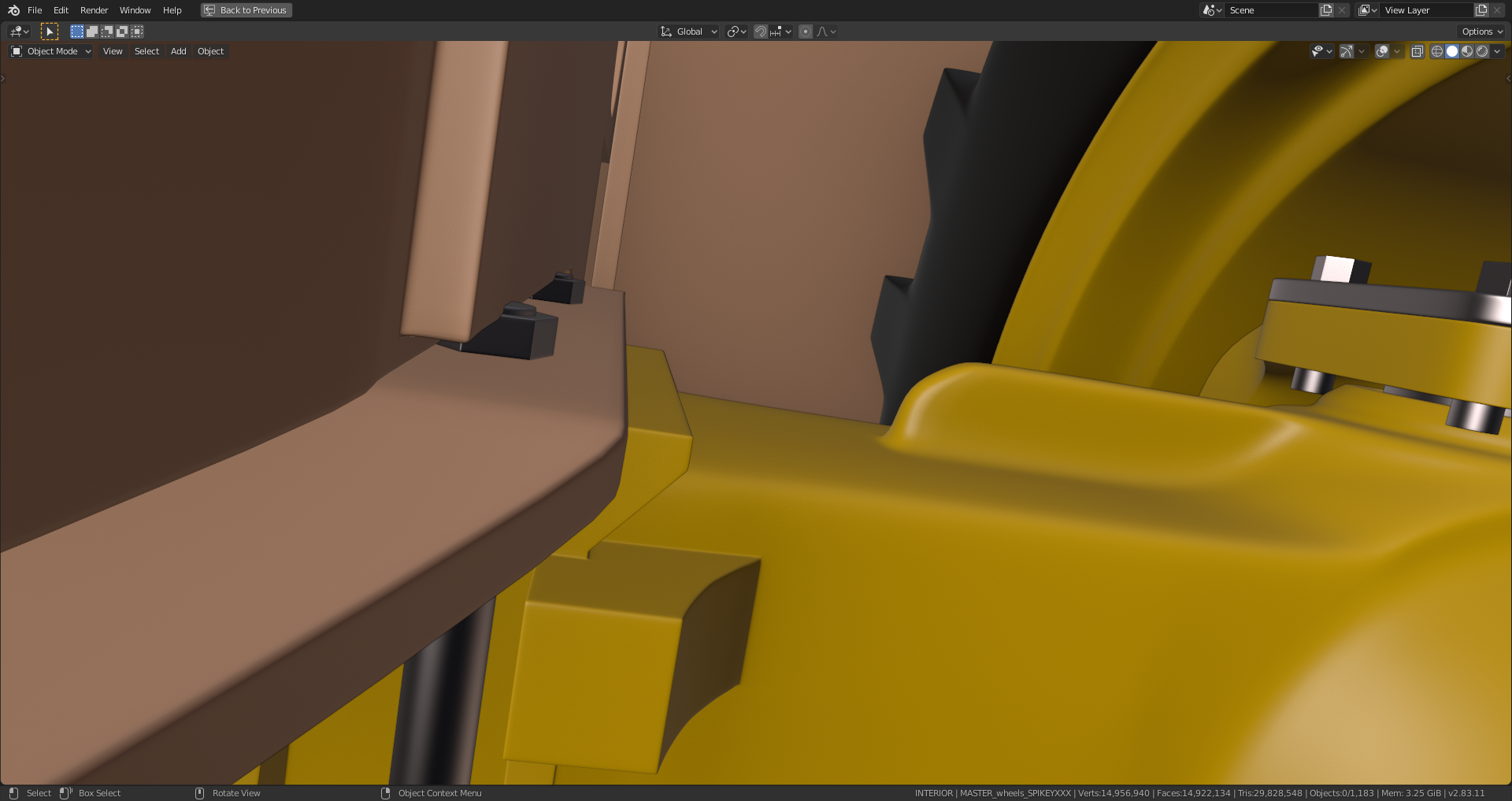

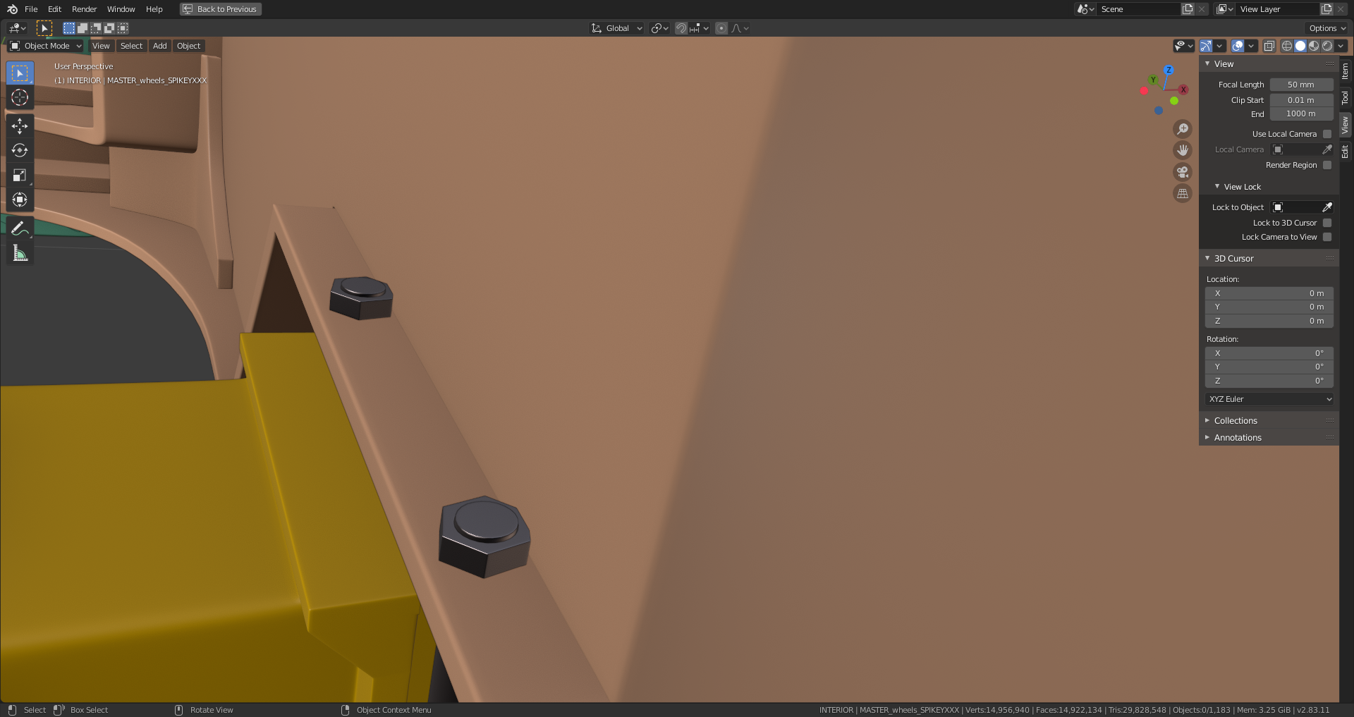

There’re still some slight intersections at the connections between the rear axle and the chassis which should be easy to fix without causing new intersections elsewhere:
