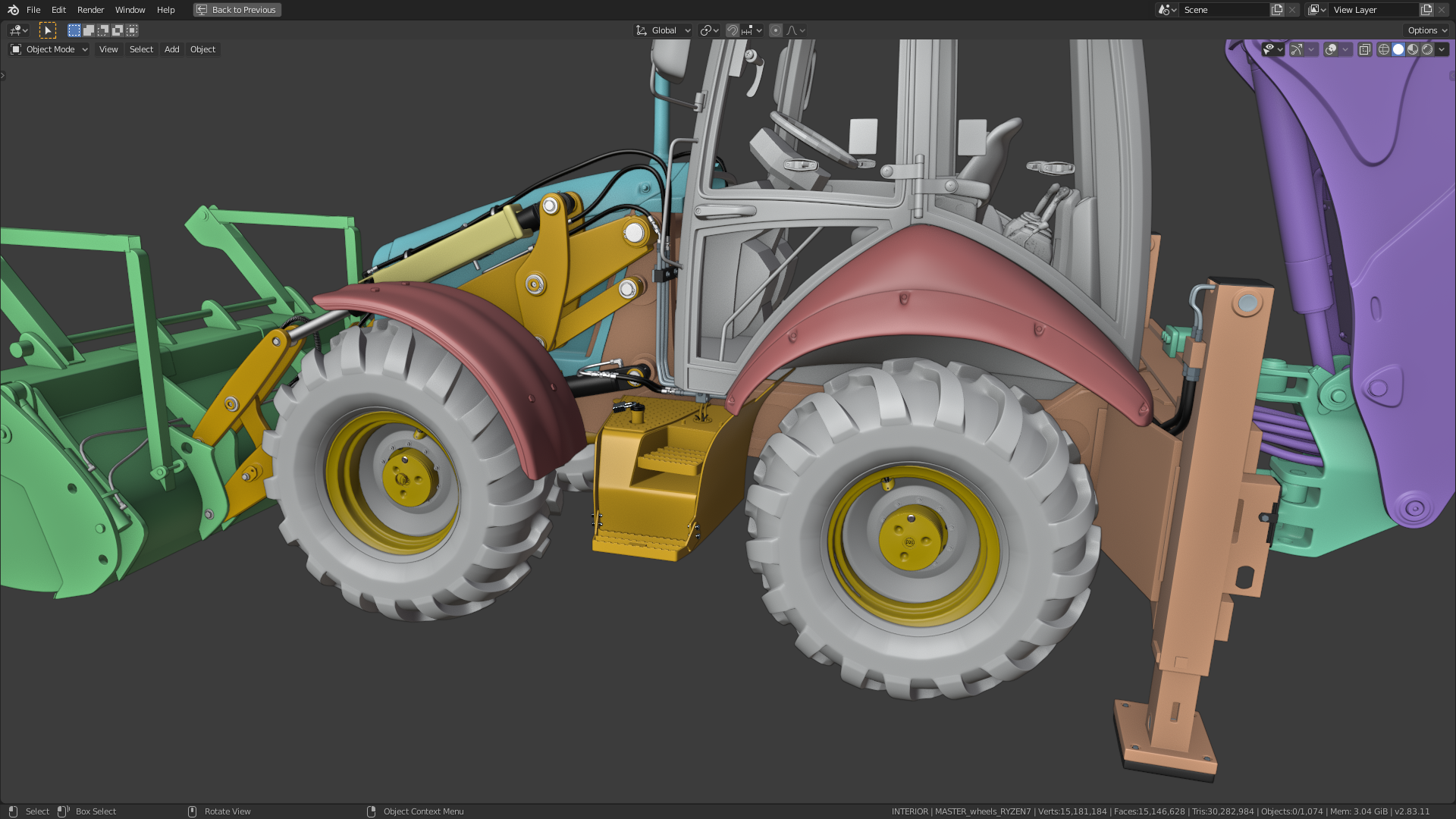

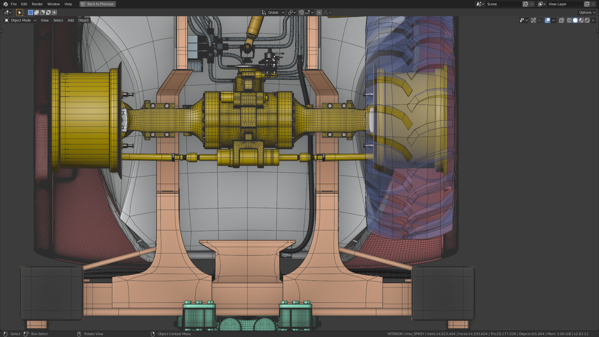

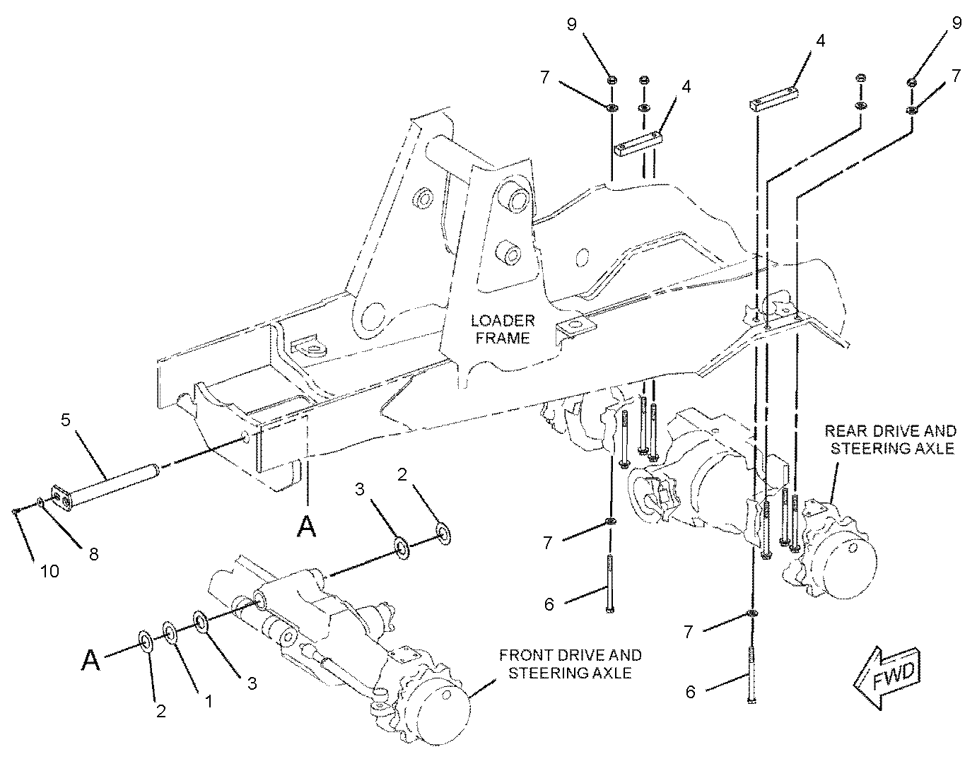

    I’m currently checking what has to be done so that my rear axle fits properly to the adjacent parts:
    1) The gap to the front has to be closed
    A screenshot from the video that @spikeyxxx has found shows that connection:

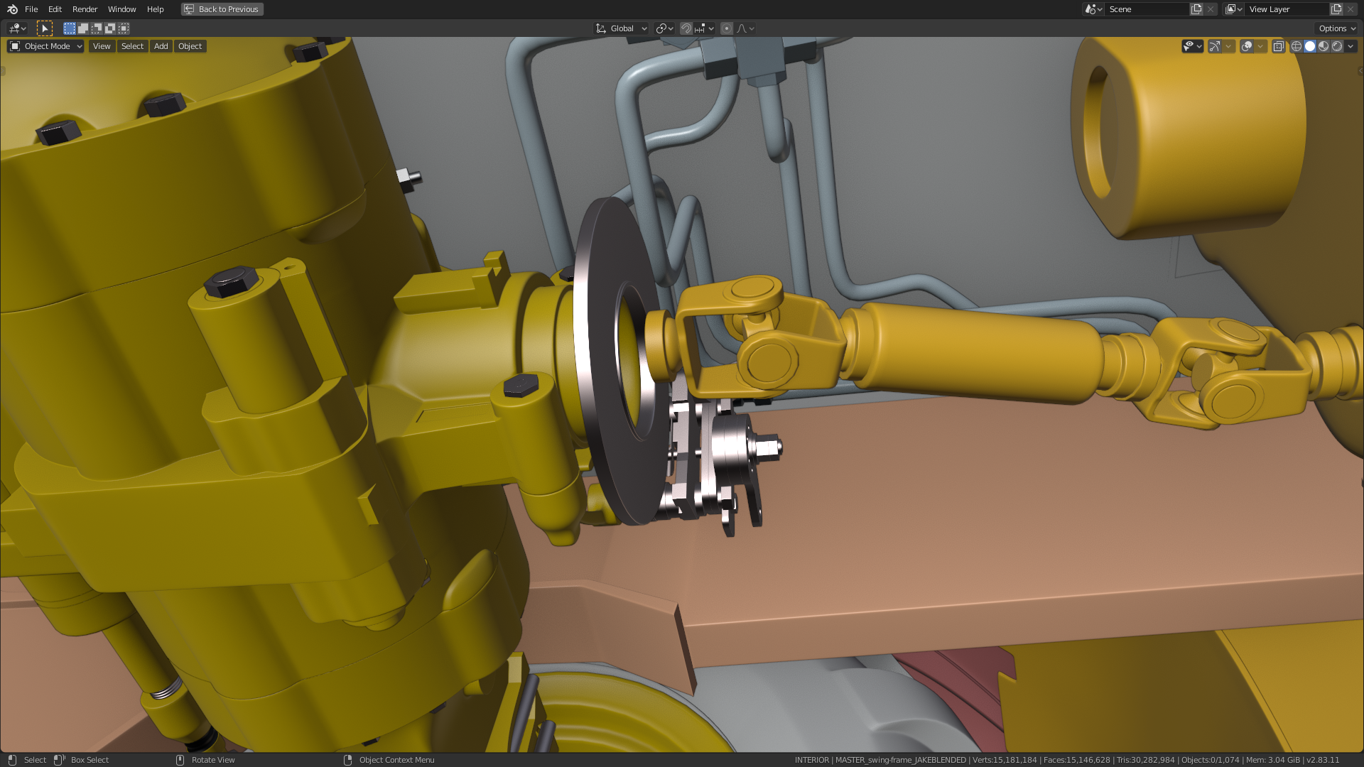

    2) The bolts that connect the rear axle to the chassis aren’t yet in the correct position relative to the chassis:
    That’s how it should be:

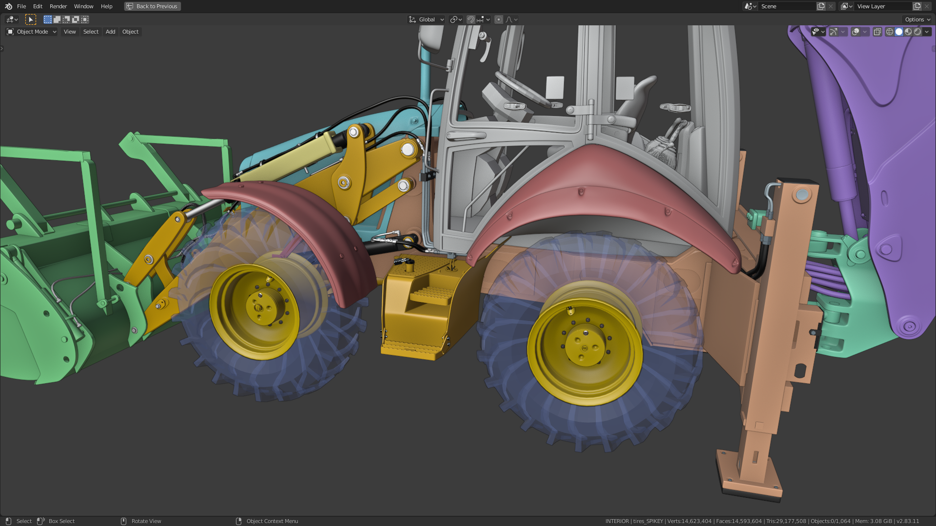

    3) The tires by @ryzen7 and both axles have to be aligned:
    I had my rear axle and the hubs aligned to @spikeyxxx ‘s tires:

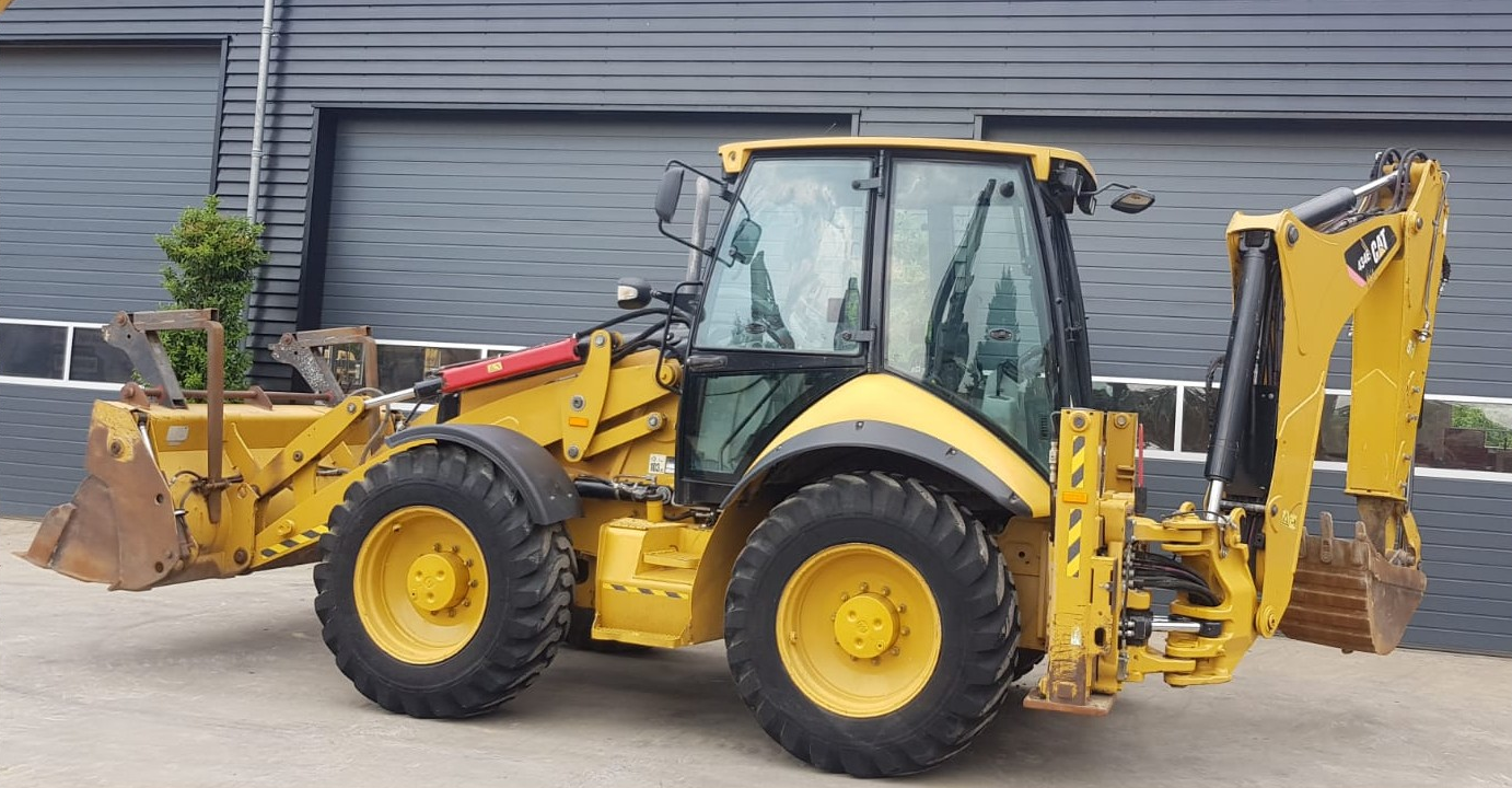

    The gaps between the tires and the fenders seem to be a little bit too big compared with one of Kent’s reference images:
