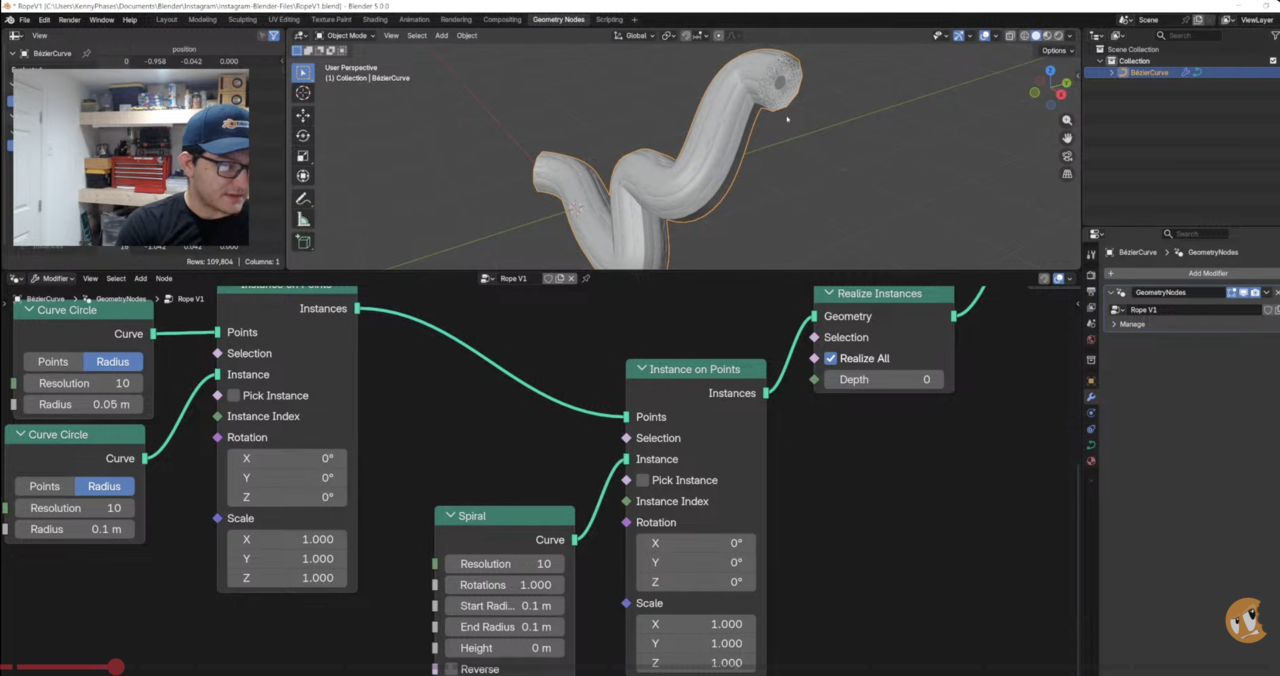

The stream kicks off with a clear breakdown of how to build a procedural rope using curves
, instancing, and tilt control. Even if you never create a rope in your own projects, the thinking behind it is the real value. You see how to create something that reacts in a predictable way when you change a single value.
From there, Blender 5.0 throws a few surprises. Kenny rolls with it, adjusts the node tree, and the whole session shifts into a procedural playground. Watching him troubleshoot on the fly is half the lesson.
You get to see how someone experienced thinks through weird behavior, rather than hiding it with cuts and edits.

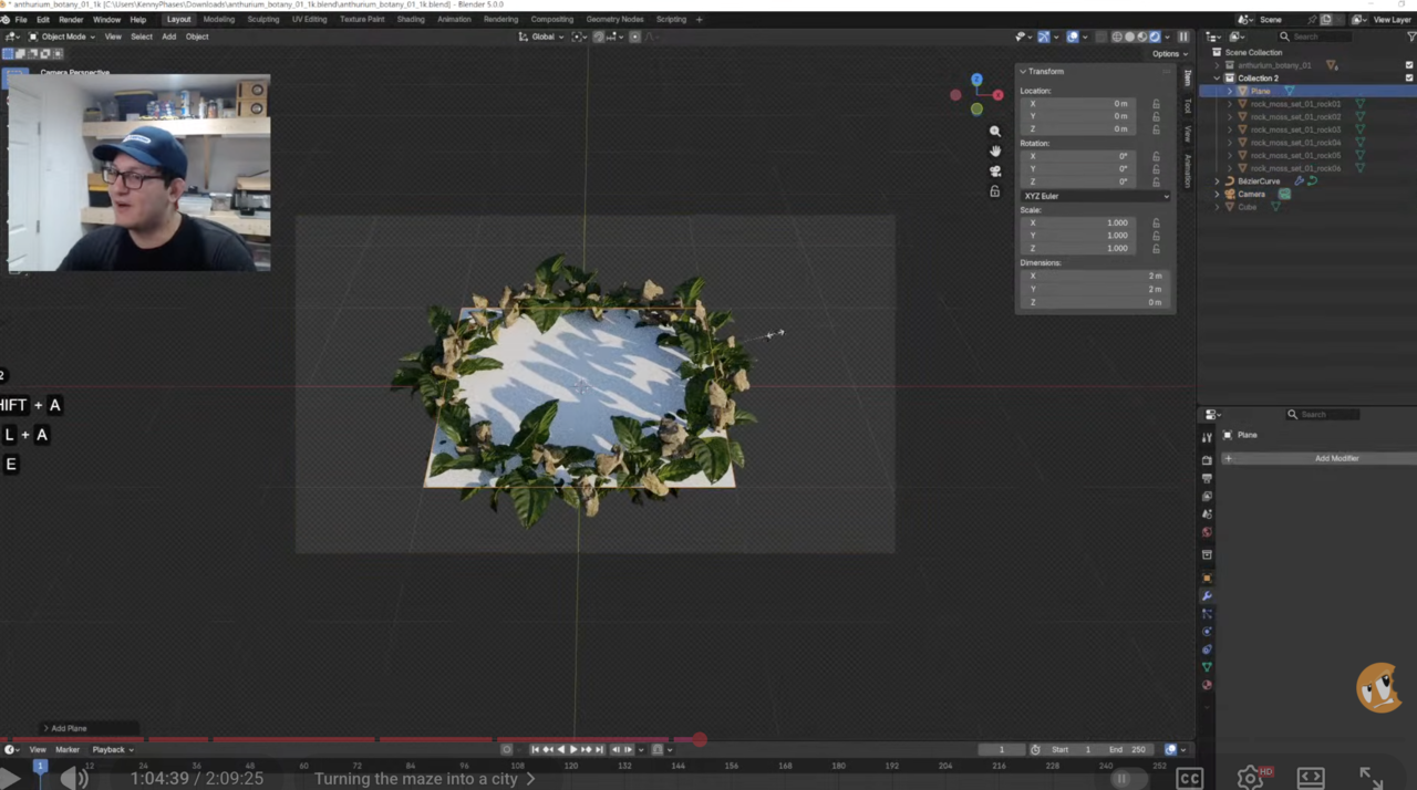

Once the maze pattern exists, Kenny shows how easy it is to turn that same setup into a simple city generator. Convert curves to points, instance some basic cubes, randomize the building heights, and suddenly you have a tiny cityscape.
This is exactly why procedural thinking is so powerful. You do not start from scratch every time. You reuse ideas. One experiment feeds the next.

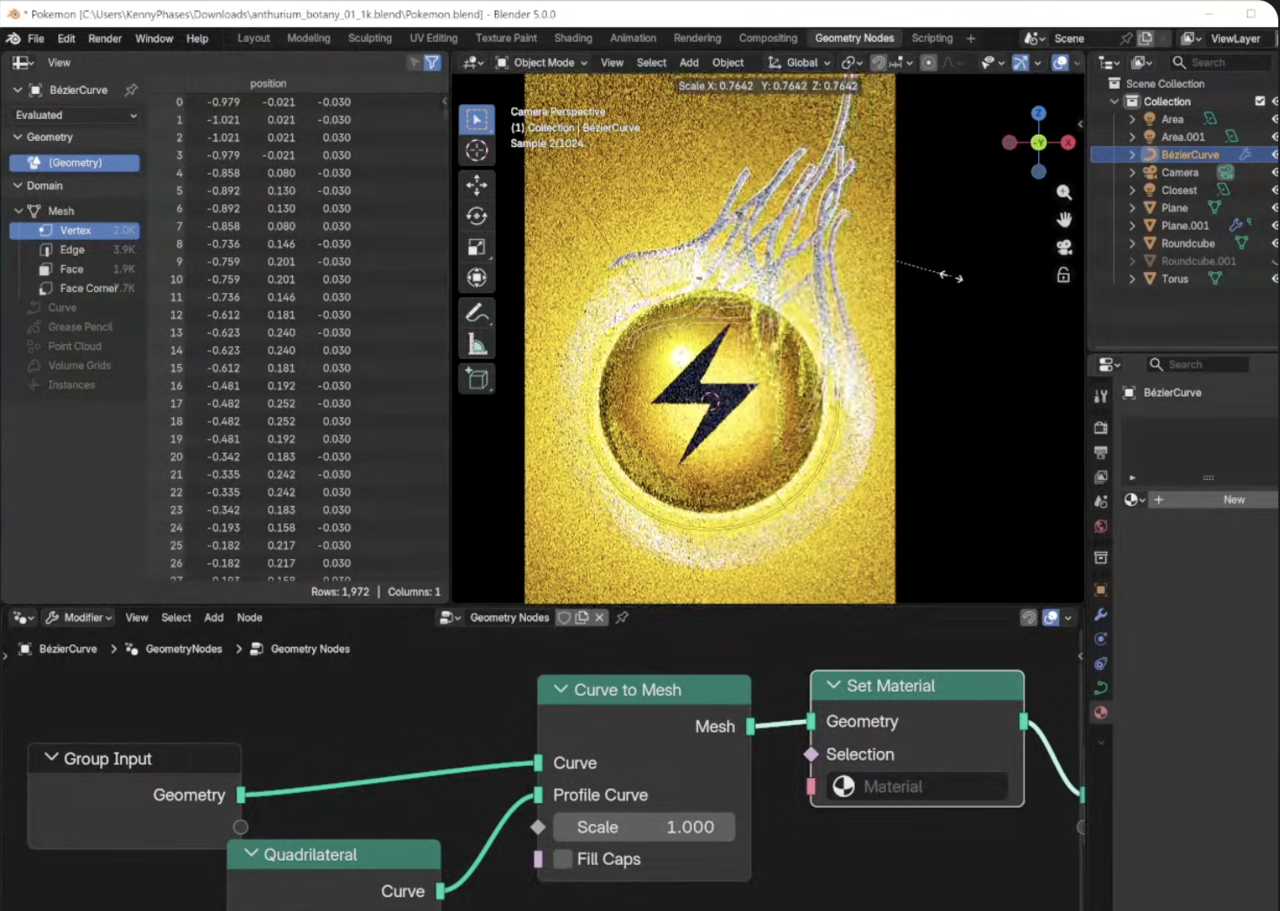

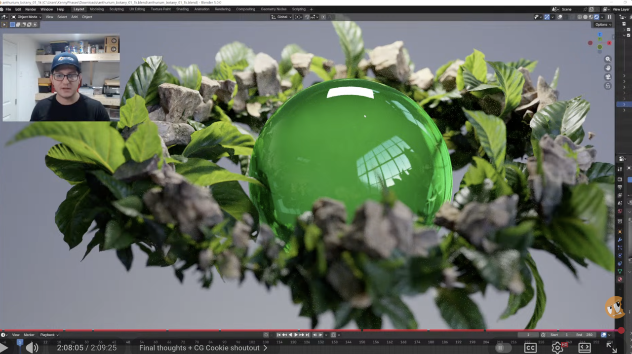

Near the end of the livestream, the focus moves into effects work. Kenny starts scattering leaves along curves, instancing rocks from a Polyhaven collection, and bringing everything together around a glowing central sphere.
He combines:
  • Instance on Points for scattering leaves and rocks.
  • Pick Instance for natural variation.
  • Emission shaders for bright, energetic particles.
  • Volume Scatter for a soft atmospheric glow around the energy core.
The final result looks like something you would find on a trading card or in a game key art piece. More importantly, you see how all these smaller procedural ideas stack together into one cohesive scene.
