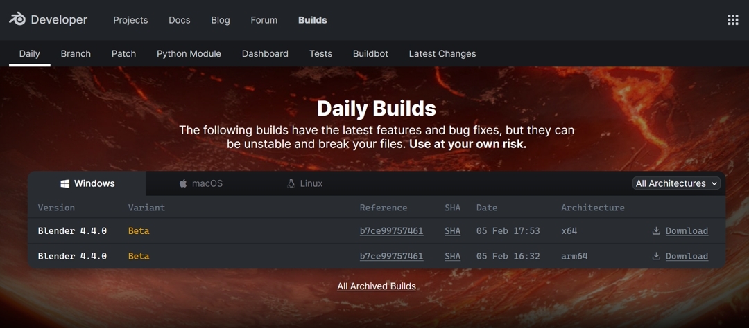

Where to Download Blender 4.4 Beta
To test out these features yourself, download the Beta version from Blender’s official site:
Your platform should be detected automatically, displaying all available builds.

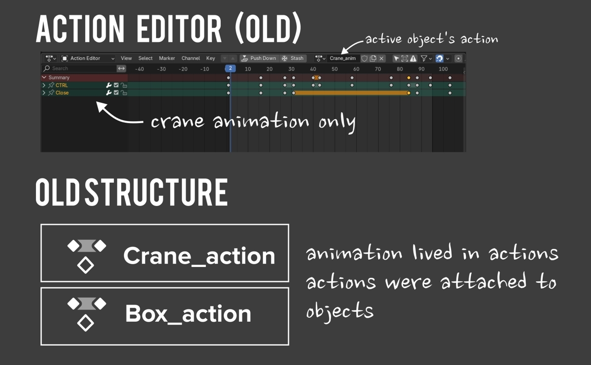

Animation and Rigging: New Action Slots
A new concept called Slots will make its debut in 4.4, making Actions easier to manage. You could consider action slots to be material slots for an object with multiple materials or groups for grease pencil objects: they now allow you to organize distinct parts of your animation data in each slot.
🔹 You can name each slot, reducing the need to scroll endlessly through long animations.
🔹 Action Slots are also added to Non-Linear Animation (NLA) Actions.

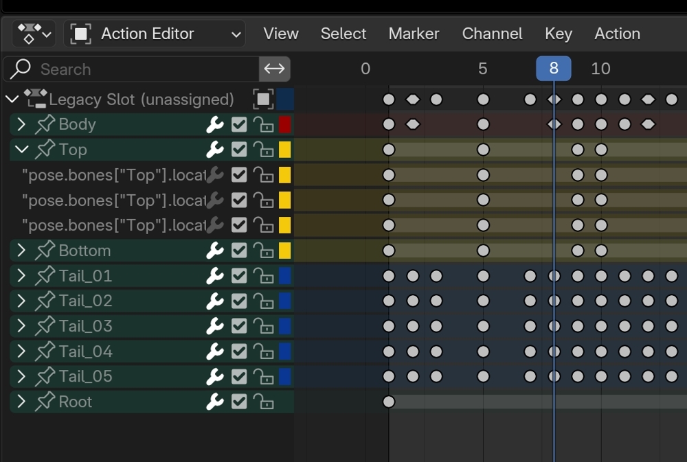

🔹 When opening older Blender files, Actions will be automatically converted to slotted actions and labeled as “Legacy Slots”
If you’re opening an older file in Blender 4.4, Actions are upgraded to slotted actions automatically, and labelled “Legacy Slots”.

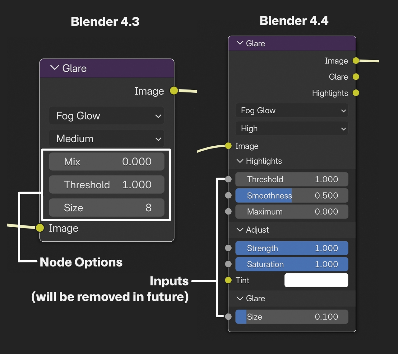

Glare Node Enhancements:
  • Threshold & Smoothness controls give better control over highlights.
  • Adjust strength and saturation for more refined effects.
  • The Glare factor for Bloom and Fog Glow is now relative to image resolution, ensuring consistency across different render sizes.
⚠️ Note: The Glare node options are deprecated. If you open older projects, the settings will appear as inputs but may be removed in future versions. If your Bloom or Fog Glow looks different, adjust the Size and Strength sliders to restore the previous look.

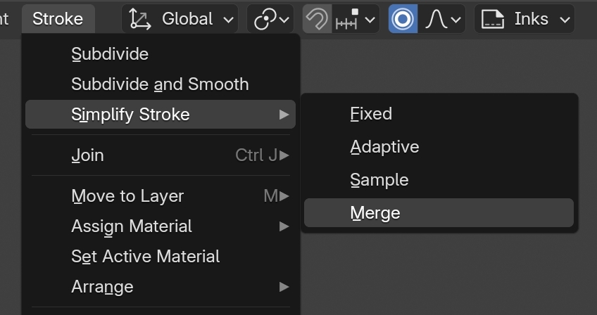

🔹 Simplify functions such as Fixed and Merge return, making it easier to optimize strokes.

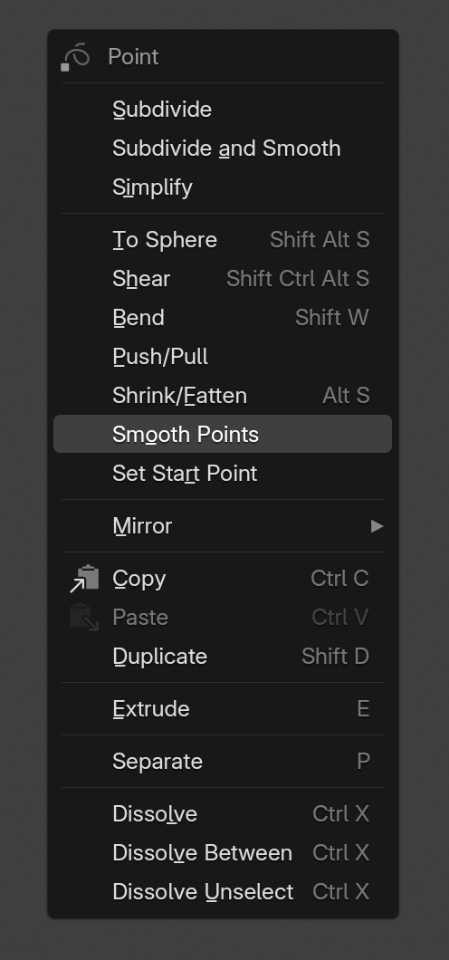

🔹 Smooth Points is now available in the edit point contextual menu.

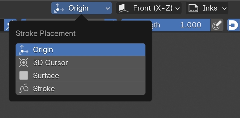

🔹 Stroke Placement is restored in Draw Mode, while Auto-masking is back in Sculpt Mode.

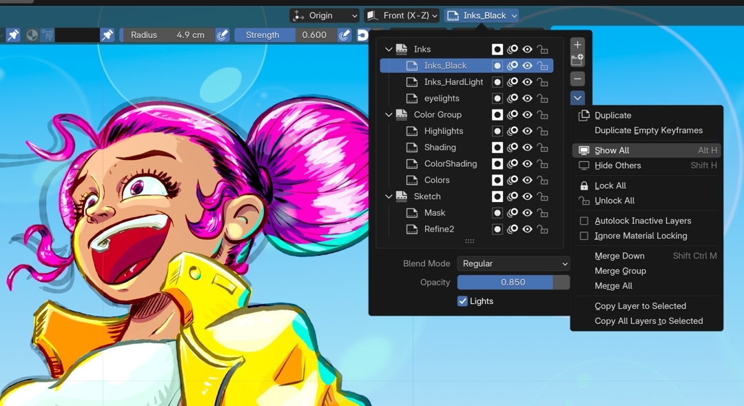

🔹 Layer Groups now respect Show/Hide All and Lock/Unlock All commands.

It may not seem like much, but bringing back simplify functions such as Fixed, and Merge to Simplify makes a big difference. As does bringing back “Smooth Points” in the edit point contextual menu.
Draw mode and Sculpt mode lacked Stroke Placement and Auto masking, respectively.
They are now returned!
Layers in groups are now responsive to commands like Show/Hide All and Lock/Unlock All.

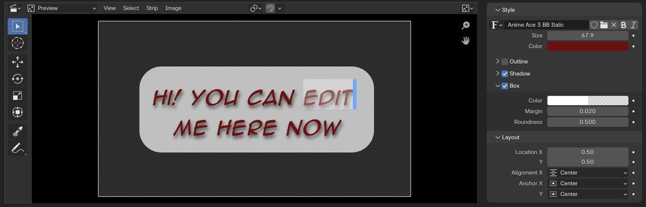

🔹Text can be edited directly in the preview window!
Proper alignment and rounded box corners are now options for text strips, allowing you to create text overlays in custom fonts, colors and styles more efficiently.

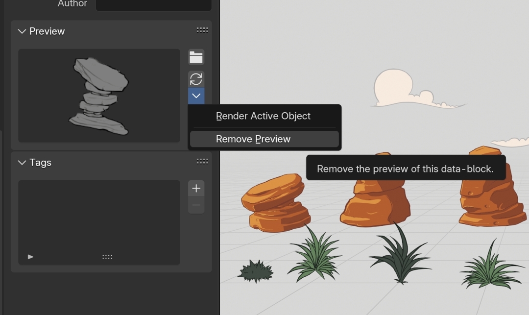

🔹 You can remove an asset’s preview in the sidebar if necessary.

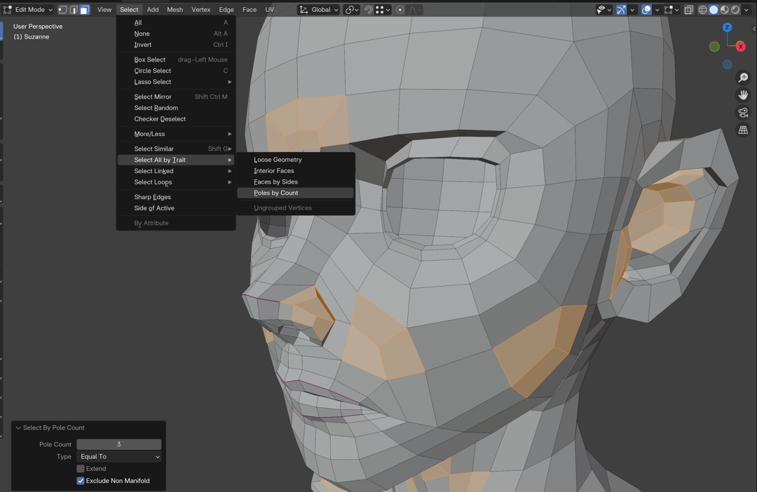

A new “Select by Trait” option allows selection by poles.
When joining triangular faces to make quads, the direction will favor quad topology. Using the Tris to Quads operation will bring up a dialogue box where you can fine-tune relevant factors.
