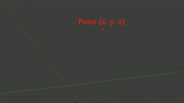

2) Any point in 3d space has three coordinates
A single point P has coordinates x, y and z. For example, (3.0, 0.73, 2.5). But these coordinates can also represent a 3-dimensional vector.

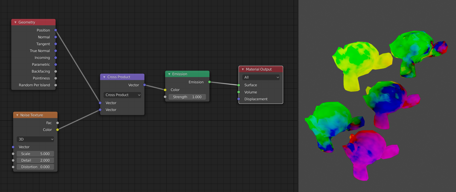

And because everything is a number it’s also possible to do completely ridiculous and meaningless things: like determining the length of color. What!? A colour can have a length? Well a color to Blender is just a number and so yes, you can find the length of that number.
In this example I am taking the cross product of a point in space and a Noise Texture, and plugging the result into an emission shader. Did I mention you can do completely ridiculous things with numbers?

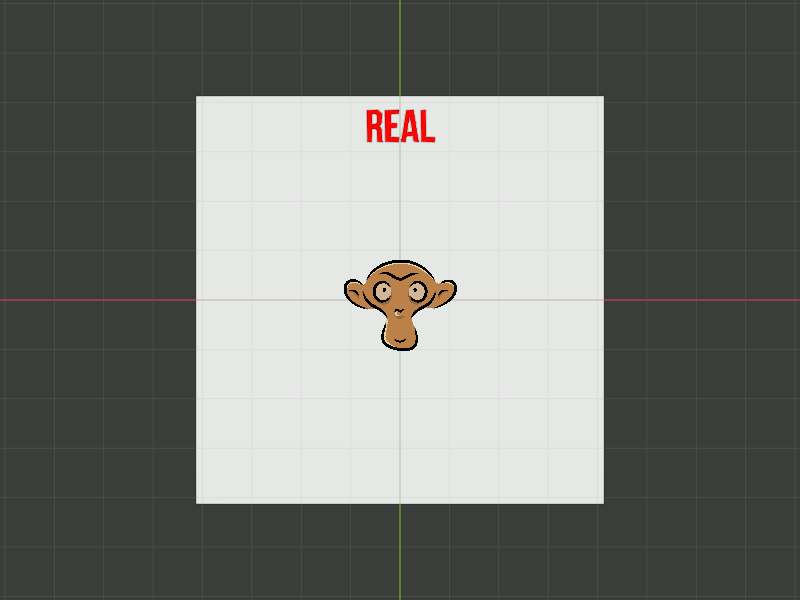

Let’s say we have a 2-dimensional plane, called ‘real plane’, with a point that we want to rotate around the Origin.
(If we can do that, we can rotate as many points as we like around any point on the plane.)
Now, we’ll create a (linked) ‘copy’ of this plane and place it perpendicular to our real plane. The copy is called a ‘complex plane’ (for historical reasons, not because of its complexity! We might as well call it the relax plane…):
Everything that happens in the real plane also happens in the complex copy — and vice versa.
For every point (a, b) on our real plane, there is a point on the complex plane.

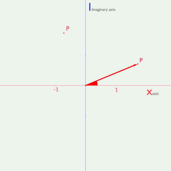

Example 01 with complex numbers in 2d
For a point P(a, b) in our real plane, there is a corresponding point P(a+bi) in the complex plane.
If we multiply this point by i [this is the complex number (0+1i)], we get:
Now comes the beautiful part: if we look at this graphically, we can see that we just rotated the vector (a, b) by 90° (around the Origin):
There’s one thing to note about this example.

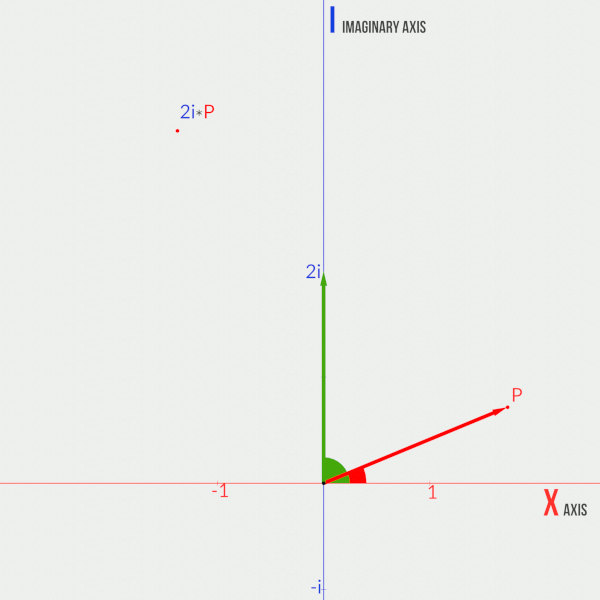

We multiplied our vector by i, which has a length of 1. That’s because it is a vector that moves exactly 1 unit in a given direction.
If we would have multiplied by 2i, we still would have rotated 90°, but also scaled vector P by a factor 2.

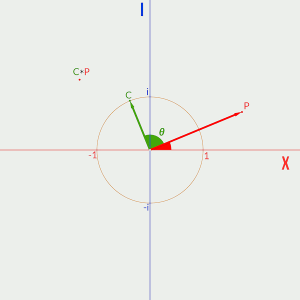

So we will make it a convention to only multiply by vectors of length 1, that is: by numbers, whose corresponding points lie on the unit circle. When we add the angles and multiply the length by 1, we will only get the rotation, without any scaling.
Example 02 with complex numbers in 2d
This works for any angle; we take the unit vector in the complex plane that makes the desired angle with the positive X-axis and multiply the corresponding number by the number belonging to the point we want to rotate. Put the result back into the real plane and Bob’s your uncle.
If we call the angle of rotation , we can also write point C as: (cos, sin) and the number as: (cos+isin). This will become especially useful in 3D.
If a number lies on the unit circle, meaning it corresponds to a vector of length 1, we say the number has a Norm 1. (As numbers do not have a length. This is the equivalent of length for vectors and distance (to origin) for points.)

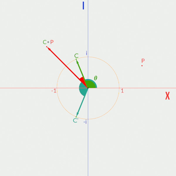

Here is an important term:
if we have a complex number
then we call
its complex conjugate.
(Here I use the notation C’ to indicate the conjugate of C, but there are other notations that you may encounter…)
When we multiply a complex number P by some complex number C of Norm 1, we rotate by a certain angle θ.
If we after that multiply again, but this time by the conjugate of C, we rotate by an angle of (360°-θ) and thereby return to the original place of P.
As a special case: if P is an imaginary number, meaning its real part is 0, for instance:
then
is also an imaginary number for any complex number C. Although this sounds trivial here, it will be extremely important when dealing with 3D rotations!
Multiplications of this form are called sandwich multiplications, for (I hope) obvious reasons.

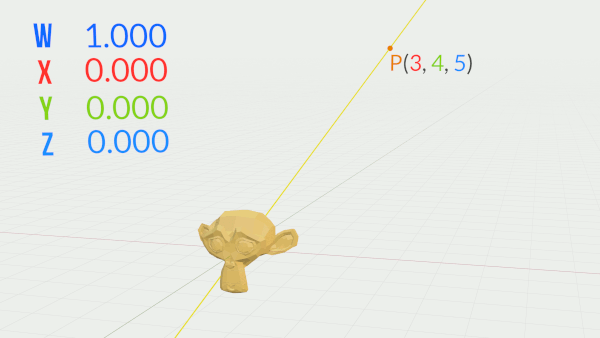

In Blender, if we set the rotation mode to quaternion we get the 4 fields: W, X, Y and Z. Important to notice here is, that the angle of rotation is contributing to all four; to be precise, if the angle of rotation is θ, and the unit vector around which we want to rotate is (a, b, c), then:
[As we have set
and
Just to be clear: that rotation vector is placed at the object’s origin. If the object is rotated around some other line, then that is done by rotation around the objects origin AND a translation.
You don’t actually have to fill in those fields by hand, but it is good to know what is happening.

Open Blender, delete the default Cube, add a Monkey and switch the rotation mode to Quaternion (I know, not much of a challenge yet for most of you, but wait…)
Fill in the W, X, Y, Z fields, so, that Suzanne rotates 180° around the axis that goes through (0, 0, 0) and (3, 4, 5).
